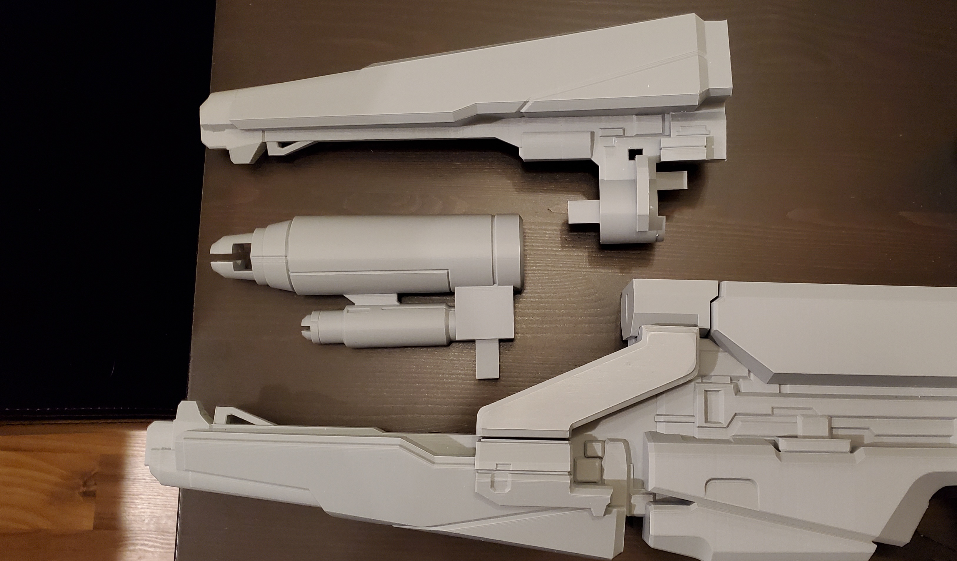

Here are the 28 pieces and their likely orientation for printing:
