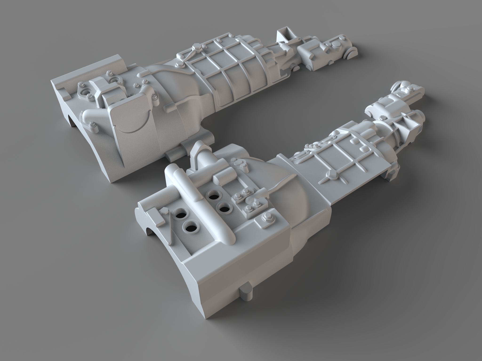

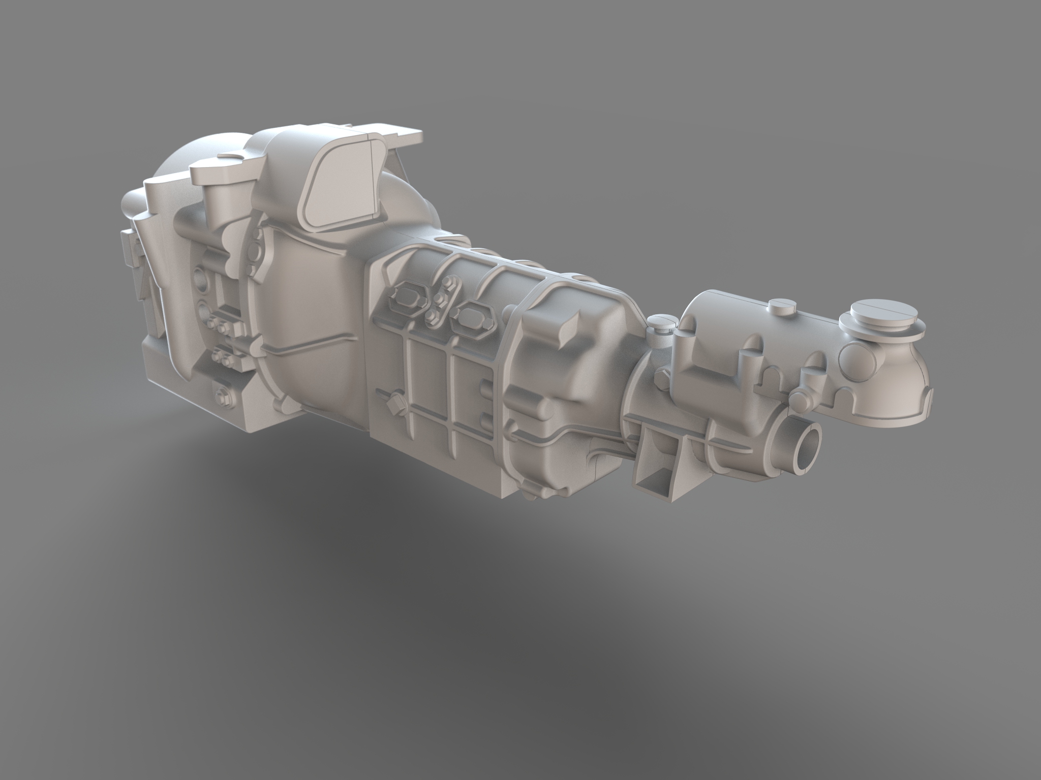

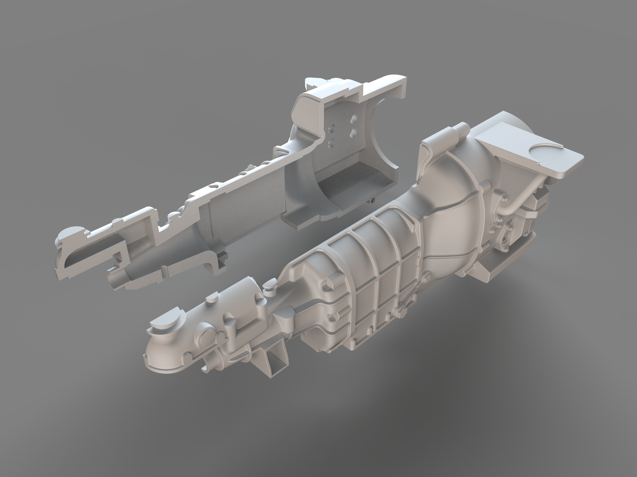

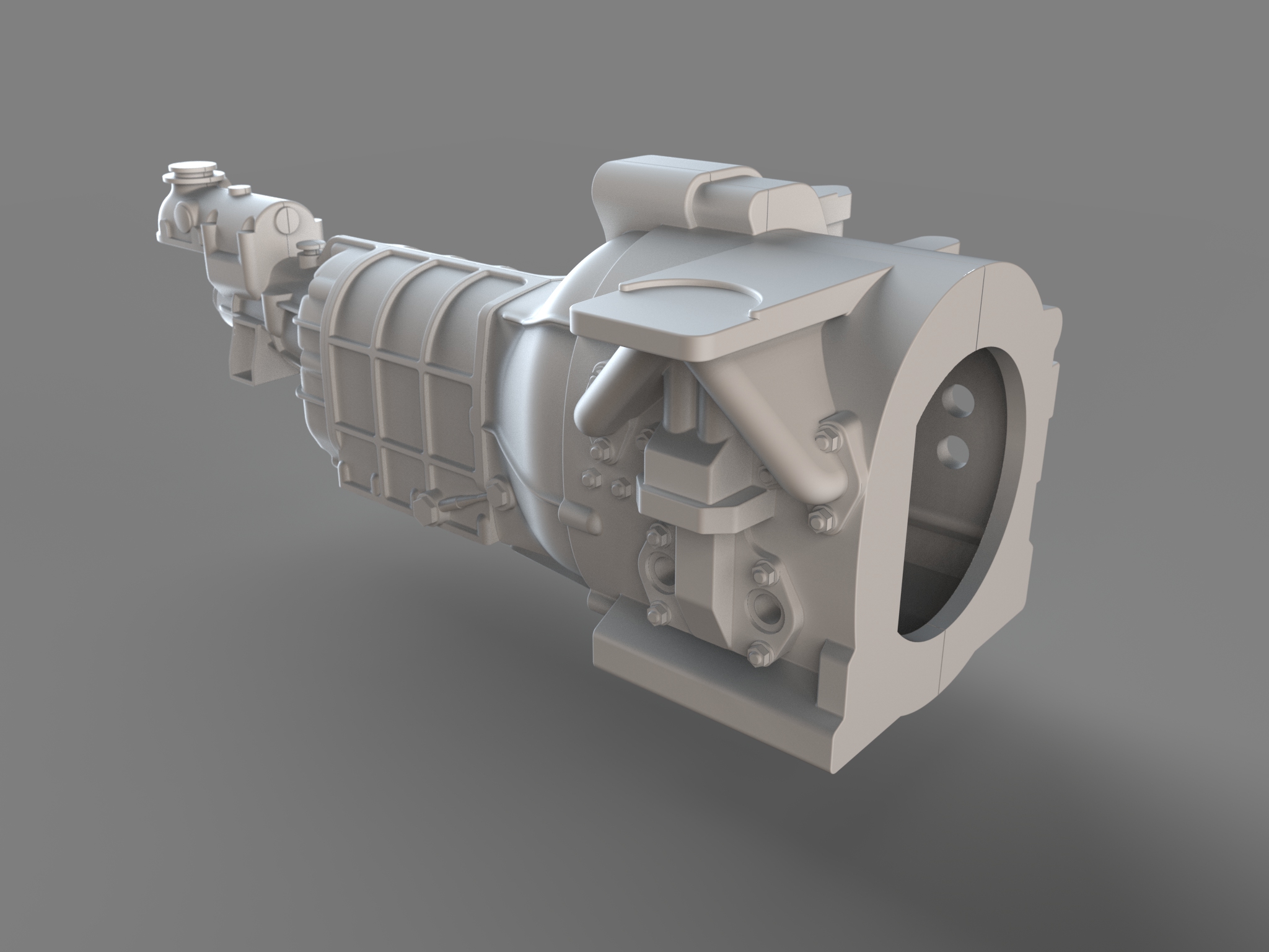

I use a combination of different programs; mainly Fusion360, but also Alias, Maya, Blender and Solidworks.
Fusion is pretty new on the market, but it's free, and very comparable to Solidworks for the type of work I do.
The Entex part was created in all the above...

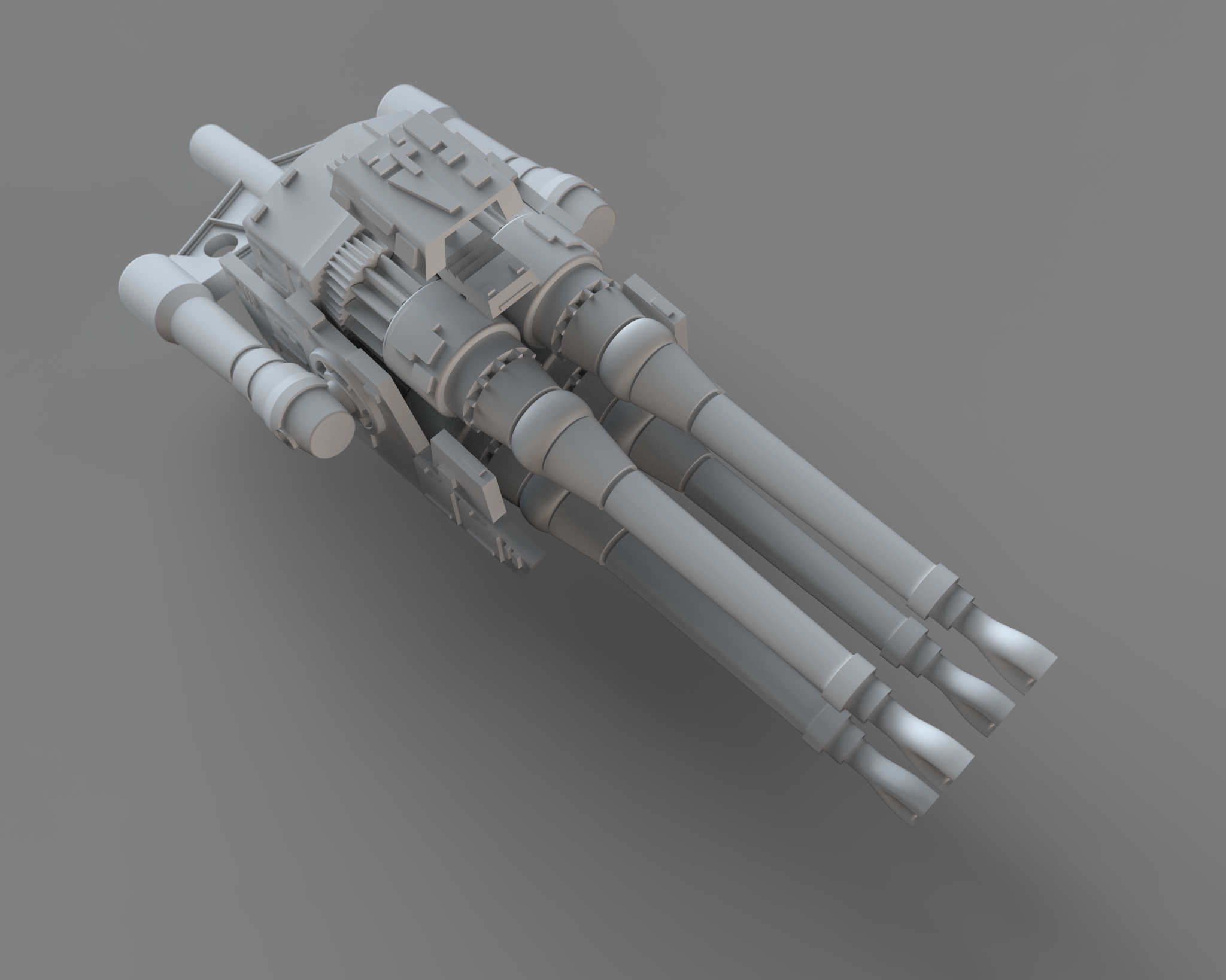

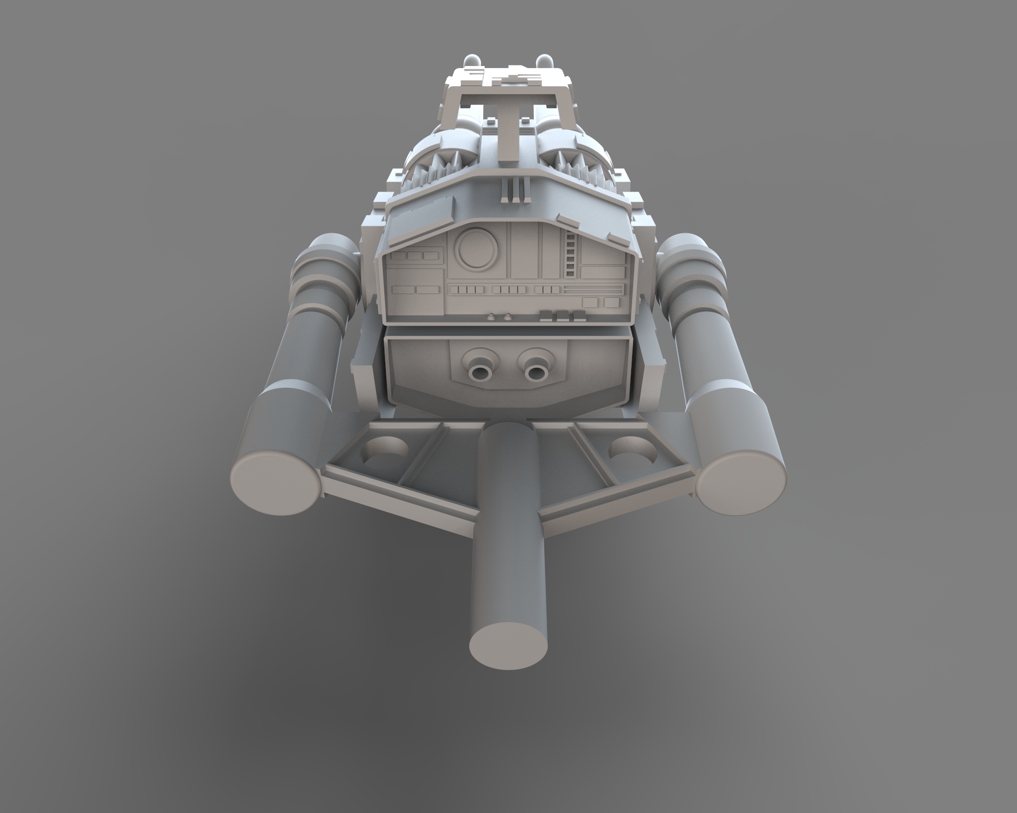

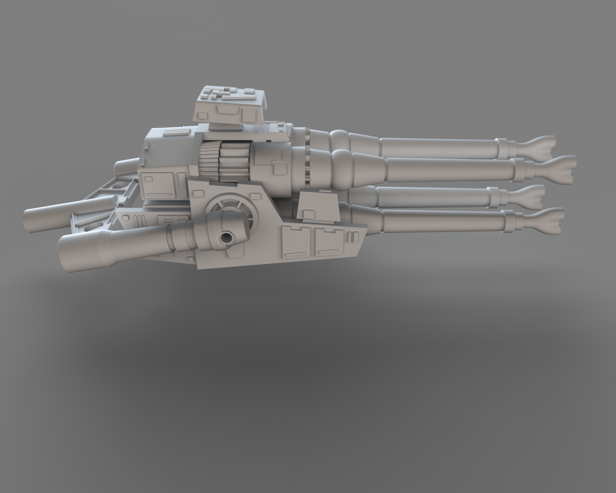

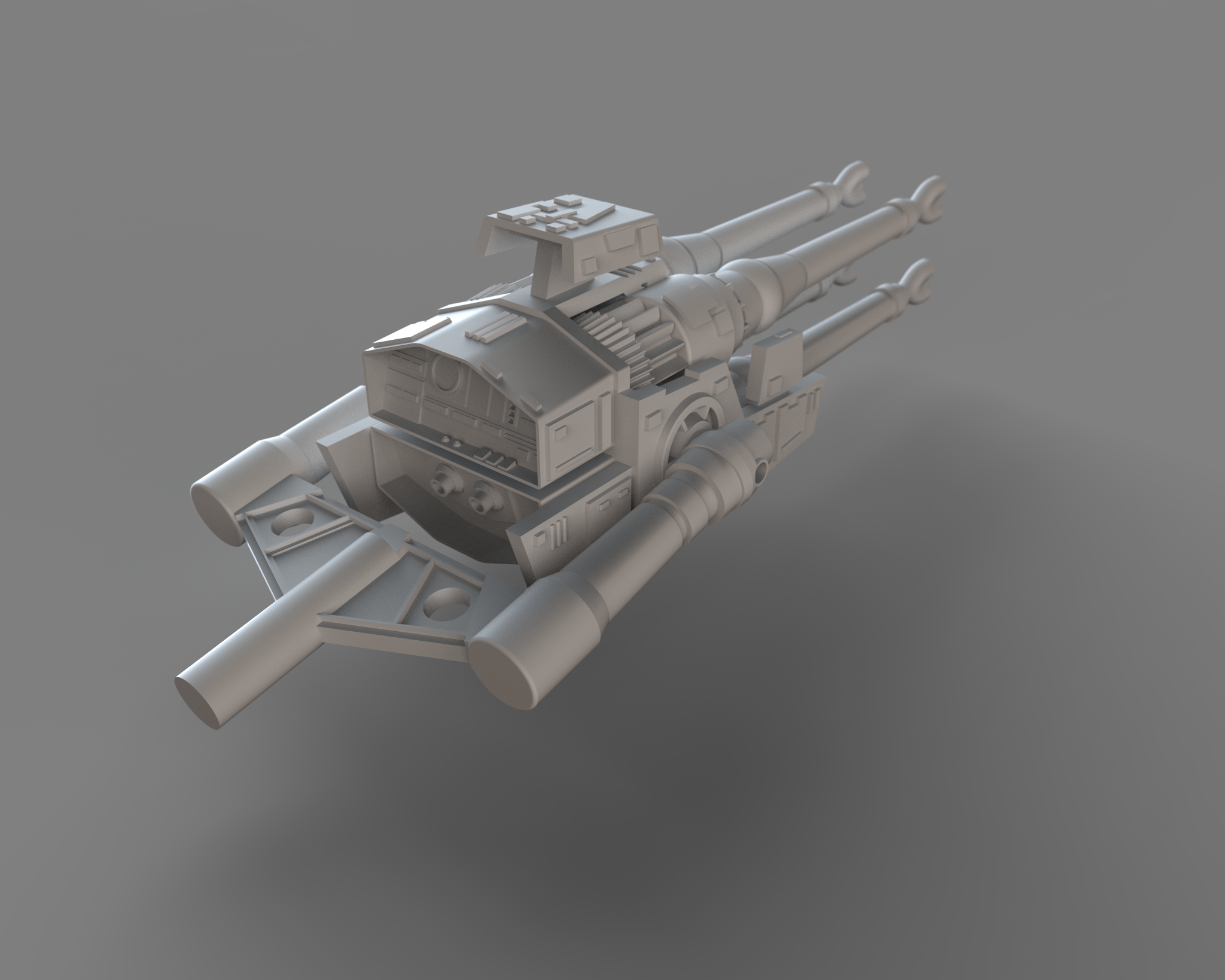

This is a quick motion control test I threw together. Yes, the gun barrels are Bic pens, but it was just a proof of concept.
The targeting is being calculated in Unity (yay quaternion math!). Unity maintains a virtual target that the barrels try to point toward which, in-turn, calculates the values of each of the servos. The servo values are passed to an Arduio and then to the servos themselves.
I'd like to try to come-up with a way to get this all to run on the Arduino, but the spherical calculations are tricky and result in gimbal lock conditions quite easily...
https://vimeo.com/140881412
Oh, and here is a version of the quad gun that won't be made from Bic pens...
Cheers,
J.

if you ever get to a stage of selling this set up , I would be interested ,
excellent engineering

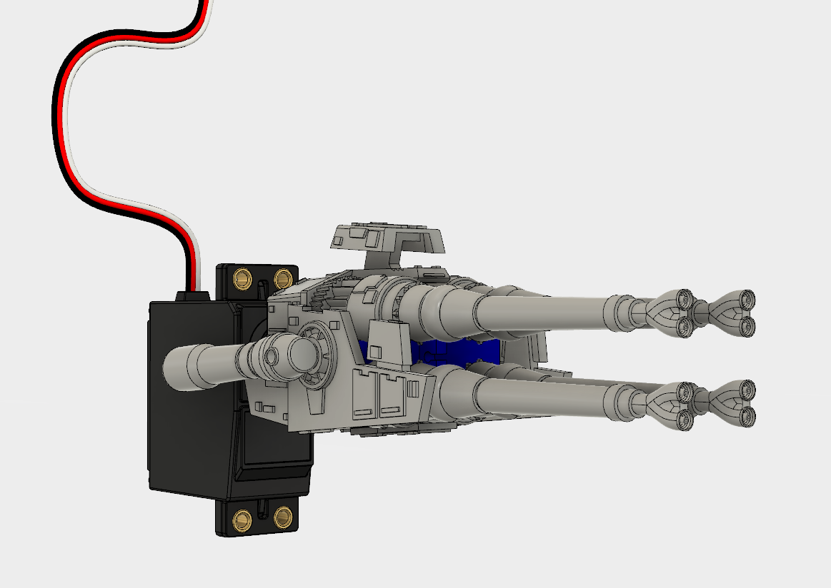

Sure! Once (or if) I ever get this working on just a standalone microprocessor, I'll share the code. It's kind of a convoluted set-up at the moment - but it was a quick way to visualize what's going on with the two motions of the servos.
I'll also need to hunt down some smaller servos - this is them placed in a ANH 5' scale gun. The mini in the barrel mount is pretty hidden (in blue), but the main yoke servo would stick out of the turret deck pretty bad...

1:1 with the 5' foot or the 32" or 1:1 with the original kit part the piece was taken from?
The 5-footer.
The Entex Rotary was from the ANH model. The 32" ESB Falcon used the Porsche transmission.
I'll be printing it half scale though to fit my smaller model.
