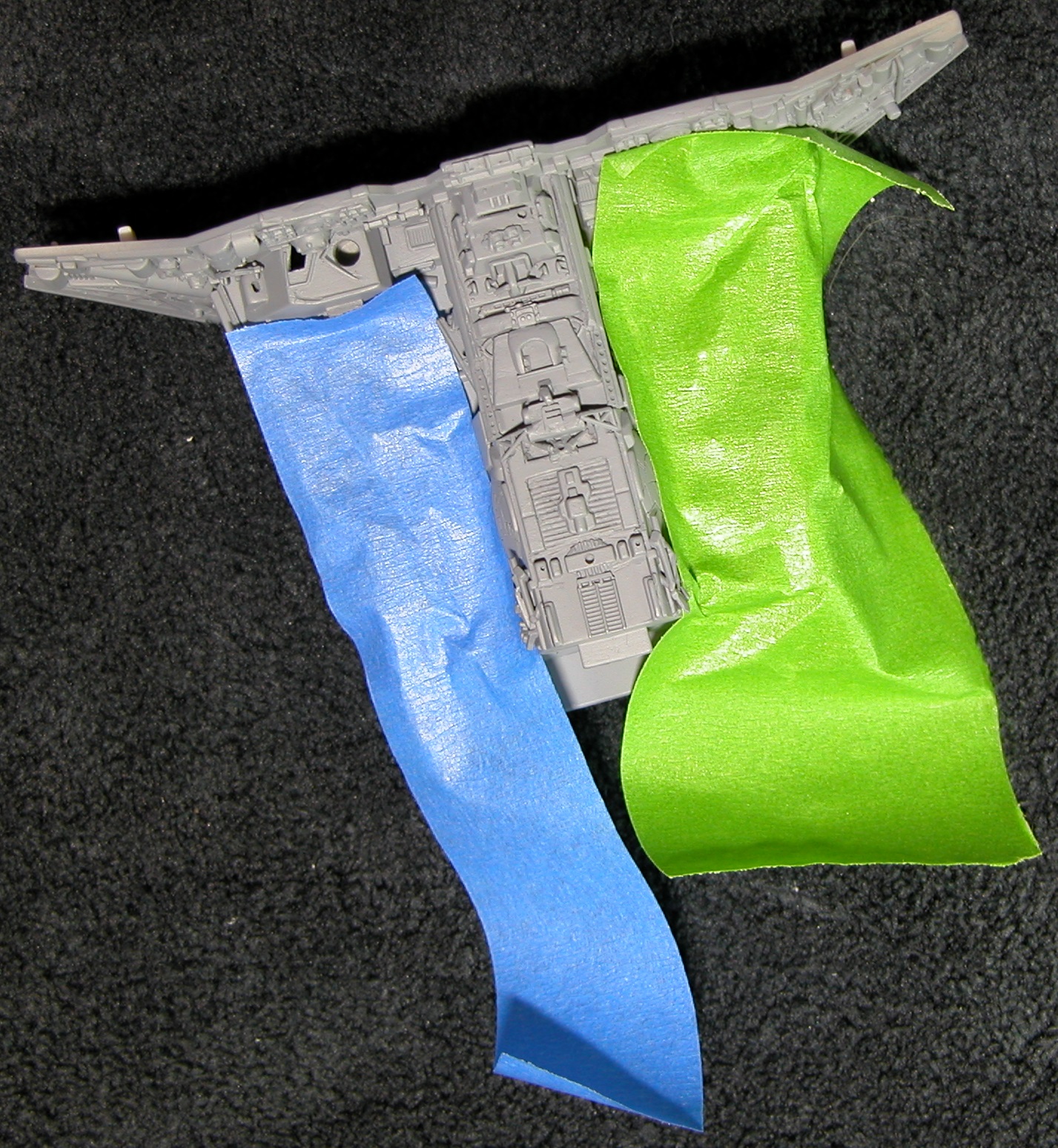

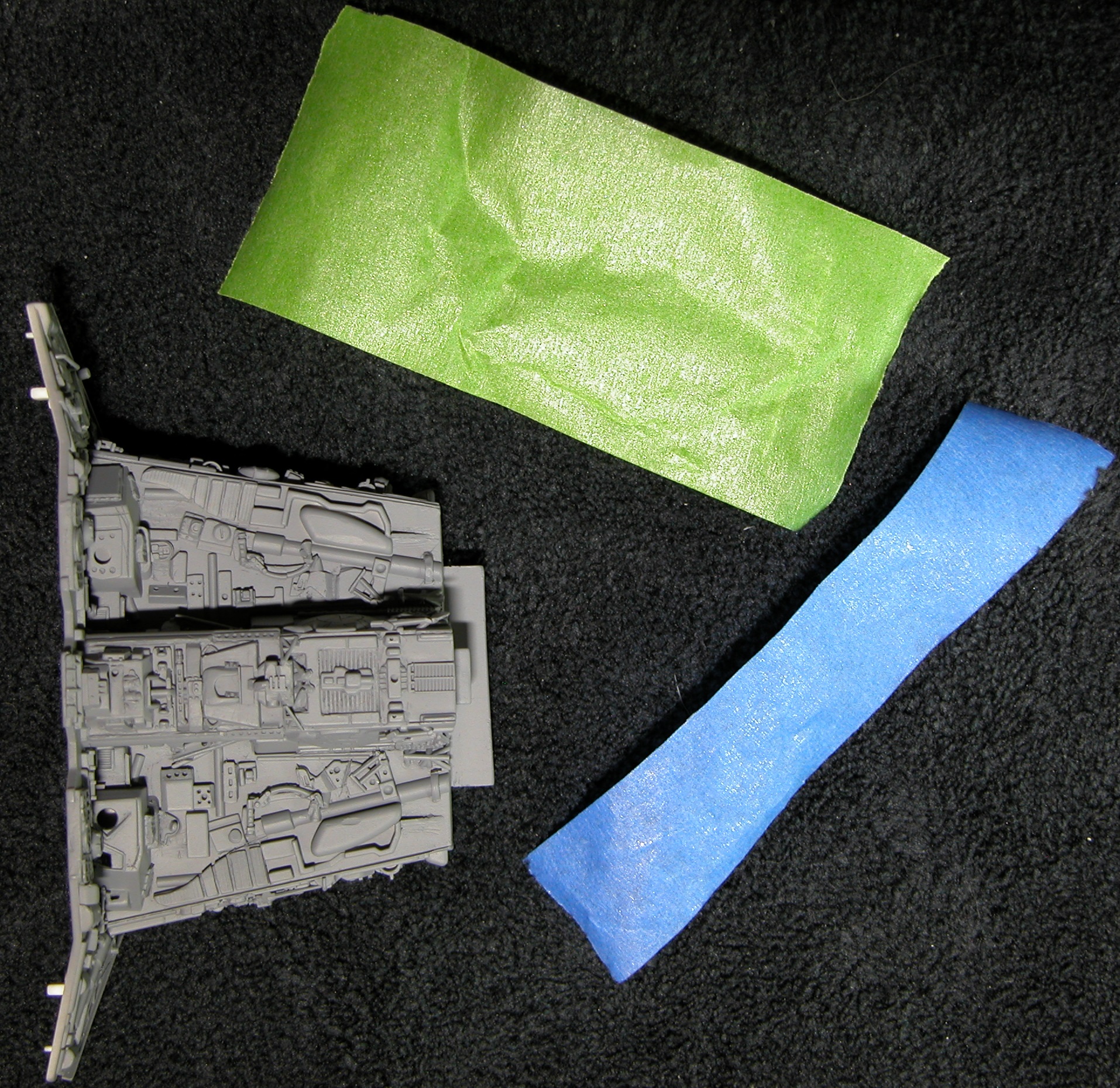

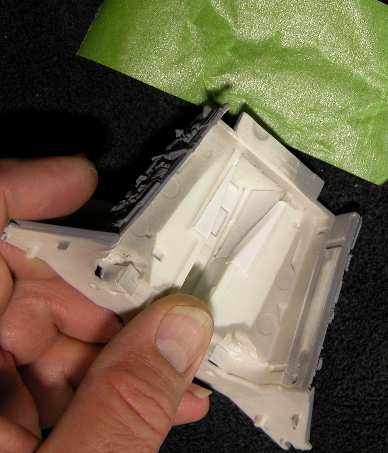

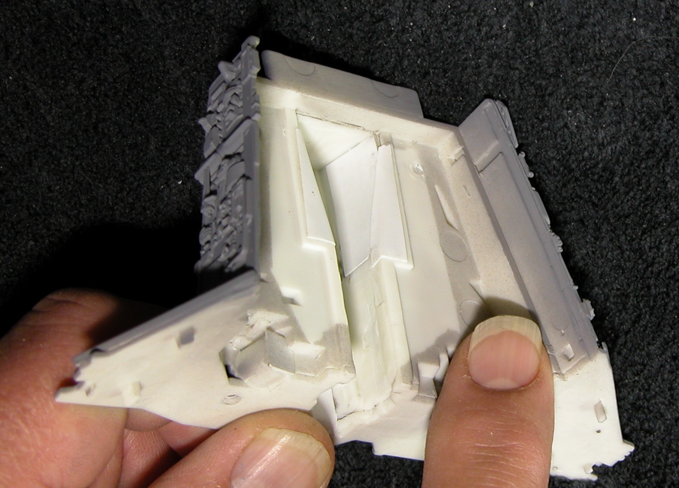

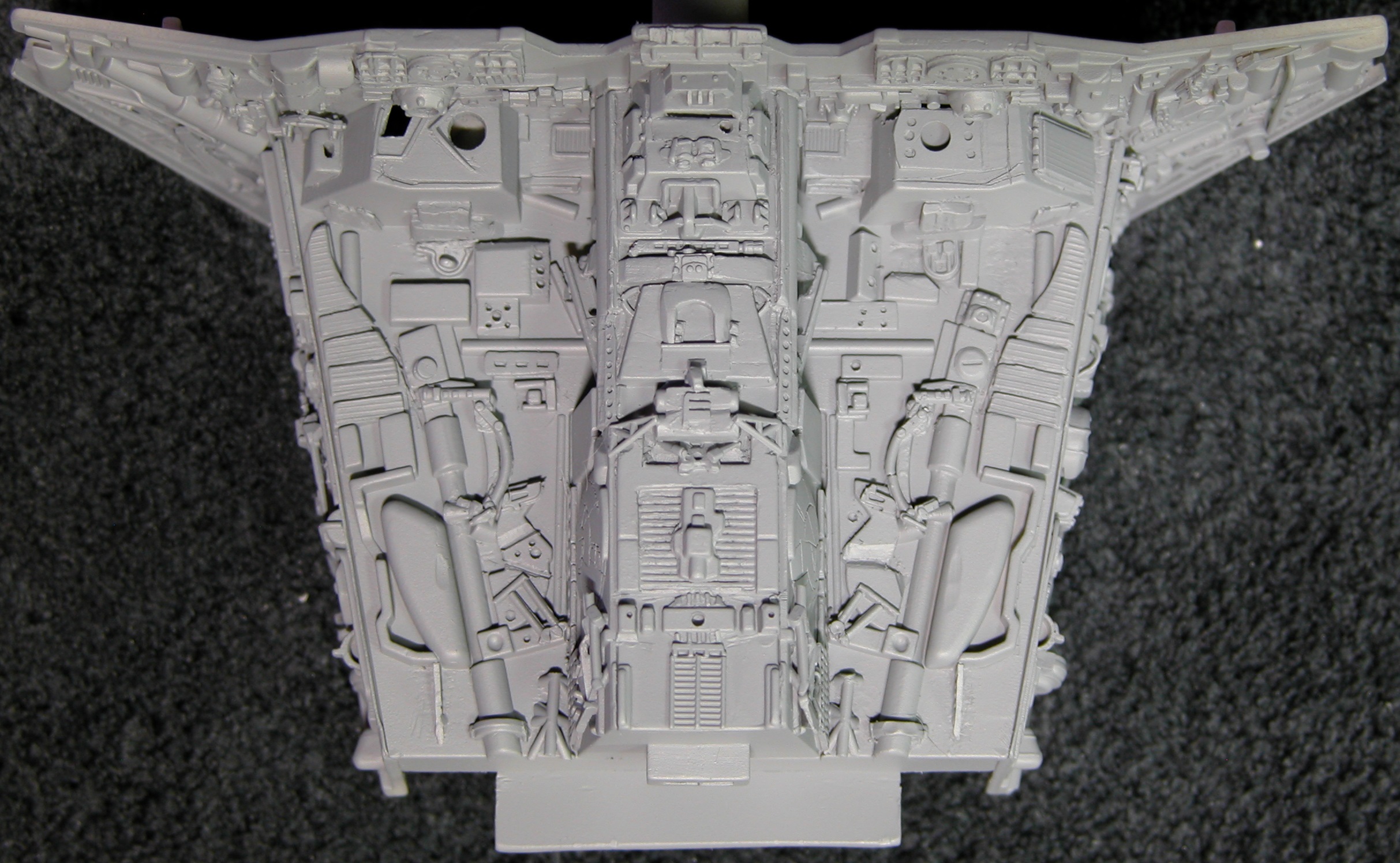

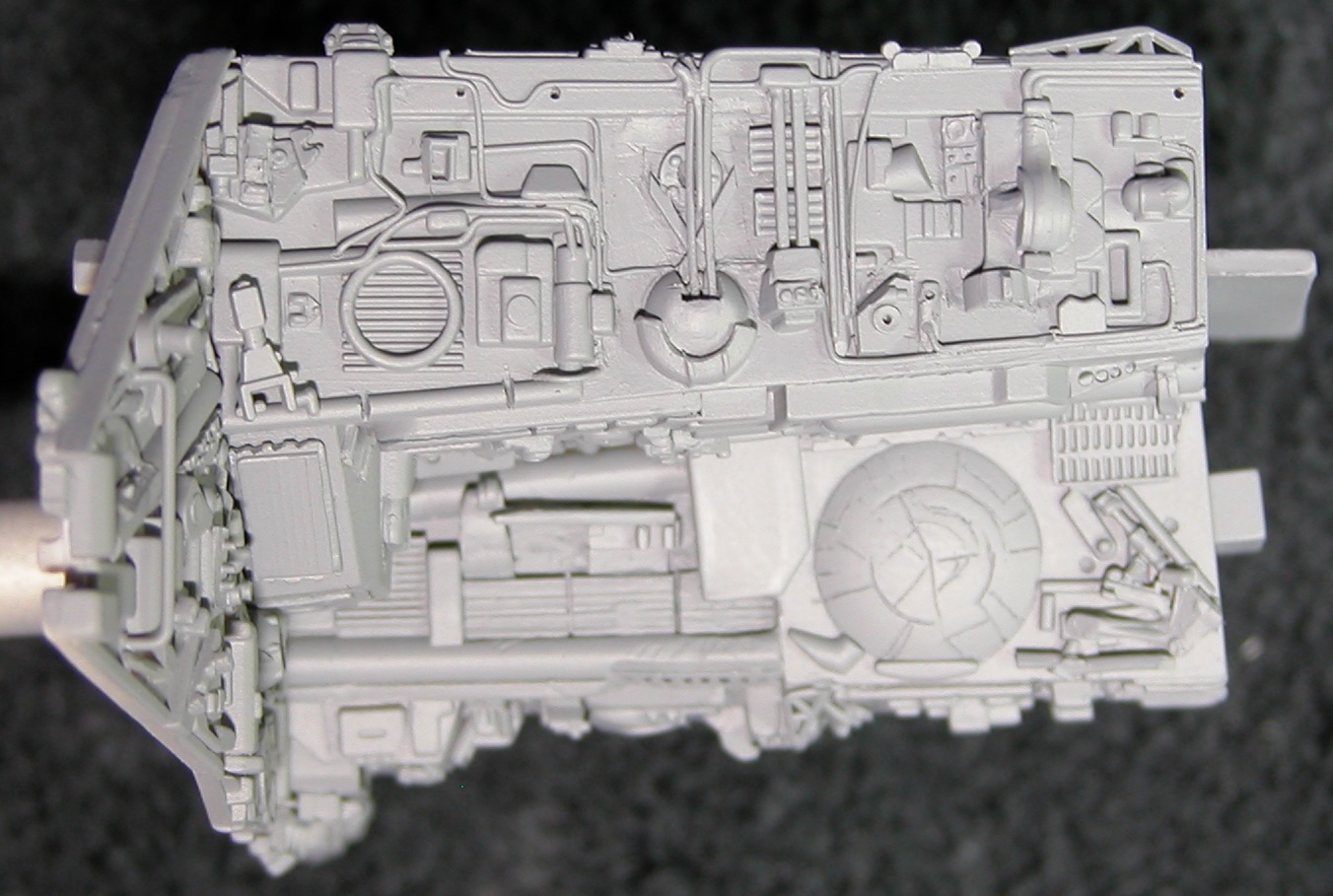

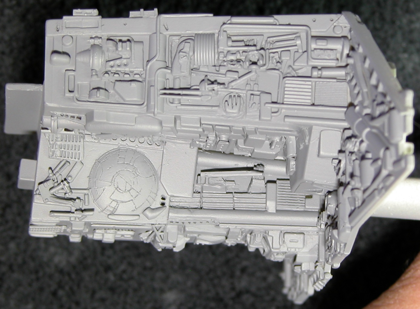

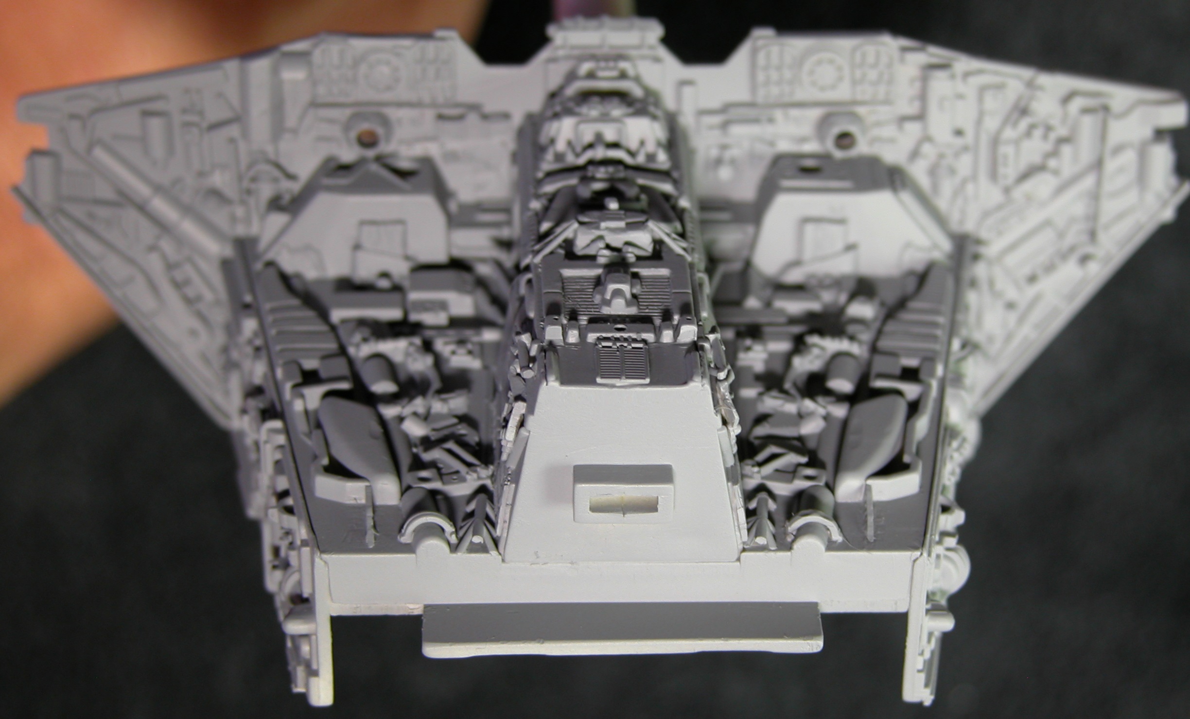

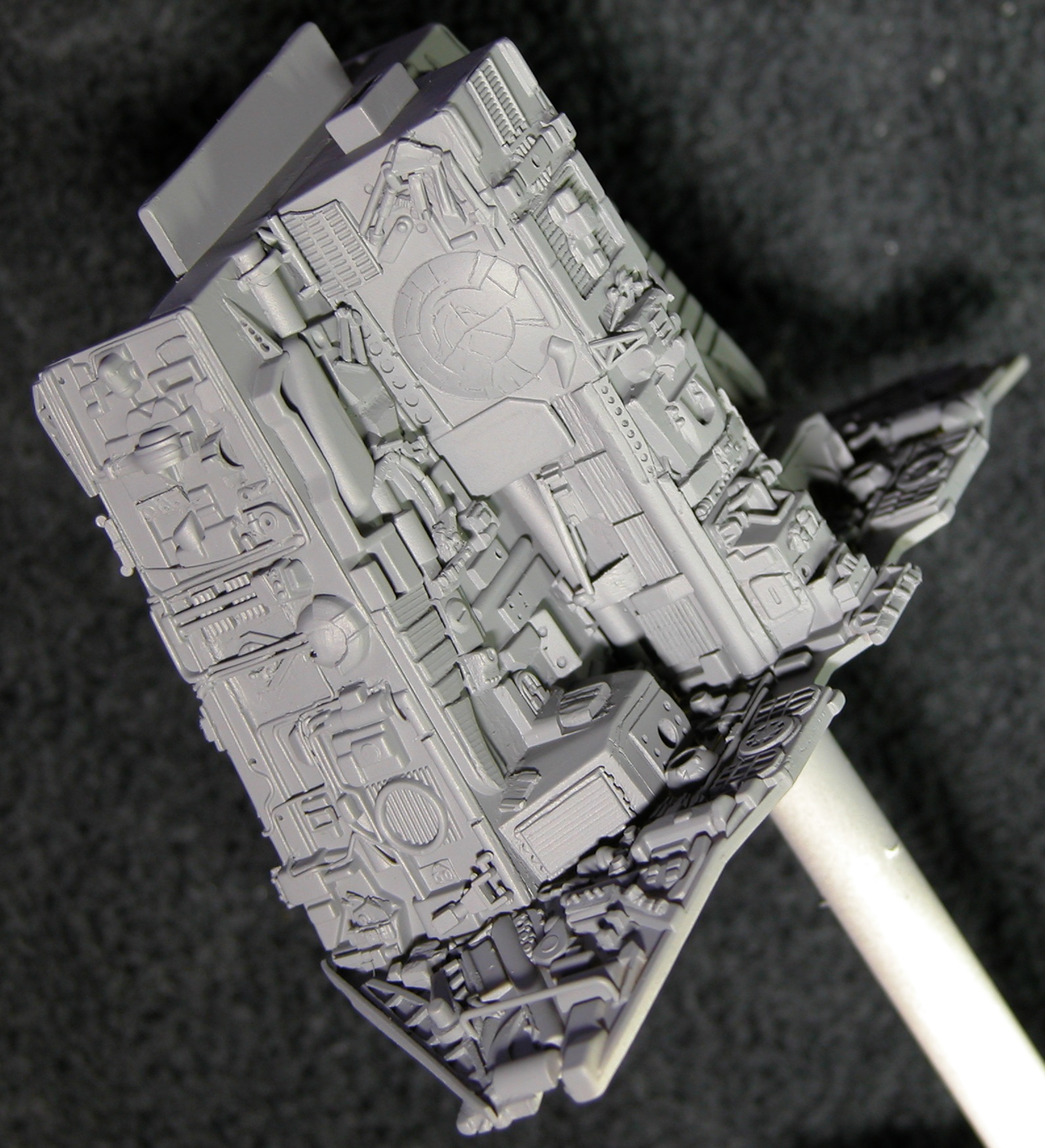

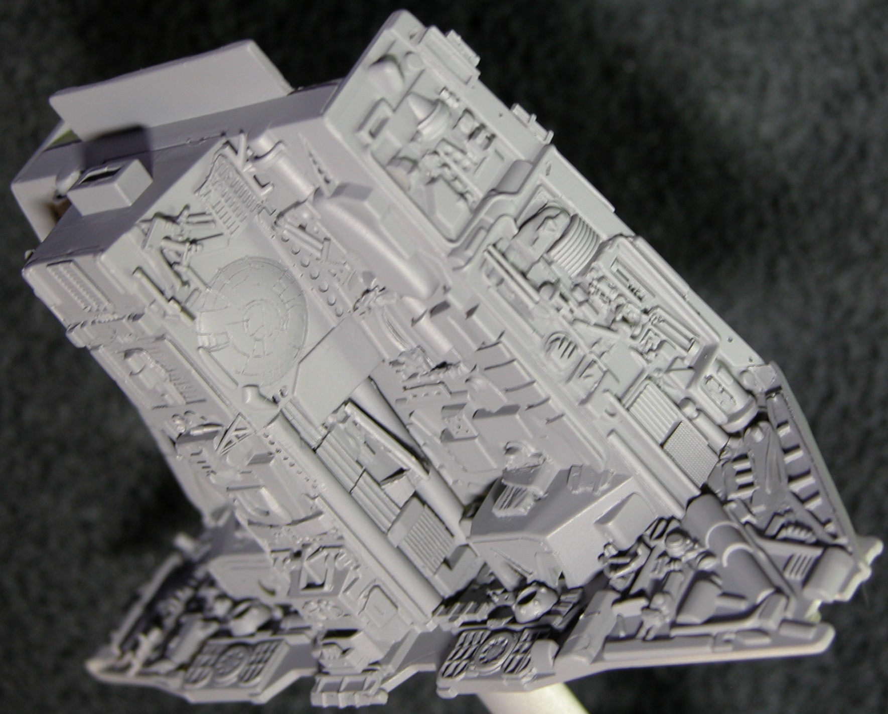

This update brings an answer I have told y'all I had a concern about for quite some time. I was thinking it would and I KNOW y'all woulda thought it was funny as hell if it had gone the way I figured it was. As I said, all these details are tiny. Very tiny in some cases as anyone with this kit knows. I have been concerned with whether or not primer would ruin some of this work, simply because of the itsy bitsy teentsy weensy tenitsy little small head of a pin parts.
I didn't tell y'all I had, what was suppose to be, an ace up my sleeve to help me prevent y'all from having that laugh. I picked up some "STYNYLREZ", gritted my tooth, loaded up the old Chinese air brush and squirted it towards this thing with my eyes closed 'cause I didn't want to see all the detail go away until I opened my eyes later. Slowly, I squinted and HEY!!! That went alright!!!
This was a mixture of 10ish parts STYNYLREZ GRAY and 1ish part Mr. Color 400 Leveling Thinner and it seems to have been an alright trial and error.
So far, after only about an hour curing time and no attempt to sand anything yet, I say STYNYLREZ is worth a try, if y'all been holding out.
Mr. Analyzer, this oughta push you even a little more! I think it looks just right and I have NO CONCERNS about the painting of any of it anymore.
