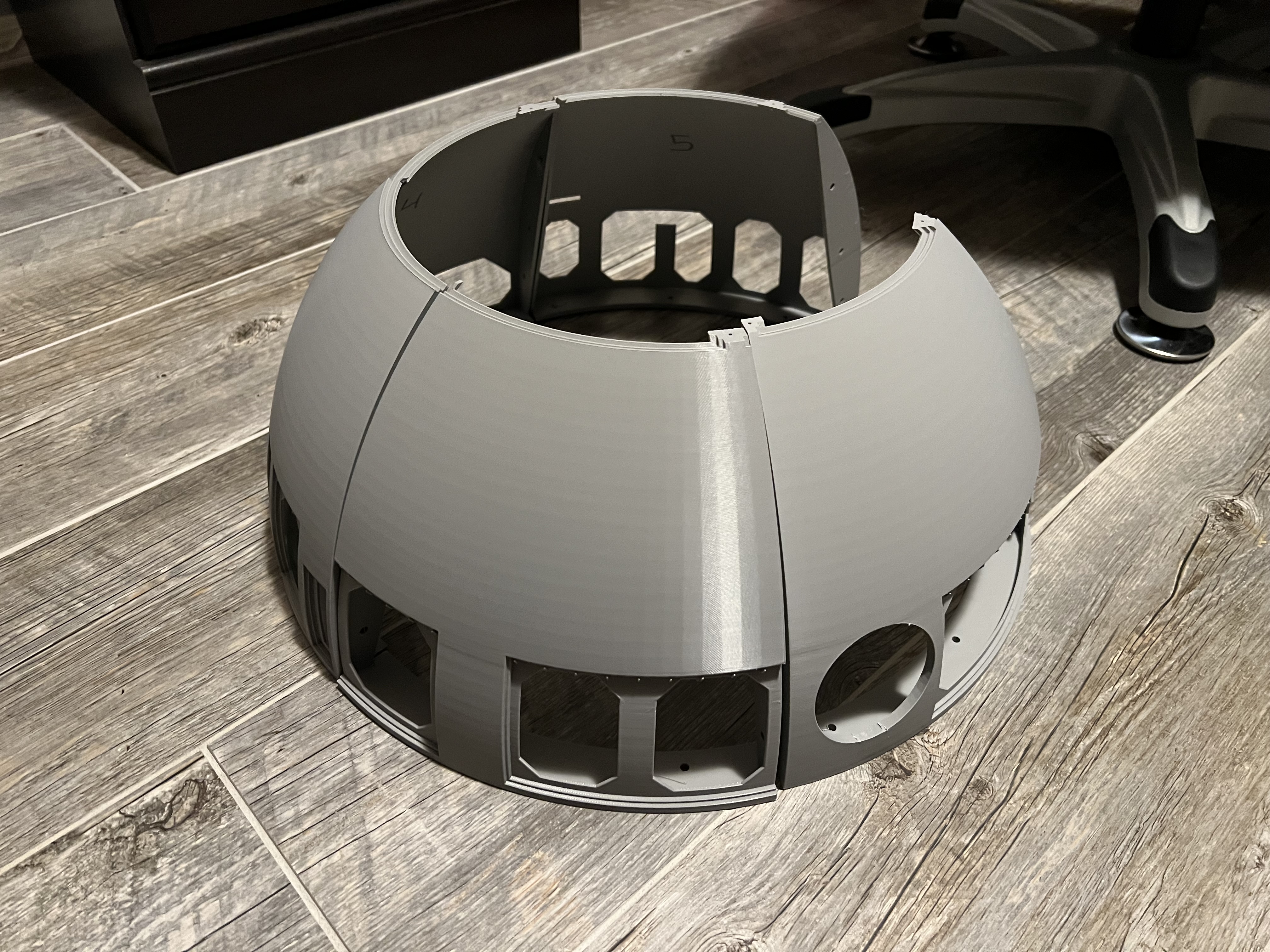

Now I'm going with Mr. Baddelley's R2-D2 files and they are amazing! I also upgraded to a new printer, a Bambu Labs A1, and it's awesome (despite the current recall which hasn't affected me).
I got to printing and now have the dome, dome rings, dome panels, dome greeblies, and main body done. I began assembly on the dome as I started printing the skirt, legs, and body panels. Really excited for this project, let's see how it turns out...........

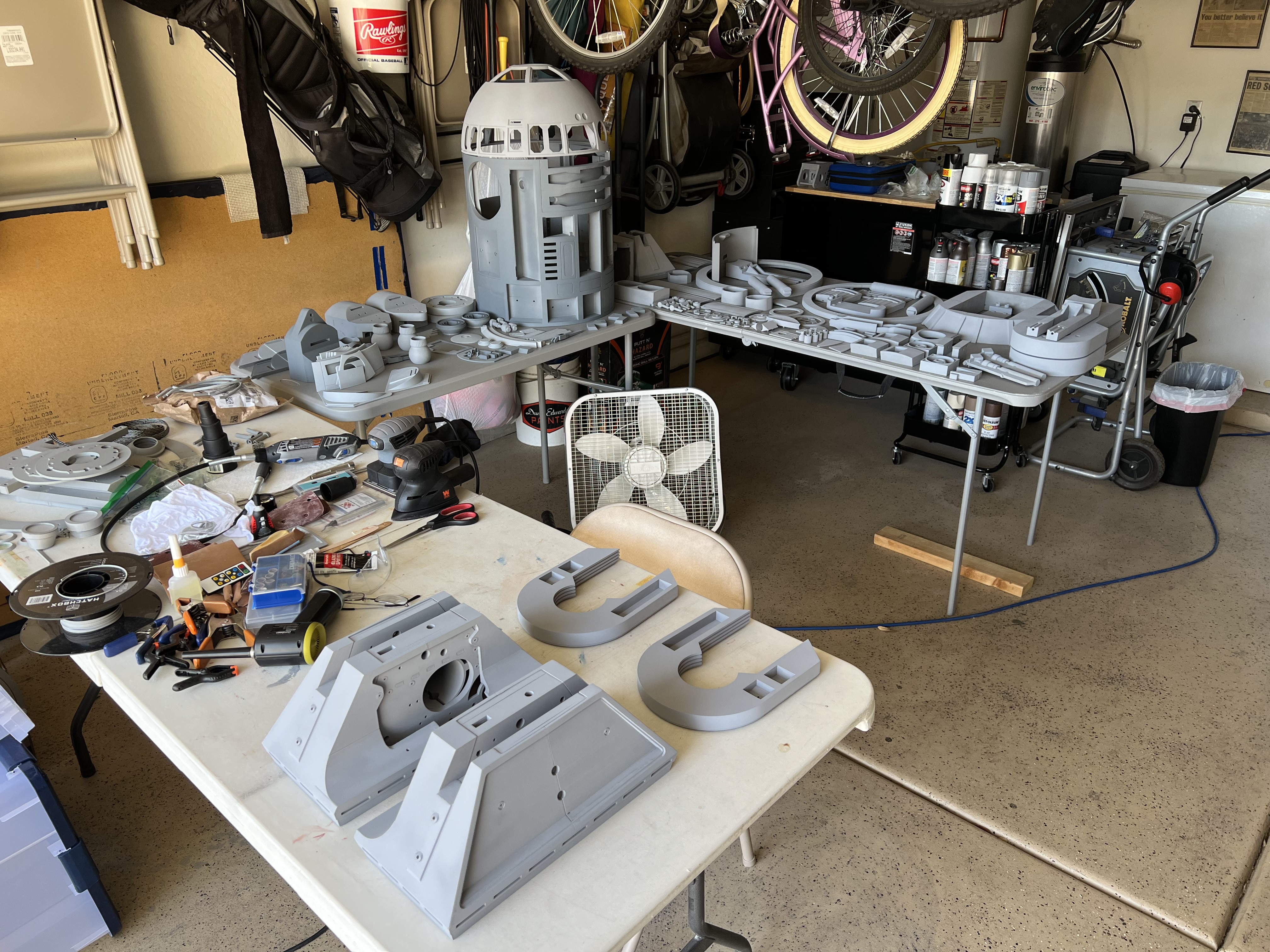

Well, as with any project like this, it's been slow going; sanding, bondo, more sanding, primer, more sanding, more bondo, etc, etc. I'm printing up the final leg greebles now and then all I have left are the feet and battery boxes. I finished printing most of the main leg parts and sanded those; real pleased with how they came out. I just need to bondo the seams, sand that, and then I can get those primed and sanded for paint. It'll be nice to get past this printing and sanding phase.
On a side note, this Bambu Labs A1 is a beast, been running this thing non-stop for two weeks and I've only had 3 failed prints, mostly my fault for how I placed the objects on the bed. I also love using Bambu Studios, still trying to navigate it since I've been using Cura for years, but it's great.
Anyways, slow and steady...........
Got a little sidetracked and lost some time on this project, but after a month, I've finally finished printing, sanding, bondoing, priming, and again sanding almost 400 pieces. I'm looking forward to putting some color on these pieces and assembling.
