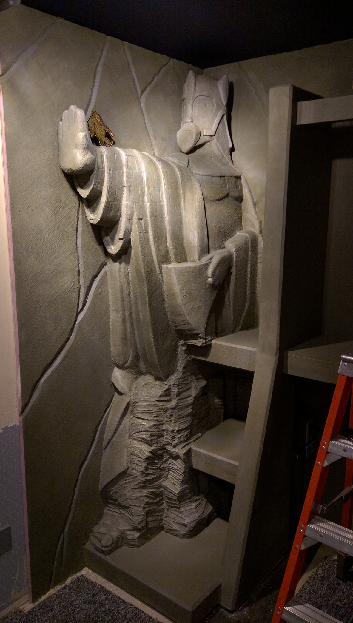

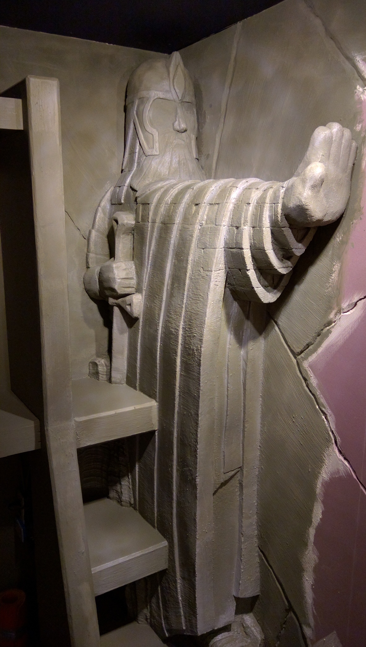

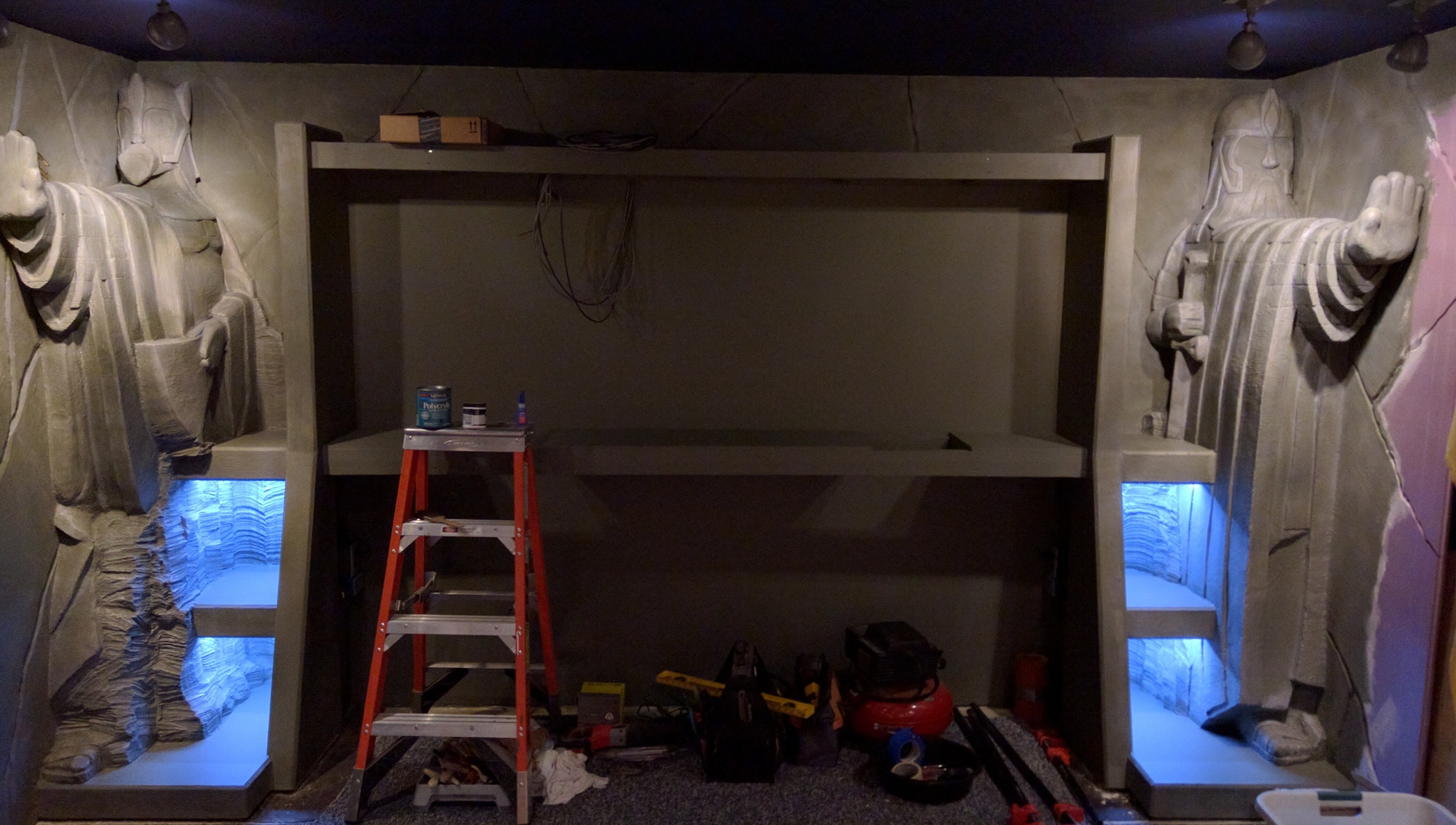

To begin my wife weathered both of the statues.
This is tough to capture with my camera, she
used 4 different shades of gray and green. She
dry brushed highlights all over them. It was her first
time doing anything of this nature, it looks amazing!

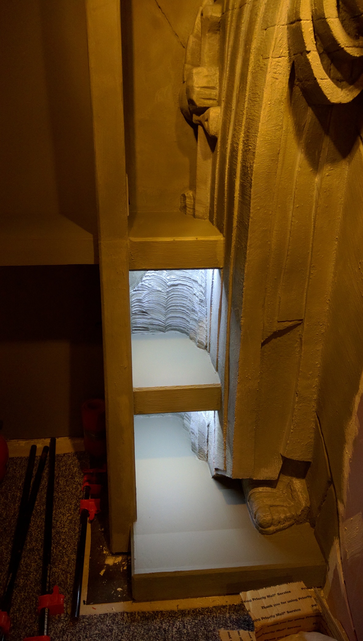

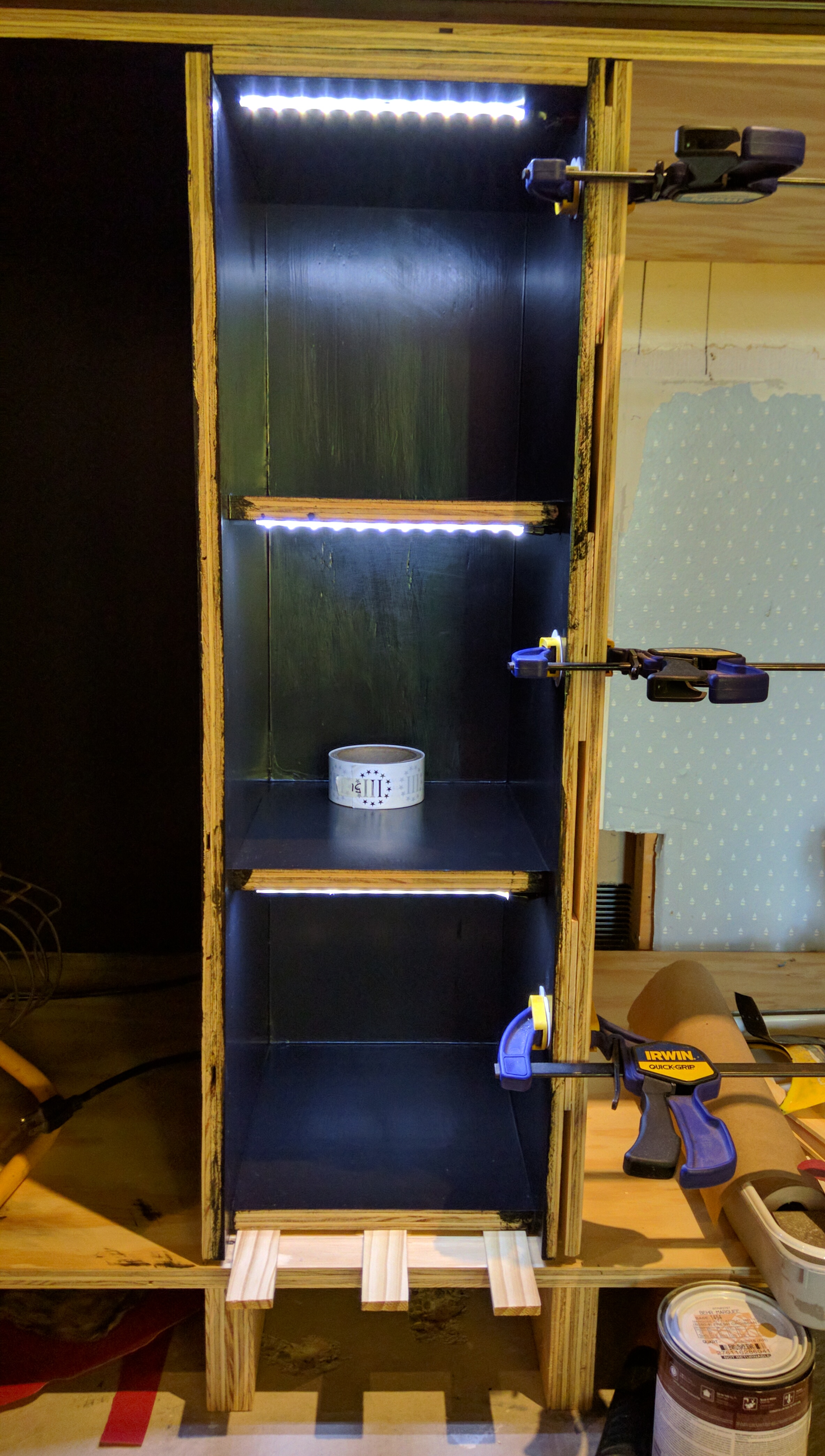

While she was doing that, I was doing this! I wired
leds into all of the shelves of the statues. This should
illuminate the props very nicely! I bought about 32 feet
of leds and soldered wires to them all to run in parallel.
This is the same leds I will use for the candy shelves.
Here are the views of the lights all lite up... They are way
less blue in person, they match very nicely to the statues.

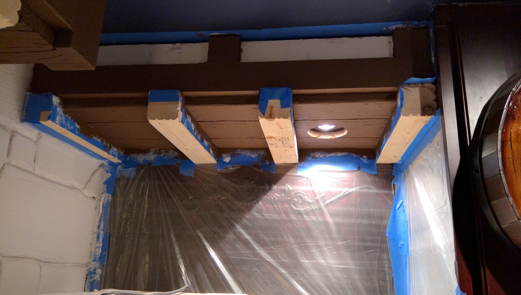

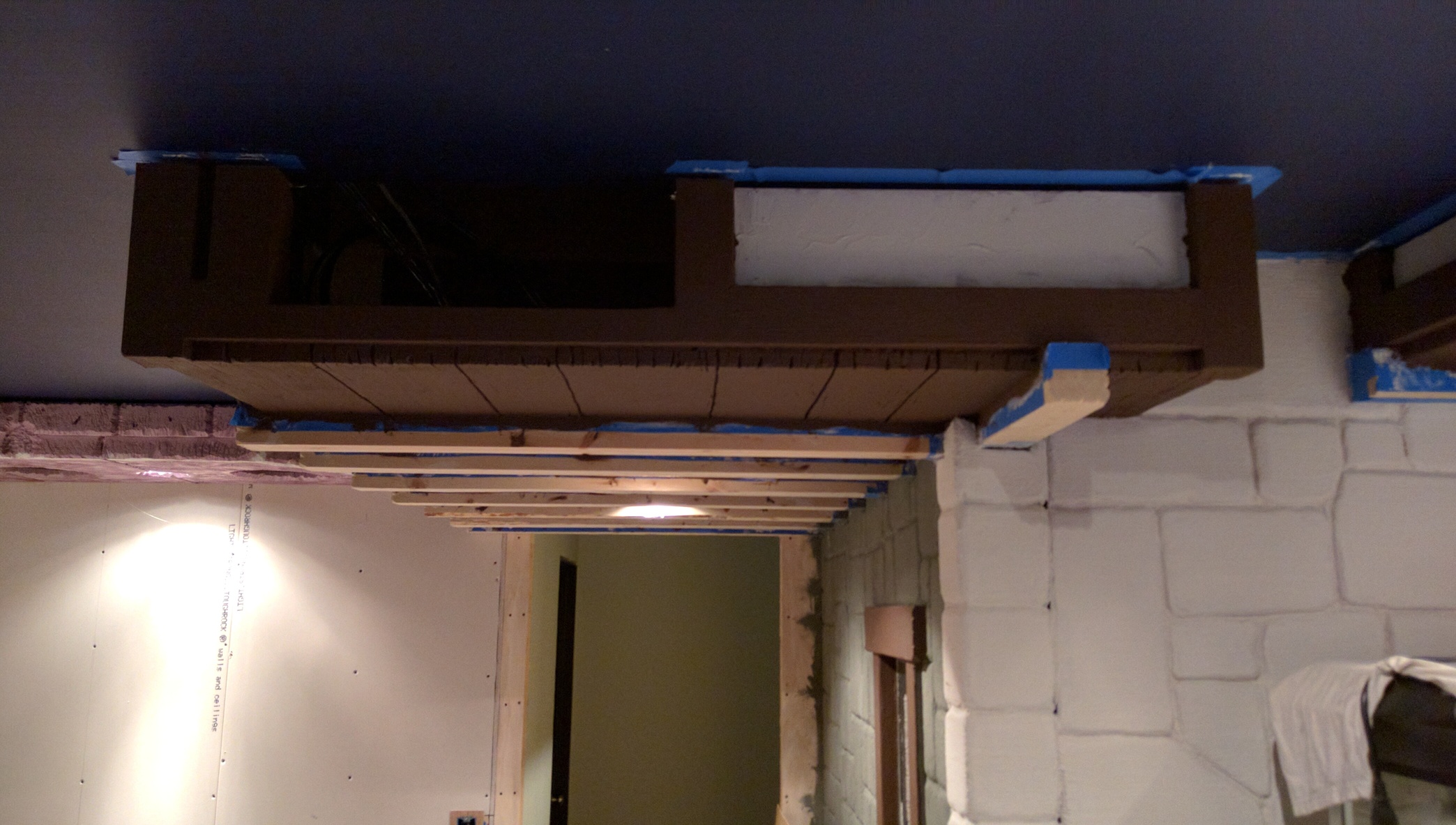

Then we began painting the underside of the soffits. They
will be this brown for a base, and then weathered with
darker browns and blacks.
More views of the other soffits. The beams will be a lighter beige for
contrast.

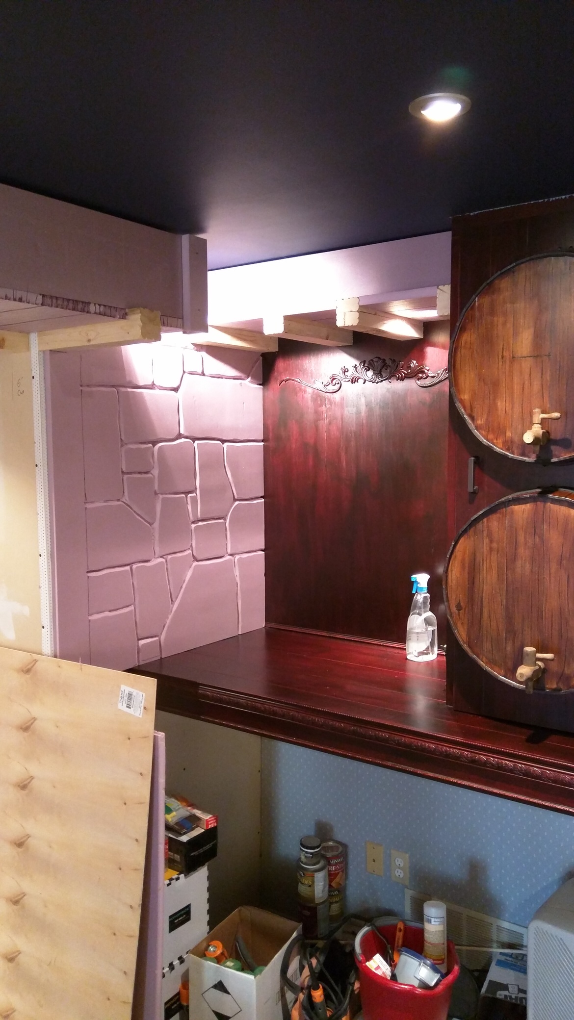

Other news, I have been struggling with this red in the
concession area. My wife and I decided to switch it to
Classic Black Polyshades. I will hopefully be doing this
within the next few days!

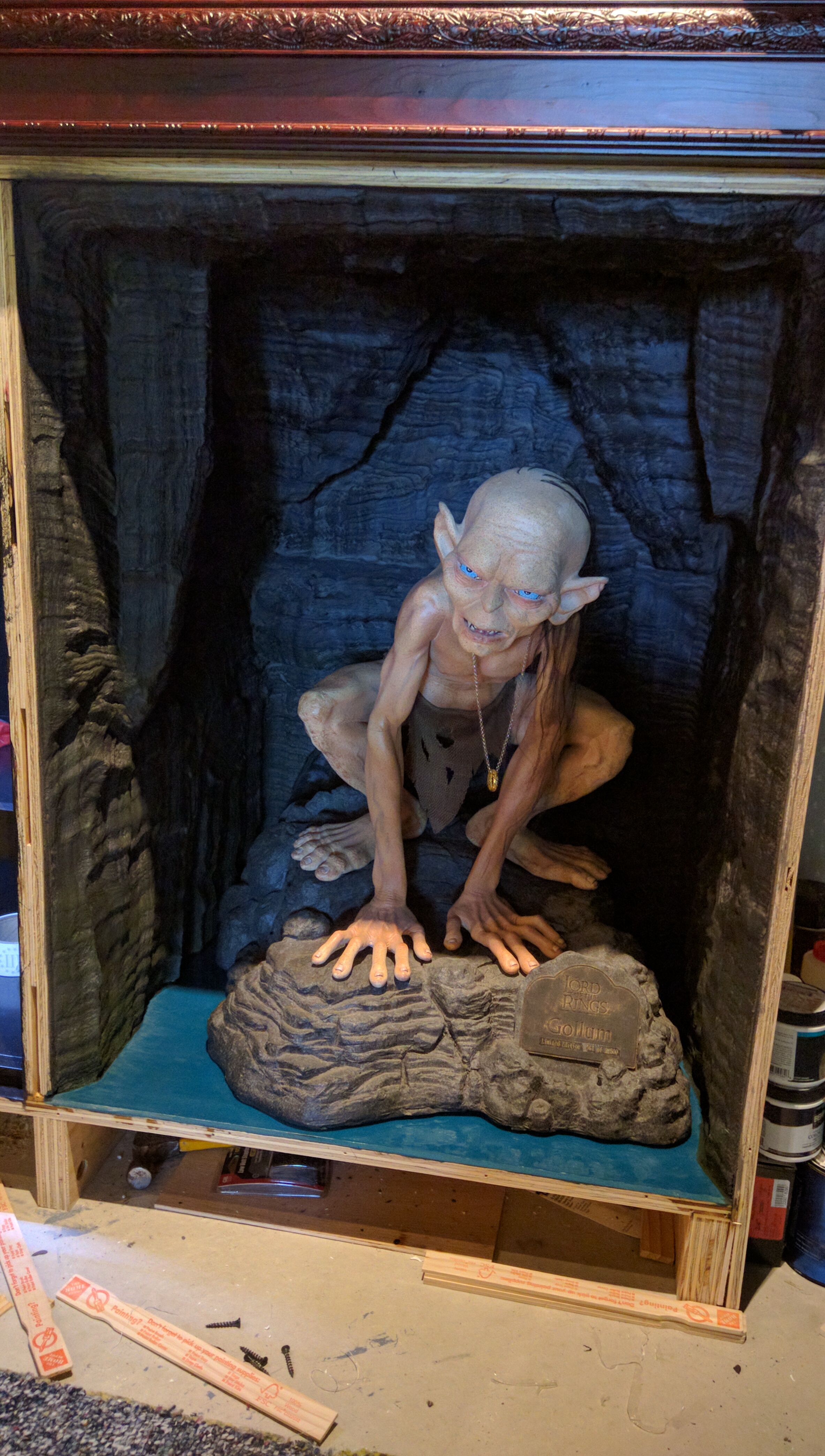

Every house needs a Gollum !!
Just to remind you not to be quite so evil in how you treat other people. ;)

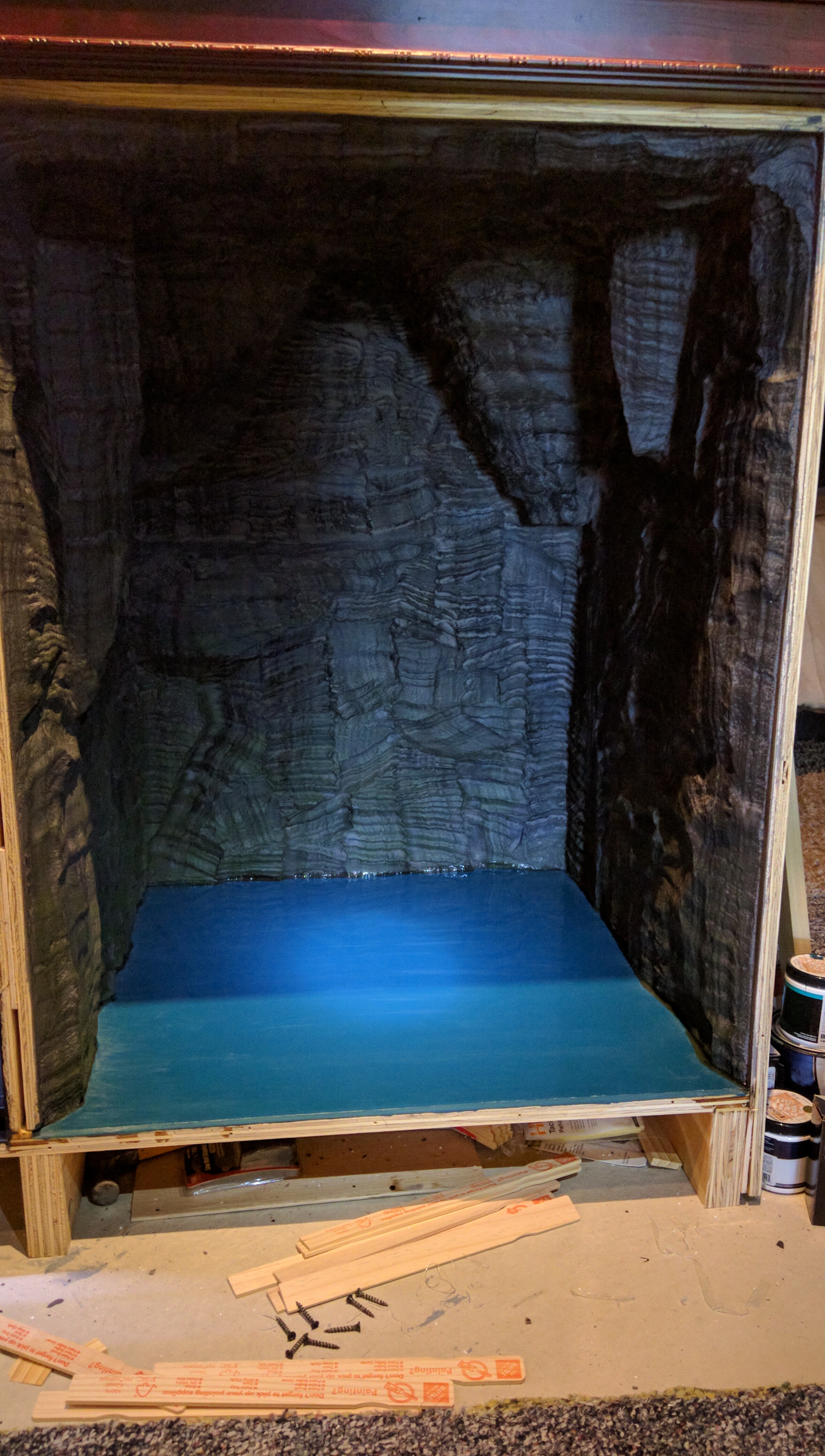

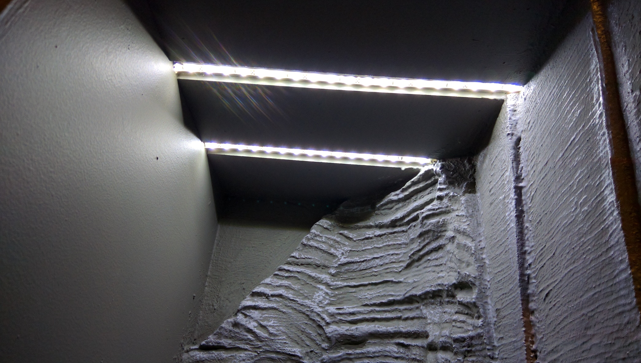

So a bit of explanation. The first picture is kinda the latest one. This is Gollum being lit by hidden LEDs in the trim work. The second one with Gollum is only with ambient light. The third is the cave without Gollum. It was carved from foam, hard coated, then painted and weathered. We then poured resin epoxy over the bottom to simulate water, the effect of much cooler in person! The final is the candy shelf lit by what will be hidden LEDs. Thank a ton for all the compliments everyone!

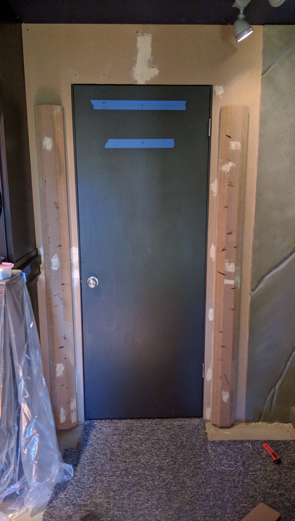

As I have stated before, this has been in the works for almost 2 years! My family and I are more than ready to wrap this up, and with the progress I've made this year thanks to getting to work on it during my work season, I believe we'll be watching movies this December! Today's update is the wall leading to the master bedroom. We decided to make the bedroom door, a recreation of the Doors of Durin.

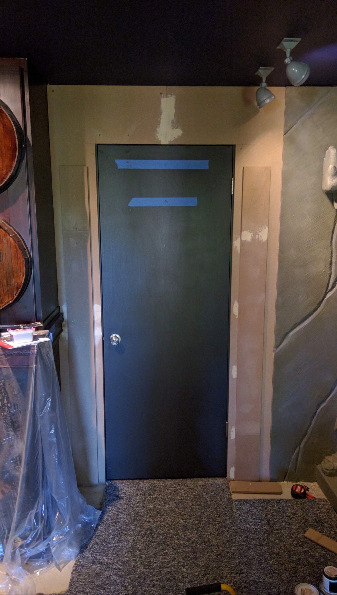

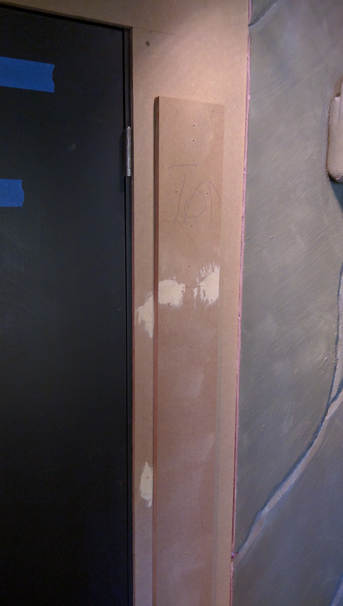

This is the section of wall. As of this point all I've done is install a MDF base to the drywall for both soundproofing and an attachment point for the rest of the items for the wall. And I have attached the bases of the columns that will surround the door. The door that is pictured is not the final door, I ordered 2 smaller doors so that it can open outwards like it does in the book/movie.
Here is a closer view of the same thing. The columns I built were 4 pieces of 3/4 MDF glued together, so to securely attach them to the wall I left the very last piece unglued, just screwed, while I cut and shaped the columns so I could remove it, glue and screw it to the wall. Then I could attach the rest of the column to that base with glue and screws.

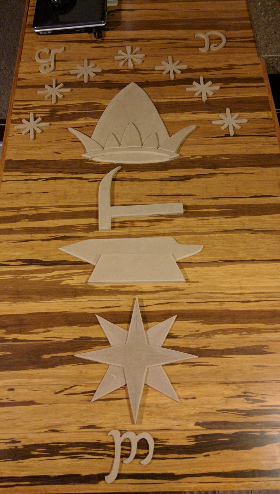

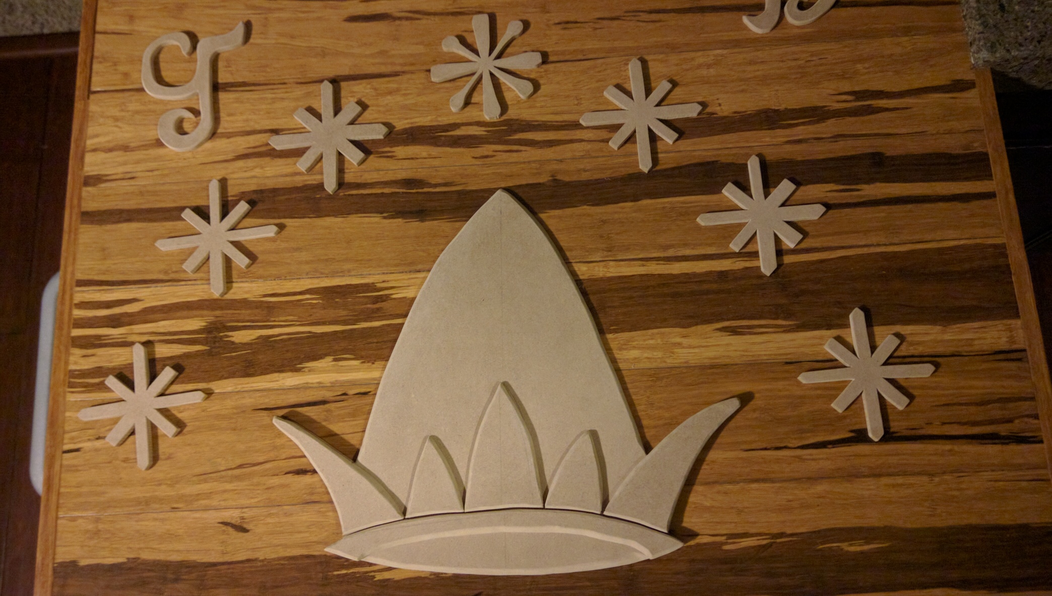

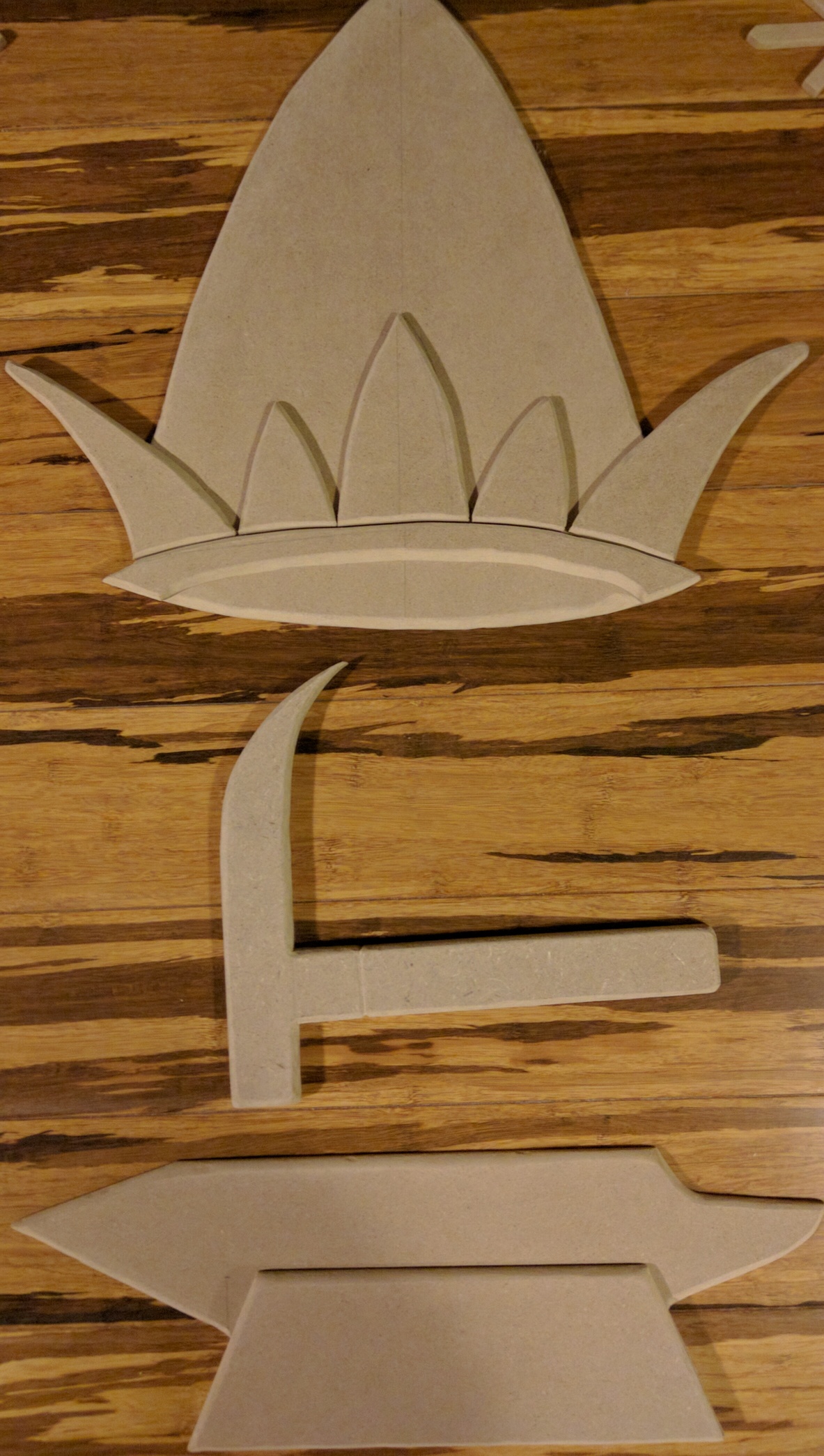

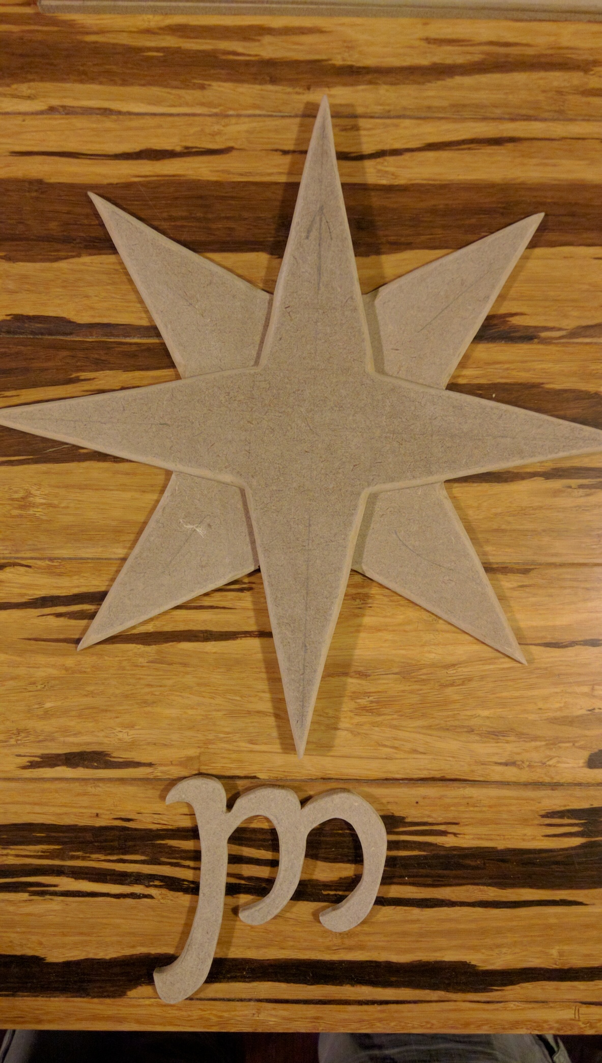

This is the carvings that are placed all over the doors. I used 1/4 MDF and cut and sanded it to get the look I wanted. These will be cut in half and placed on both sides of the doors when they arrive.
This is a rough setup of what it will all look like as one piece on the doors.

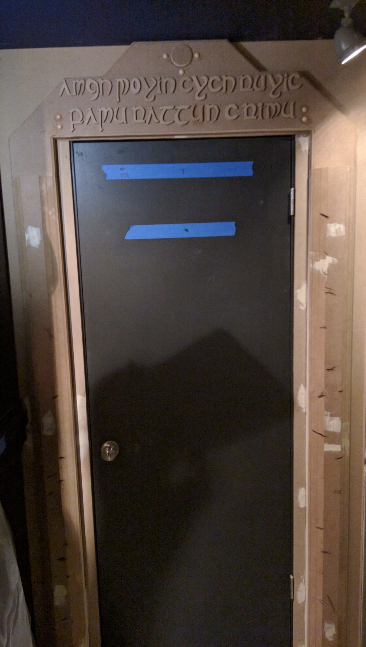

This is the archway for the doors. Not exactly movie accurate but I have had to change things slightly to fit the space better. I feel like it fits beautifully into the theme and my family is happy with it so it works! The letters were all cut from 1/4 MDF by my wonderful wife! She spent all told, probably 7 or 8 hours cutting and sanding every letter here! I chose to not go with the entire inscription found on the actual archway but instead choose "Door of Durin, Lord of Moria, Speak Friend and Enter" The part I decided not to include was basically just Durin giving credit to himself and another for writing and carving the inscription. Since it wouldn't all fit, and actually my wife and I wrote and carved it, it felt right. Other than that this is the actual lettering found on the arch. The arch itself is just 2 pieces of 3/4 MDF glued, screwed, sanded and routed to shape.
This is the arch on top of the pillars. I still need to build out the bases and tops of the columns to look right. Then install the doors when they arrive. Install the carvings to the doors. Then hard coat and paint the entire section. Once finished with the stone look, I will outline all the parts with a glow in the dark paint or something, so that when I turn the lights off, it will all faintly glow for a bit.
