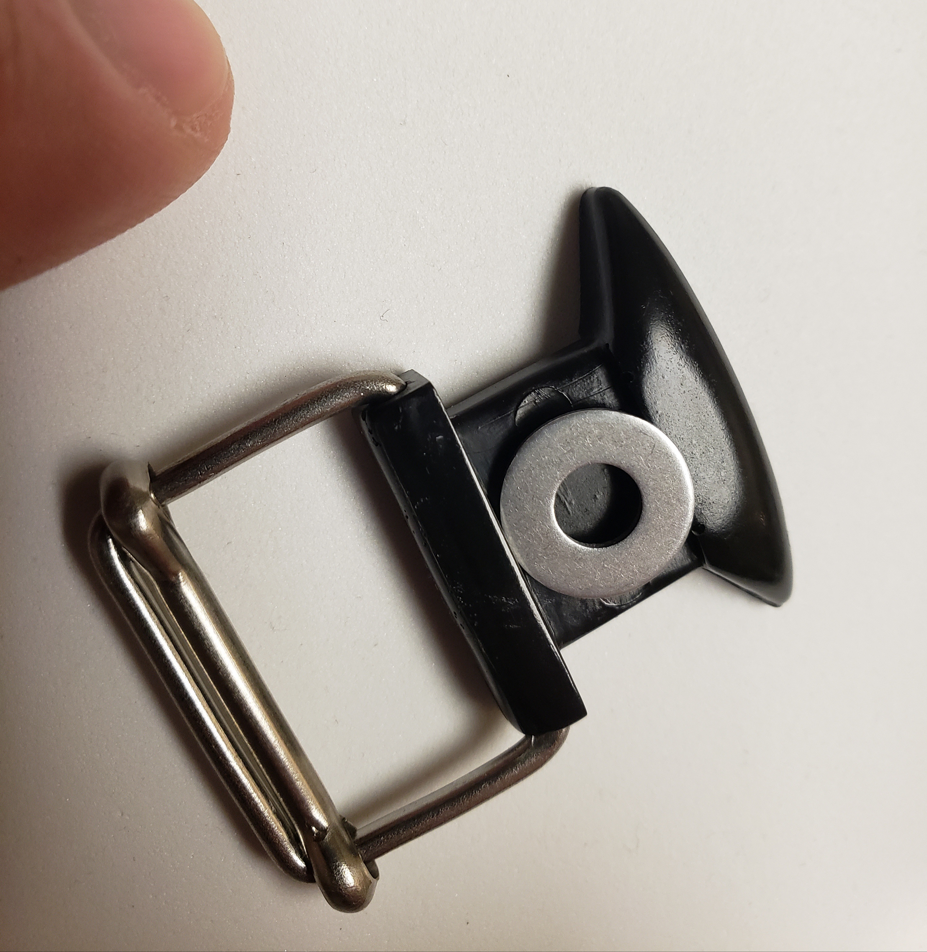

The correct washers for these were difficult for me to find. They're 1/2 inch OD x 1/8 inch ID aluminum. The rivets I used are 1/16in - 1/8in grip range. I always thought the washers on this part looked like the sides were filed down. They definitely are or at least that's what I believe. There's no way the washers fit in that space otherwise.
The washer in this picture is the correct outside diameter but the inside diameter needs to be 1/8 inch. This is just an example to show it doesn't fit unless you file down the sides.

Hey everyone I've been casting these things and I wanted to point out something you'll probably notice when you get your casts. One of the points on the piece is more pointed than the other. So when they're mounted they won't be semetrical. I thought I would need to cast the left and the right piece but they're both shaped the exact same. Here's photos of both the left and right (real) pieces together. Might be more noticeable in person. The one without the D-ring is the one I've been casting. Its the better looking one of the two.
They look awesome
What thickness are the d rings? mine that were bought separately and didn’t come with the strap/mask look much thicker, I may need to find new ones to fit
Or make some with stainless wire and a split pin?
They look awesome
