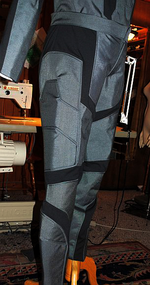

Next, I needed to move on to the pants. The patterns for the pants were made in the same manner as the top. I created a base pattern in muslin, measured and added in some darts and shaping to make them more sculptural and form fitting, drew on the new seam lines, cut it all apart and transferred the new patterns to paper.
The thigh and the outer calf areas were constructed in the same manner as the arms and chest. The individual pieces were lined with the headliner foam and stitched together. Then the stretch areas were added in. For ease of wear and to keep the bulk down, the center front, center back and knee/inner calf areas were not padded. Here are pictures of the upper leg and lower leg sections laid out flat during construction.
Here are the pants mostly completed. There are a few alterations to make and they can be hemmed and finished.
