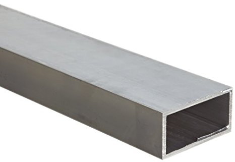

Crazy idea, what if they just took rectangular tube stock and cut a slot down the middle?
and maybe fabricated a rectangular countersunk washer that fit inside?

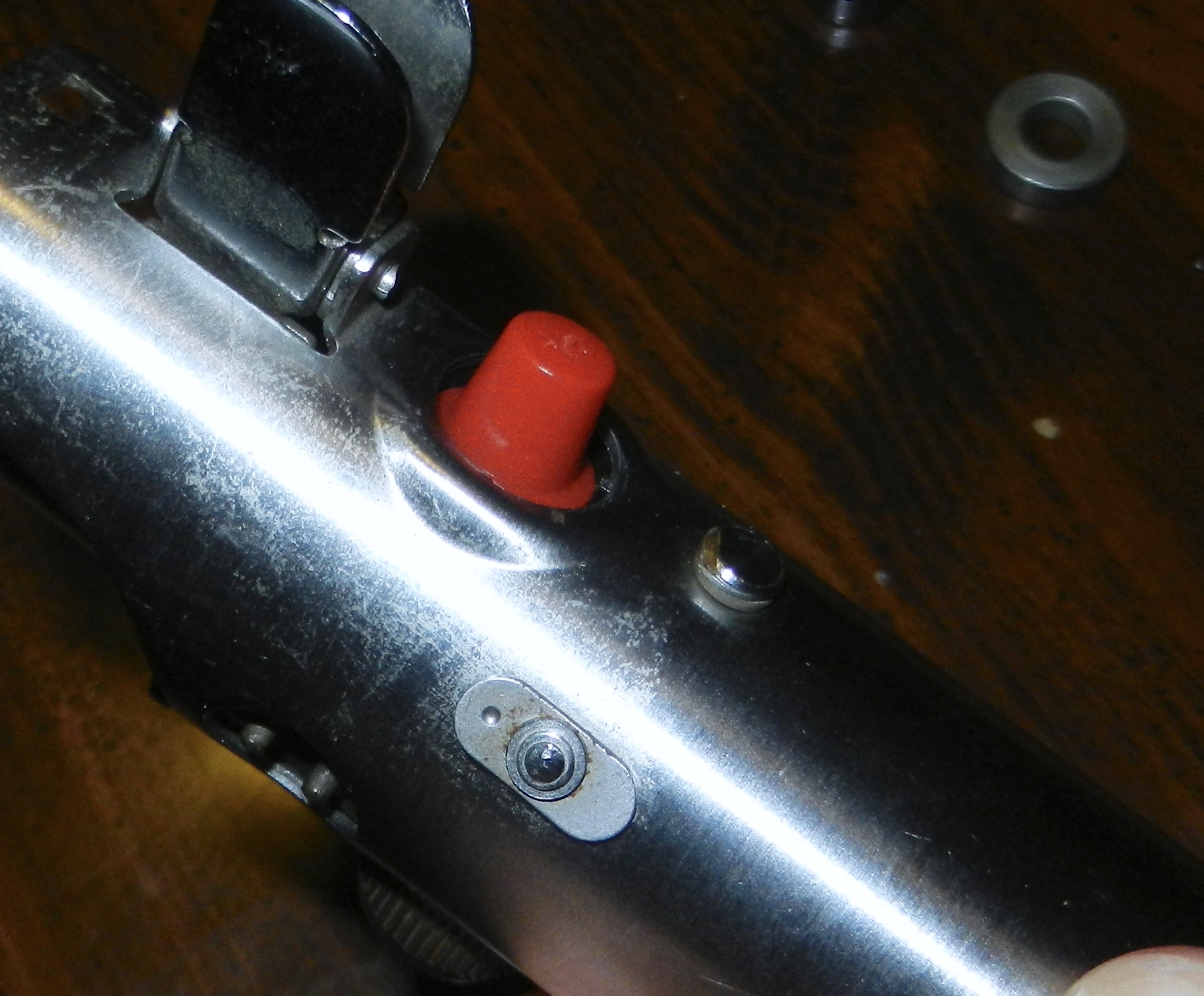

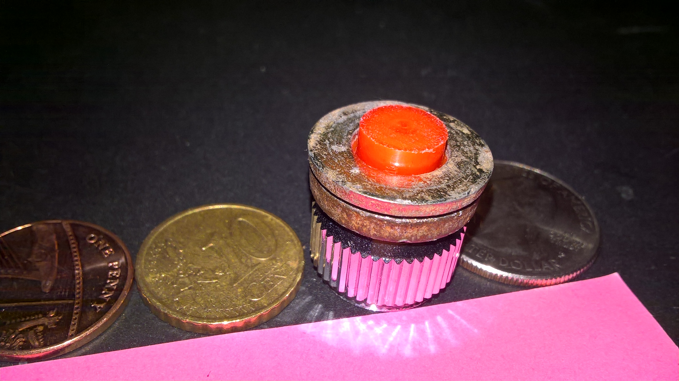

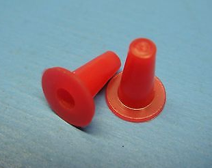

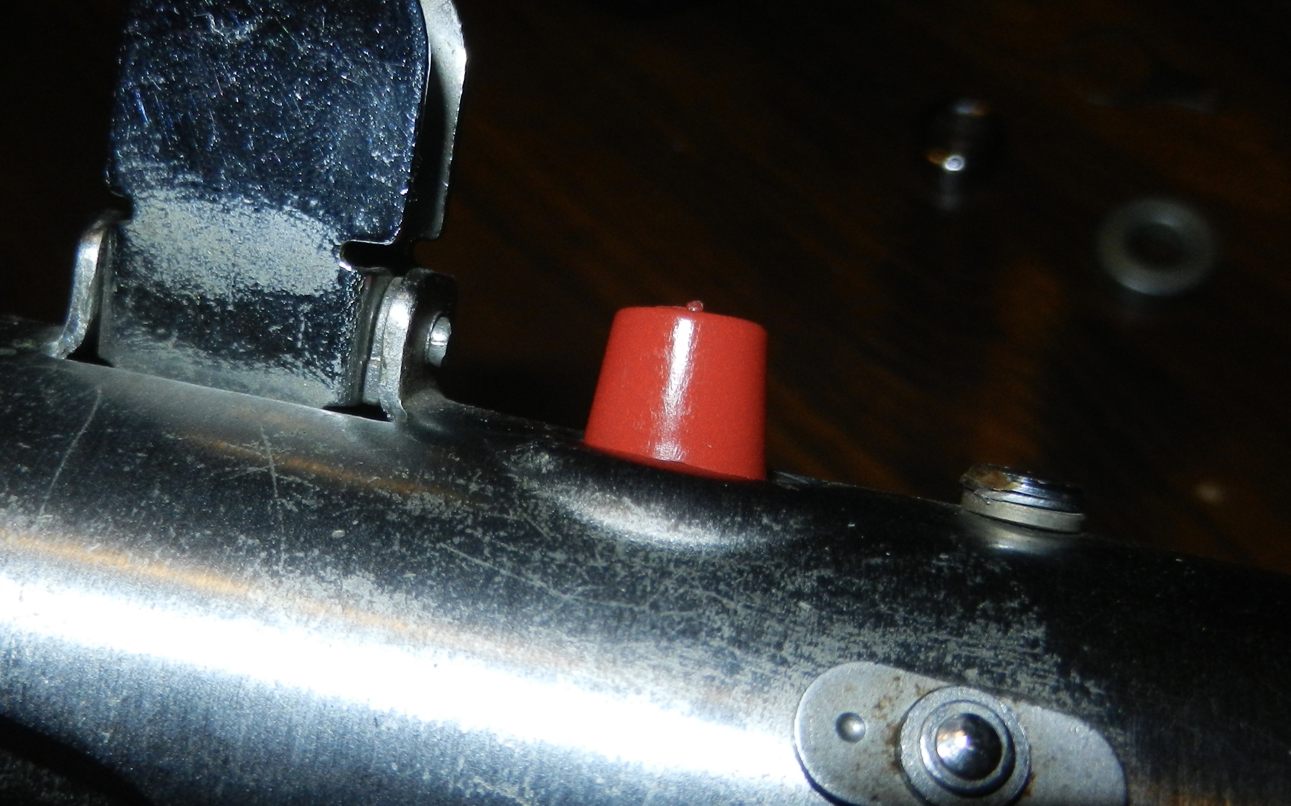

There are regular tapered cap plugs, however there are also these. what if we're looking at a conical one with a flat top, and the base is the washer beneath the steel ring?Screen Shot 2016-12-23 at 1.46.28 PM.png
I took a snap of the pen base. Another thought; If it was glued in place and a crystalline fog was left from smudged glue (hate when that happens), it could have been sanded off leaving the finish we see on the top edge.

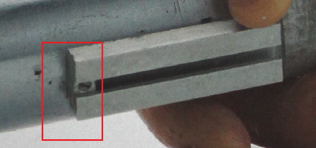

Youre right, originally I thought the nut and box may be one piece. I tried making one but it was pretty difficult.
Making the T track is pretty easy, Im going to make a few sizes then see what looks best.
Now that you mention a sliding nut that gives me another idea :)
I only see the one part box, and a sliding nut in the channel?

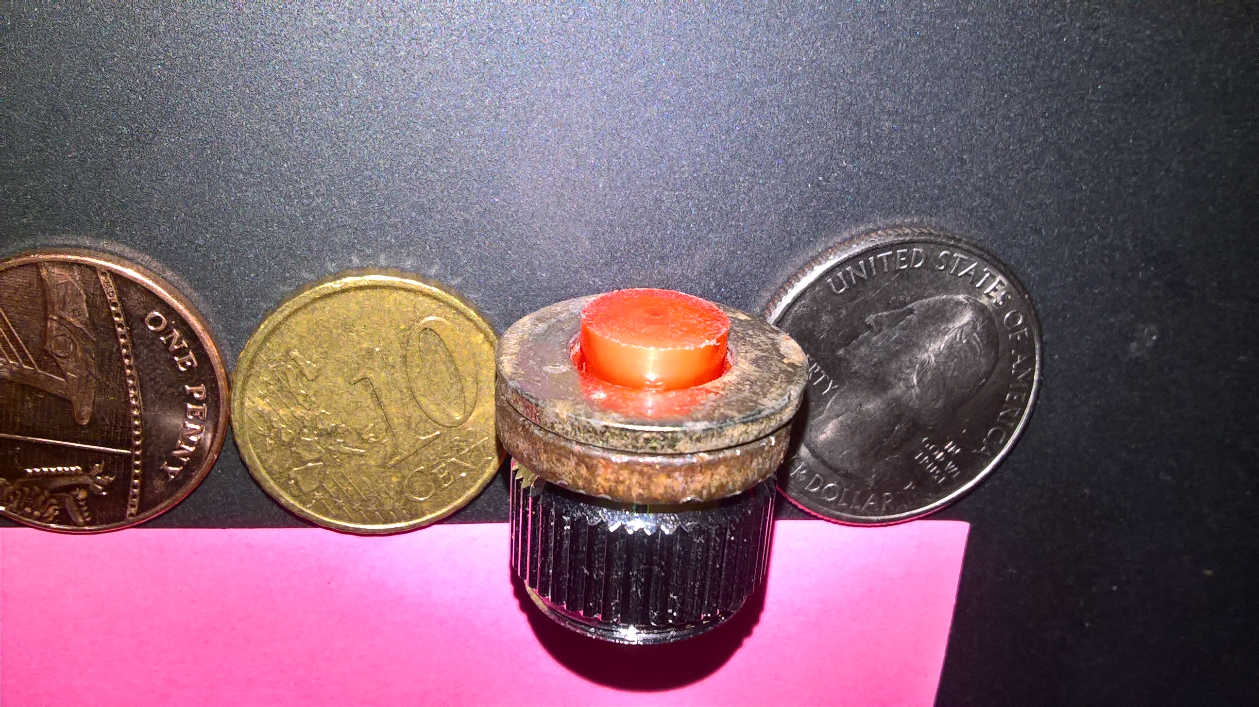

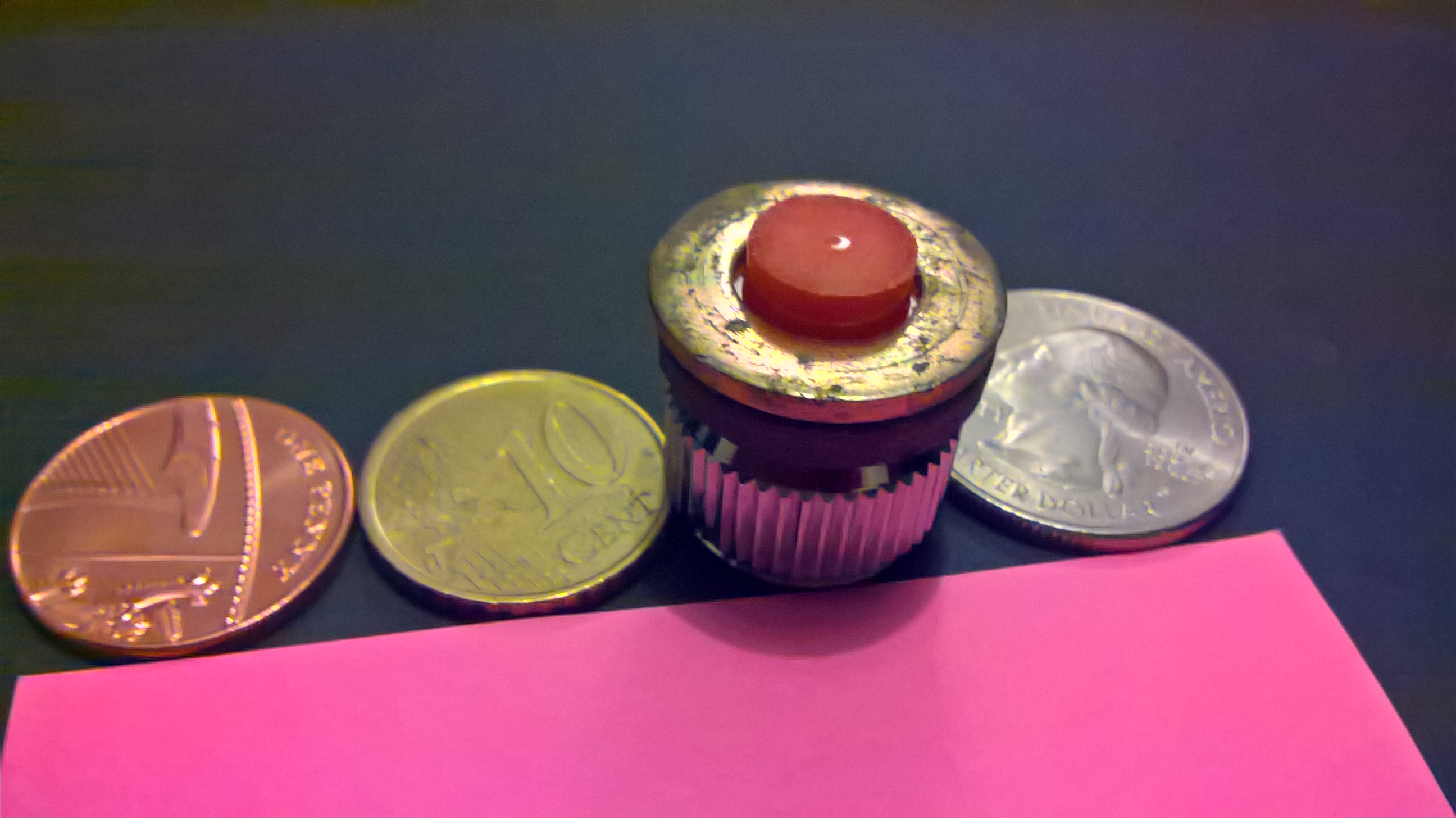

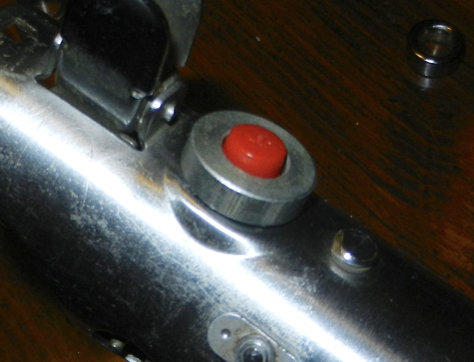

So - I may have found something cool.

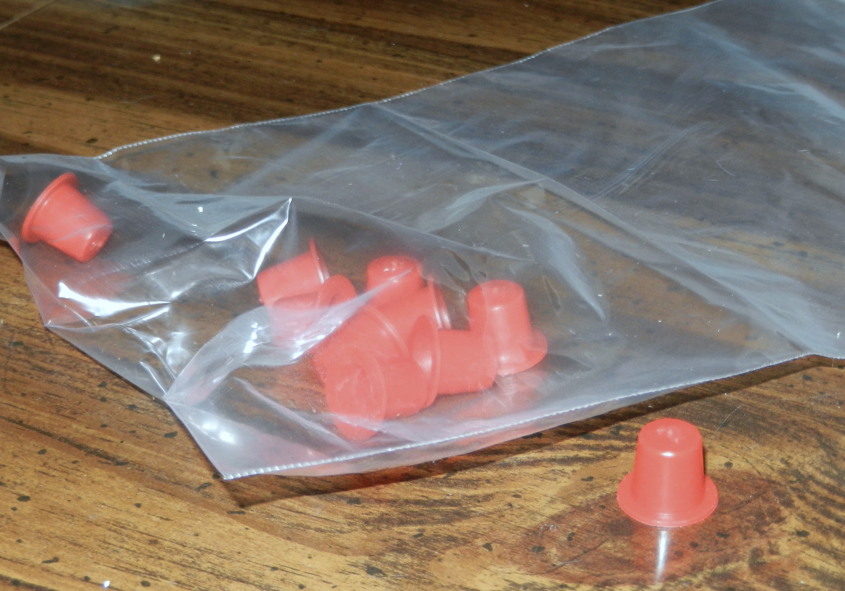

I dug through some american caplug sales things. (Some are used to plug test tubes, so I think these are meant to be used upside down) The tapered shape seems legit to me, that doesn't look like a straight cylinder on the real prop.

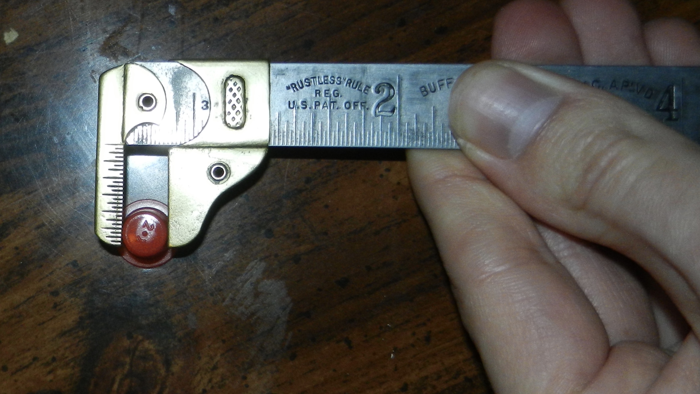

Anyway - Kurtyboy had originally deduced just under 8mm for the diameter of the red button. 7.9 mm is 5/16 in the US, and I found one with a 5/16 top (or bottom, however you look at it.)
Originally I thought it was too short - however that is because my Larbel socket has no pins in it. I dropped it in there and it was barely over the rim.

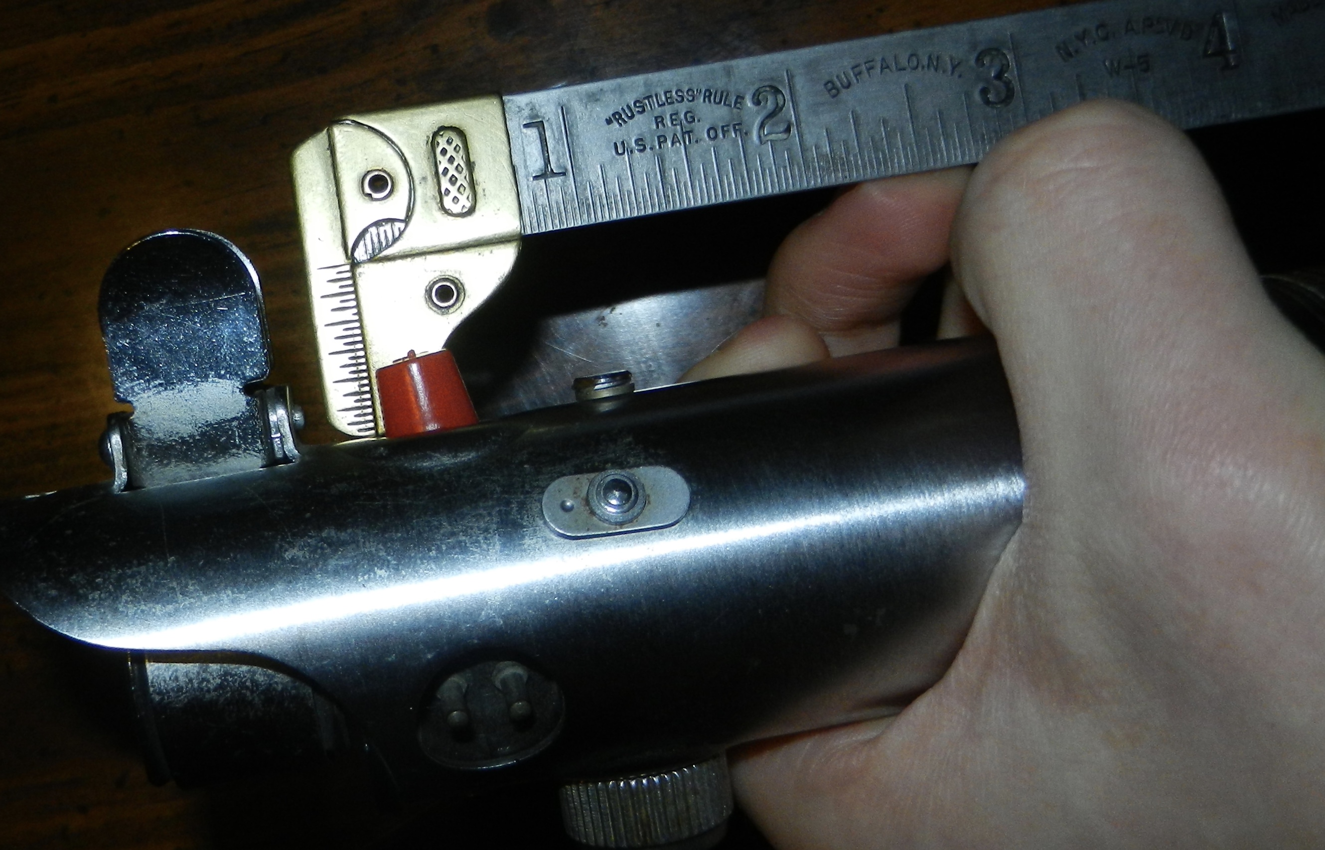

The original Graflex pins are the key here - if you squish the conical plug onto the pins it will sit rather tight and slightly at an angle just like the photos we've seen! You can't push a cylindrical button of that diameter around the pins, it would have to be really short. Also, this has a flange which helps keep it from falling out if the spacer is glued down.
Also, Kurtboy had measured 5-6 mm for the height of the mystery metal spacer. When this is stuck on the pins, it sits 5-6mm above the rim of the graflex! Mine just has "2 X" written on top....I bet I can sand it off, but I wonder if there are any without any writing on them.

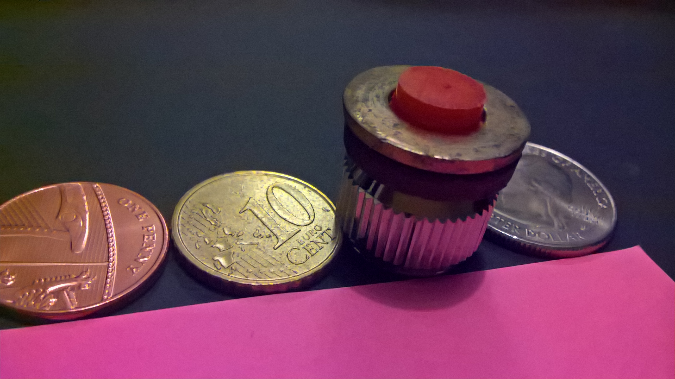

here are pictures, including one with an incorrect spacer - just a tad too short, it's 3-4 mm thick.

I noticed the red button sits a bit above the metal spacer, and without squishing it down, these caps sit that high as well.
