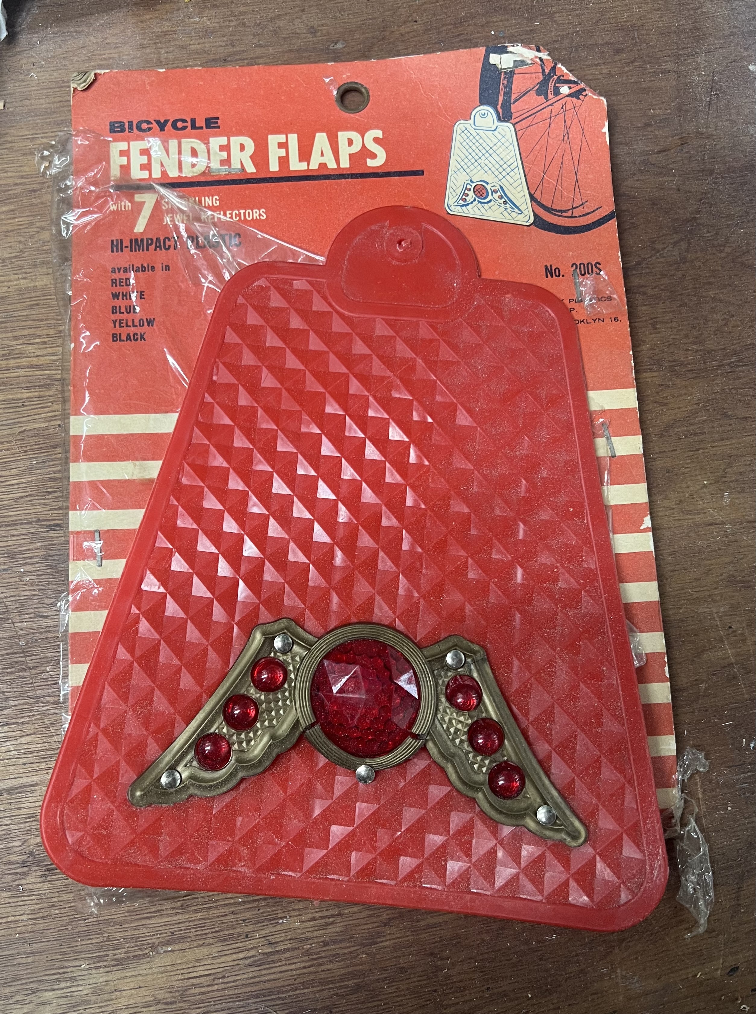

Out of curiosity, are the 'fender flaps' never showing up on eBay or am I just missing them? I have had a saved search for these things for like 5 - 10 years and only seen the right ones (wrong color) show up maybe once at the beginning. Even if they're rare, it seems like these things should have hit a little more frequently than that.
I happened across one in a local antique store locally, but I’ve never seen any pop up on eBay. If you get your hands on a real one you’ll see why..the plastic is really bad and they are quite cheap. I’d have to imagine they weren’t very popular. I’ll ask Charlie from the Pedal Pusher shop (who built the bikes for the film) why those were used and report back. I imagine the shop was able to buy a large quantity cheaply from a distributor (notice there’s no grey color listed)..you’d need 28 flaps to outfit all 14 bikes made for the film

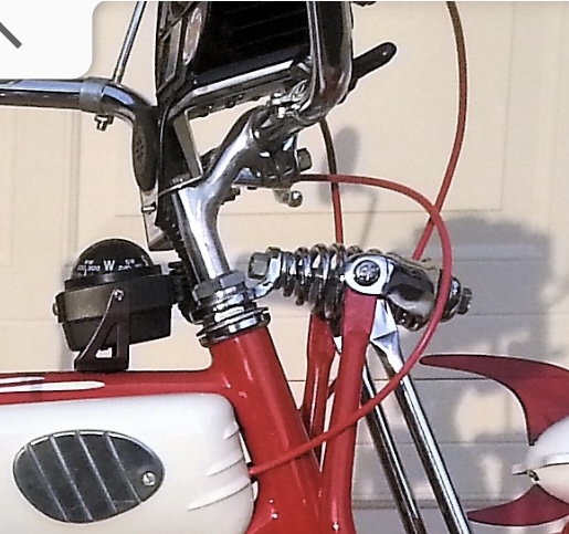

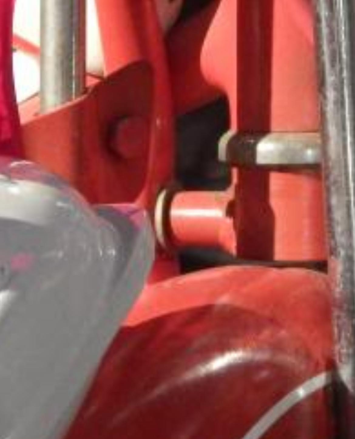

Screen used bikes you a generic (I think Joy Tech) front hub. I’ve seen extra washers used on screen bikes between the crown and legs..presumably to space the legs out a bit. I’ve done this and it helps. See pic of screen used

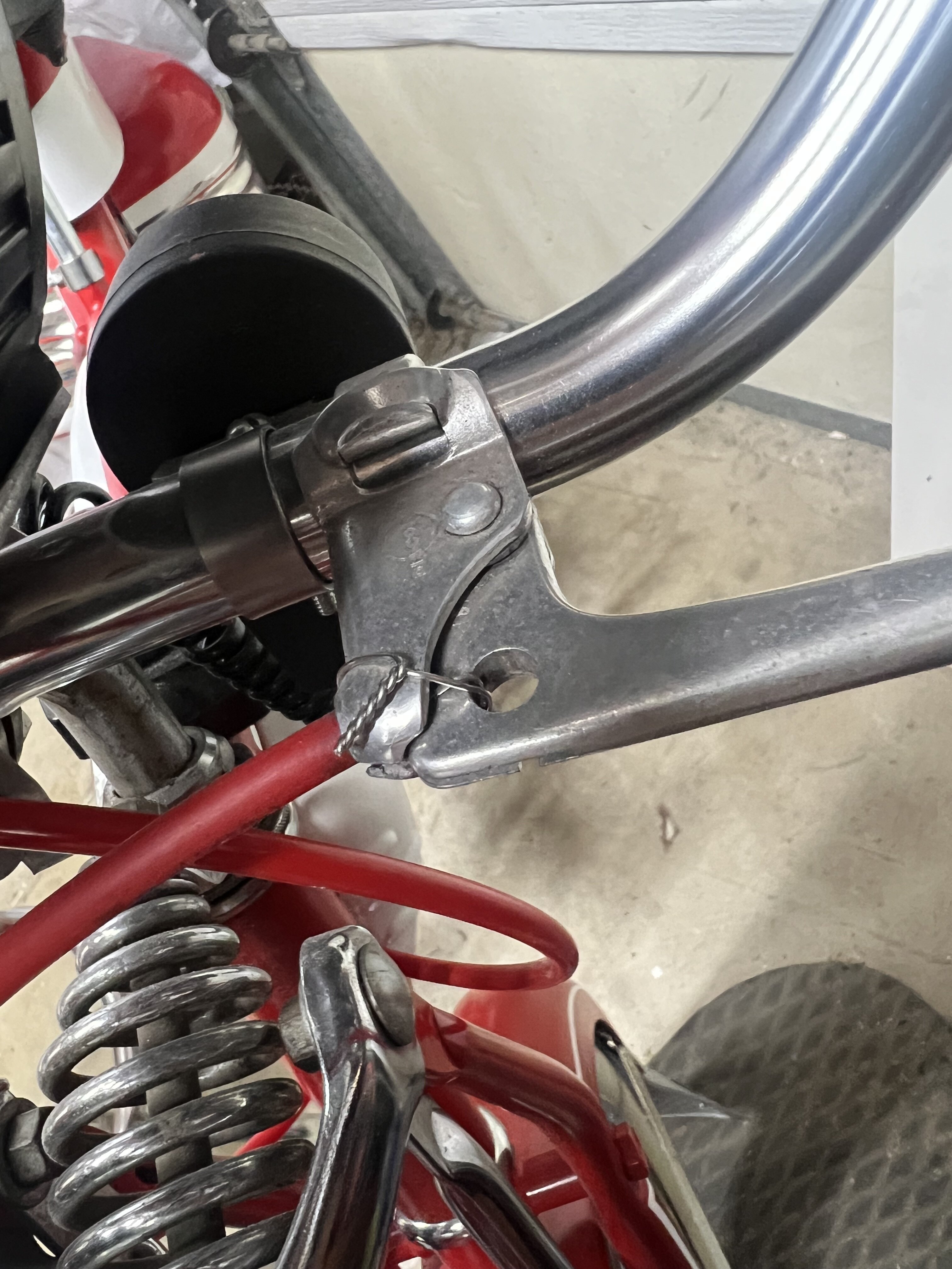

How do you keep tension on the brake handle
Safety wire. I put the housing in the lever, then put a small zip tie around the housing so it doesn’t slip out of the lever, then hold the lever out with wire. This is how it’s done on screen used.
