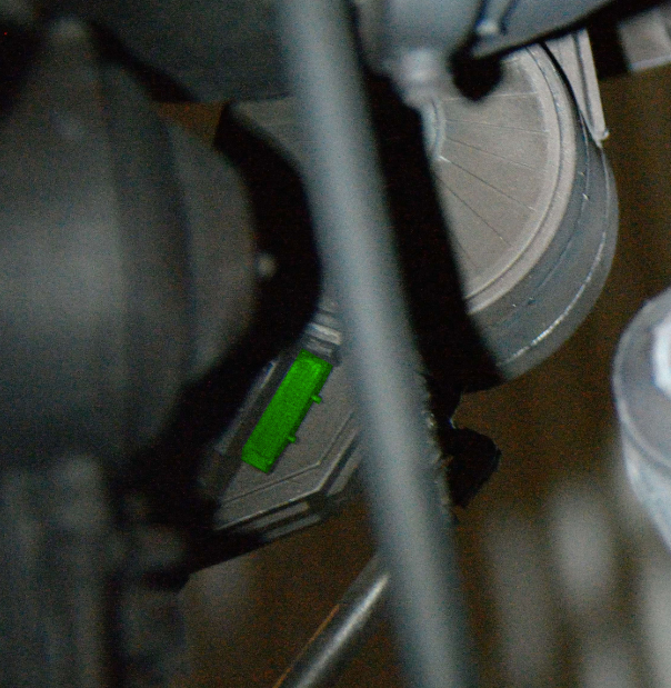

Hi Jason! What is part #32 on the "Body Underside"? It isn't listed with your photo.
It looks kinda like a FLIR pod from something....
Super helpful thread! I've wanted to build one of these almost as long as I've wanted a full size Artoo.
(Got the Artoo, now he needs a buddy!)
#32 is a Roco Gepard

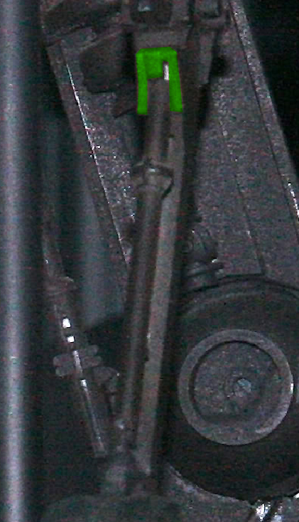

Almost there - just need to clarify the Plastruct codes :)
Still need to do 85 & 87 - pretty sure the Ertl German Artillery WWII W/M-18 Light Howitzer in 1/35th is the donor for the green one, but I have to verify.
#85 is the WWII W/M-18 Light Howitzer or 1 Ton Half-Track SD. KFZ 10 with M-18 Howitzer (the M-18 Kit is the same)
