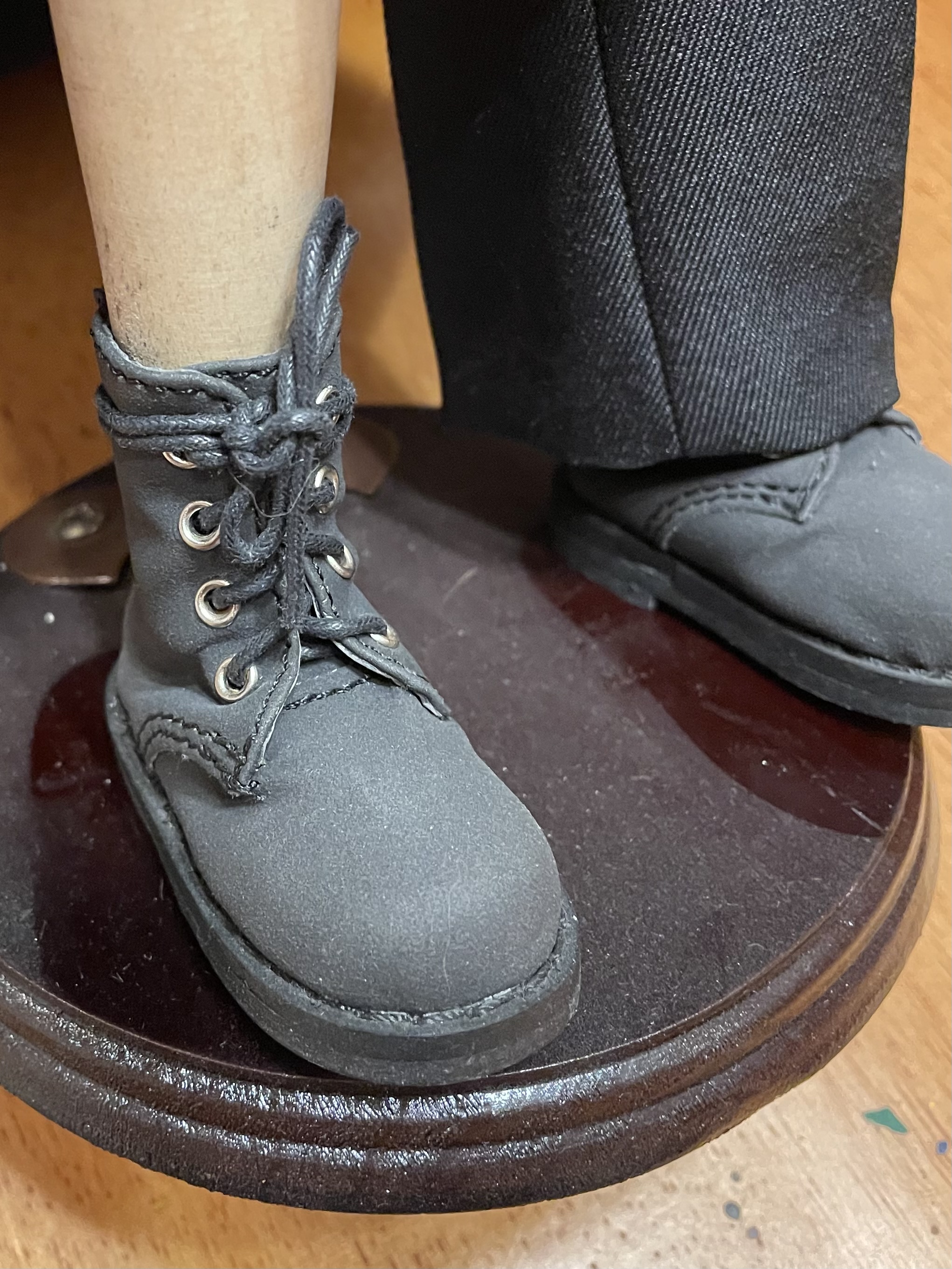

What boots?
The boots i used were 1/4 BJD MID Boots Supper Dollfie EID LUTS AOD DOD Shoes MSD Nubuck leather Boots
What boots?
Same boots, just didn’t see a follow up pic showing how the boots looked on Blade. Wasn’t sure if you still used them or not. Did you have to sand the feet down a lot?
I'll get some pics tonight, I believe i just used them as is. It's been a few years so i cant remember.
Yup boots are as is, just positioned the foot around to get it in there, nothing special.

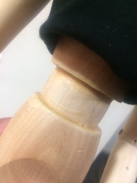

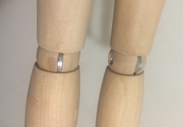

The real Blade prop is about 21" tall, and using this mannequin body It ends up being that size when the head is attached. I glued the torso sections of the body together with wood glue, since it is very floppy and the real puppets didnt have articulation there, I'm finding that once I have the heavy resin head on this body the joints become pretty weak, so I'm working on strengthening them. Be carefuly when taking parts off these bodys, the entire thing is articulated with super strong springs with hooks, so its easy to have one spring loose and cut yourself. I also wedged some washers into the front of the knee joints to stop the knees from bending the wrong way. The hands were removed and the feet will need to be ground down a bit to fit into the correct sized boots.

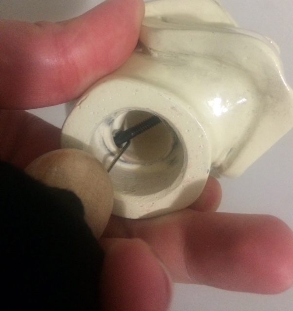

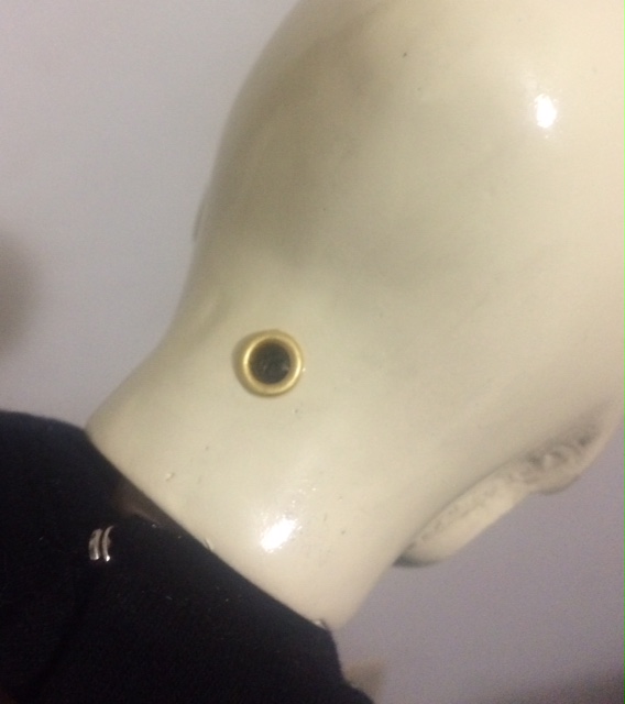

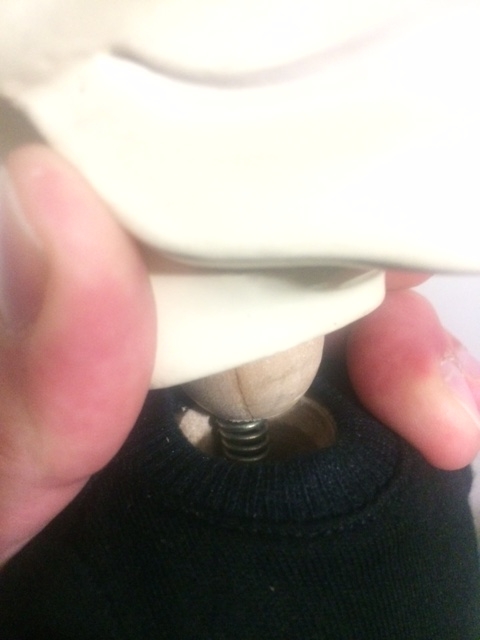

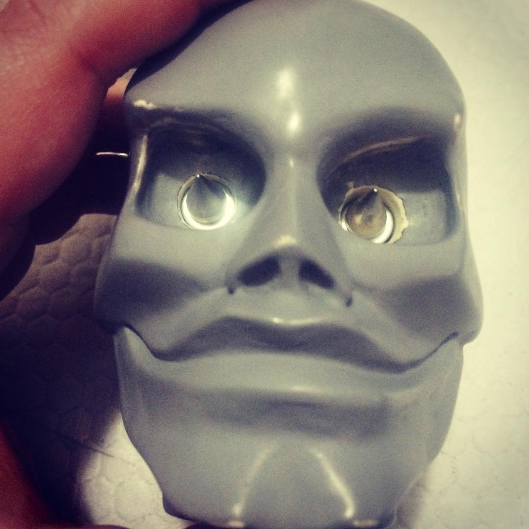

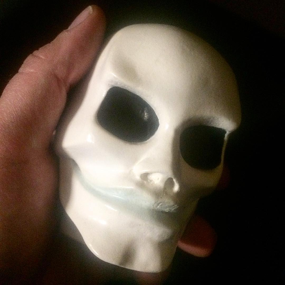

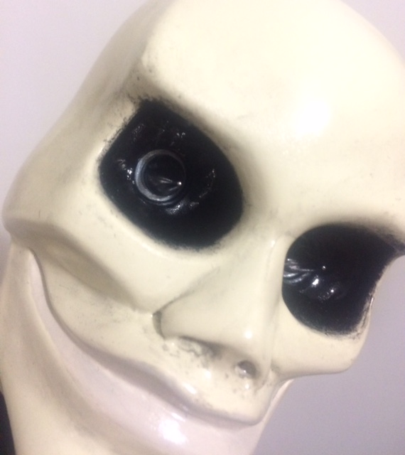

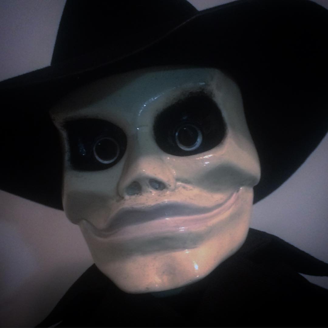

When It comes to the head and hands, that's gonna be up to you. I got my parts on ebay, some are better than others, but there are many different sources. The head I got needed some touchup work and I ended up completely repainting it and doing quite a bit of work to it. To work with the mannequin body, I needed to hollow out the neck and have a post for the spring to hook to. I used a long hex screw as the post, and placed it into a hole I also used for the exterior "fluid injection" hole on the back of the neck as seen in Puppet Master 9. This was done with a small brass grommet.
View attachment 586296View attachment 586295View attachment 586298View attachment 586306

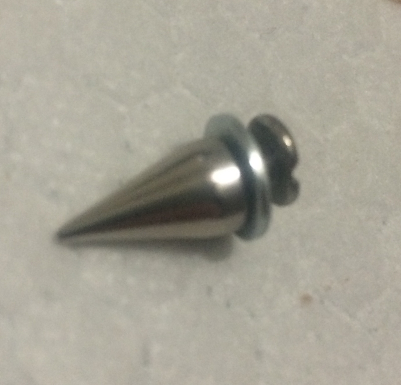

I drilled out the eye holes on the head so I could put in the eye spikes. I wanted them recessed like they are usually seen in the films. I made these from removing metal spikes from a neck collar I got at Spencers. I glued them to washers and glued them in place on the head after painting it. I went with a Puppet Master 1 paint style, with an off-white color, light weathering, and a high gloss finish.
View attachment 586303View attachment 586297View attachment 586301View attachment 586302

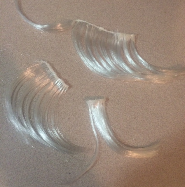

The hair that I will be attaching to the inside of the hat (once I get a new one) came from Party City. They have several different colors of hair extensions and a headband ponyytail thing. If you disassemble the headband and cut a few spots, youll have already curved hair that is attached in a big long strip, perfect for lining the inside of the hat.

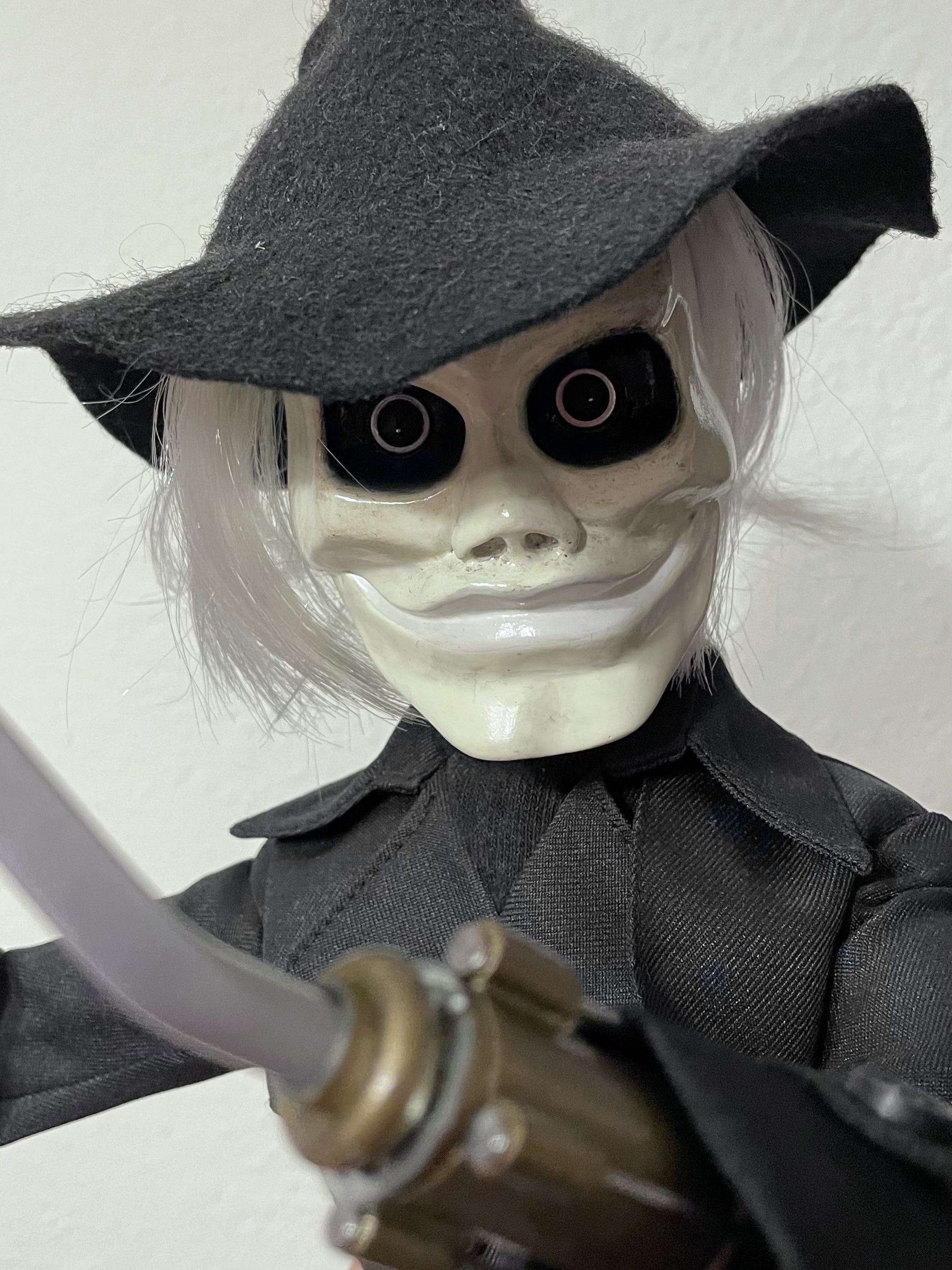

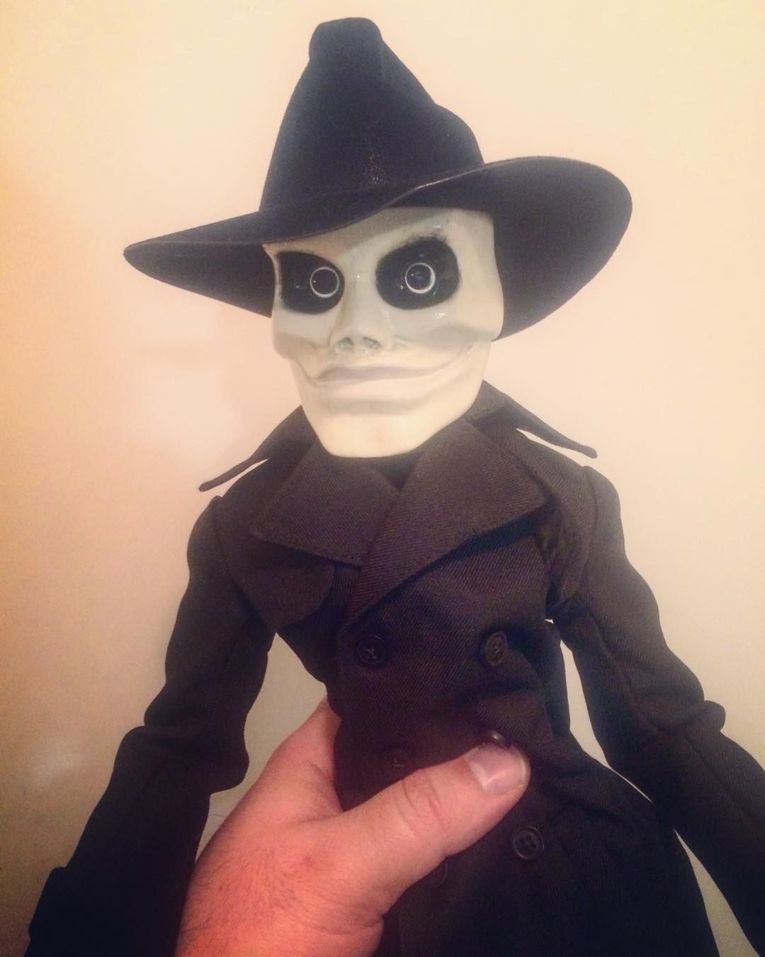

And that's about where I am right now. I'm finding a different hat, the jacket buttons have been replaced, the head is done, and the pants are on their way. I still need to grind down the feet to fit the boots and get the hands I have coming. But it's already starting to look like Blade! Thanks for looking!
