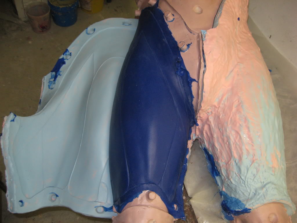

The next day, the silicone is set so the mold is opened...
Trimmed while still on the core....
The blue silicone was tinted that way because these legs were promo suits done for the Toronto Maple Leafs...it's been a few years now.
Prior to that, black silicone was used as well...naturally. :)
