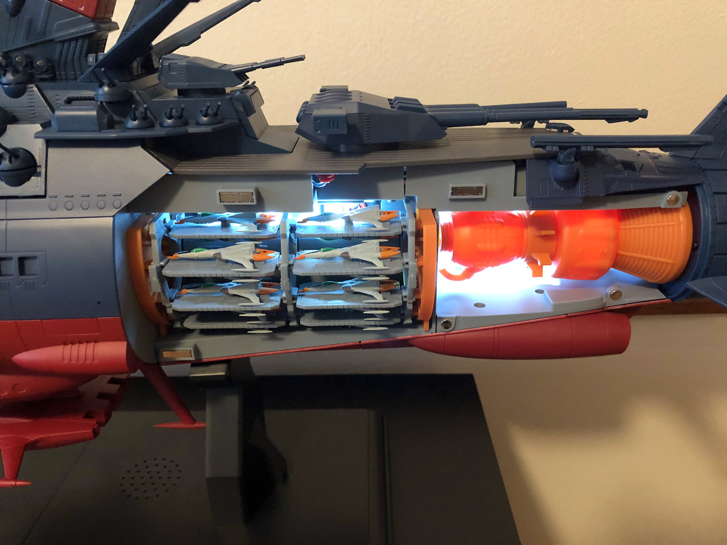

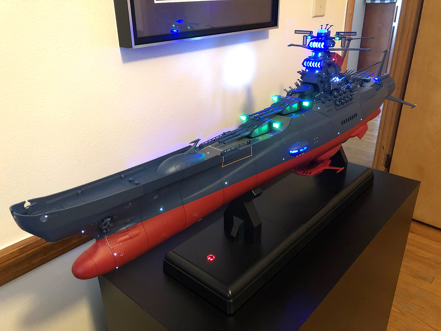

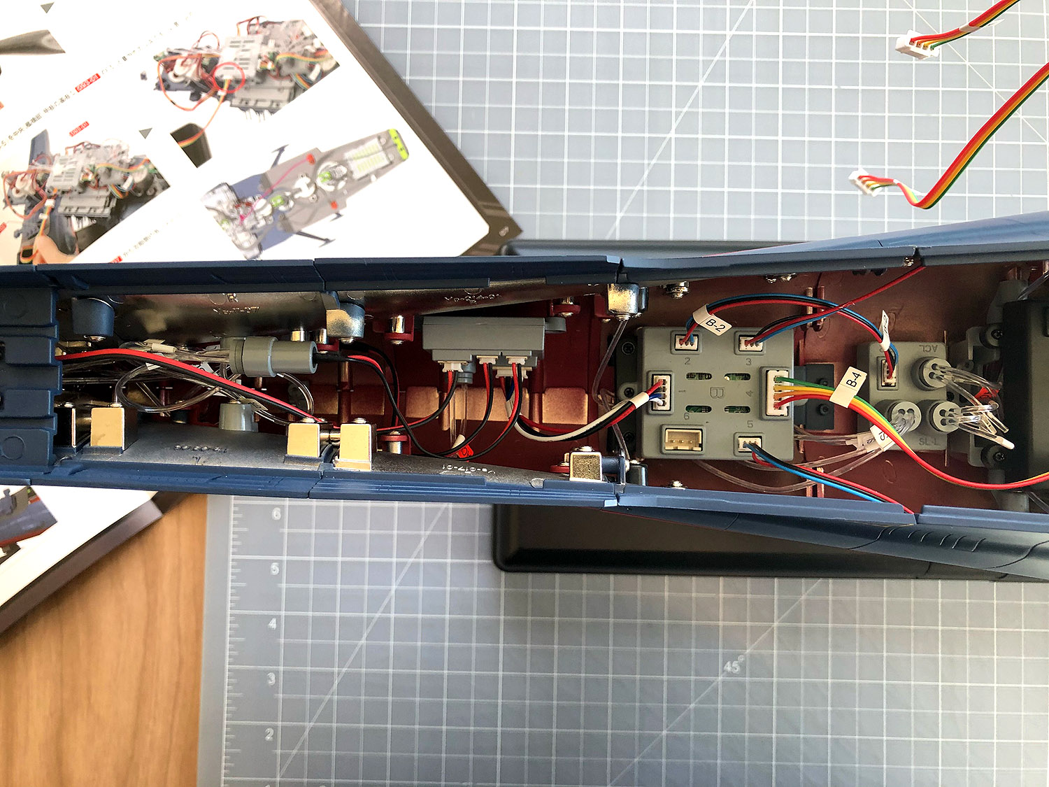

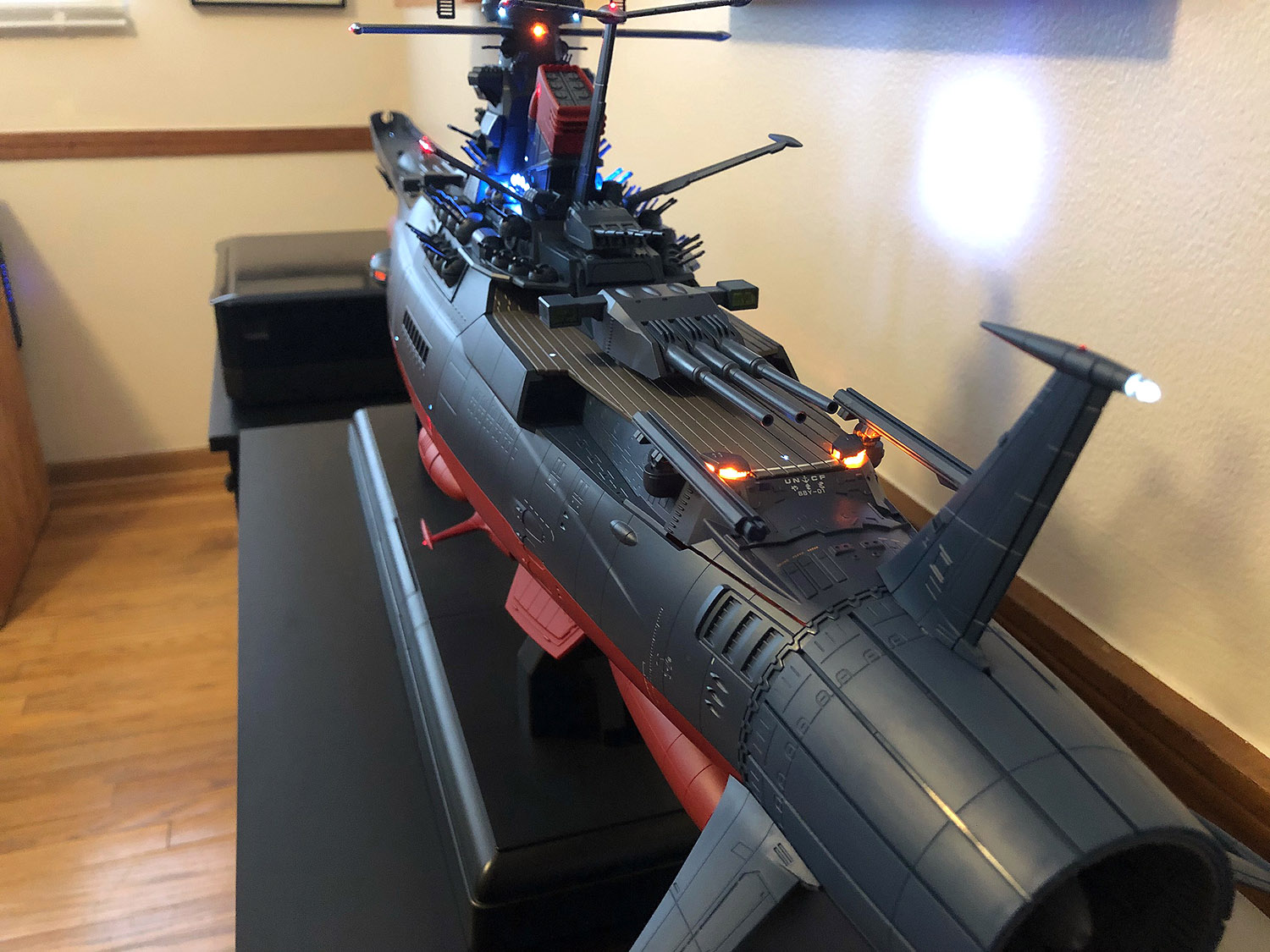

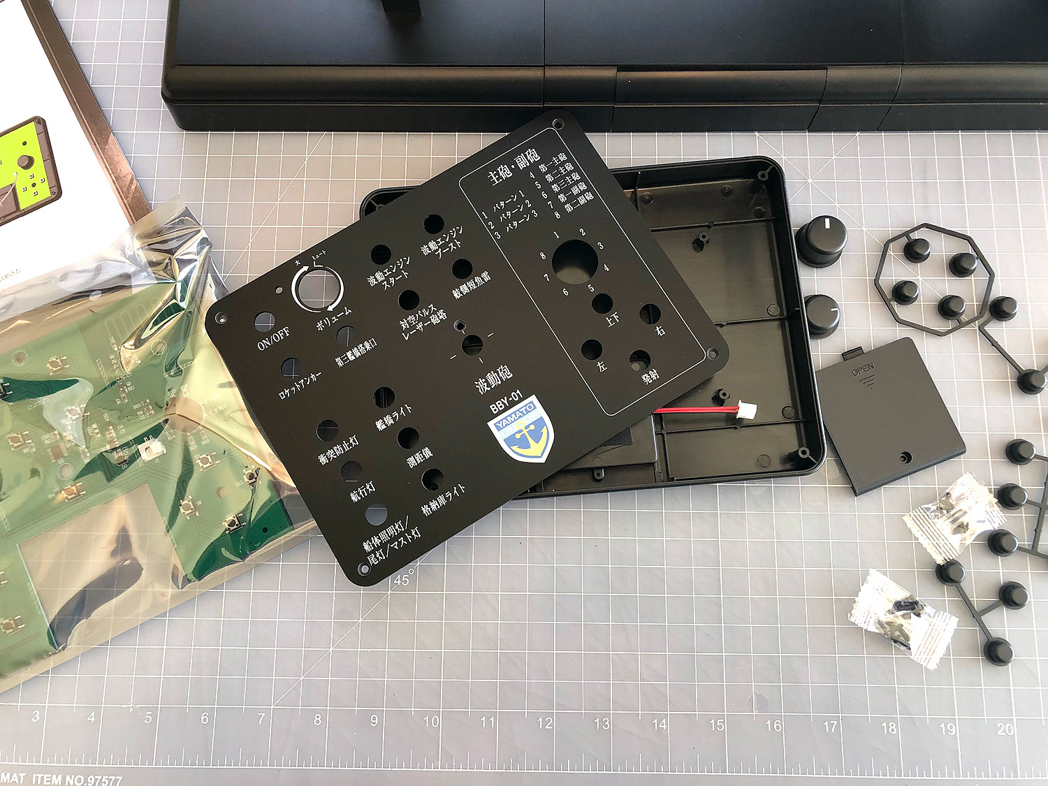

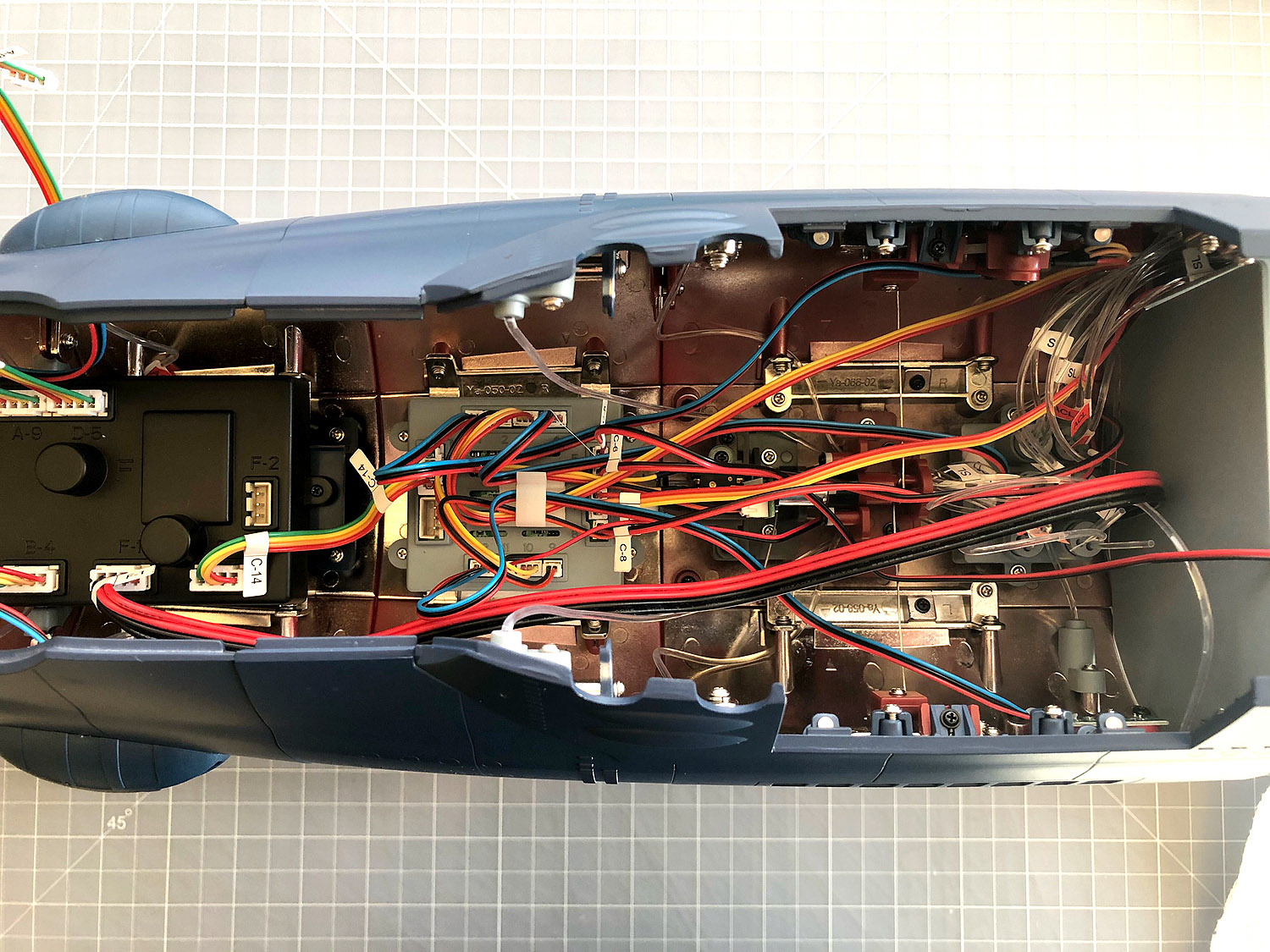

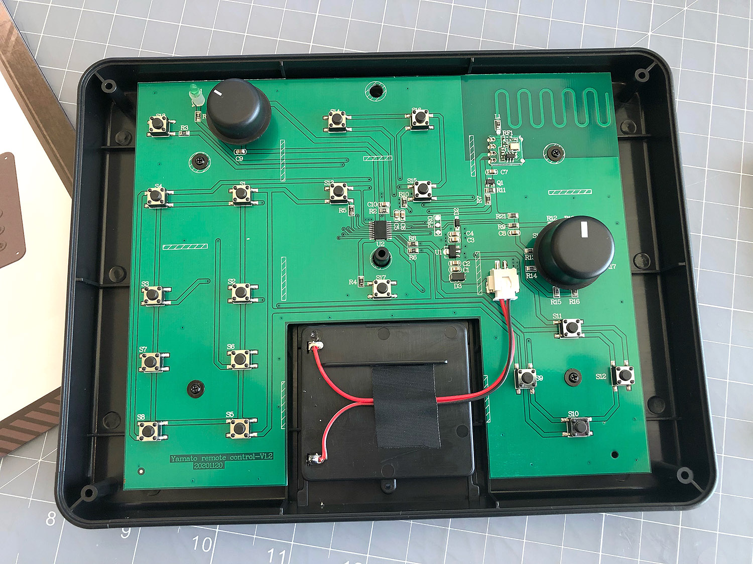

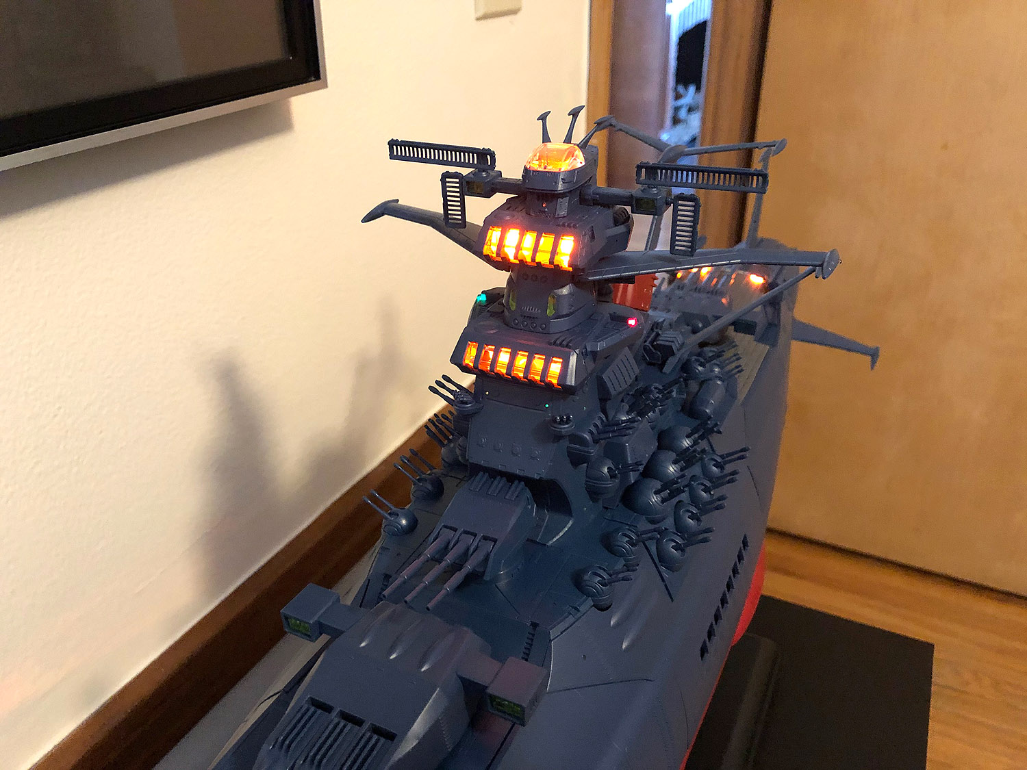

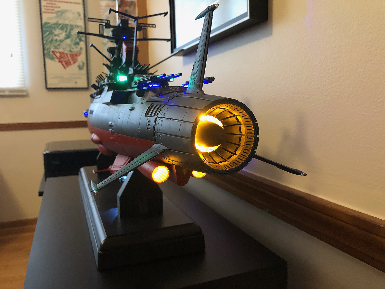

Thank you for your wonderful photos. I have been following your progress for a while and I would really appreciate some advice from you. I have volumes 1 to 109 and I have not yet started building the Yamato. I have never build a Hachette model before and the last model I built was over ten years ago. I want to collect all the tools I will need before I start. I have noticed that some parts require glueing. Someone earlier in this thread warned against using a specific type of glue. I was wandering what the brand name of the glue you used was? Also, what specific tools did you need to build the model? Also, do you have any tips for a first time builder for this model? Sorry for all the questions. Thank you for your help.All good things come to an end, the final 6 issues, 105 thru 110. Every thing is wired, connected, master control board installed, the display base with the main power switch, speaker and sound board assembled.
The control panel is finished and after a deep breath, Yamato powered up, controller switched on and everything works! There is a volume knob and it can be turned up pretty loud. The controller has great range; I can run the Yamato from two rooms away.
I’ll take some detailed photos and video later in the week, I have a few little adjustments to make and this is a wrap.
I have decided to extend out the additional 60 issues and get the Andromeda but I’ll likely take a little break before starting it and let the parts pile up for a bit.

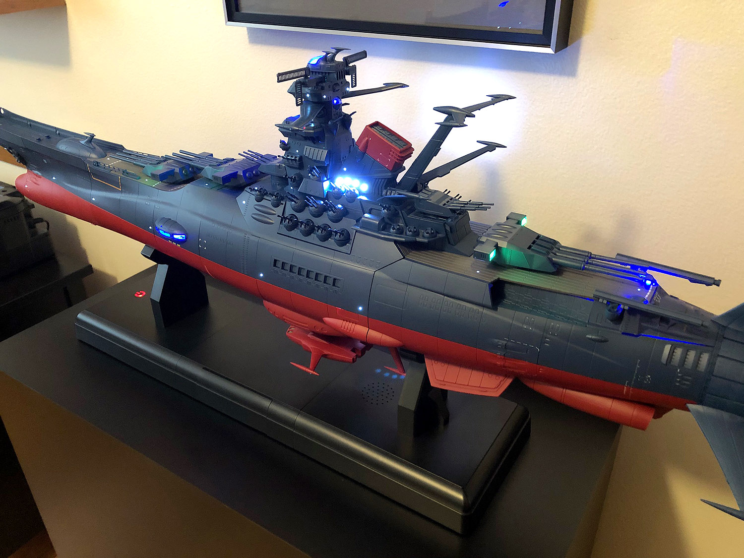

Thank you for the helpful tips. I finished building the Yamato yesterday! It was fun, but exhausting. I feel like I have just binged watched a entire show...building 2 years worth of parts in less than a week feels very strange. I wasn't planning on building it so quick, but the build experience was just so enjoyable that I just kept building. Overall I am very happy with the model and would recommend it to any Star Blazers/Yamato fan.Thank you for the kind words. I used a couple of good magnetic ended small screwdrivers (Philips), a small pair of side cutters, I prefer the Tamiya flush side cutters, and a couple pairs of tweezers, straight and angled, again I like the Tamiya ones. I used Gorilla Super Glue in the precision allocator for models but most of the time I would put a small amount of a piece of cardboard and then apply it with a toothpick which will give you more control and less chance of applying too much super glue.
Because of the language issues I recommend watching the Hachette videos before doing the issue, the instructions can be a little vague at times. You can find them here Hachette Yamato Build Videos
Patience will be your best friend for this build, take your time and if something looks unclear walk yourself through it a couple of times before moving forward. If you have any questions along the way feel free to reach out.
