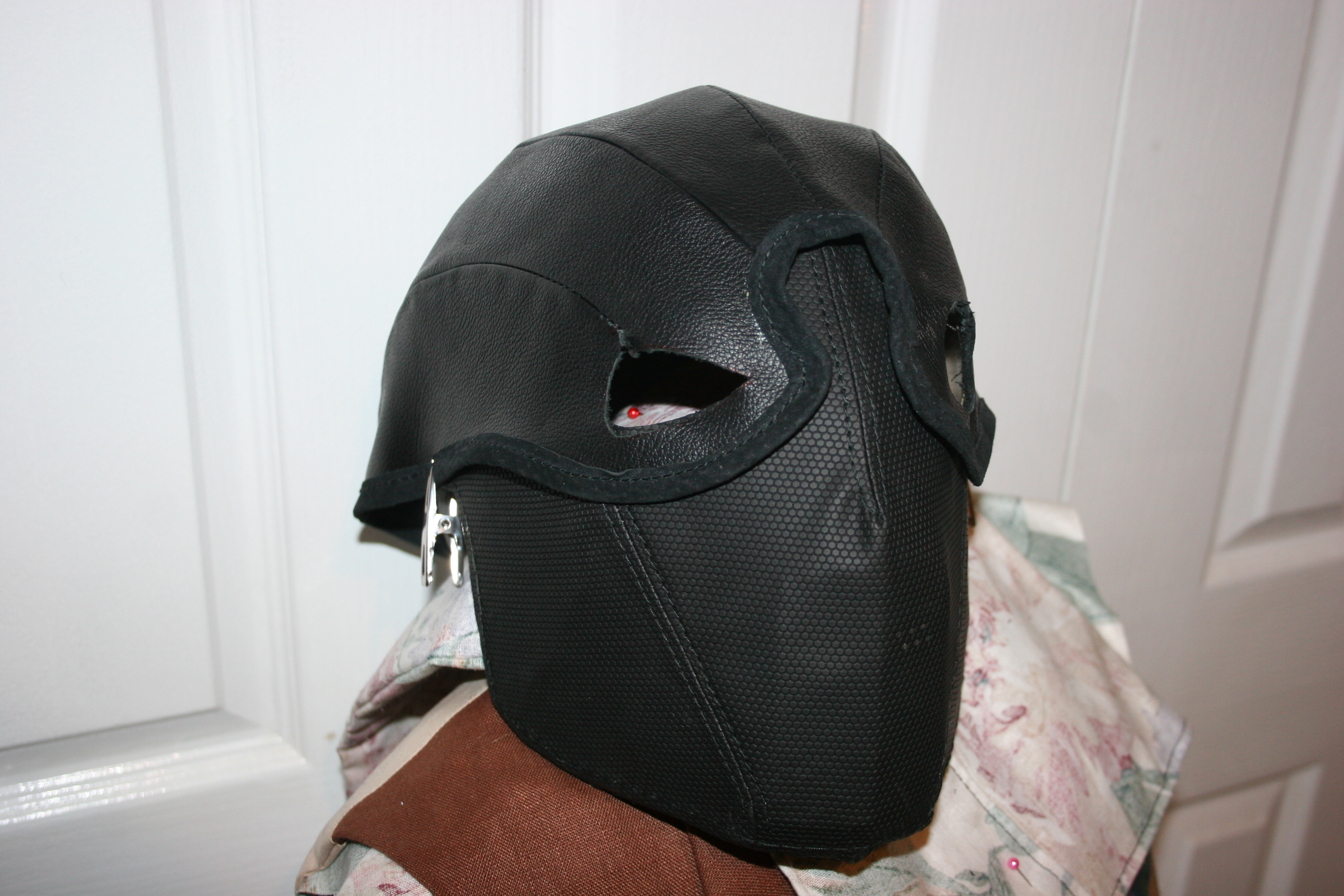

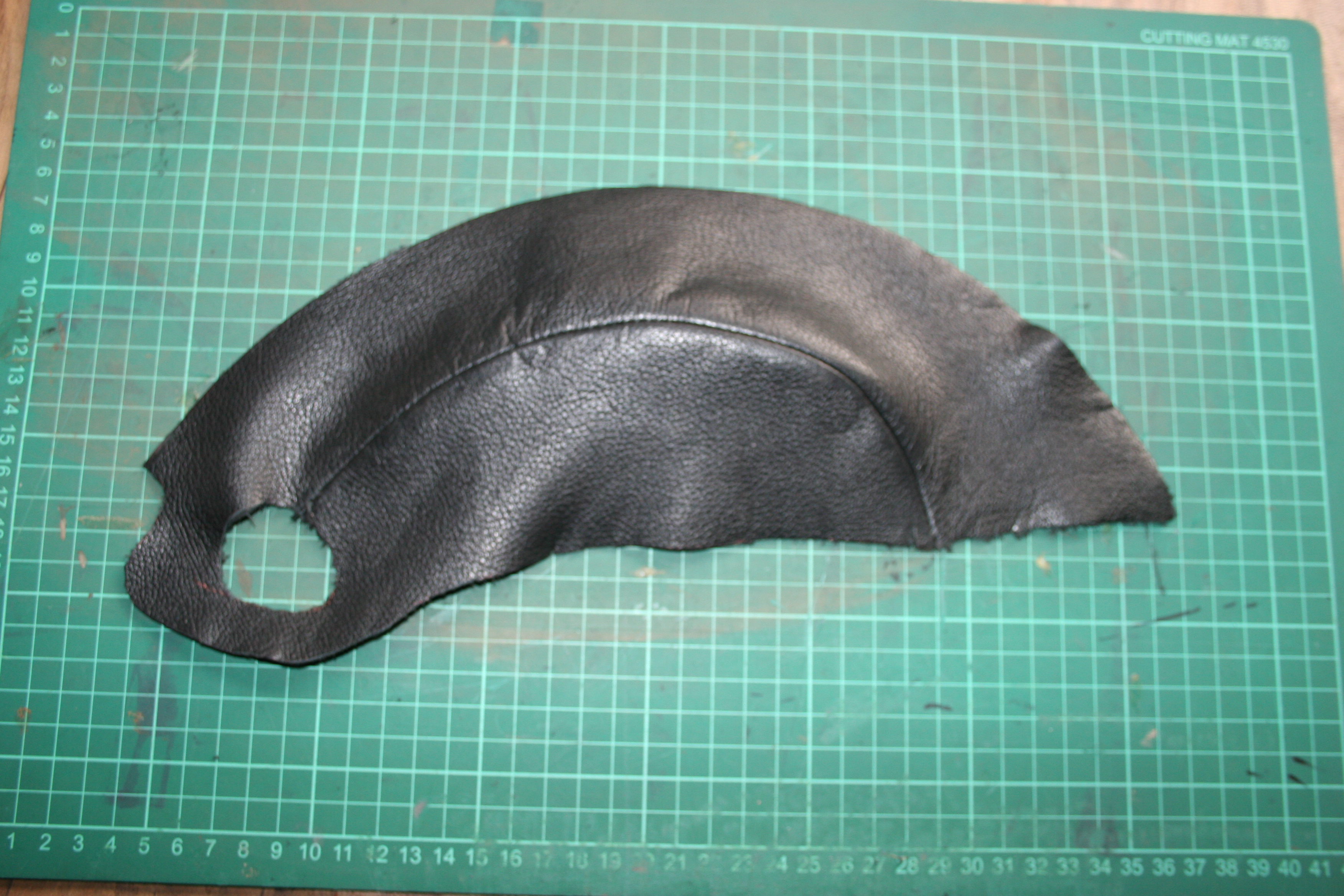

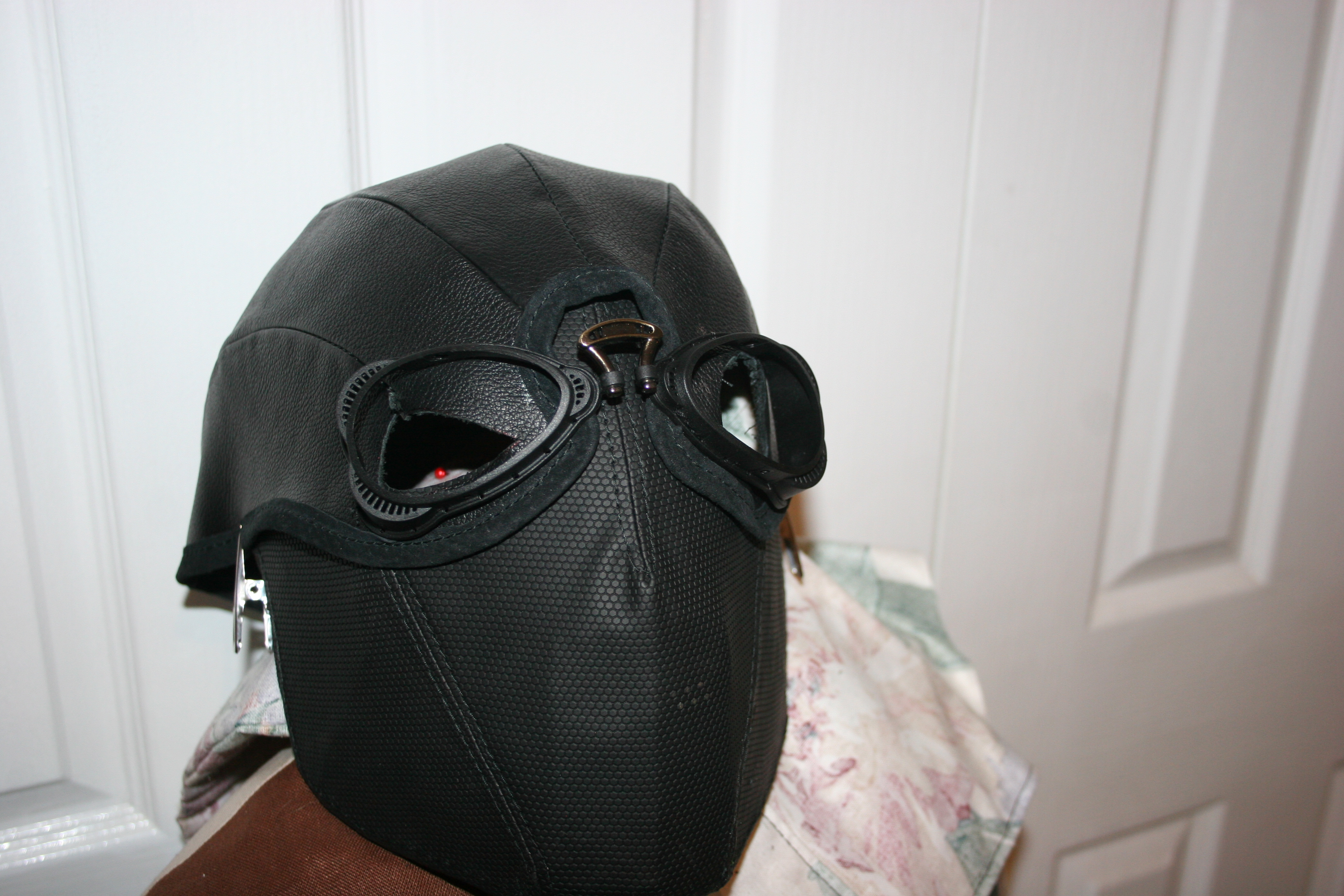

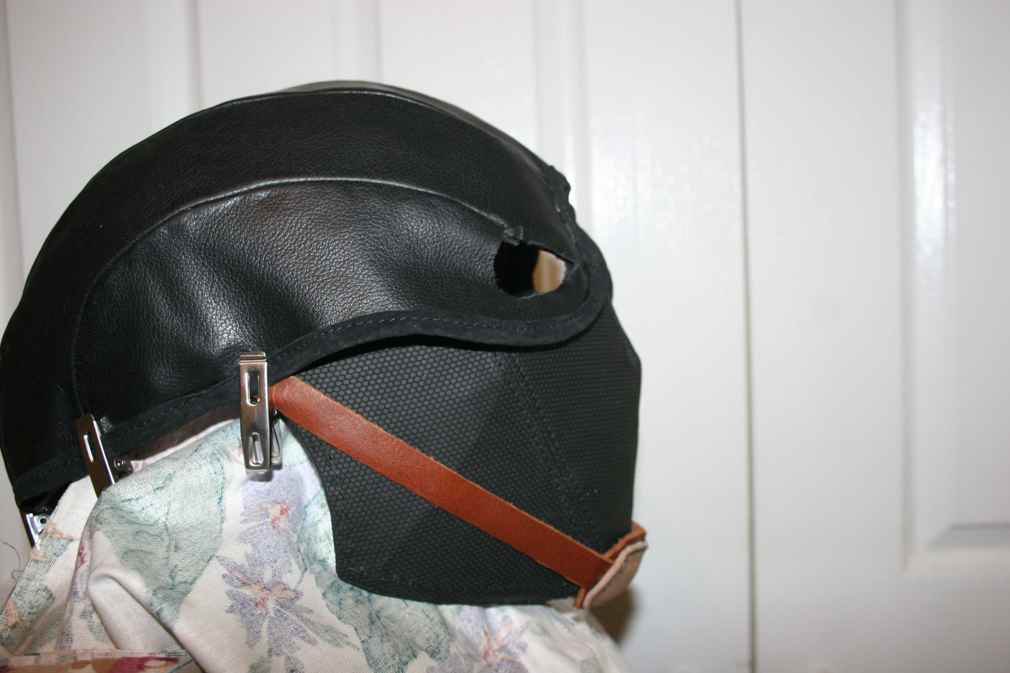

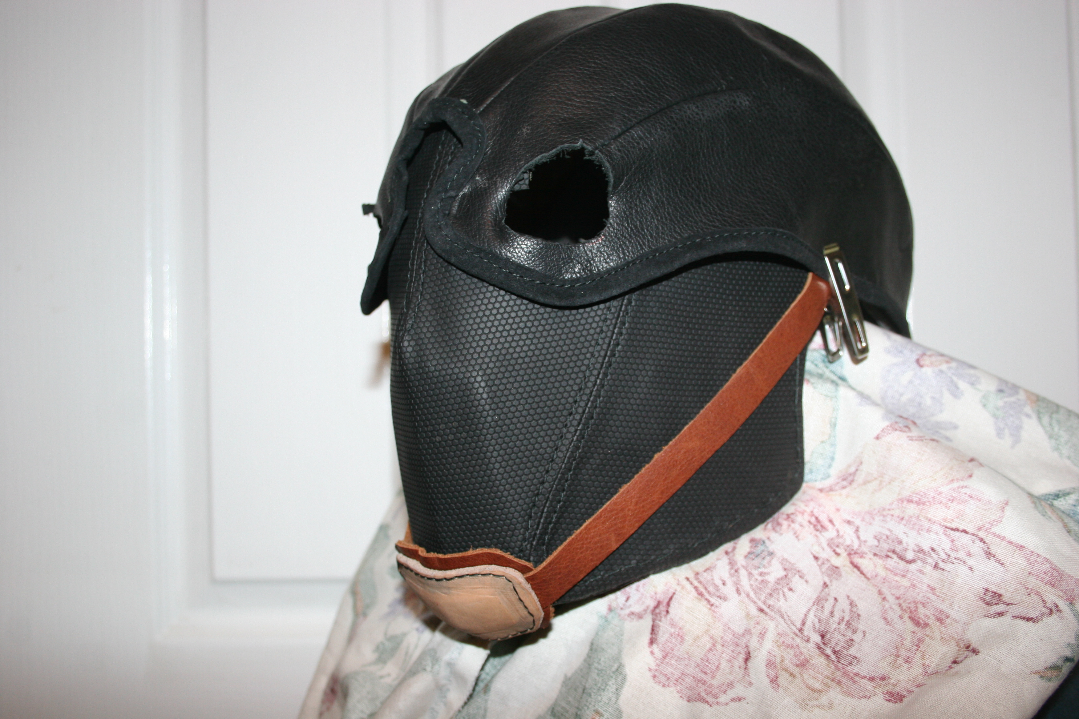

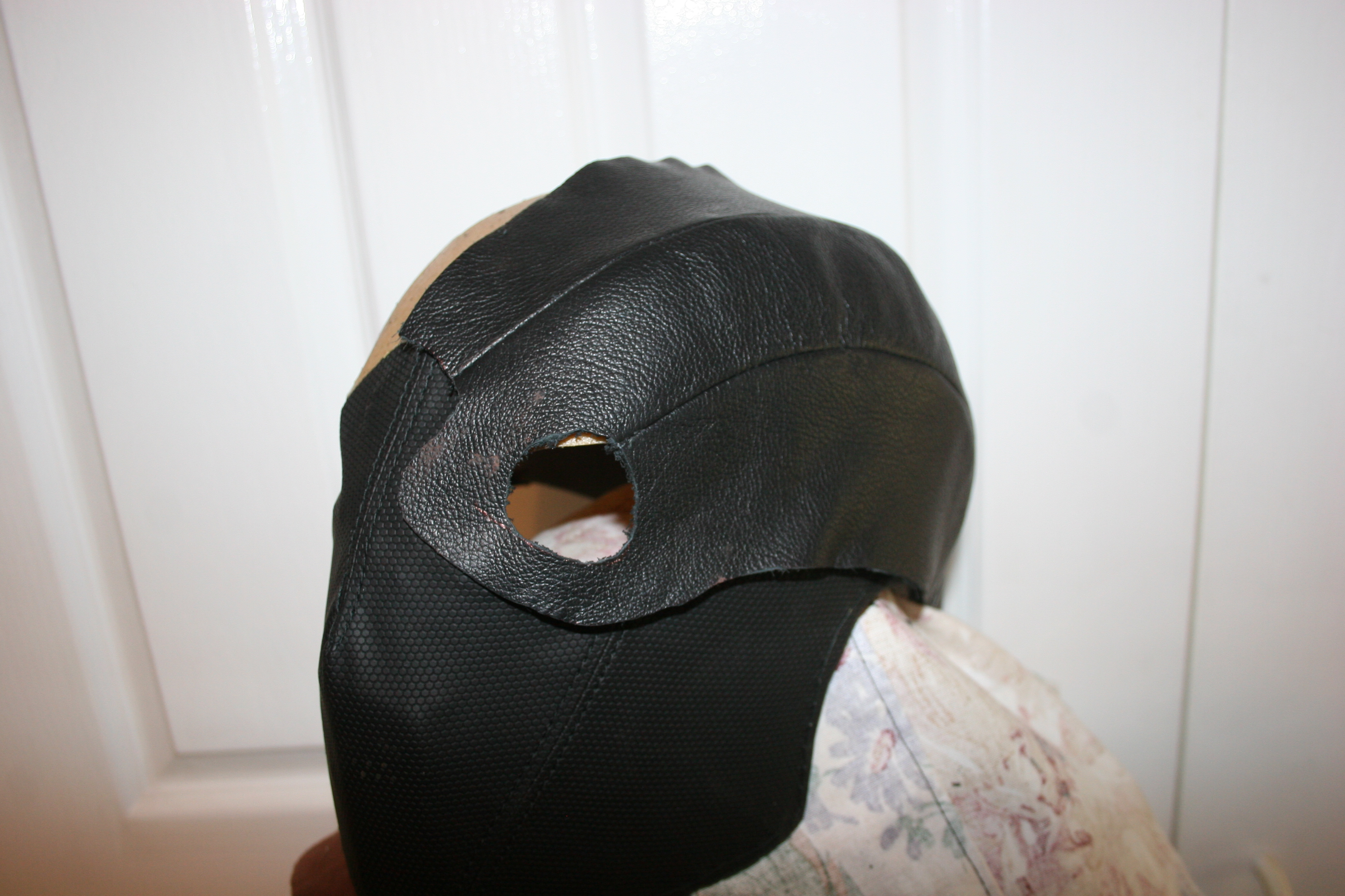

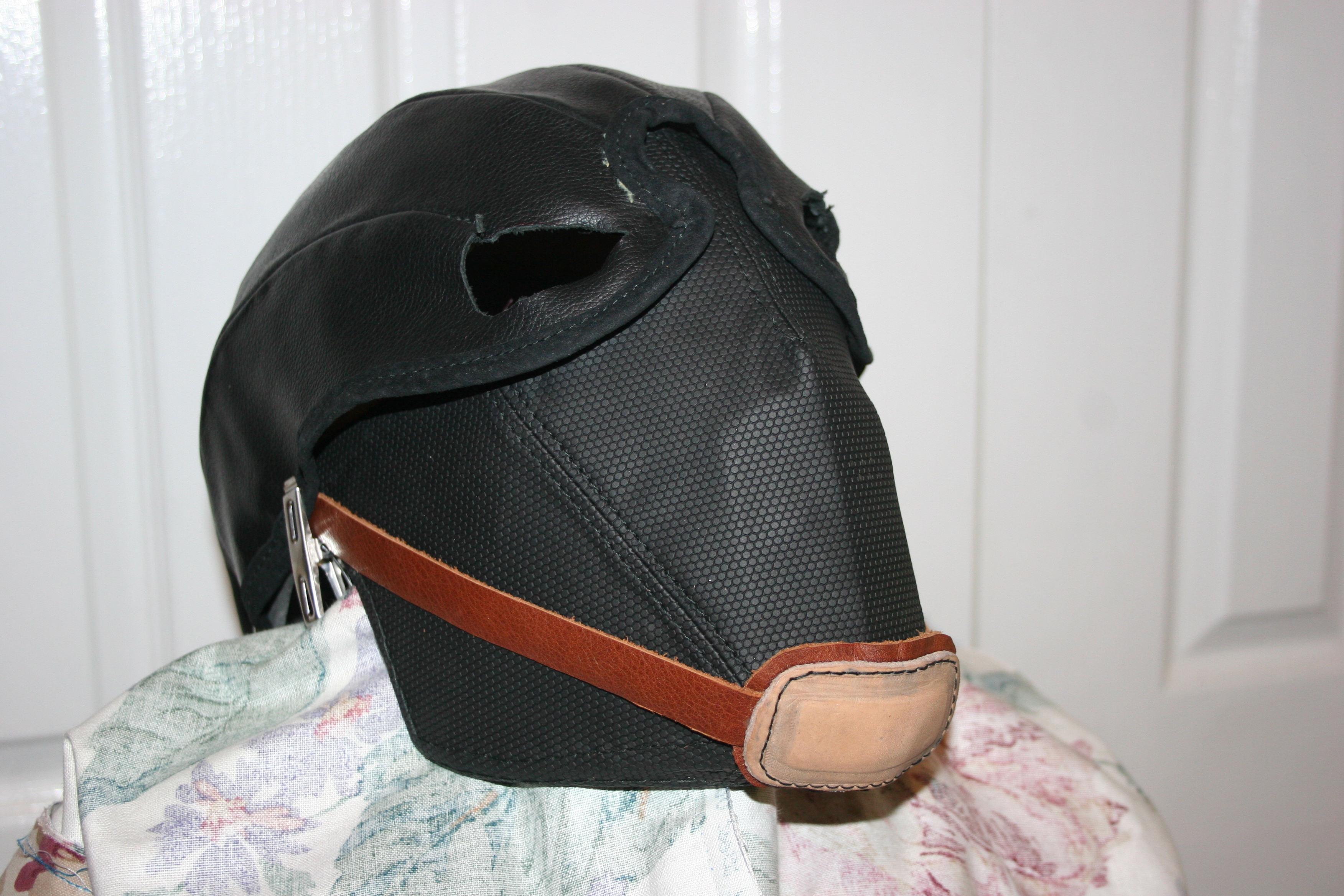

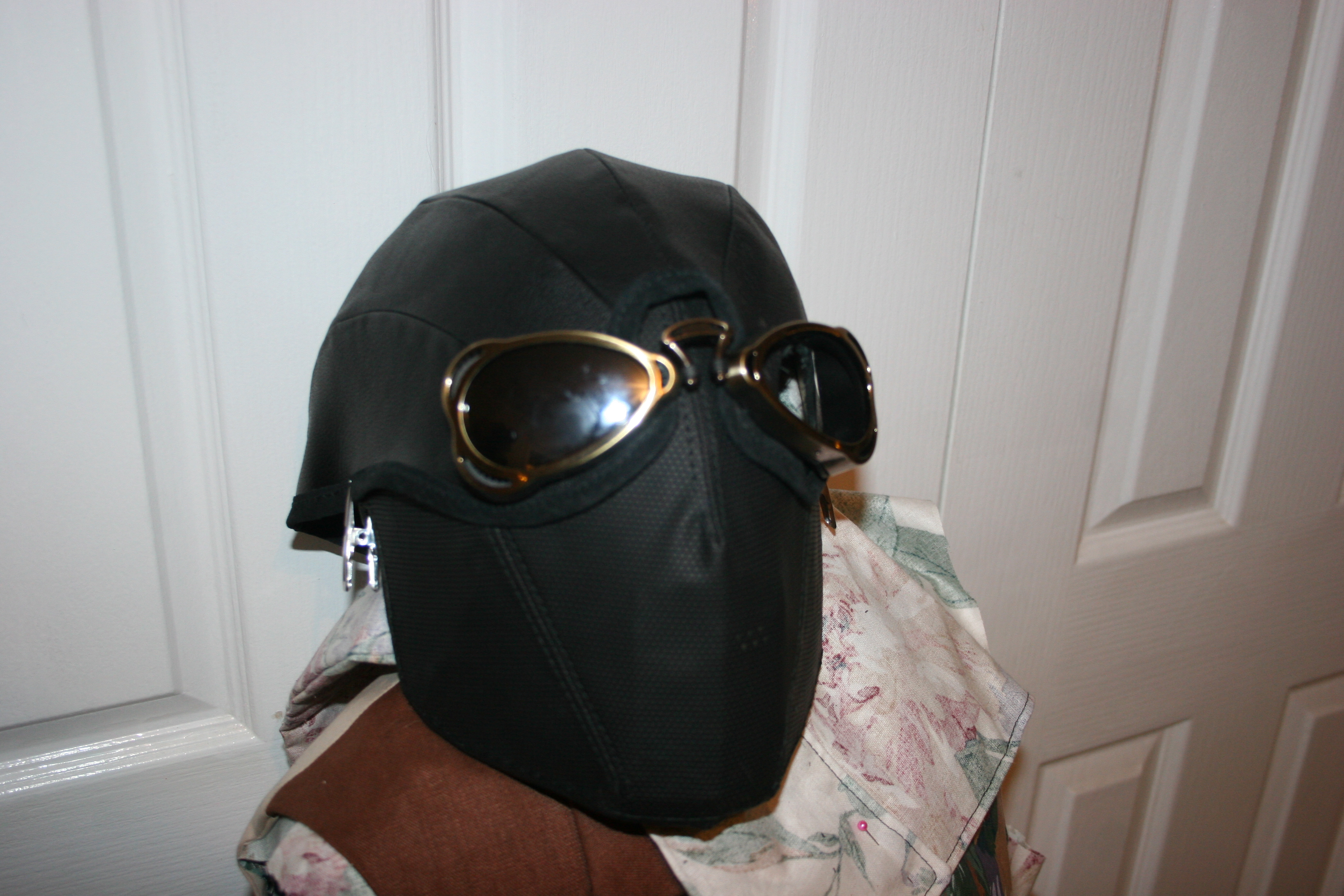

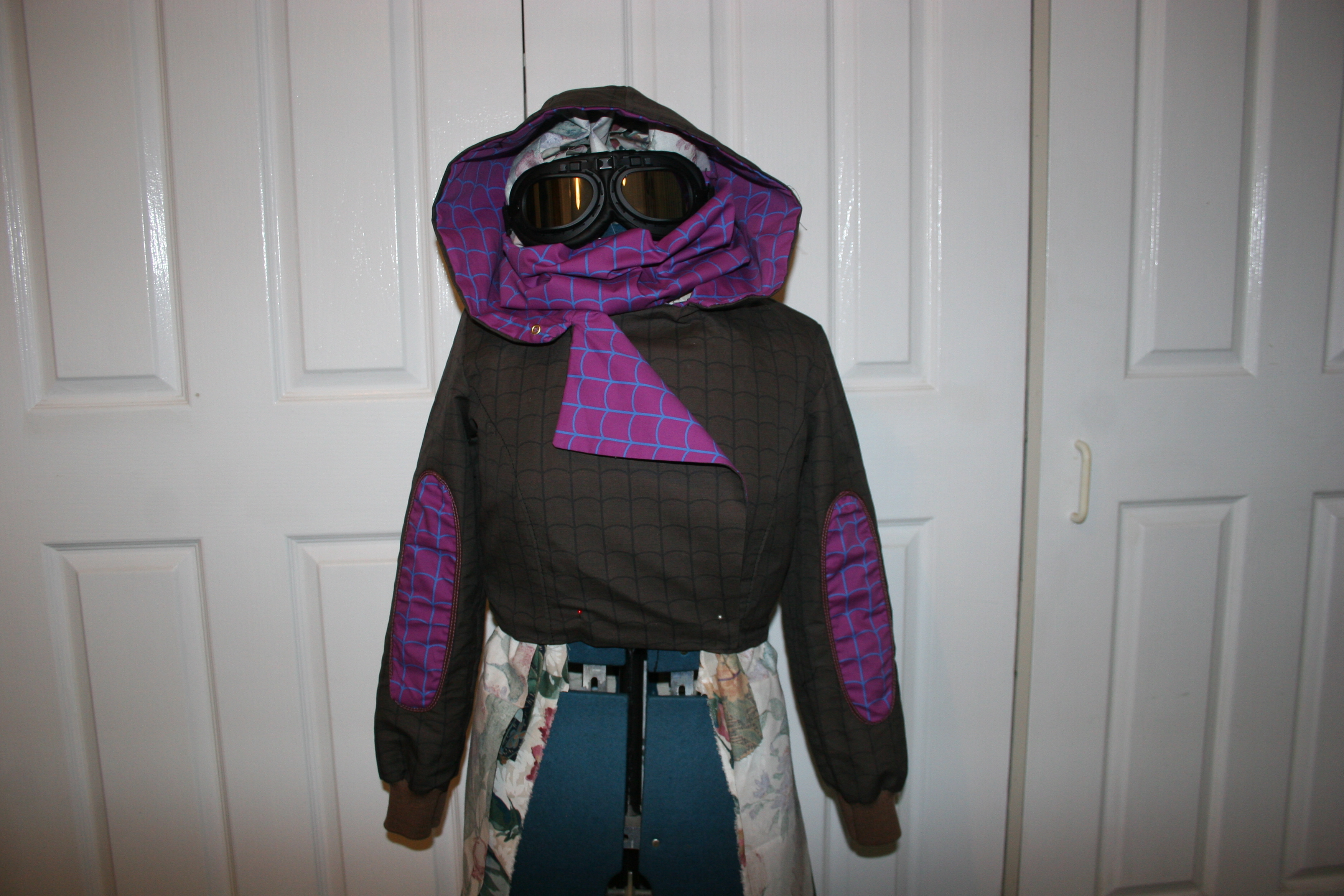

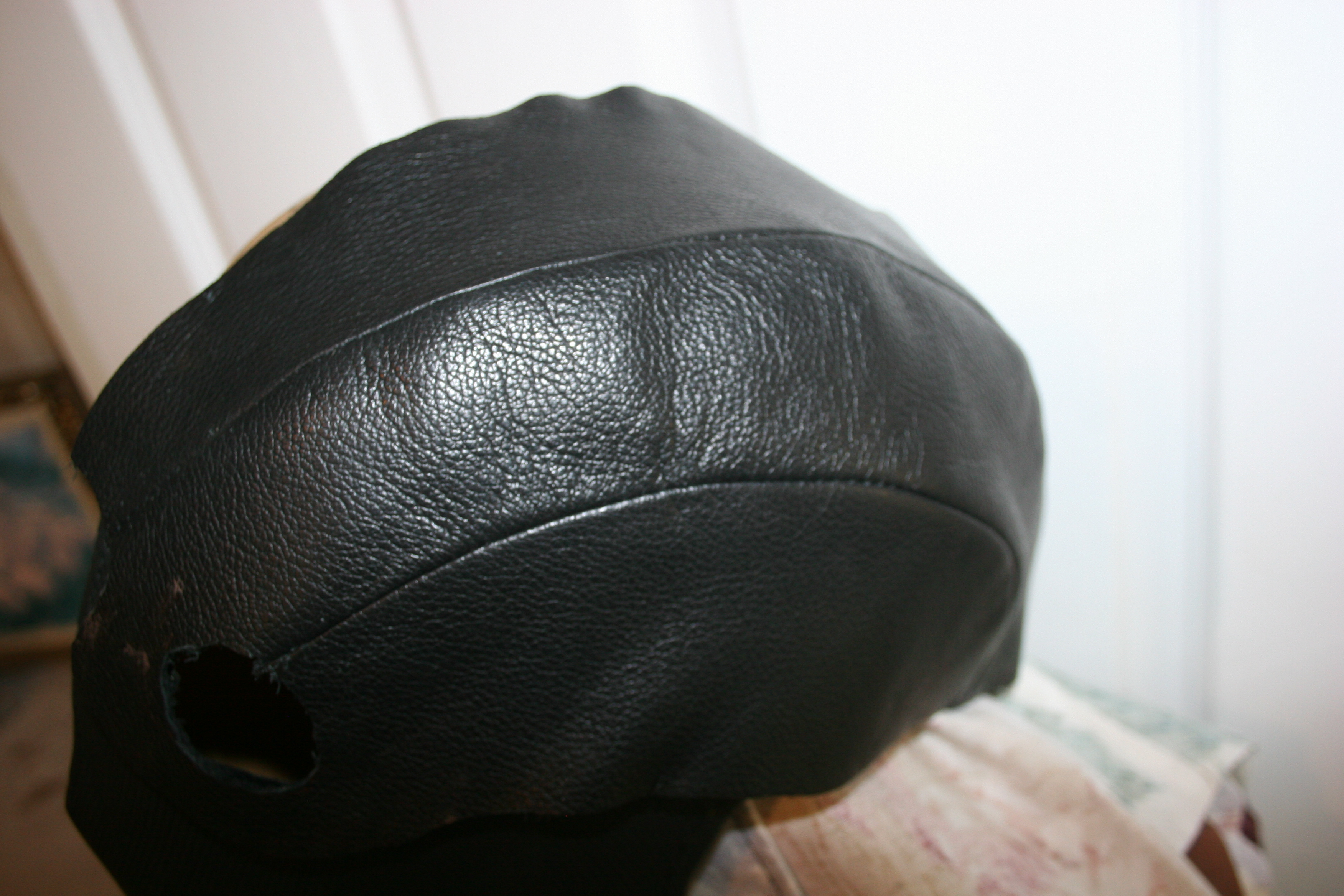

Finished sewing the leather skull cap but will need to hand sew it to the shell which is going to be a pain in the backside.

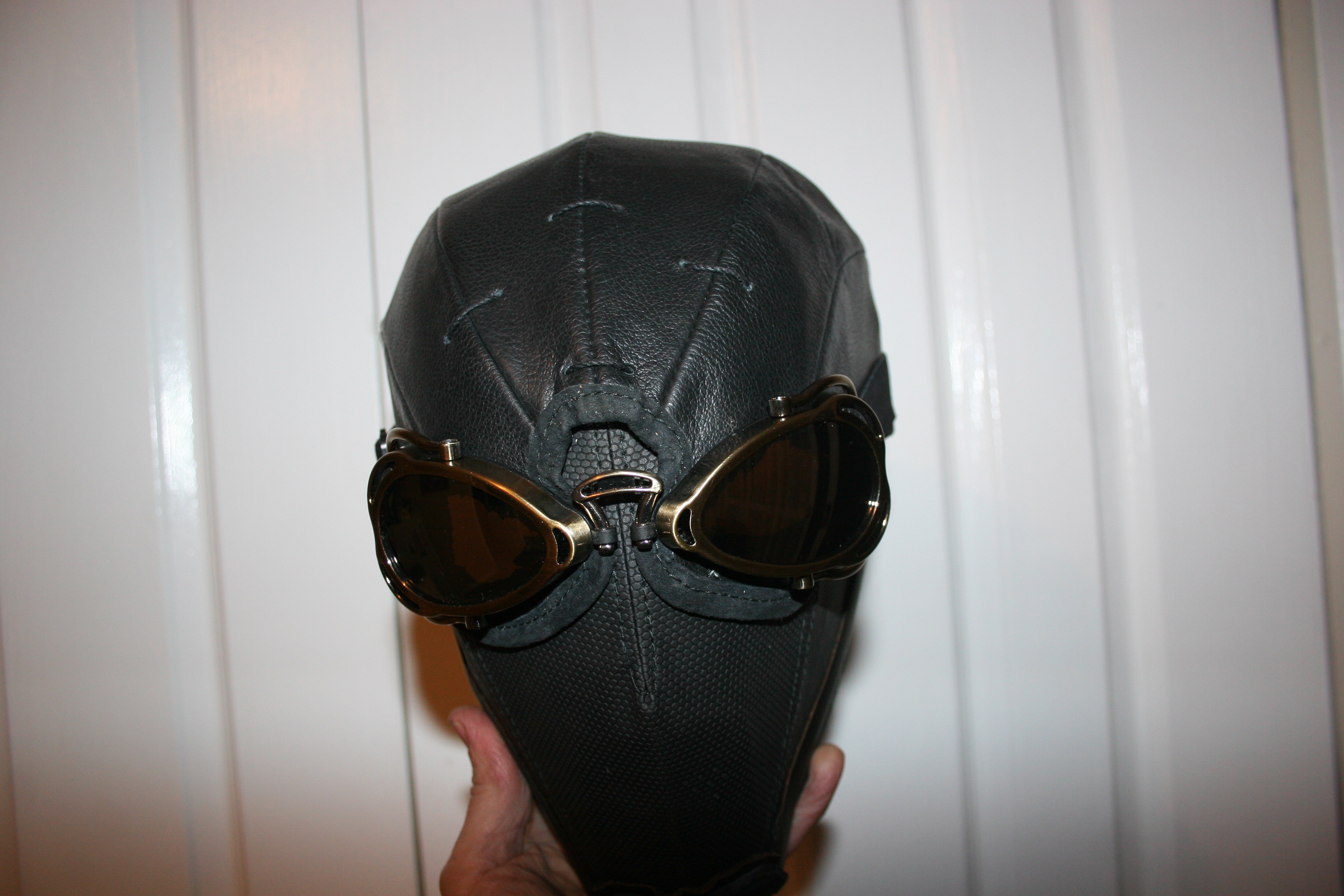

I have sat the skull cap on the shell for a couple of pictures. In the last two you can see how I am going to build the deconstructed aviator goggles onto the shell by sewing the black plastic inner frame onto the front of the shell first.

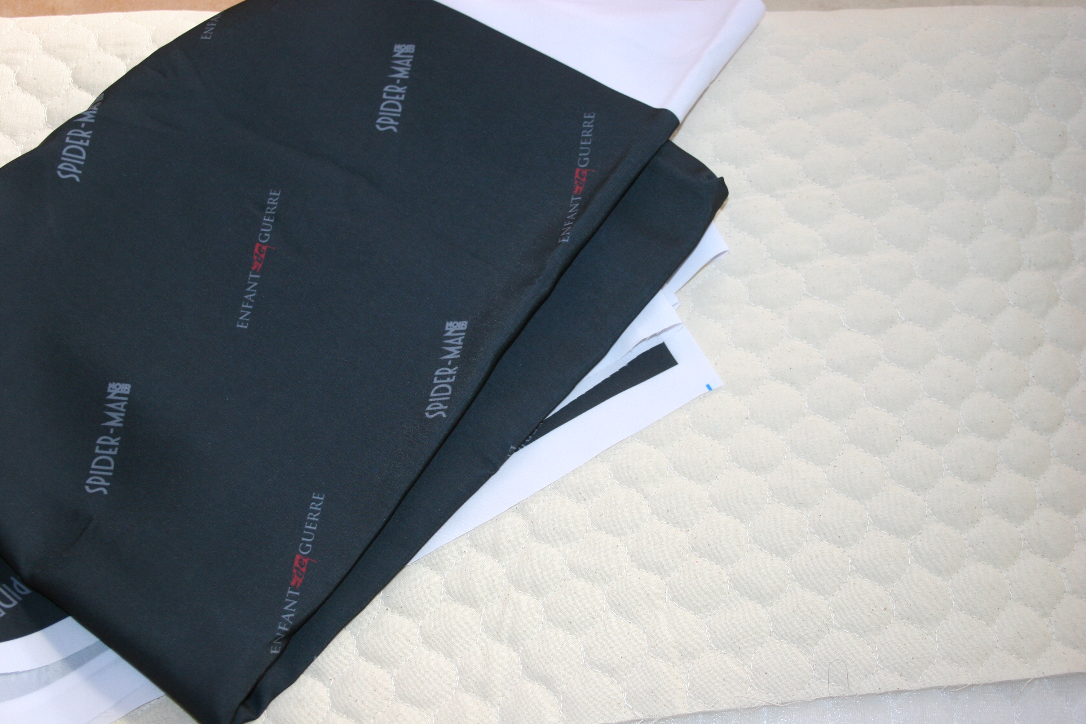

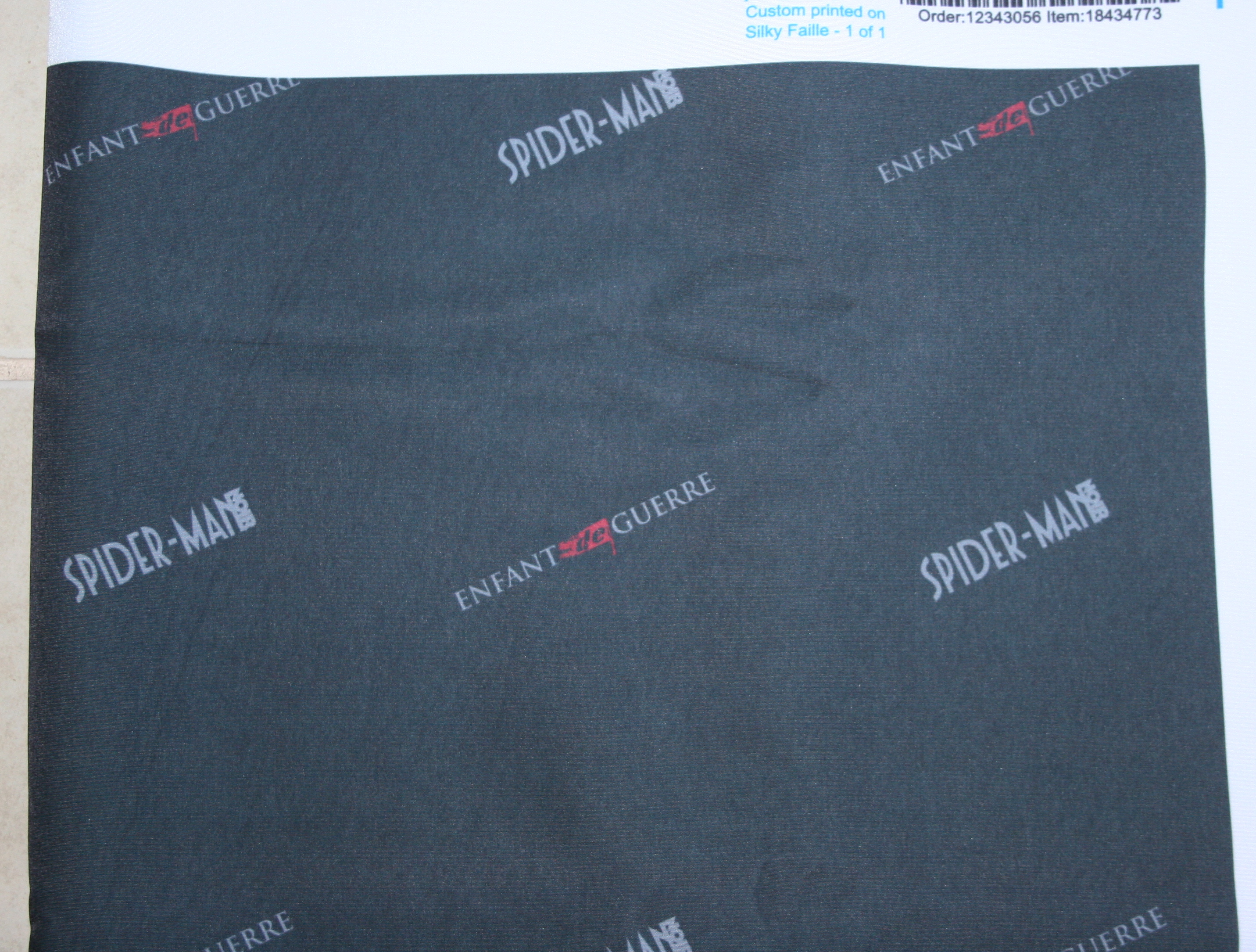

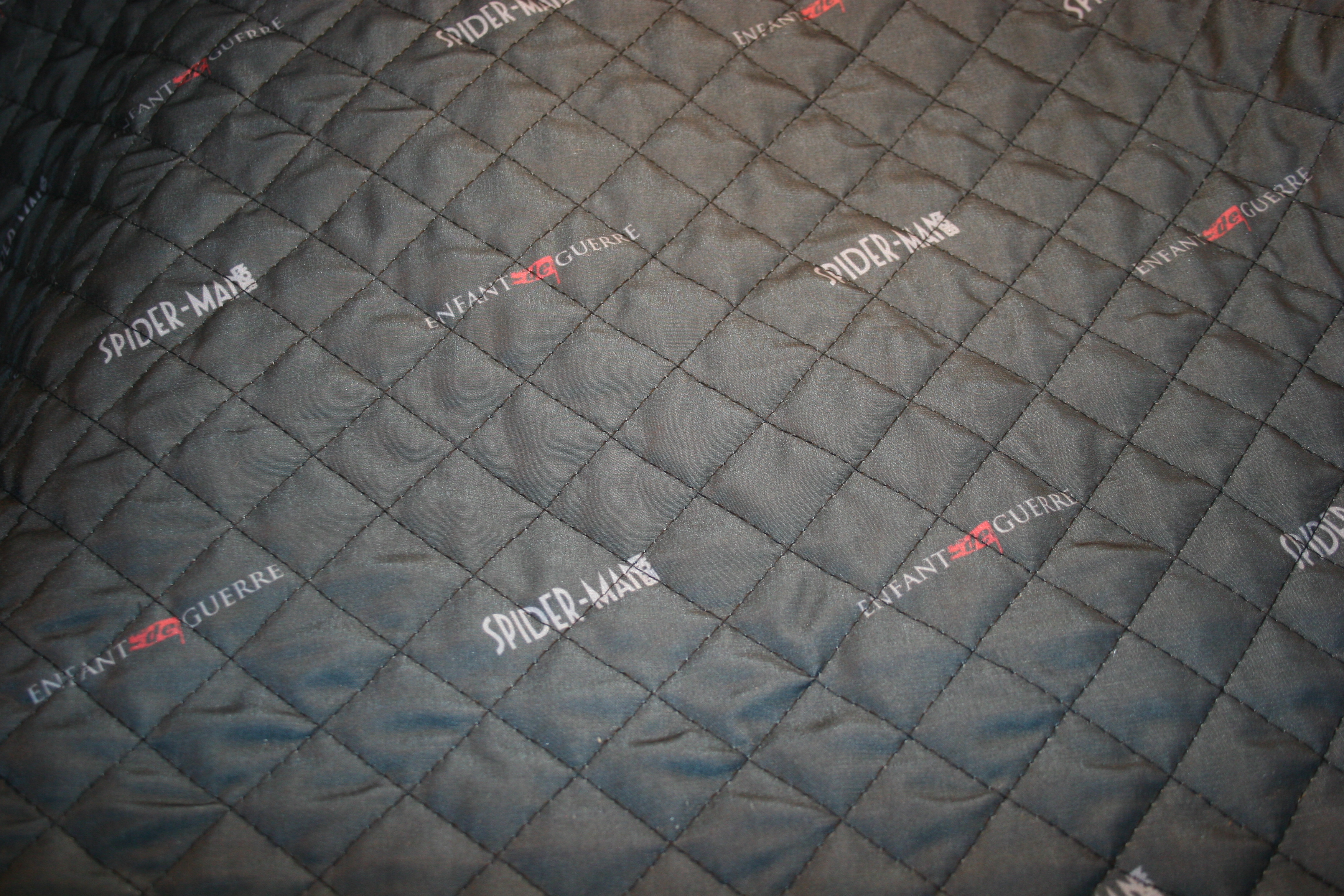

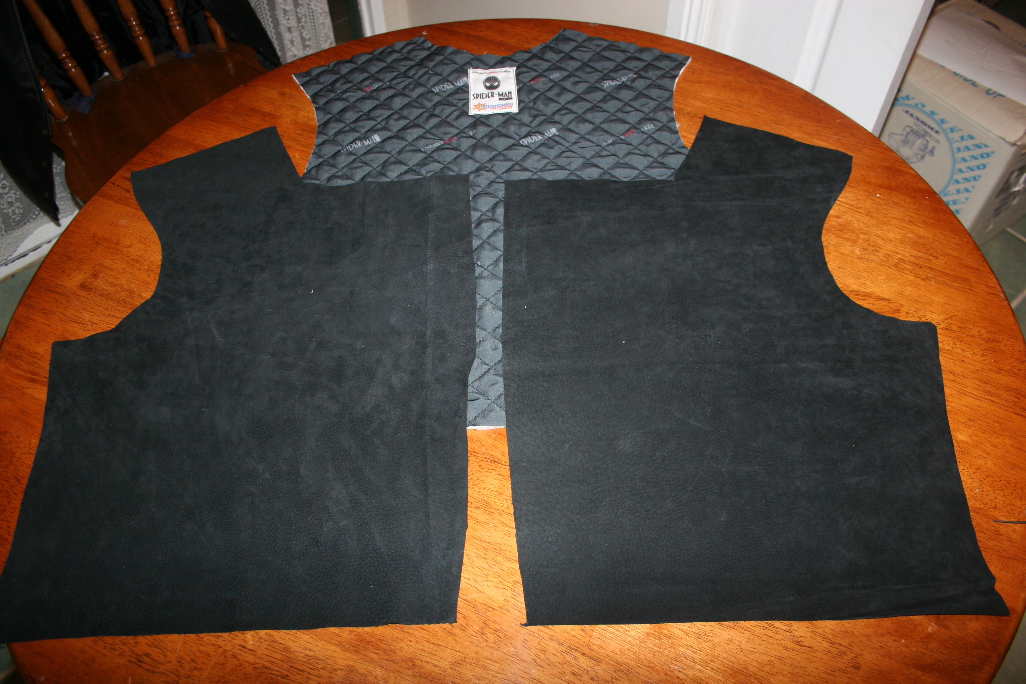

Maybe this is a bit much, but I have had my own lining printed for the leather waistcoat. I am going to quilt the lining onto some padded calico and have this on the inside back. The front breast panels will be lined with suede.
Hopefully I will get started on this during the week.

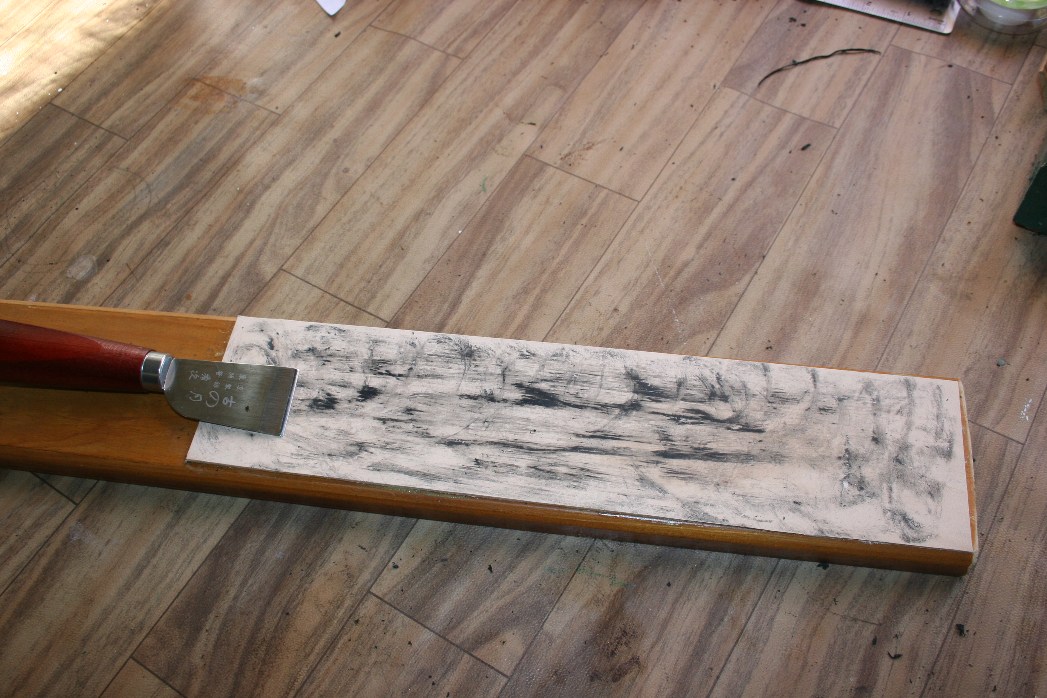

I mentioned the other day how much I hated skiving, well it seems like I hated it because I didn't really know what I was doing. You wouldn't think that stropping your blade would make that much of a difference but it makes a huge difference, particularly when you are working with soft leathers like the stuff I am using on the skull cap. I was getting so frustrated with my hopeless skiving I made my own strop. It was really simple. I cut a piece of 2mm vege tanned leather about 80mm wide and 350mm long. I glued it to a piece of dressed timber about 500mm long. I rubbed it with the grey buffing compound that I use on my buffing wheel and then stropped my skiving knife. Instant improvement! Now I just leave the strop next to my work area and sharpen the edge of my skiving knife every few minutes. It is important to have a sharp blade when you are working with soft leathers because you can stretch the leather by pushing too hard with the knife. You can see where I have done this in one of my pictures above where the edge of the leather has become all wavy. Anyway, here is a picture of the strop that I made. Looks a mess but works a treat.

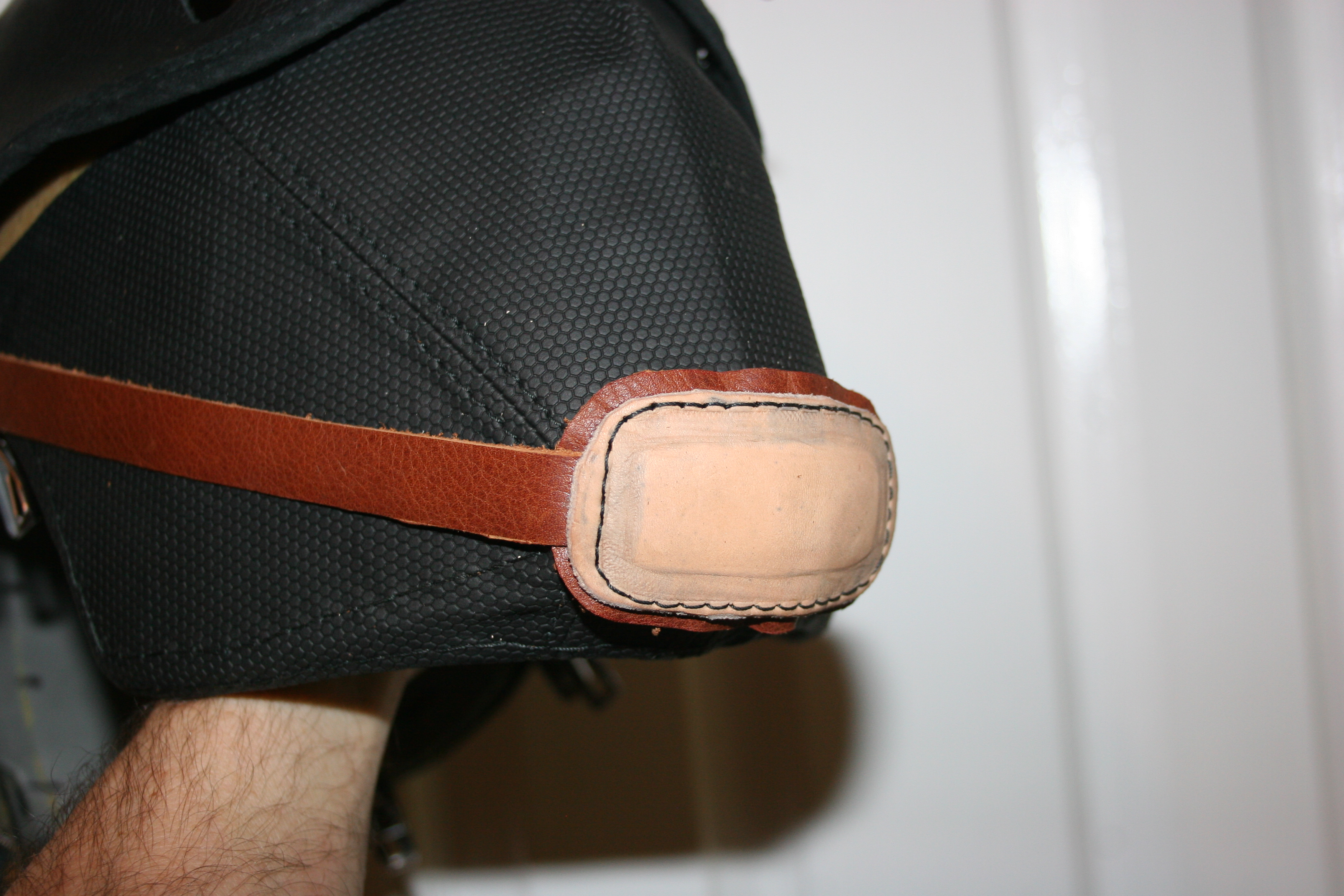

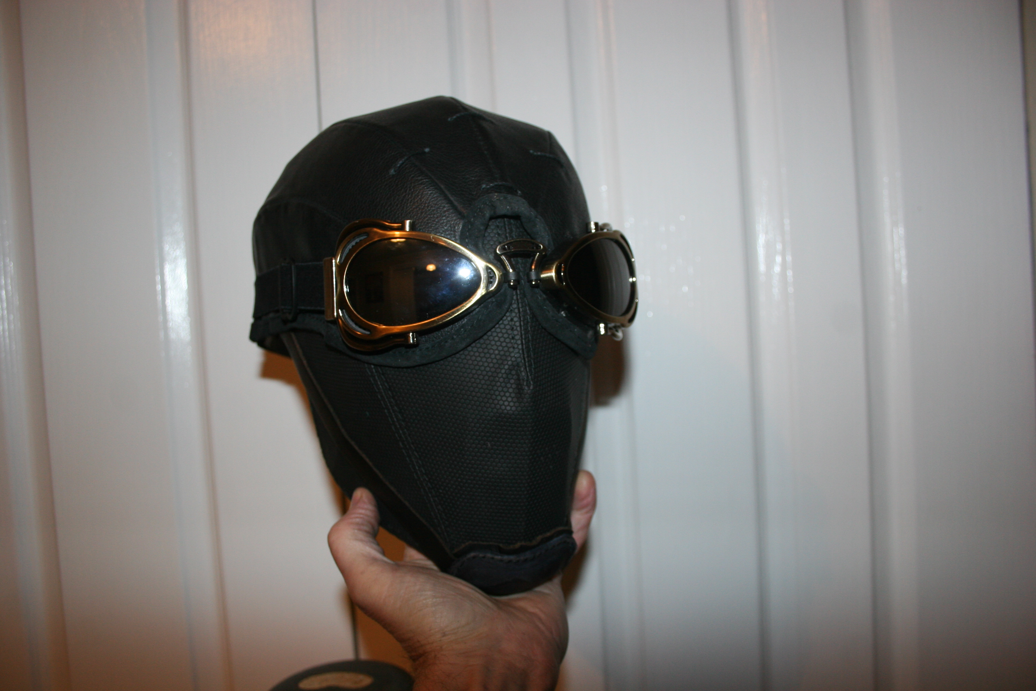

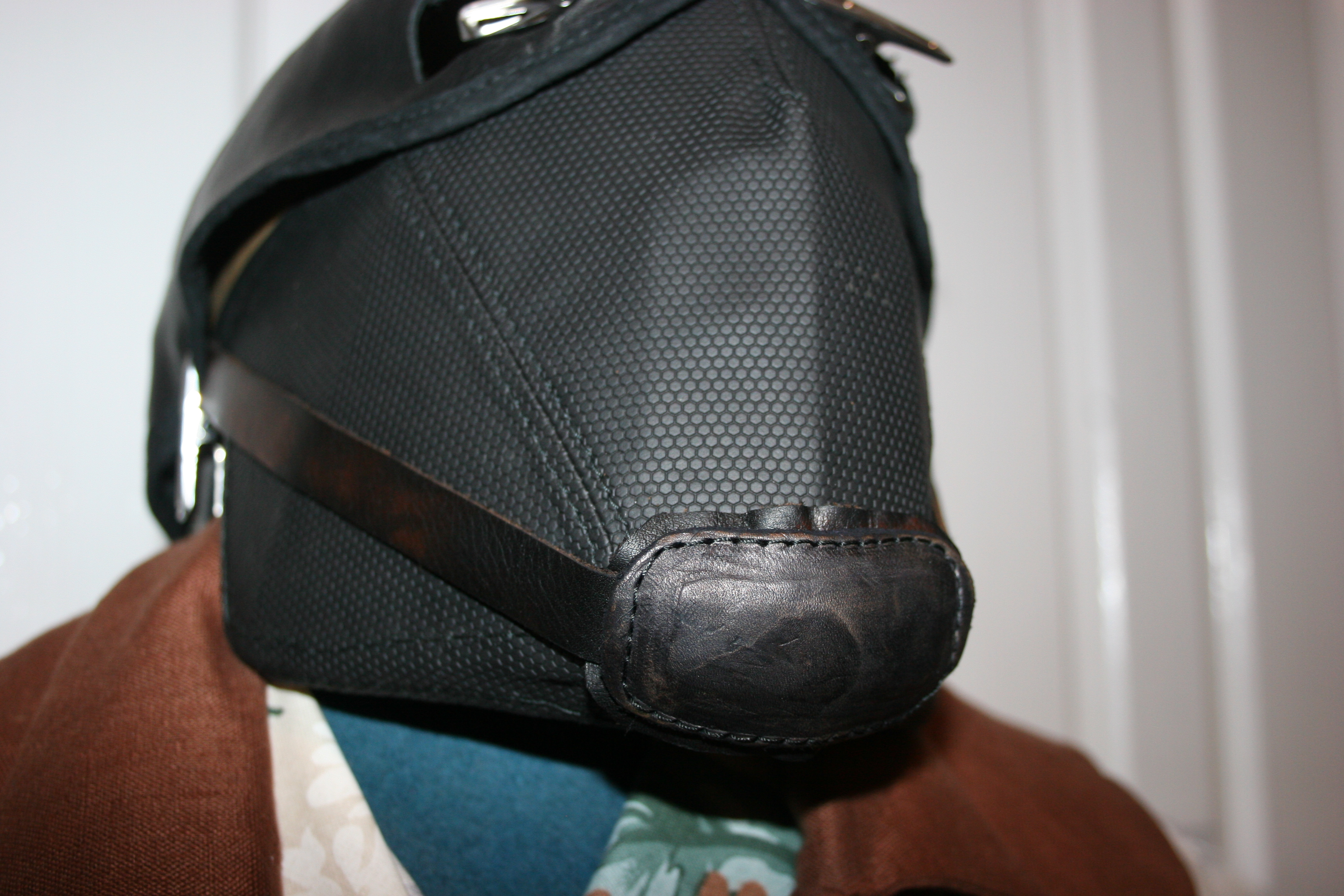

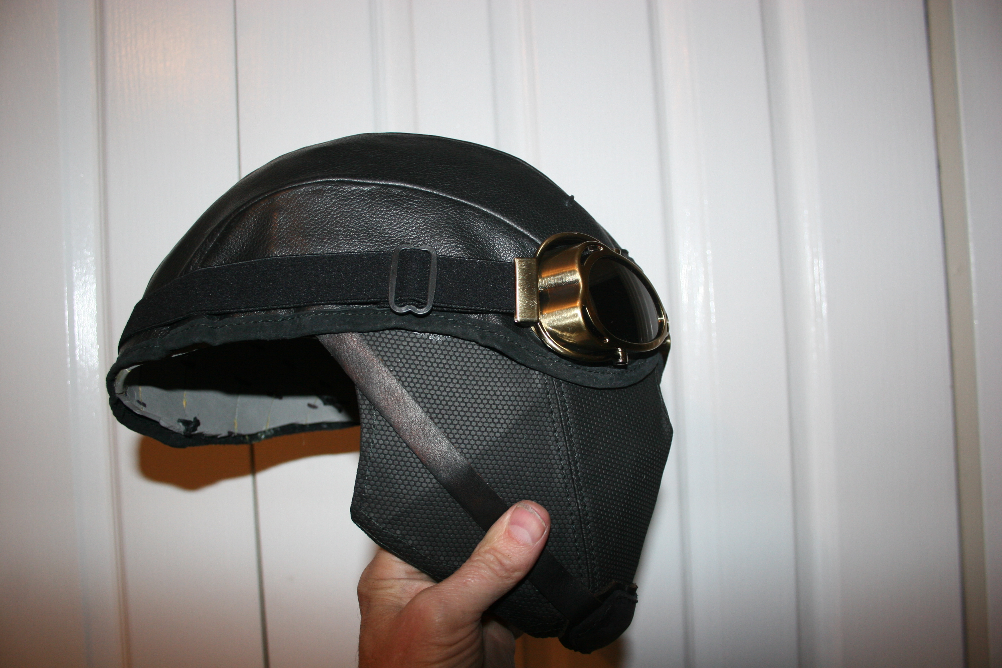

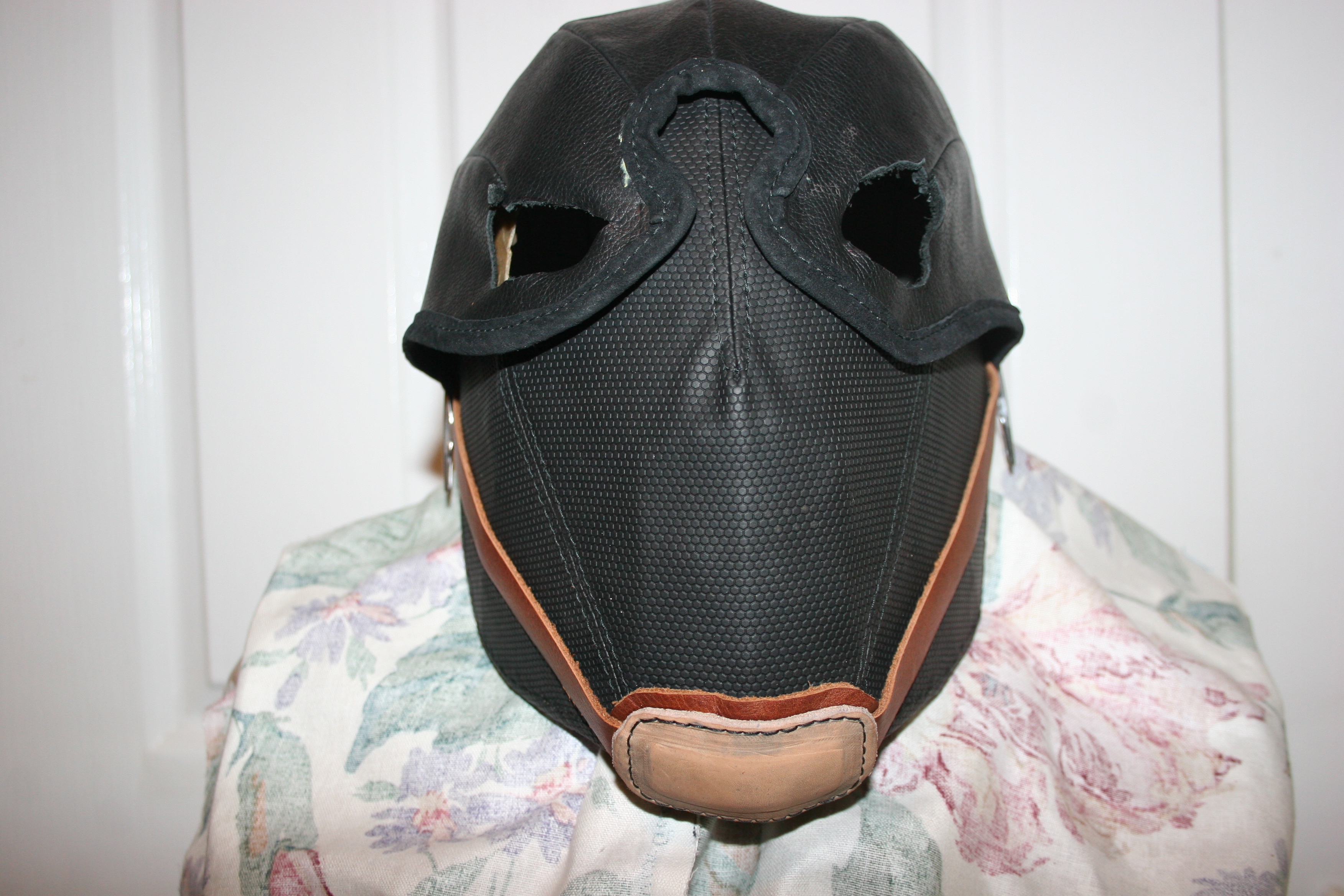

Going to be a slow day today but I have made some small progress on the face shell. I have constructed a chin strap. It will need to be dyed black as I have just used some scrap leather, but I have fitted it up to the shell and skull cap to see how it looks. I think it is going to look alright once it is dyed and the skull cap is sewn down. The skull cap has actually come out a bit larger than the shell underneath, so I might have to put a strip of 2mm EVA under the bound edge before I sew it down. I might add a buckle to the right hand side before I glue and stitch it all down.

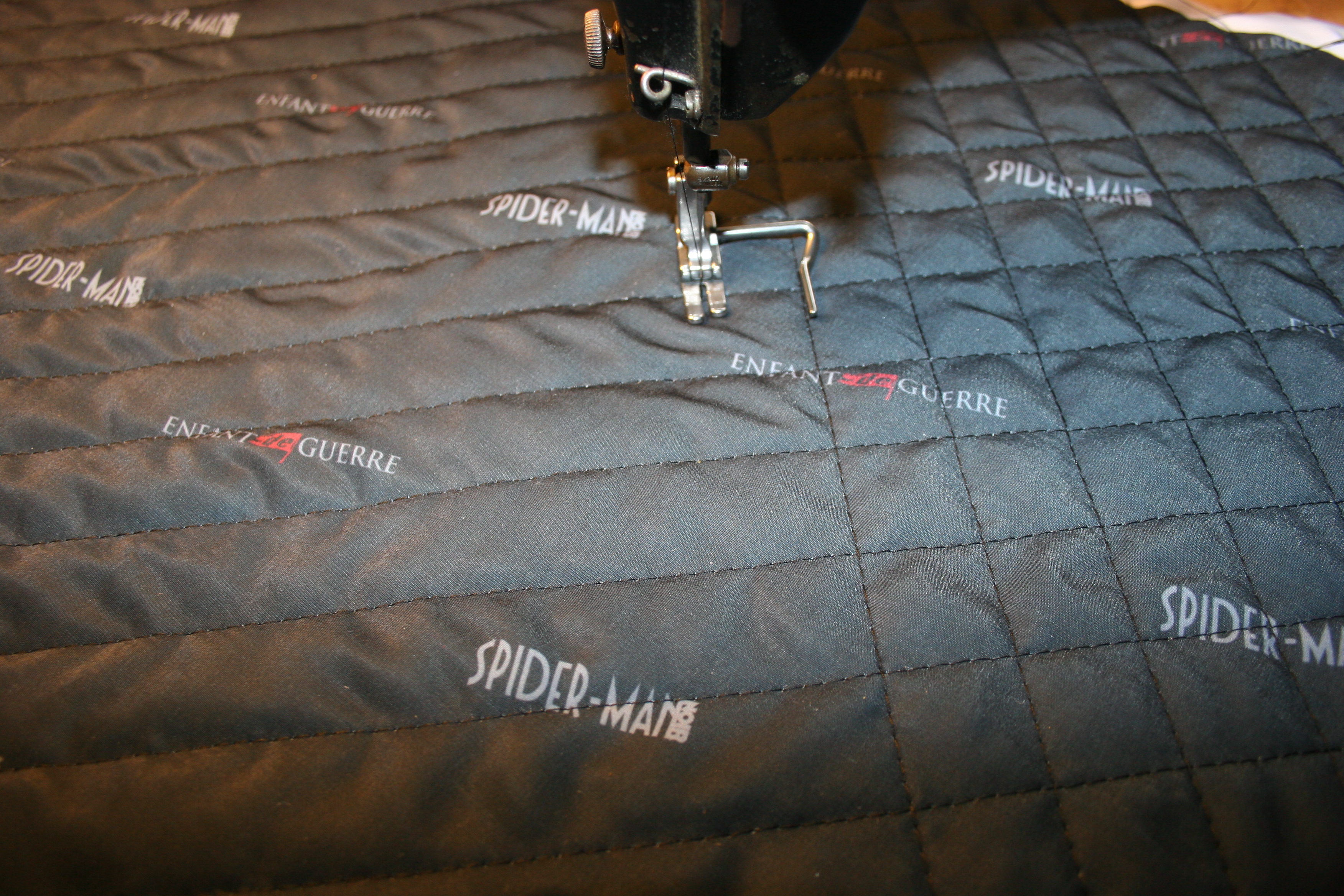

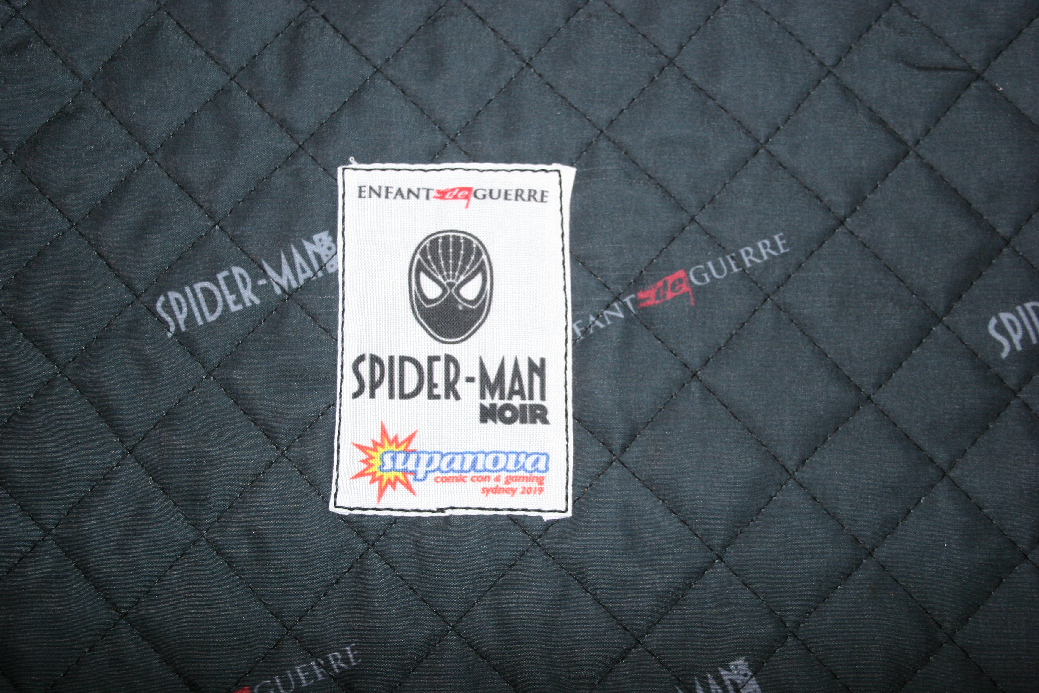

I was not planning to do much on this costume today but I started a quick experiment with setting up my machine to do some quilting of my custom printed Spider-Man Noir lining and before you know it I had practically finished.

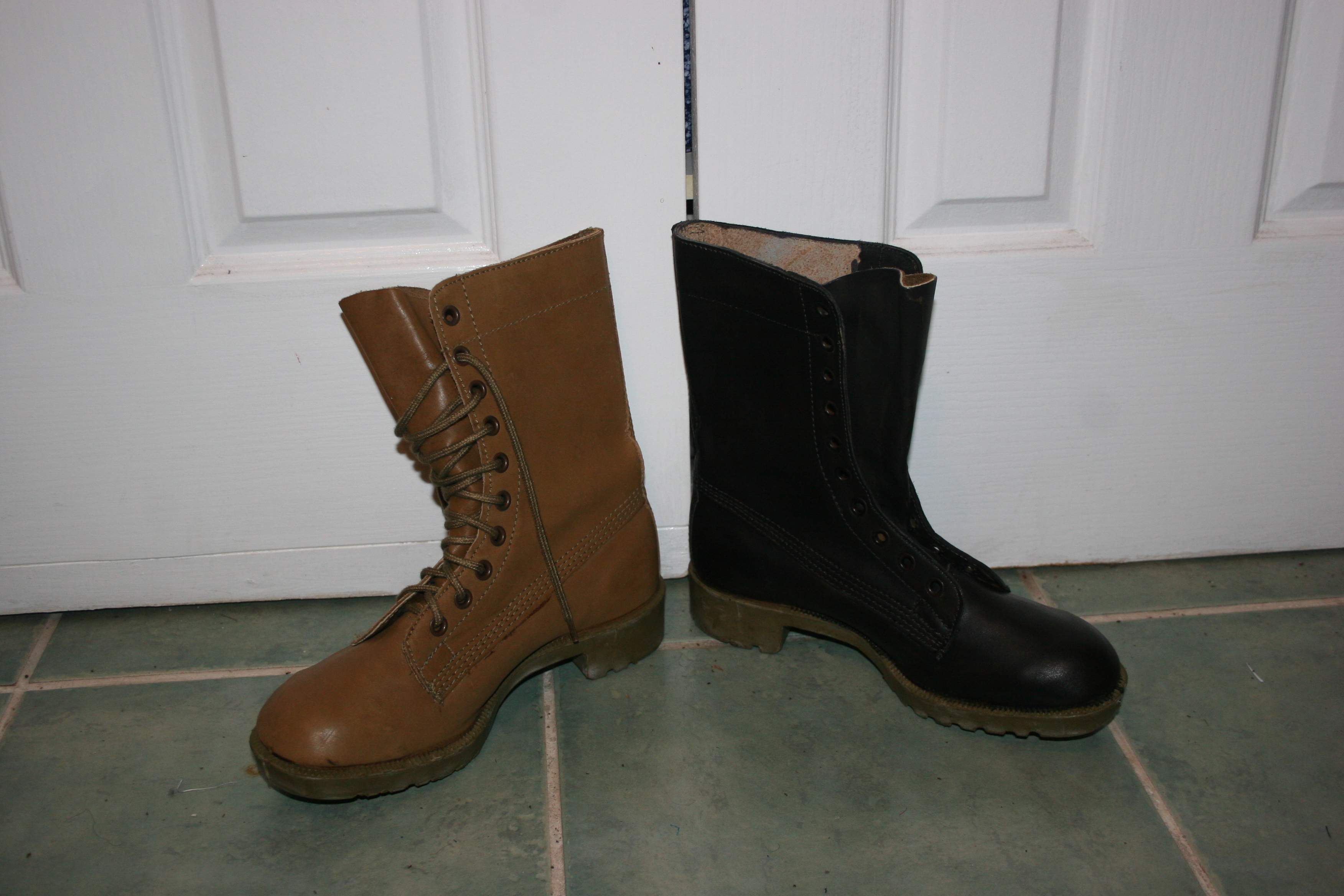

EDIT: Finished lining and started staining my boots and the chin strap.

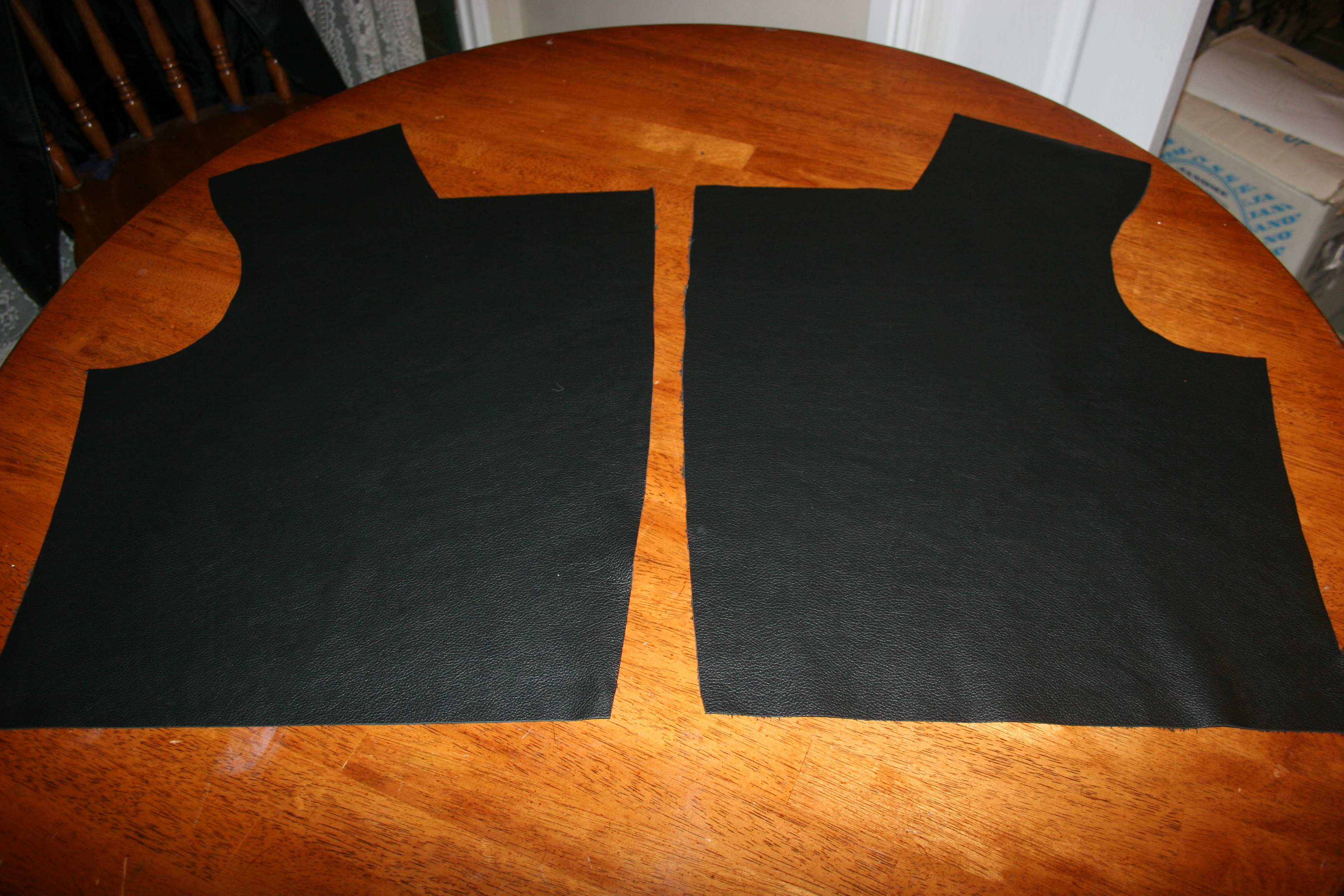

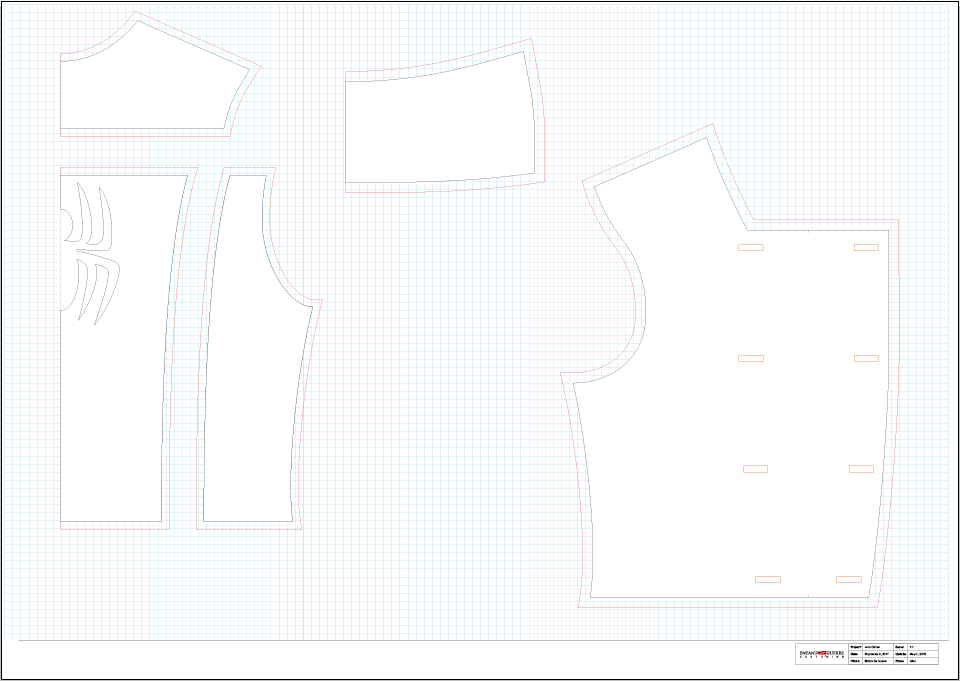

Today's the day. Going to be making my leather waistcoat today. Lining is done and pattern is cut. Now it is time to plunge the knife into the hide and hope for the best. Doing leather work is always stressful because of the expense and the fear of cocking up. There is no chance of starting again at this point.

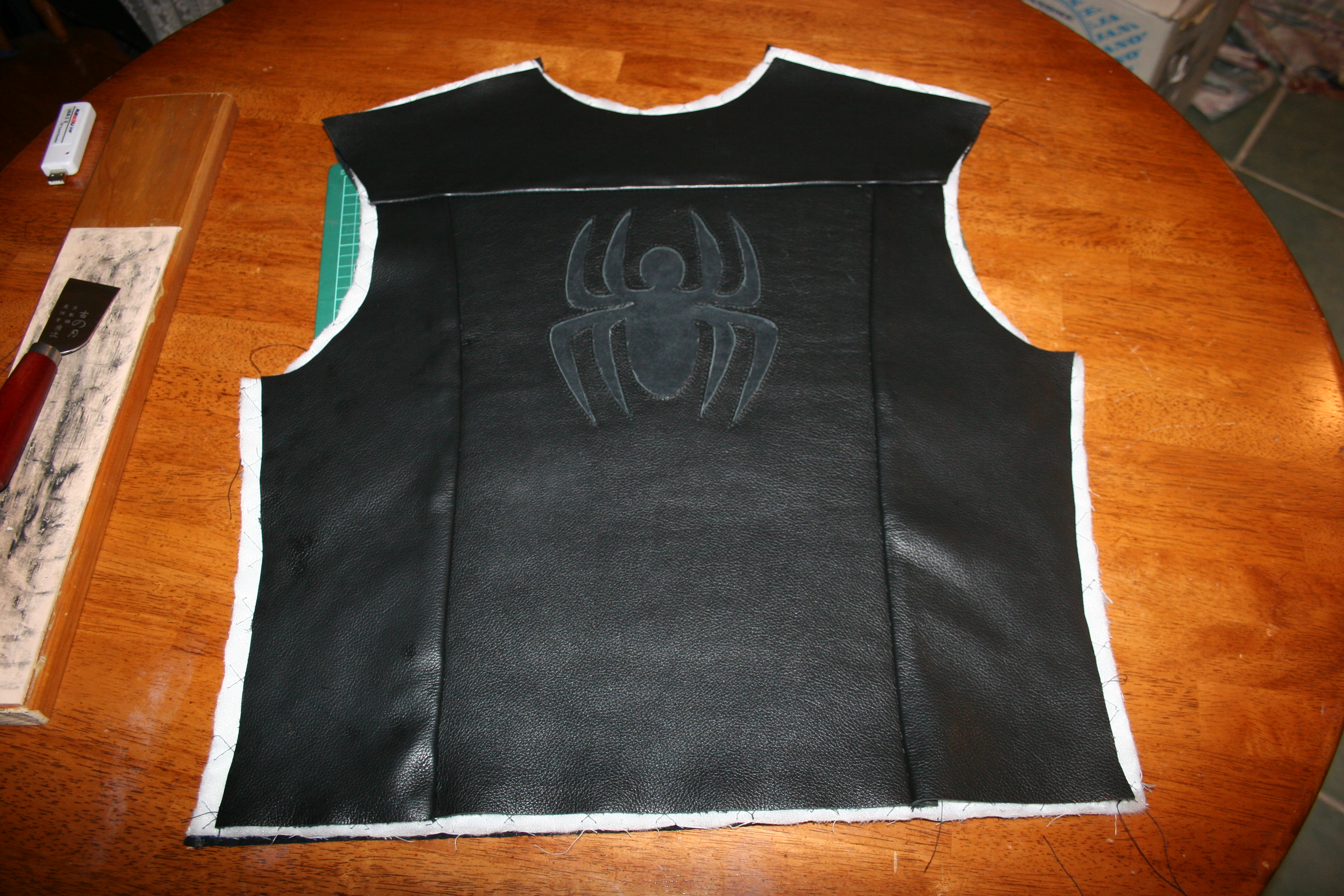

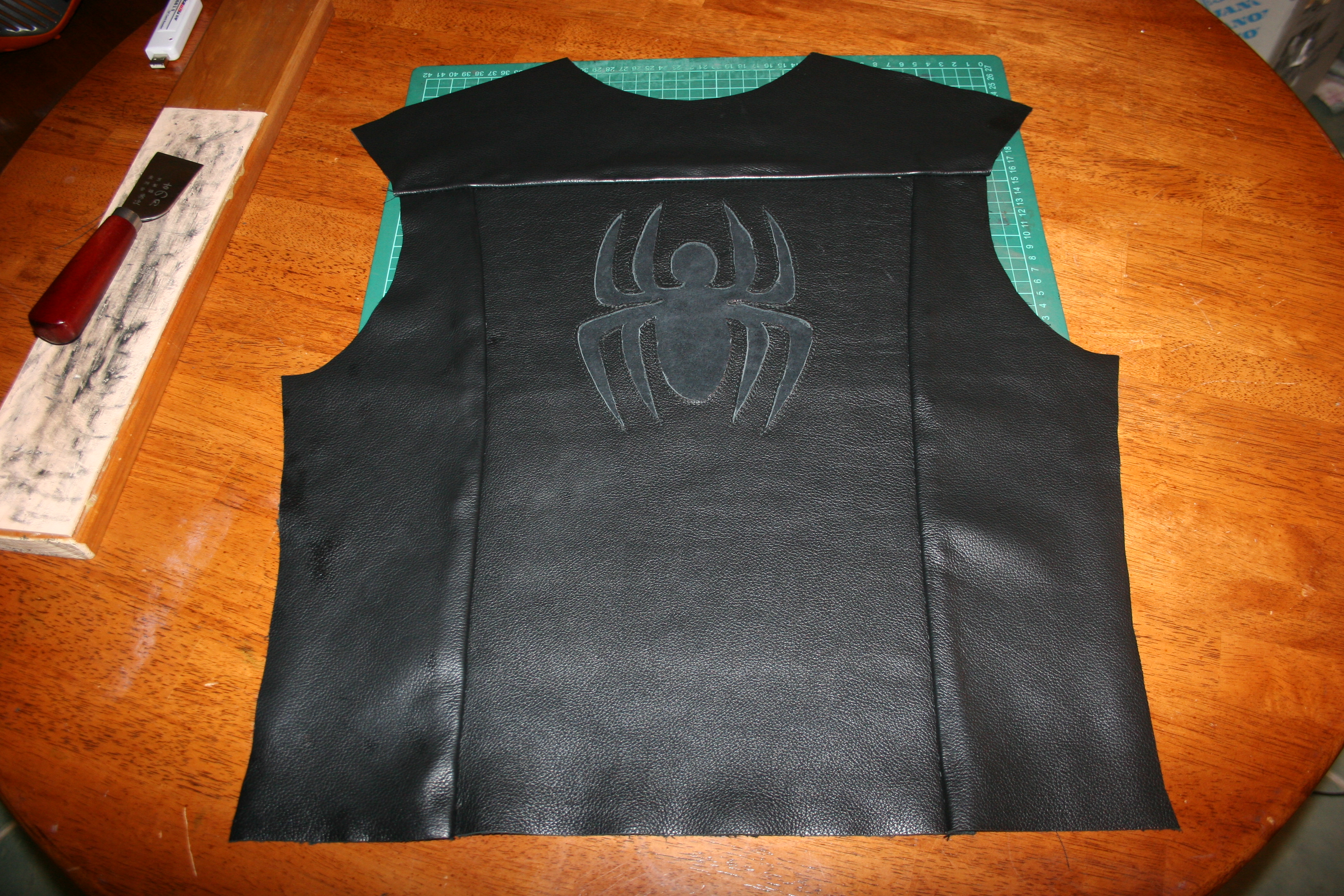

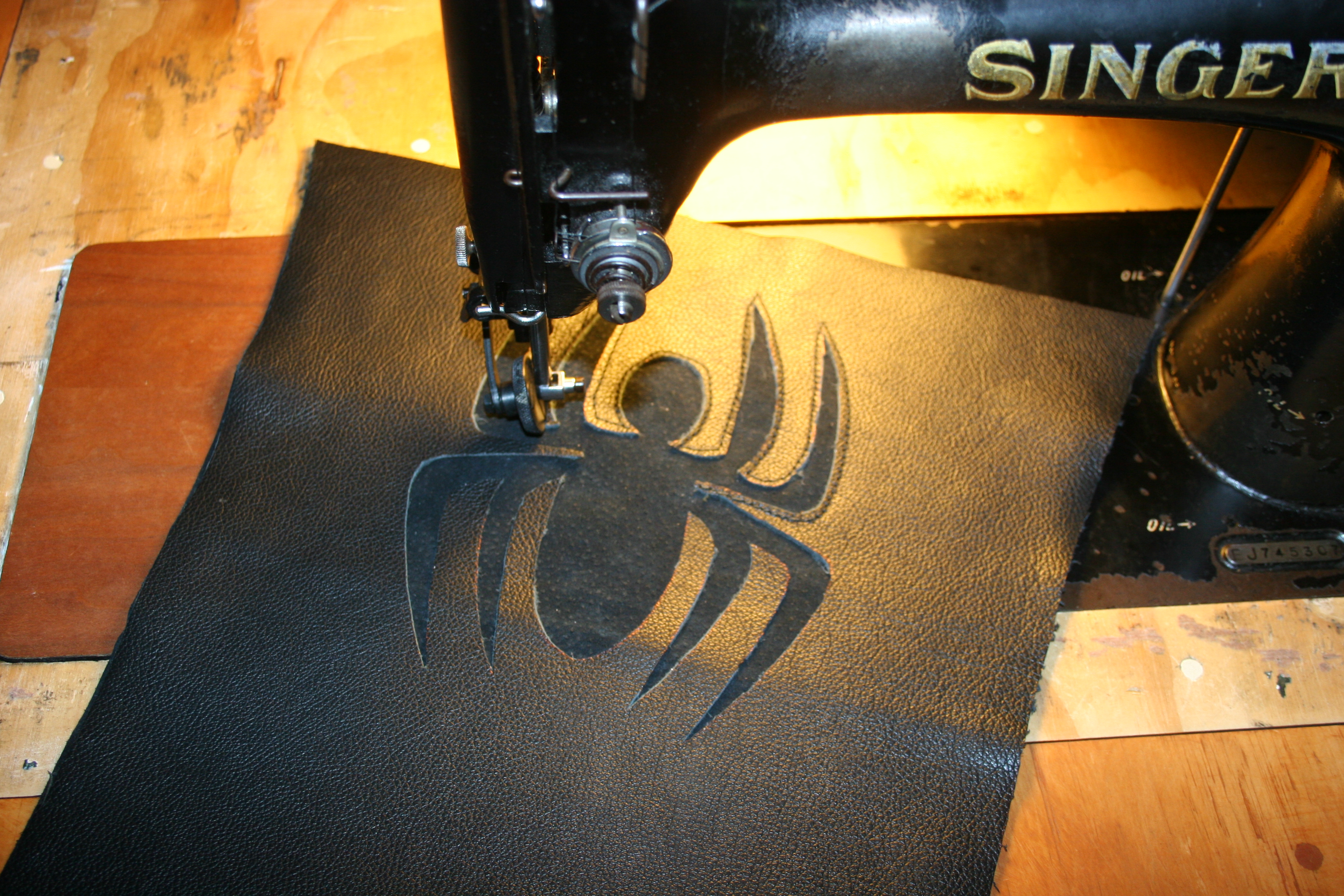

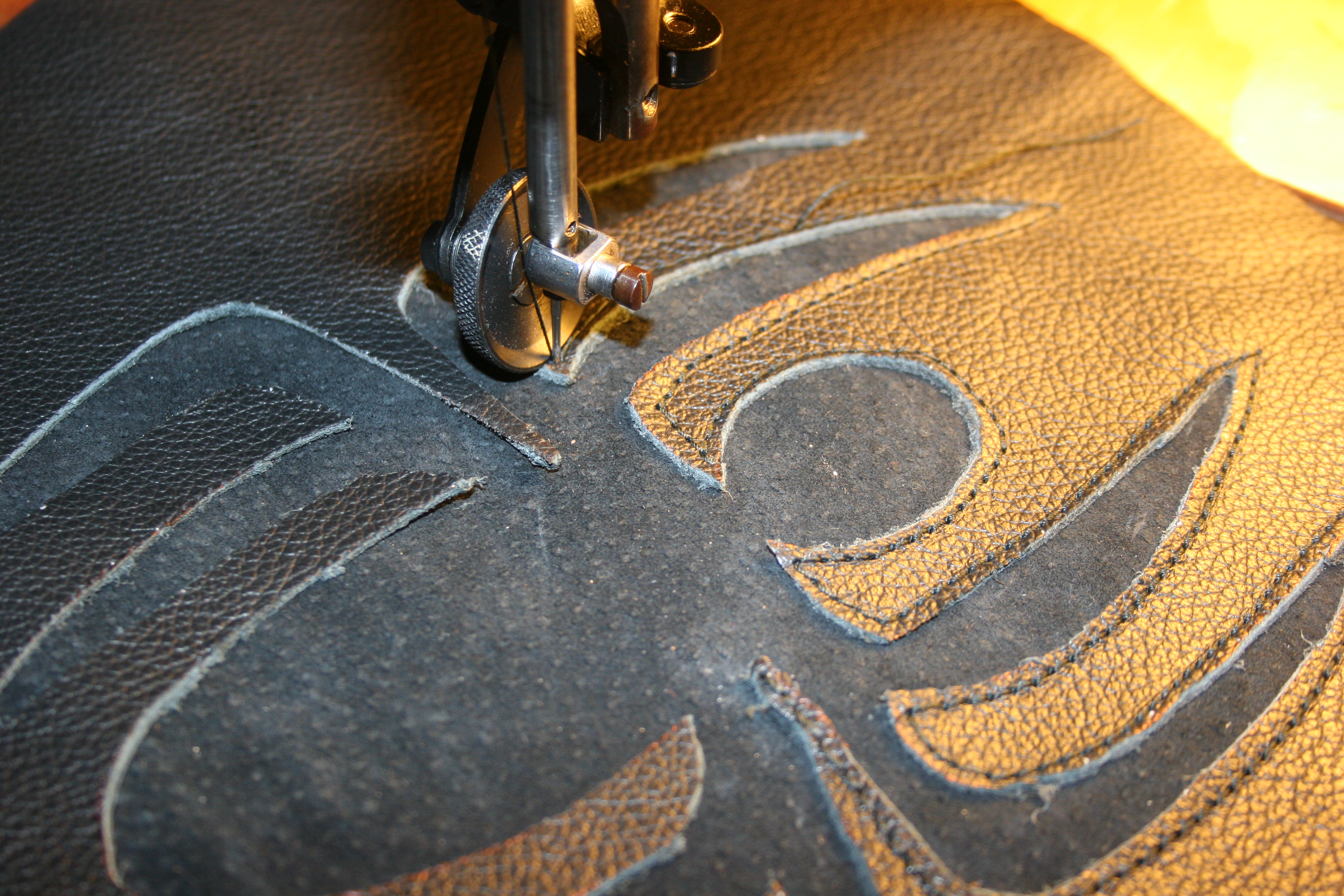

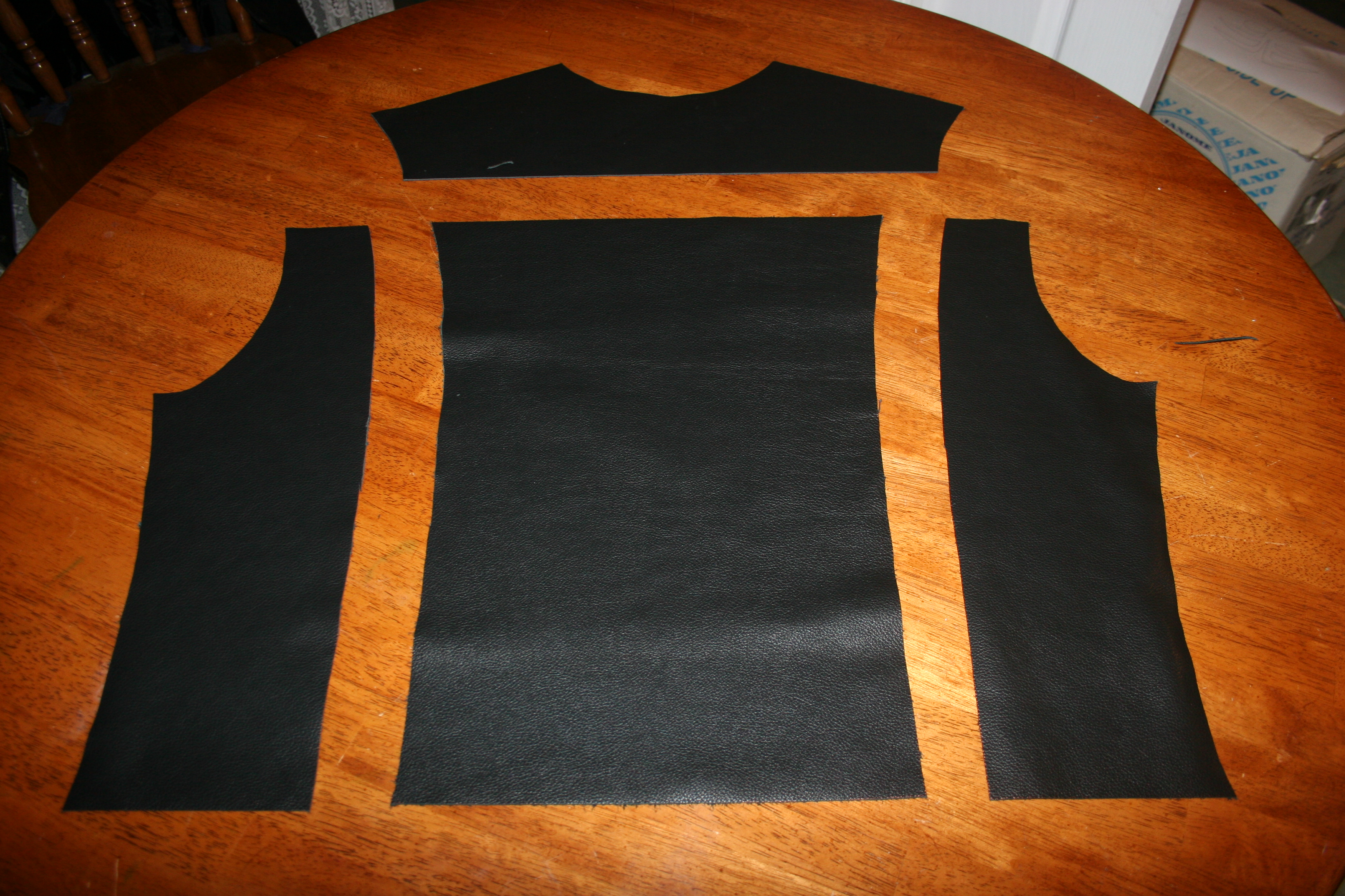

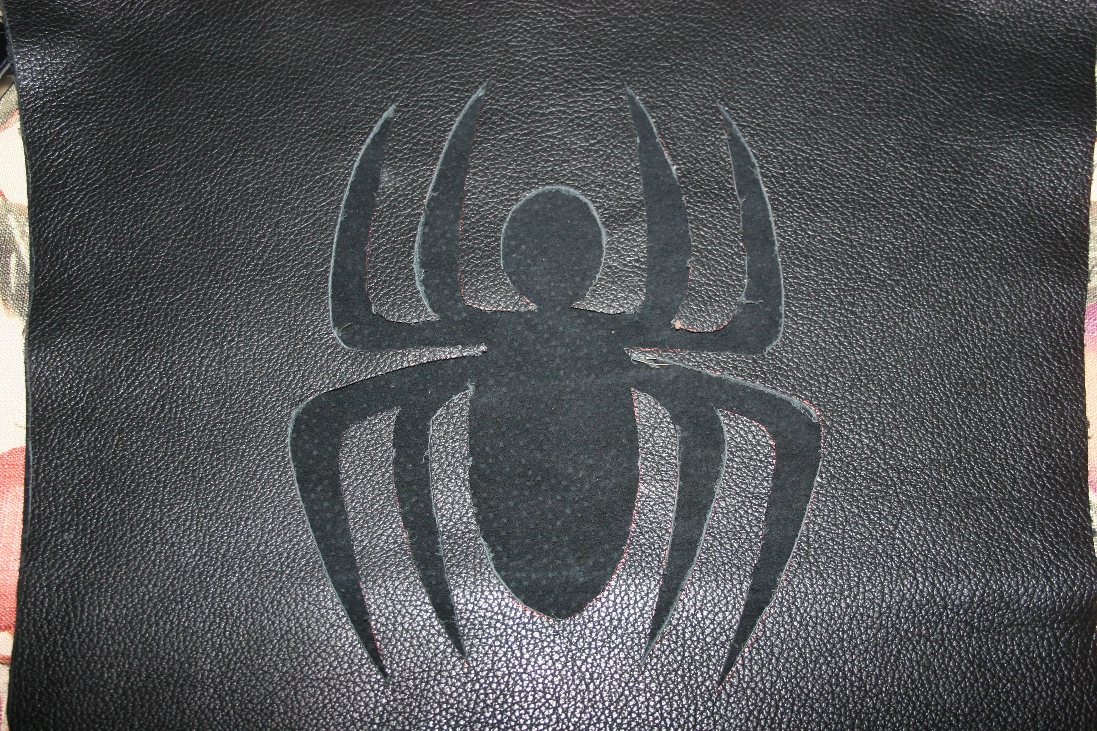

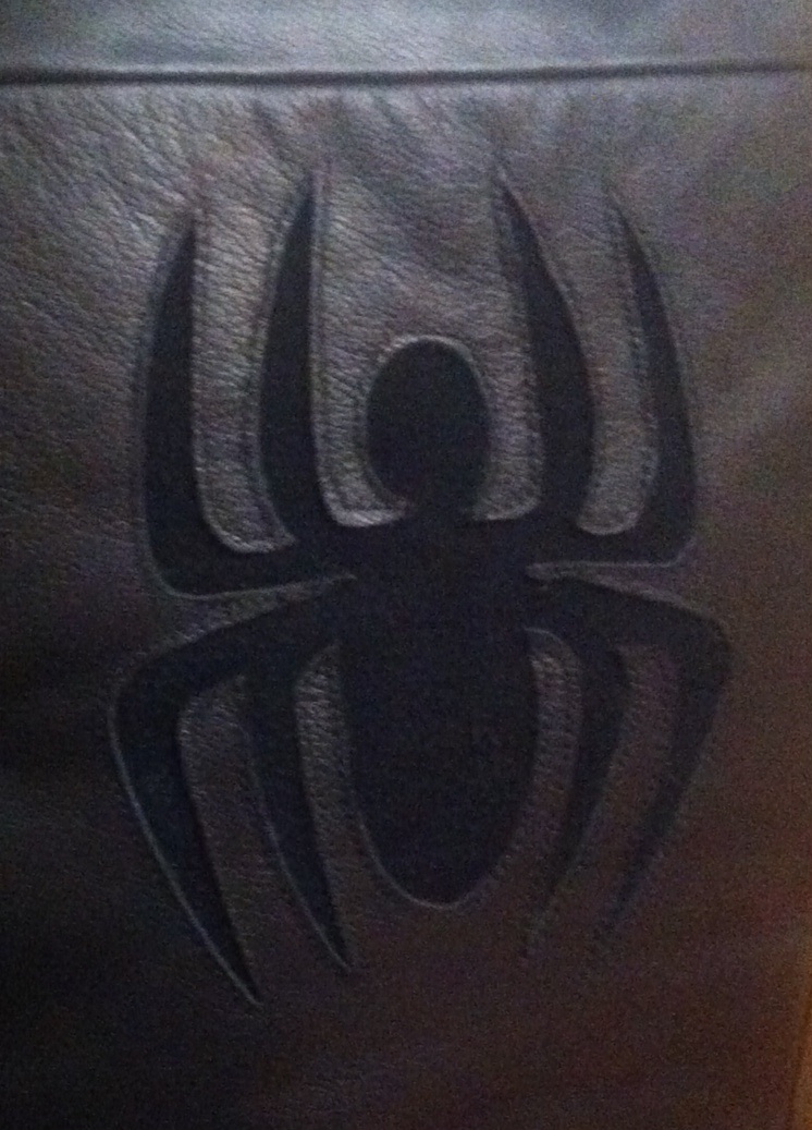

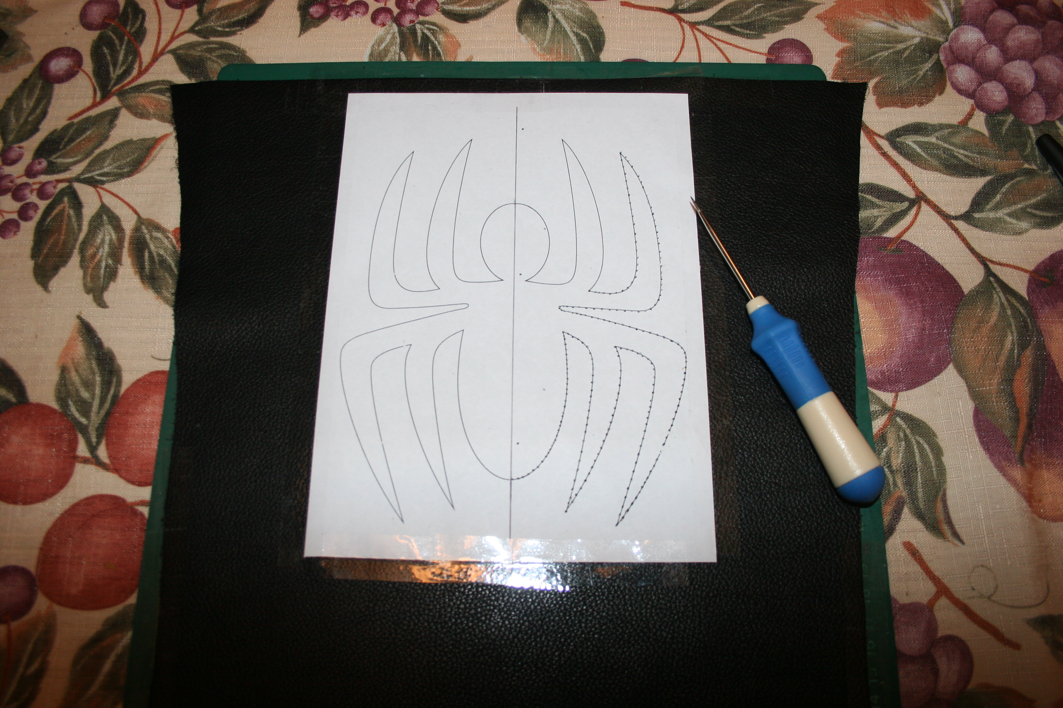

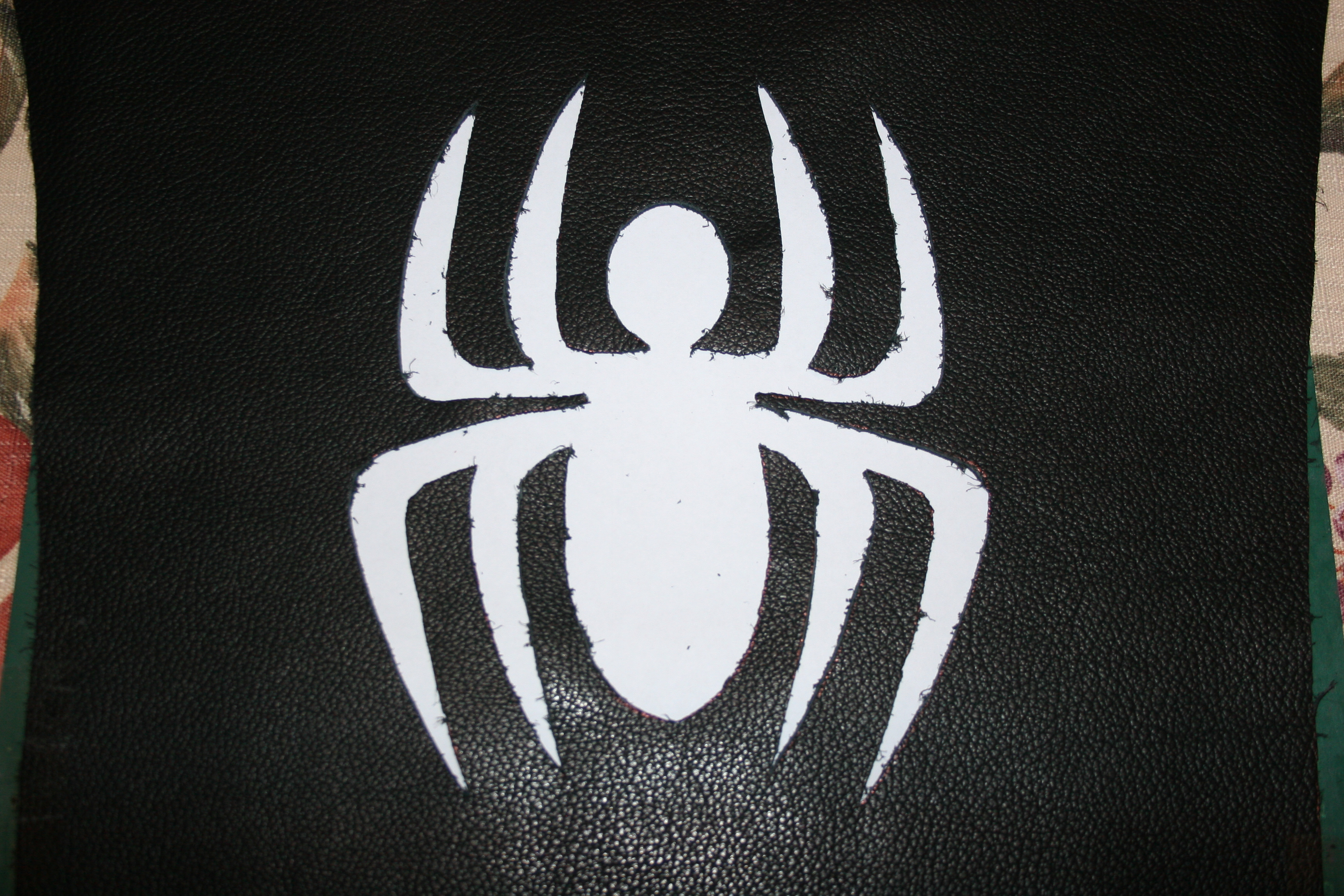

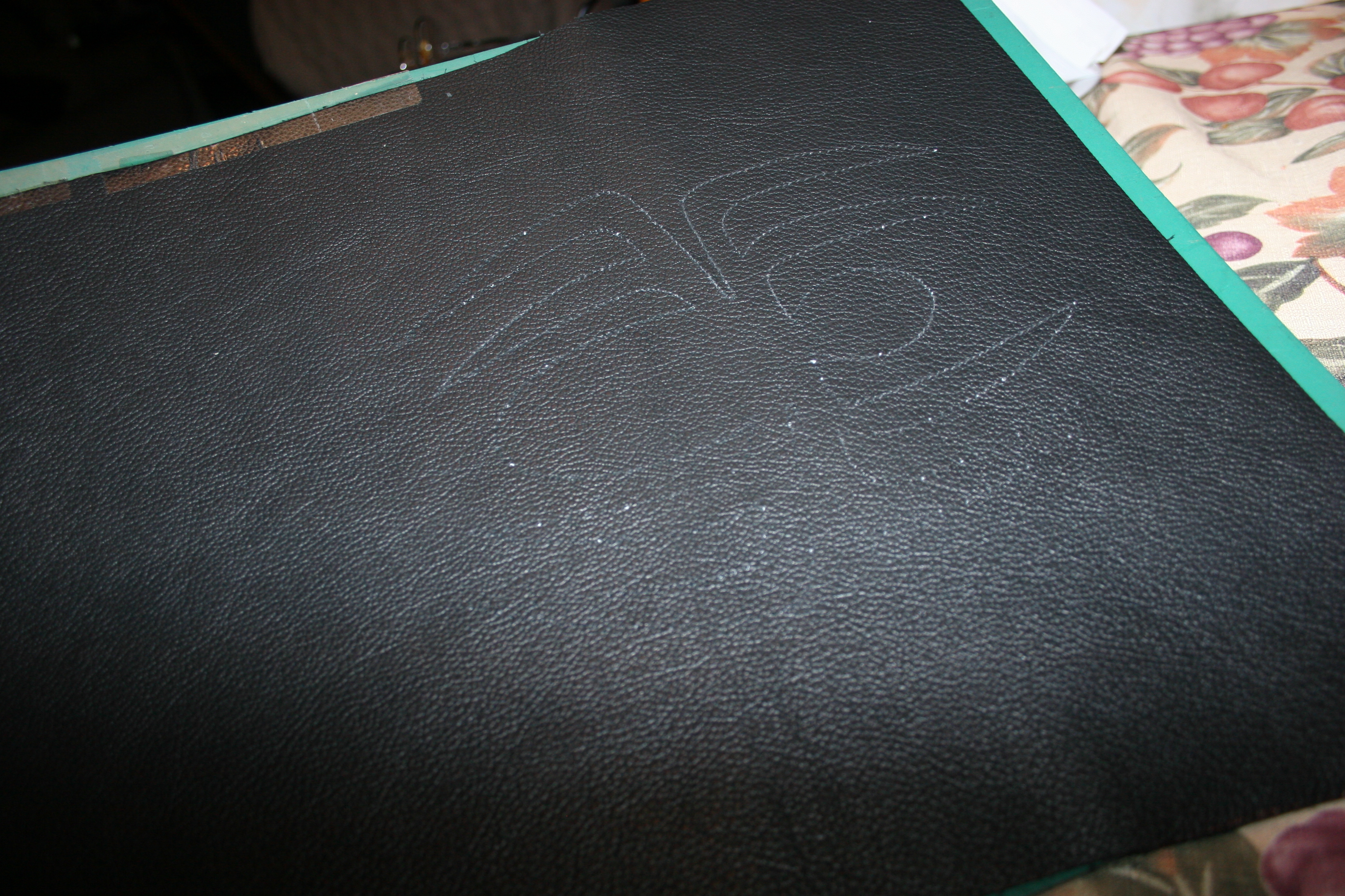

This is how things went today. Cut all the leather bar the collar. Then I had to cut out the Spider logo on the back panel. I used an awl and pricked the pattern out and then went in with a knife and cut it out. Then I lined the back panel with suede and outlined the logo with a sewing machine with a wheel presser. I attached the suede lining to the quilted back then I sewed the back leather panel together and then found that leather is a bit of a three dimensional material and it has come out much smaller than it should have. The lining is going to have to be adjusted to fit the outer. I hope it still fits after adjustment or it is going to be a disaster. The front panels have to be skived and then attached to the back. I have allowed for half inch seams so I might change the side and the shoulder seams to quarter inch and that might help me get back some of what I lost sewing the back panels together.
