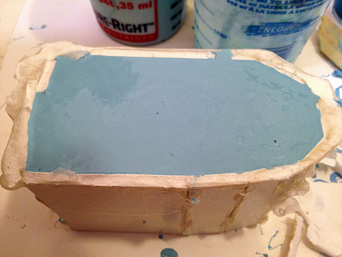

It's time I contributed something to this project. First, my disclaimer: I am as much a mold maker as I am an astronaut. I love the idea of both but either one could end very badly since I have no formal training in them. So don't judge me on the quality or technique of my mold making. My motto is, "As long as it works."
Having said that, Indie wanted me to cast the curved tube piece that goes on the side of the helmet. We need two of these and they need to be more durable than the constructed piece. So sure, give it to the guy who doesn't do this for a living! :eek

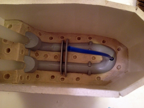

The first thing I had to do was figure out how I was going to cast this. I could have done a fiberglass jacket and try to be all fancy, but this is really a waste mold so I didn't see the point (and I didn't have any fiberglass). So I figured out where my mold would seam together and clayed up one side of the piece, cutting it roughly in half.
Again, not the cleanest mold by any stretch, but ready my disclaimer above.
Around that I bent some foam core and hot glued the #$&! out of it. Nothing is more disheartening than to check on your mold 30 minutes later and find all the silicone spread out in a nice puddle. Not that that has ever happened to me. I just hear that sometimes happens. The blue thing you see in the photo is actually a 3mm piece of plastic that I attached to the end of the piece (which curves up) to help avoid air bubbles being trapped when I pour the resin later.

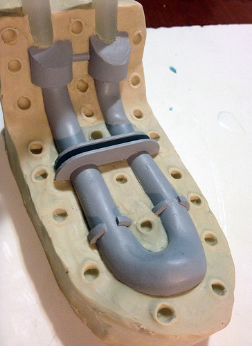

I failed to take any photos of the poured silicone on the first half, but it looked a lot like the second half, which is pictured below. I did remember to use mold release before pouring the second half. The LAST thing I wanted was to lock this piece in the mold and have to tell Indie he needed to make another.
This morning, I said a short prayer to the mold making gods that I used enough mold release as I started to take the mold apart. Clearly they exist, because the mold came apart pretty easily. I have some cleaning up to do on it, but I've done worse. It's a chunk of silicone, to be sure, but I believe it will work just fine! I'll know this evening (or at lunch) when I go to pour the resin.
I'll post pics of the resin piece once I get that done. That will get passed off to Indie so he can do more cleanup on the piece that the original would not have endured.

Nice work on the mould Digitizit. I too am going to have to tackle a 2 part mould (my first go) when my Halo MK VI helmet is done so I understand your need to call on the mould gods.

SO, glad the casting worked out! I can't wait to get these tubes cleaned up, painted and then bolted onto the helmet! :):thumbsup

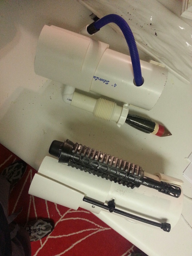

THANKS MAN!!!!! Yes I do have quite a few pics......when I leave work this evening I will see about putting some up. Im actually very excited about "presenting" it to someone to have a look at so I suppose this is a great place to start:) I have changed mid build several times I am actually getting a different pair of shins already bc I made the arms very bulky it ( second set of arms I was not happy with the first set) felt a bit top heavy so I wanted bulkier legs to sort of even it out? I have borrowed elements FROM EVERYWHERE. So its a bit of a hodge podge......its also not in traditional "steampunk" colors......its a blue that changes to purple depending on the light (colorshift paint) silver with brass highlights, havnt done much brass work yet bc that is the phase I am on now. I sort of built this one backwards bc I kept chaniging my mind but hey thats how things evolve, my original sketches looked like a subzero mixed with Iron man and now it looks like some weird robot thing LOL. So ya stay tuned pics to come..........Moetron 1.0 not to be confused with motrin.
Let me go ahead and tell you how what I have working on came to be.
The Chest and back piece, butt, cod and upper and lower legs are from a tall clone trooper kit. The lower legs are being replaced by a different set so for now they still have an overall Clone feel to the lower half that will change soon. The arms are custom, shoulders and biceps are from the newest IM custom built foam and the guantlets are custom made from 4 inch PVC some toy guns a resin rocket and some other nonsense I slapped together...I think I broke apart an old cell phone and used some parts also. The ab is a rubberized ribbed floor mat with wires zip tied on and it has a very C3PO feel that as of now I am not really feeling. I bought the arc reactor off Ebay made the shoulder straps from and old bucket and a few different old leather and nylon belts.Last night I added some belts on the sides to "pull" the front and back together. Just posted 2 lil ones I had here-----the lower one is a comparison pic where you can see I bulked up the shoulder strapping with the belts. Over the top I used old leather belts that just happened to fit perfect in the groove of the bucket( i may add some "rivets" to that top leather strap) and I used a tactical nylon belt from my Umbrella soldier get up......the other picture is after the first night I started working on the second set of guantlets so these are them in the rough form.......so yall BE NICE LOL

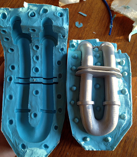

I just poured the first (and probably only) casting from the mold and I have to say I'm pretty pleased! Since it is a waste mold, I'm not going to be very picky. There is maybe 60 seconds worth of cleanup on the piece pictured below, since Indie is going to do a lot of work on it. I've pictured it with the original just for comparison.
Re: Steampunk Ironman Helmet WIP - 3/14 update
You know that looks great!! I was worried about the thin veins,but they come out fantastic!

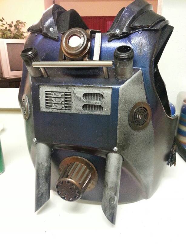

So hey yall........Got my helmet on Friday and it consumed my weekend. I got the whole bucket primed and ready to paint ( the paint has to be ordered online:( so it will be a while) meanwhile I went shopping @ Home depot and raided the plumbin section for all kinds of greeblies I could use and had some great luck. My large canister should be dry and ready to install on the back piece today and I can start adding lights to the back. Some hoses a few wires and the large canister and the back will be finished.....well until I get the smoke machine installed behind the back plate that is...
Pool, sprinkler and plumbing parts ( faucets, drains etc had great luck finding things to repurpose.
I love the work you did on the back armor! And the texture of the paint is pretty cool - I like the two-tone faceplate! (y))
