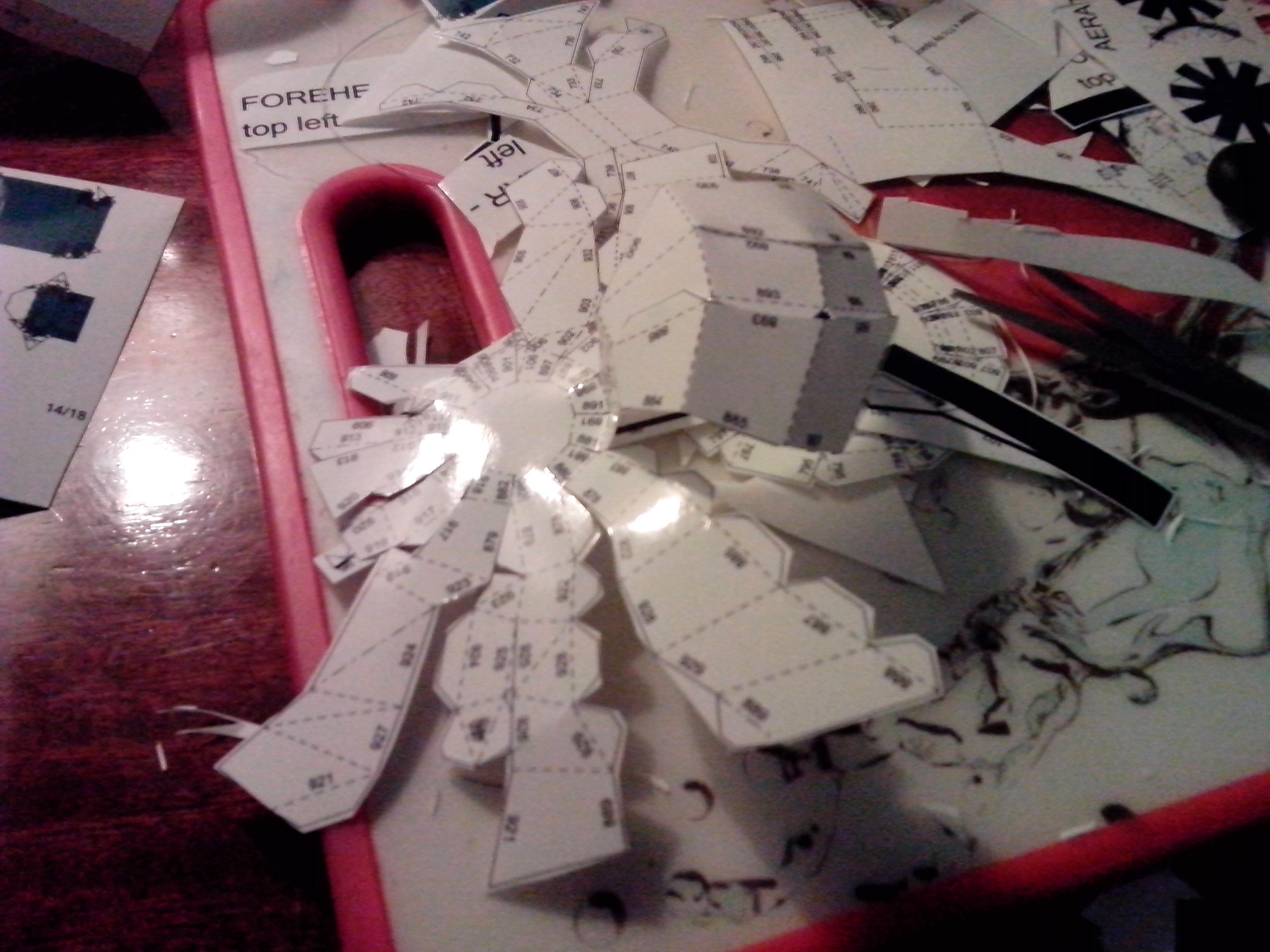

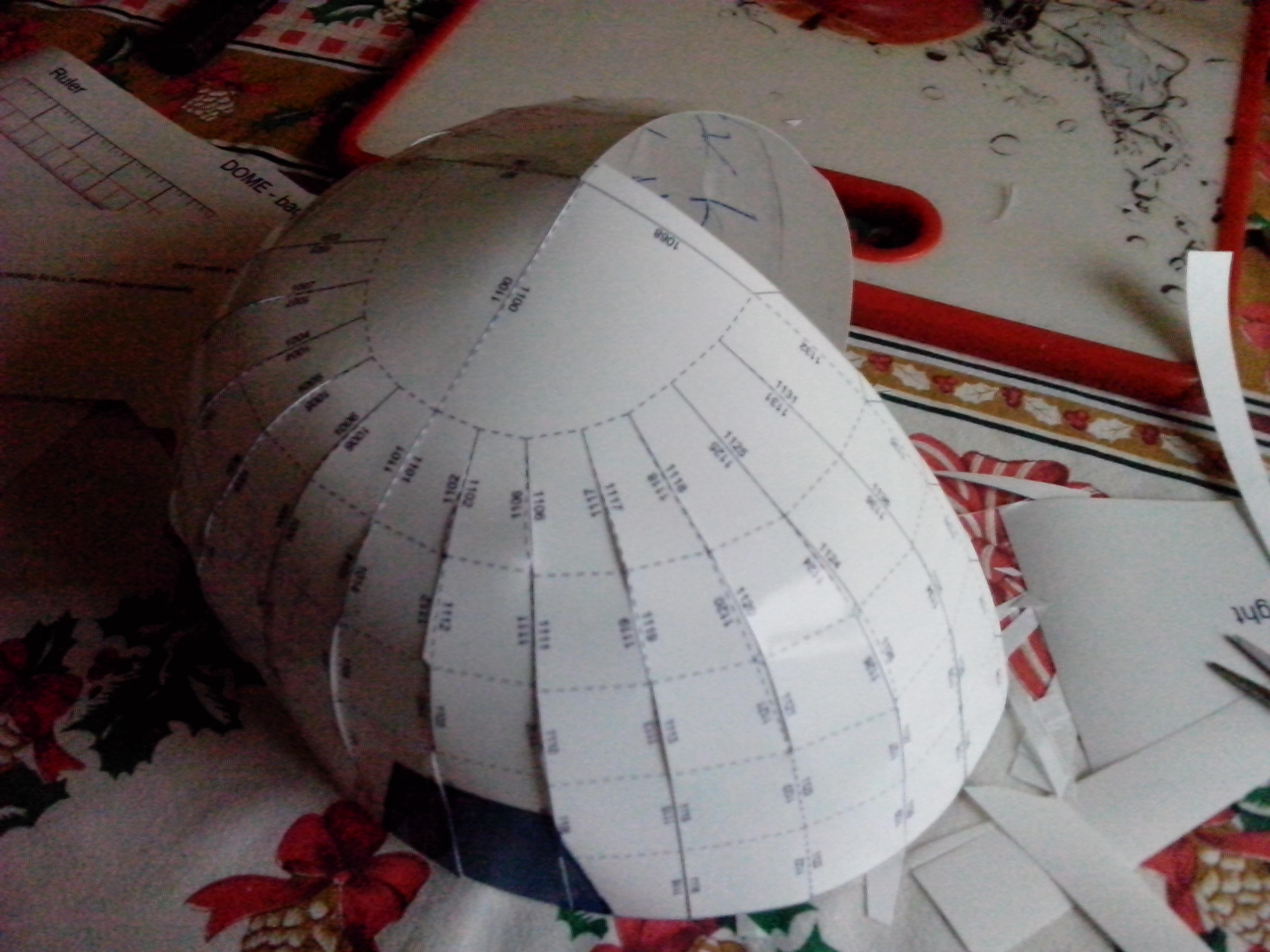

Hello. Awesome build. Im new around here, just started to do my own bucket after seeing this and its been harder than i imagined. Been strugling a bit but i keep thinking if i get trough the paper phase i can fix the warping in the bondo stage. For now im trying to cut all the molds as best as possible and glue them with super glue. Anyone knows the diference between mountain fold and valley fold hehe?
PS: English is not my native language, thank you ;)
Is this thred dead? I completly botched my build. Nothing fits and i dont know how to conect all the pieces with everything. going to print again. I stil dont understand the diference between valley and mountain fold and im really frustated.
Printed surface
/\ mountain. \/ valley
Backside
