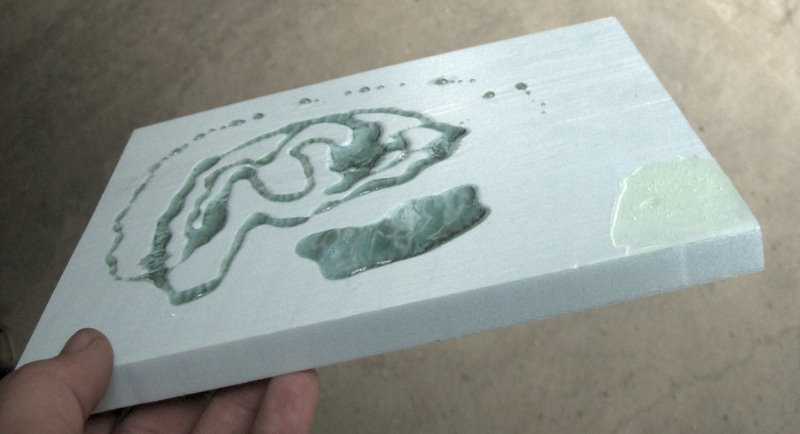

Because he's using insulation foam, which is probably polystyrene, which looks like this when you apply polyester resin:
resinfoam.jog
Yuck! :lol
The little spot in the right corner is common two-part epoxy, which does not attack the foam.
resinfoam.jog
Yuck! :lol
pilot is correct, its extruded polystyrene, here is a pic of this stuff used from a model railroad site,
