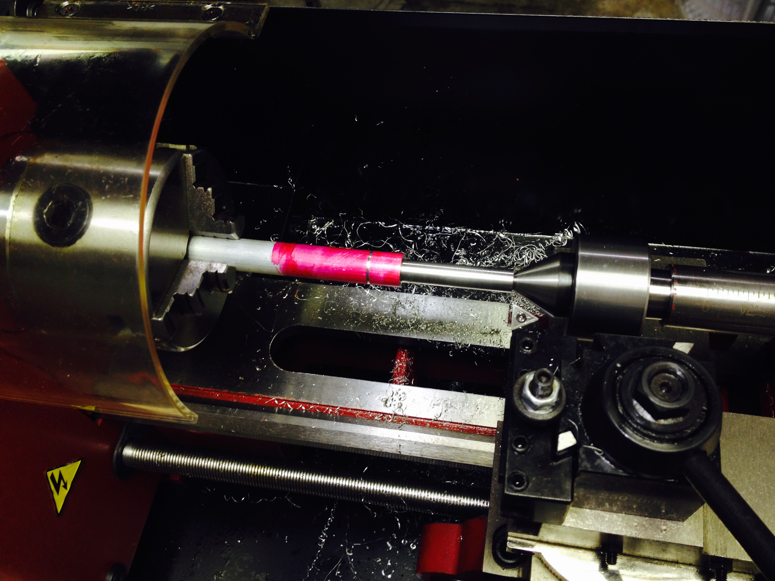

After what seems like forever, it is finally time to actually start making this model.
I'm starting with the quad guns assembly - yoke components being first up in the chuck. Recently got a small bench lathe and I'm starting to make some chips!
More to follow...

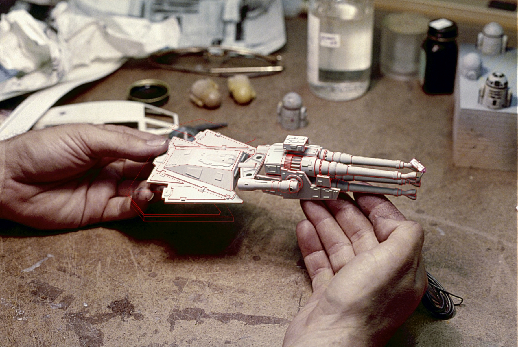

A quick update while I continue the build - I test RP printed the digital quad-gun sub-assembly model - I just wanted to get it out of the computer and hold it in my hand - a huge benefit of living in the age that we do:
Thanks!
apb
Beautiful work, dimensionally do you feel it's correct ? A very quick query , is the angled mount that the yoke fits into a model part on top of plastic, or was this shape all scratch built ?
Vacformedhero,
I'm feeling pretty good about the accuracy. The donor kit parts I have all fit and there are quite a few "cardinal" dimensions on the piece (1/8s, 16ths, 32nds etc.).
As for the angled mount, I suspect it was mostly scratch built. Others on this forum probably know more about that particular area of the model.
Regards,
Andre

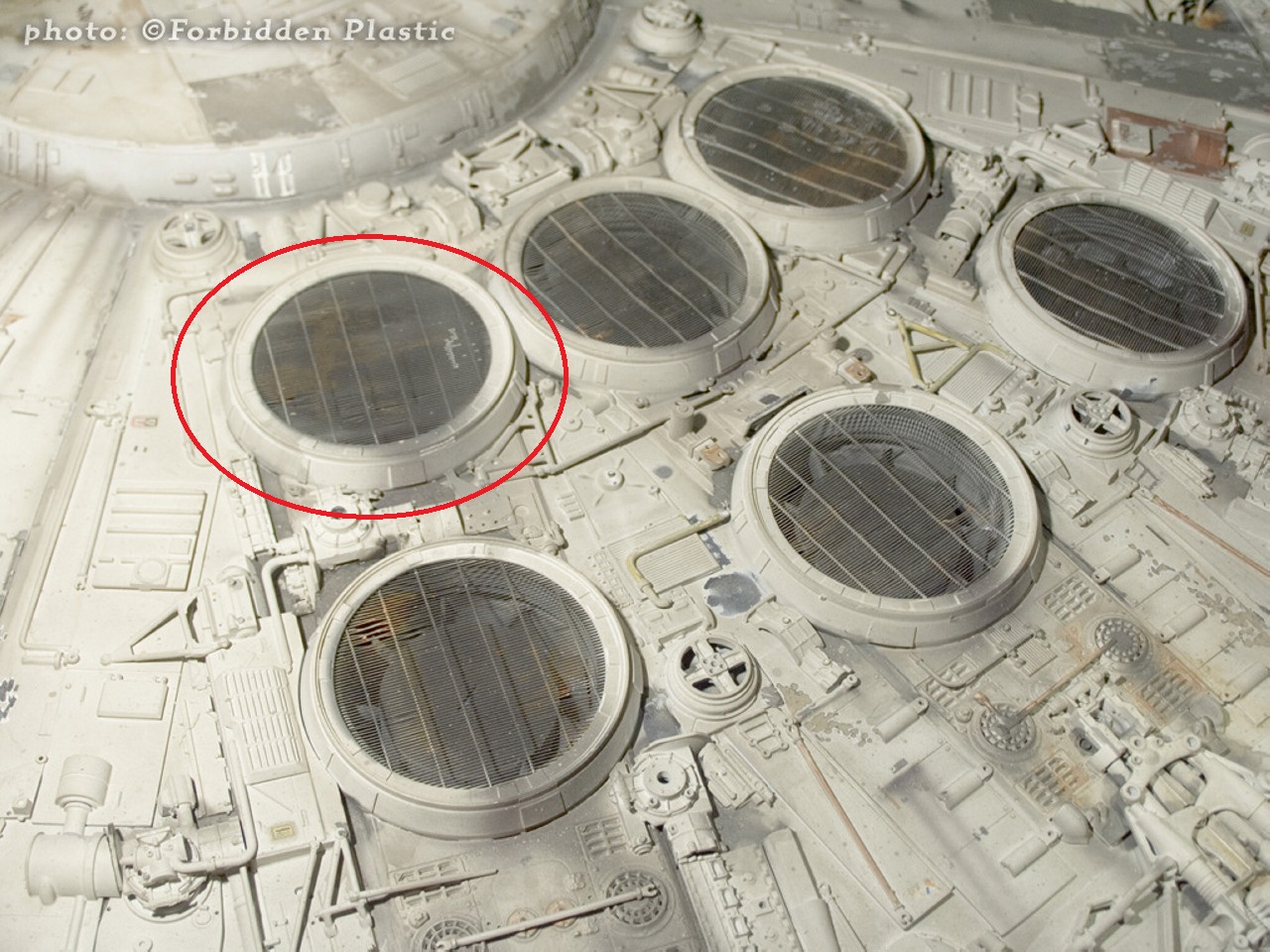

Hi guy's,
I search this part, the ring exactly (I have koolshade) on the web, but I didn't find :-( :
Thank you ! :)
Thanks Mark, yesterday I make a wood master, I think make vaccuforming...
Hi Leukirix,
I can do you a cast set of the vents if you want them?. Each vent is comprised of a lid & a base. The koolshade sits on a shelf integrated into the base & the lid hides the rough edge of the cut koolshade.
I don't feel vacuum forming over a wooden buck is going to help you here.
PM me if you like, no problem!.
Stu

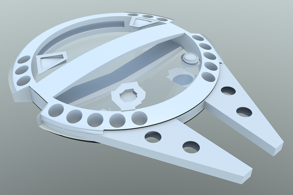

The pieces are falling into place -- I'm getting very fast at hard-surface modeling in Blender, and I've also signed up for OnShape, a free cloud-based CAD package. I've decided to scale back my MF project to a 32" version of the 5' model, since -- let's face it -- it'll be some time before I have space for a 5' anything. But with vacuforming, laser cutting, and 3D printing, 32" is doable.
Thanks again, vfxsup64 and maruska, and everyone else who's contributing, for making this all possible. :)
