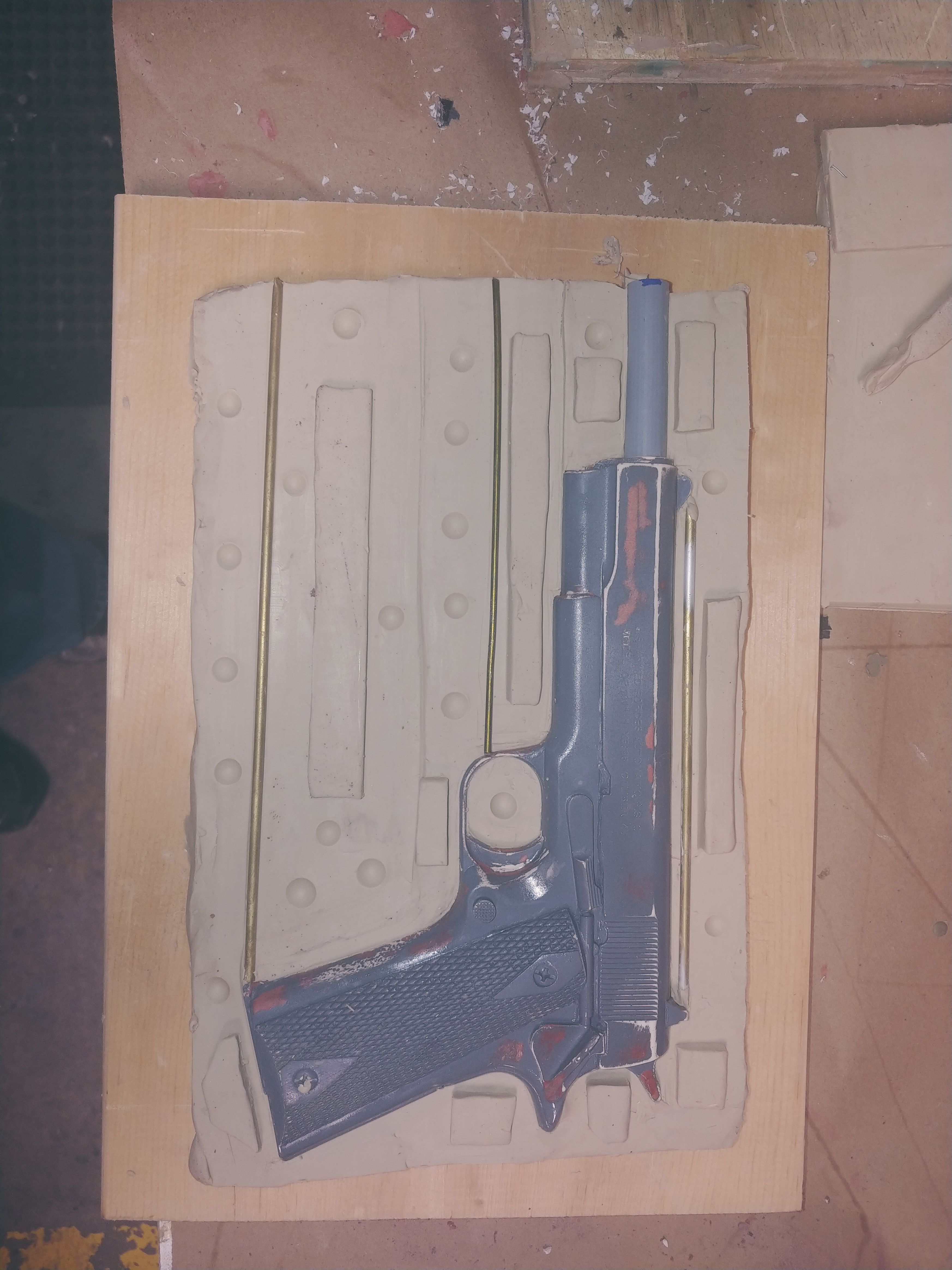

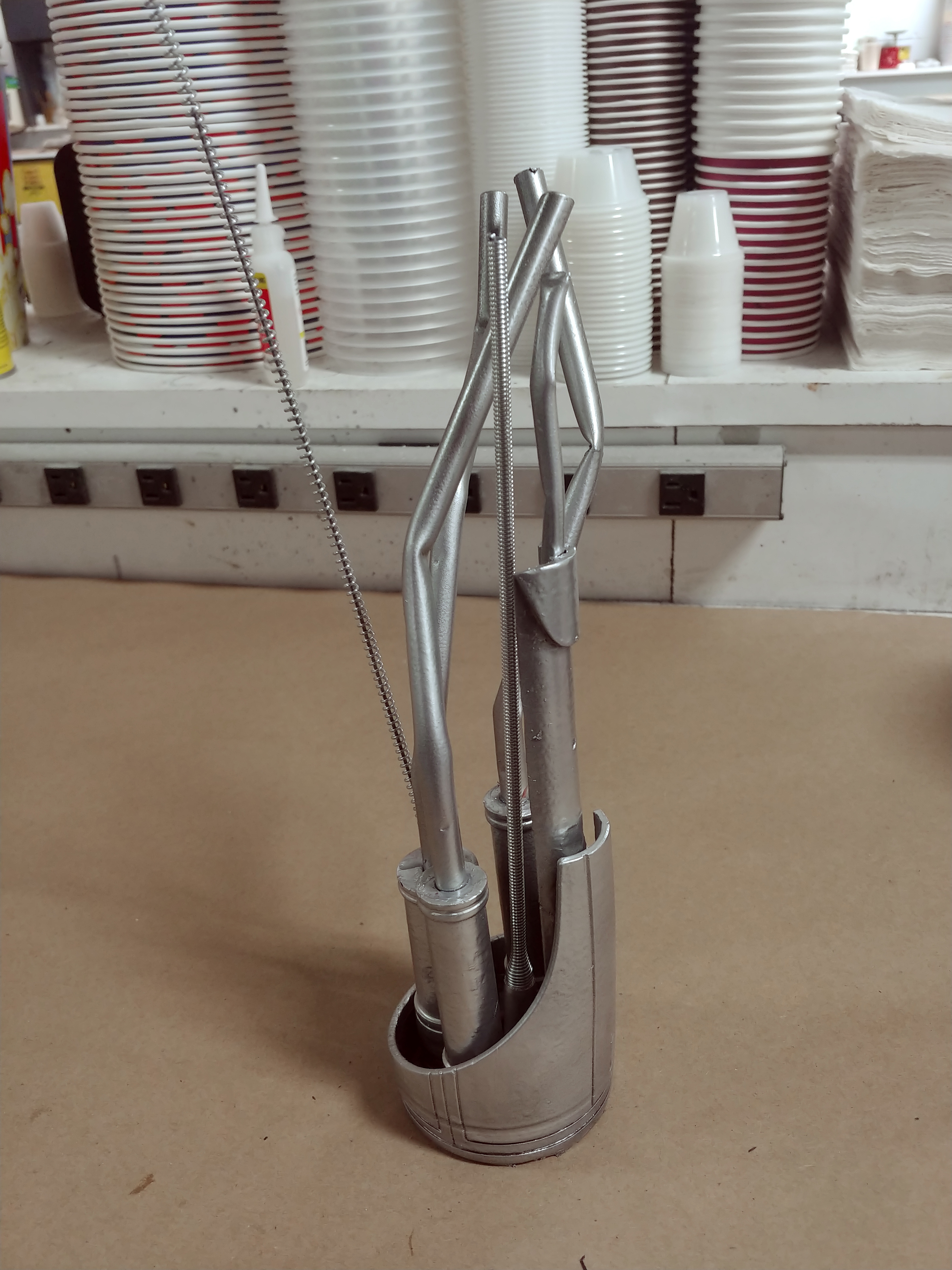

Small update... Painted the teeth white and coated them in a clear epoxy for that wet look. Sanding knee, filling, sanding repeat.. honestly I did the craft foam method to try and save time but regretting that decision, should of just sculpted it.. think I would of had it done by now.. oh well, live and learn. Started to clay up the gun for mold making and started on the broken arm... need to add more greeblies to it such as springs, hoses etc.. but it is a start.

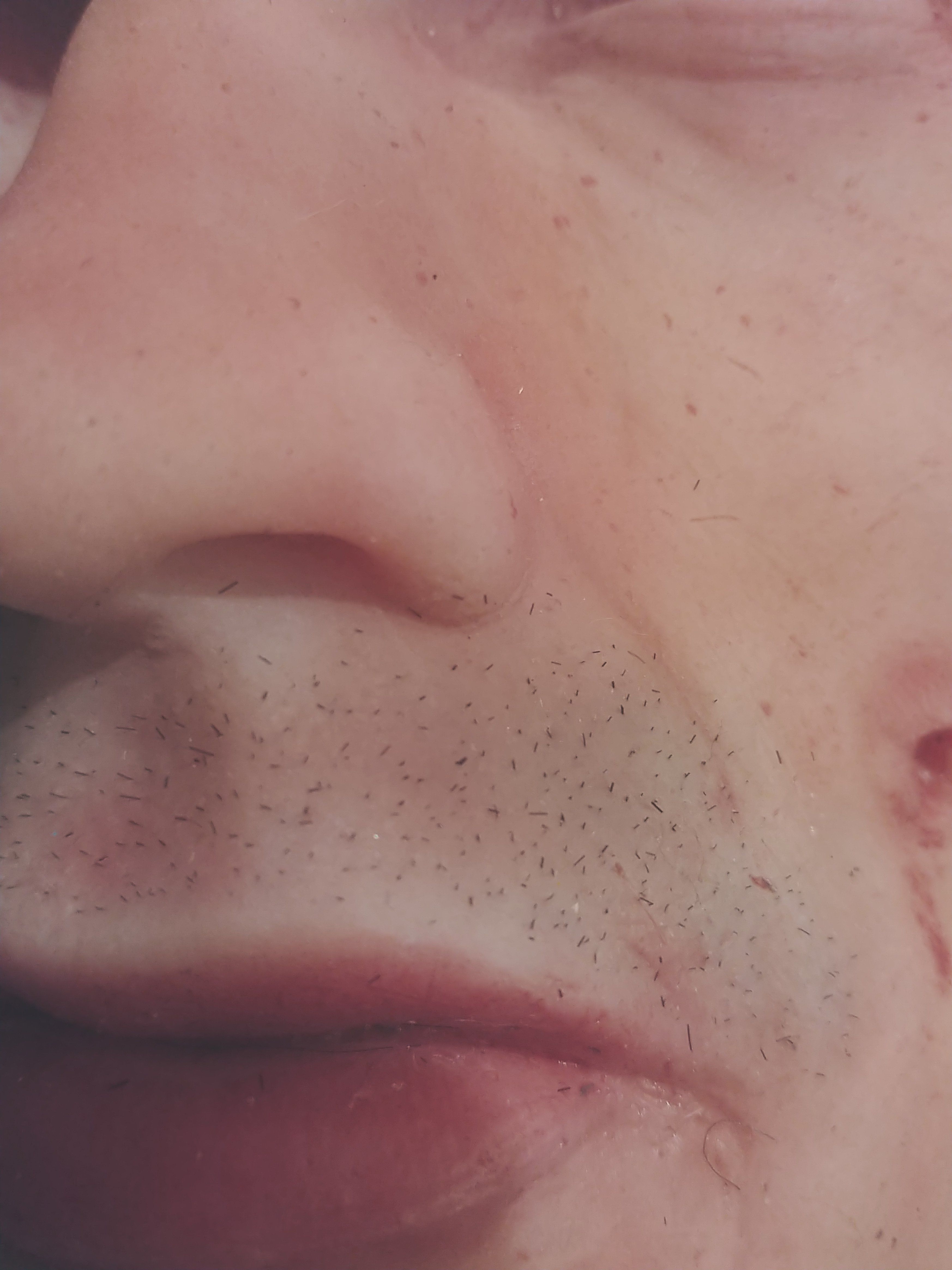

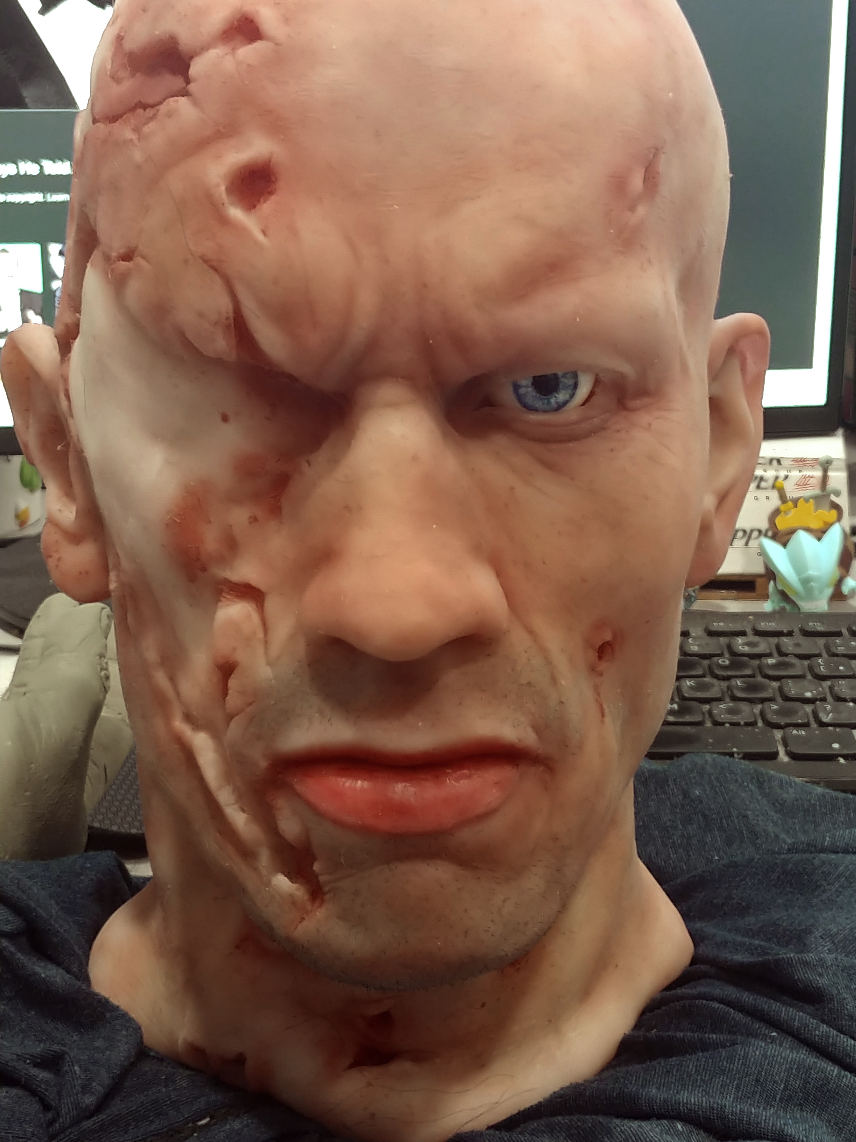

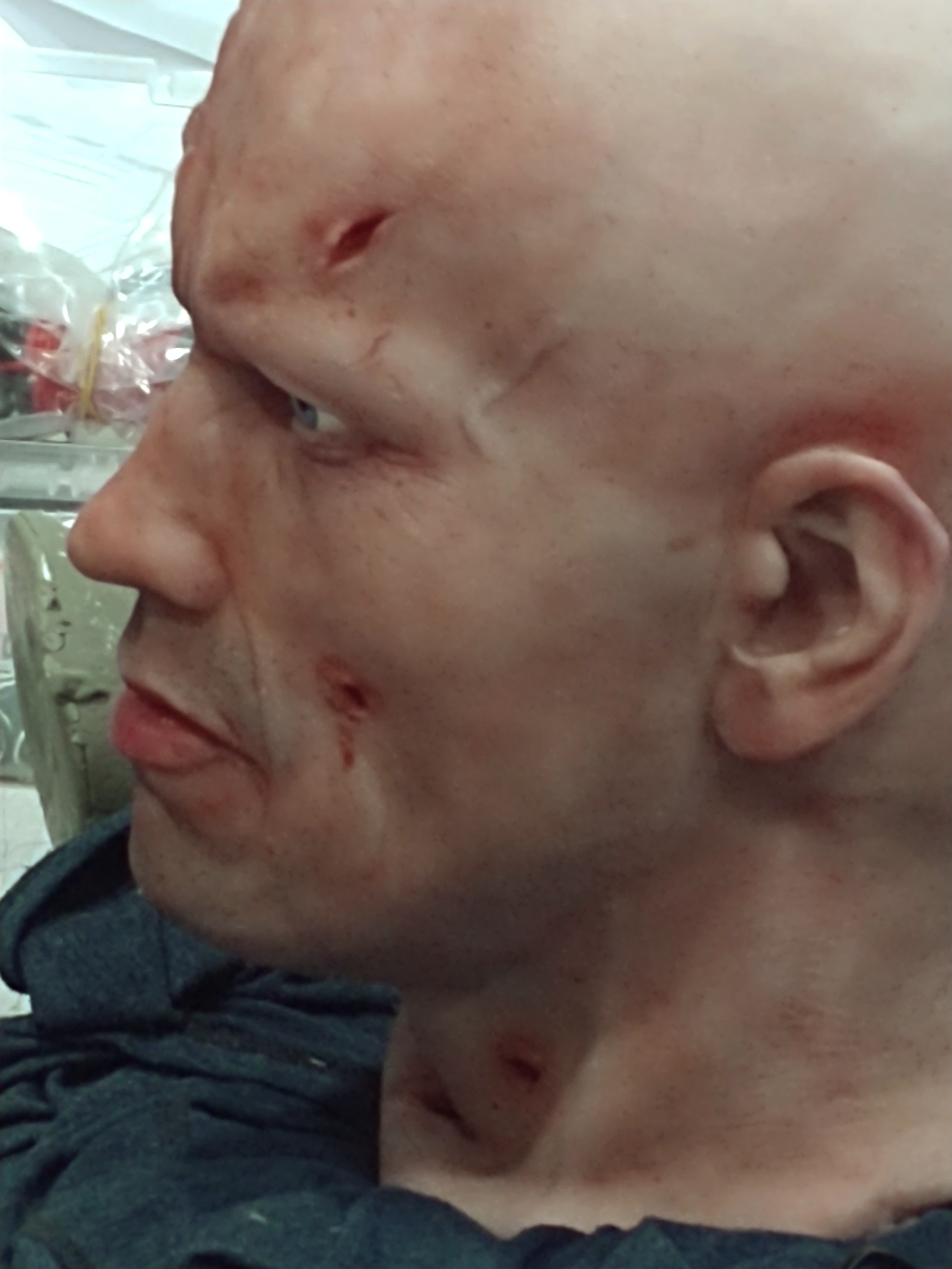

Still punching stubble when I can... threw the eye in as a place holder, not permanent yet as it is to blue for arnold and I still got to paint around the eye, tear ducts, etc.... did more of the knee... hating it more and more.. got the ripped arm done, ordered mannequin parts to attach it and detach it for shipping without breaking... made mold of gun... that is about it for the moment...

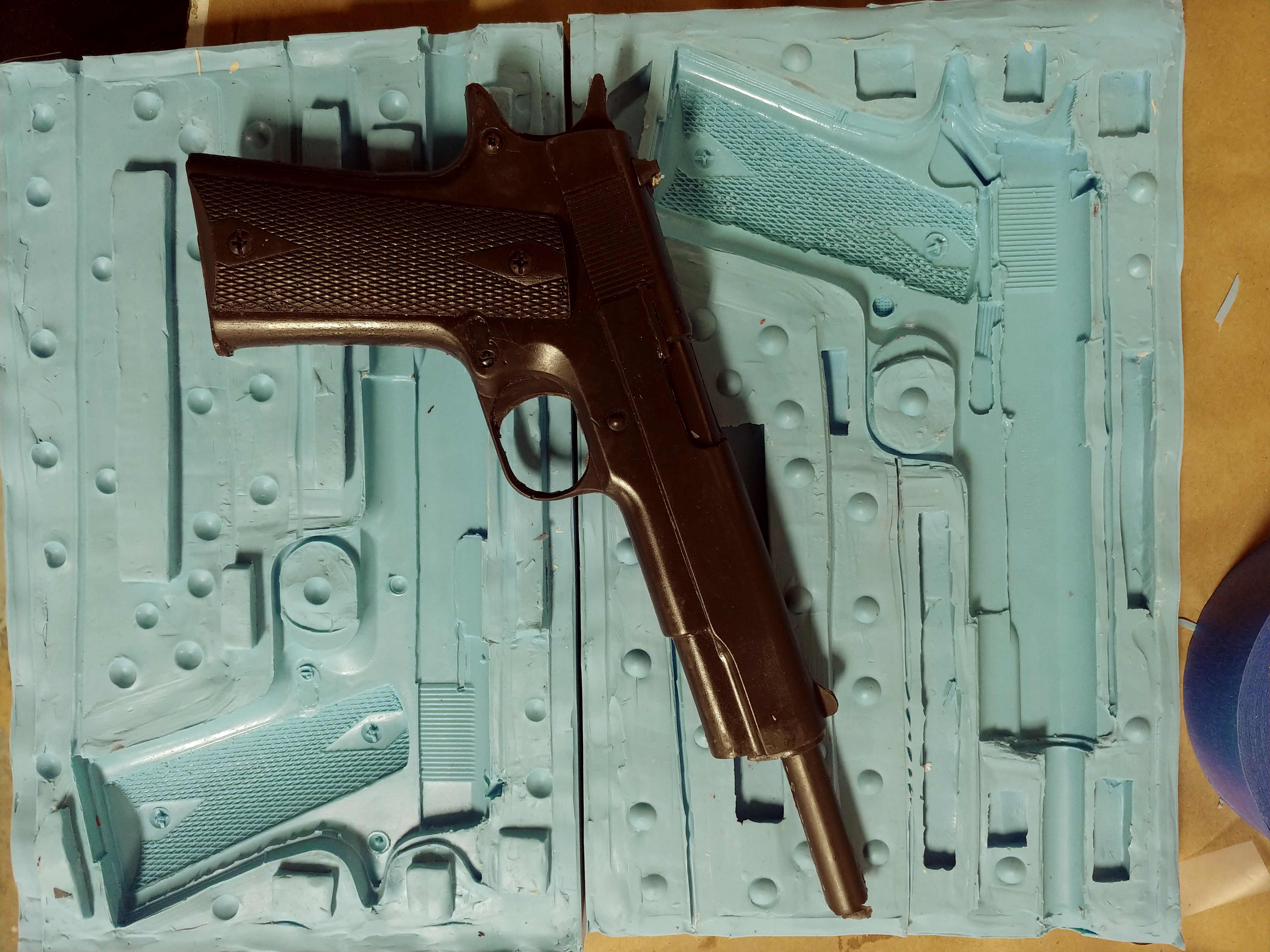

Got gun mold completed and casted:

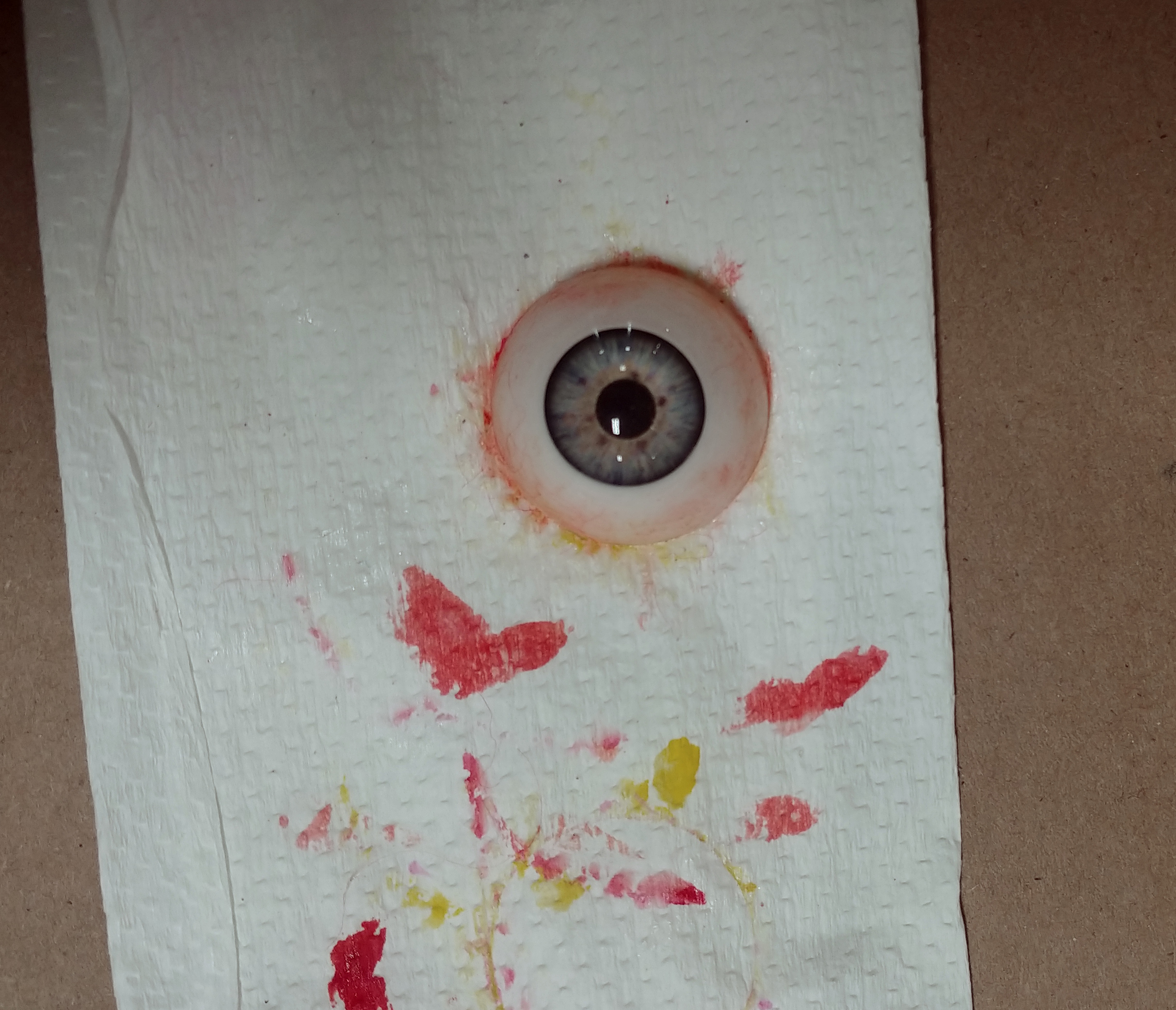

Got the correct eye done (color), just need to pop it in:

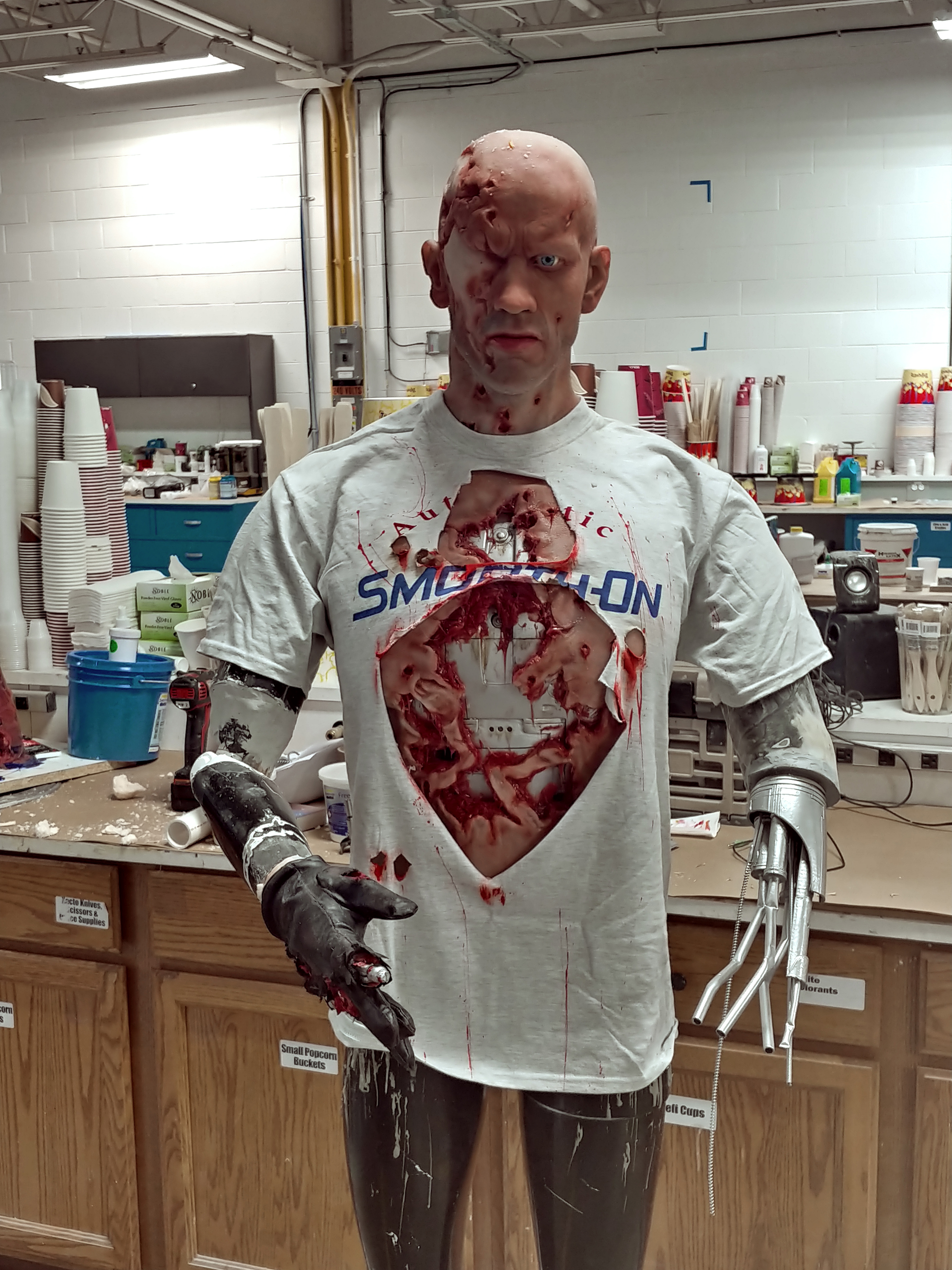

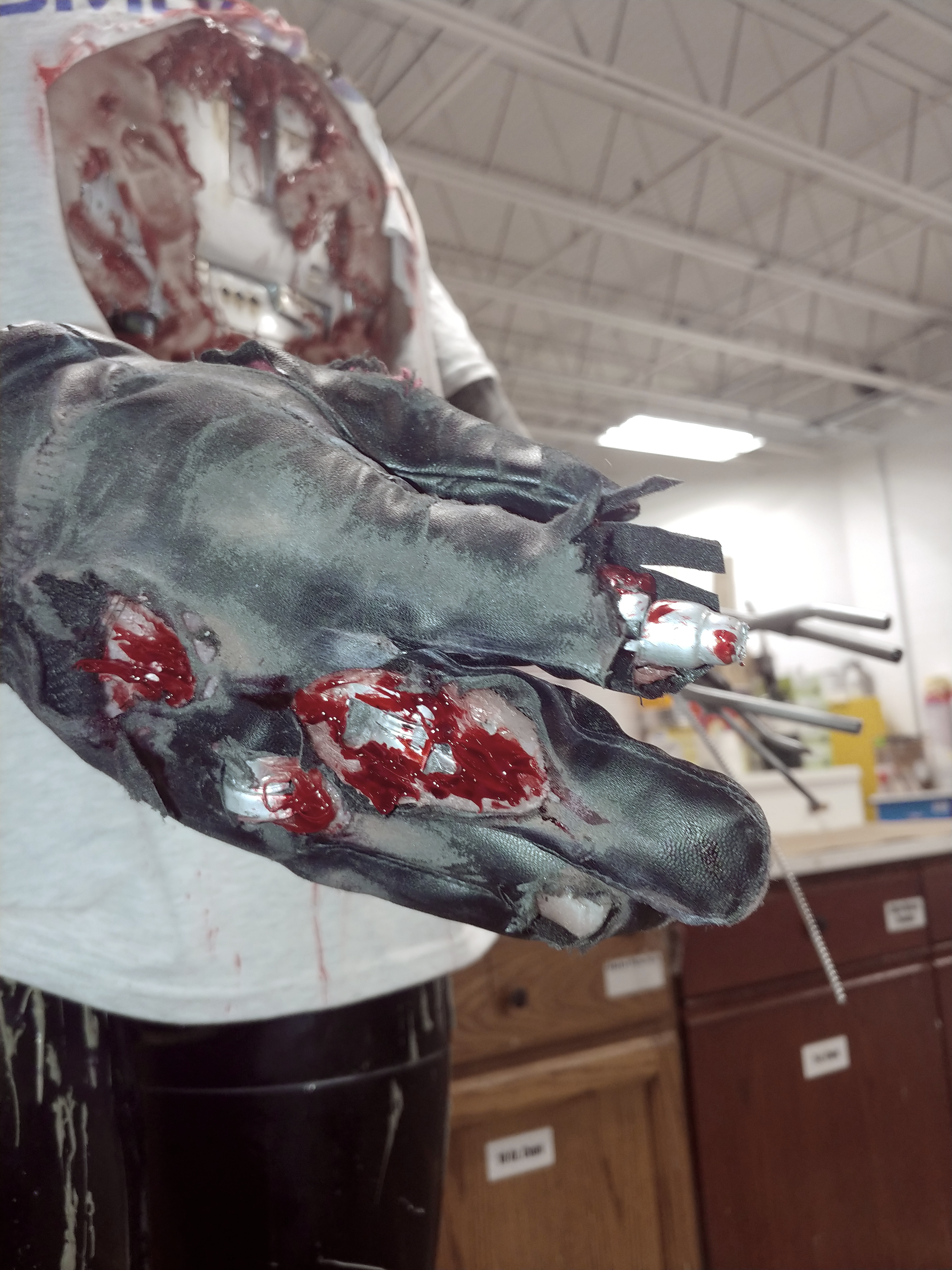

Got hand done... this was done in silicone with wires ran through it so it is fully poseable to hold the m-79 if it ever gets here.. ugh.. endo fingers run in resin and pinned so the joints can move with the fingers.. hand is cammed to be able to take on and off mannequin.

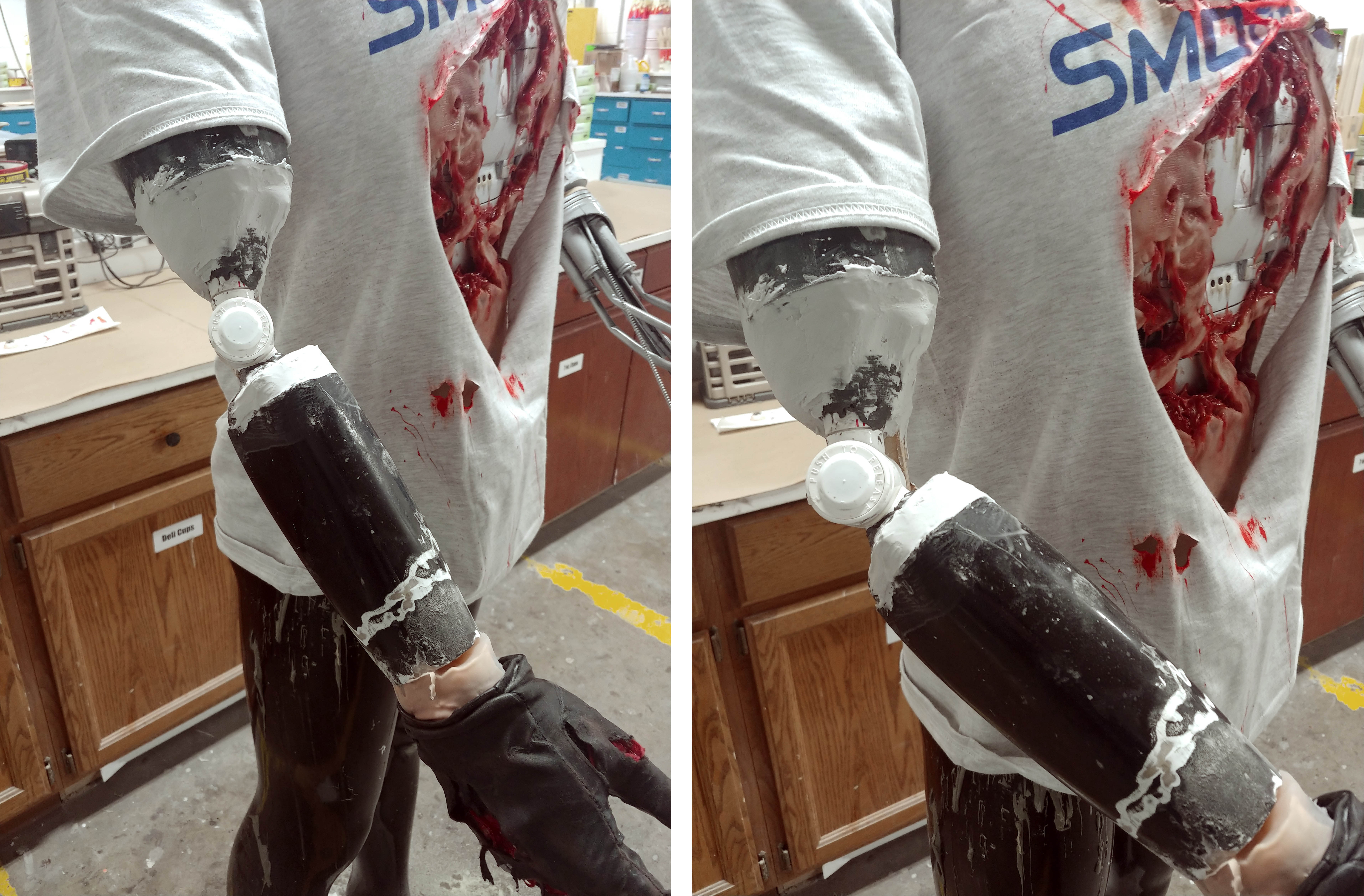

Speaking of cams, I picked up this articulate joint and fit it into the mannequin so Terminator can have an action arm! lol:

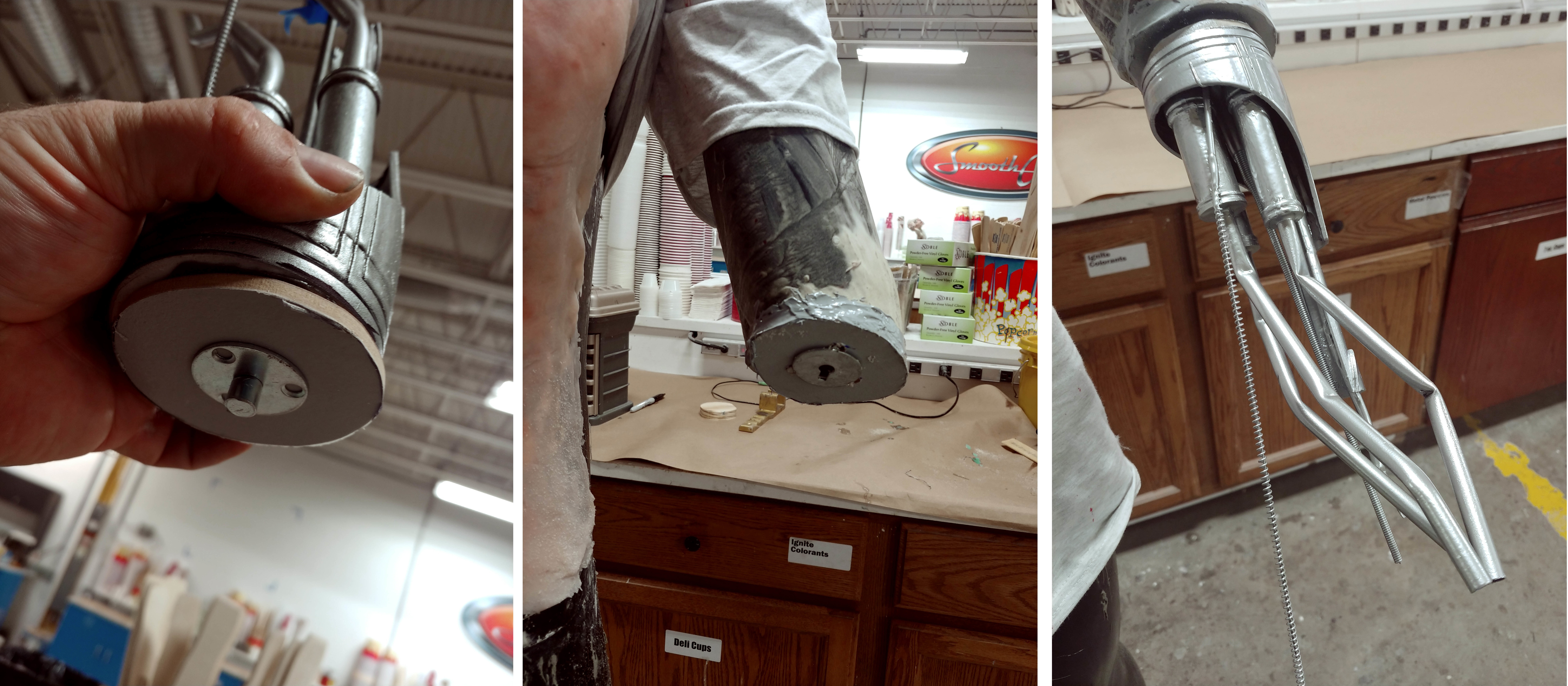

Of course the other broken arm is cammed to take on and off for shipping:

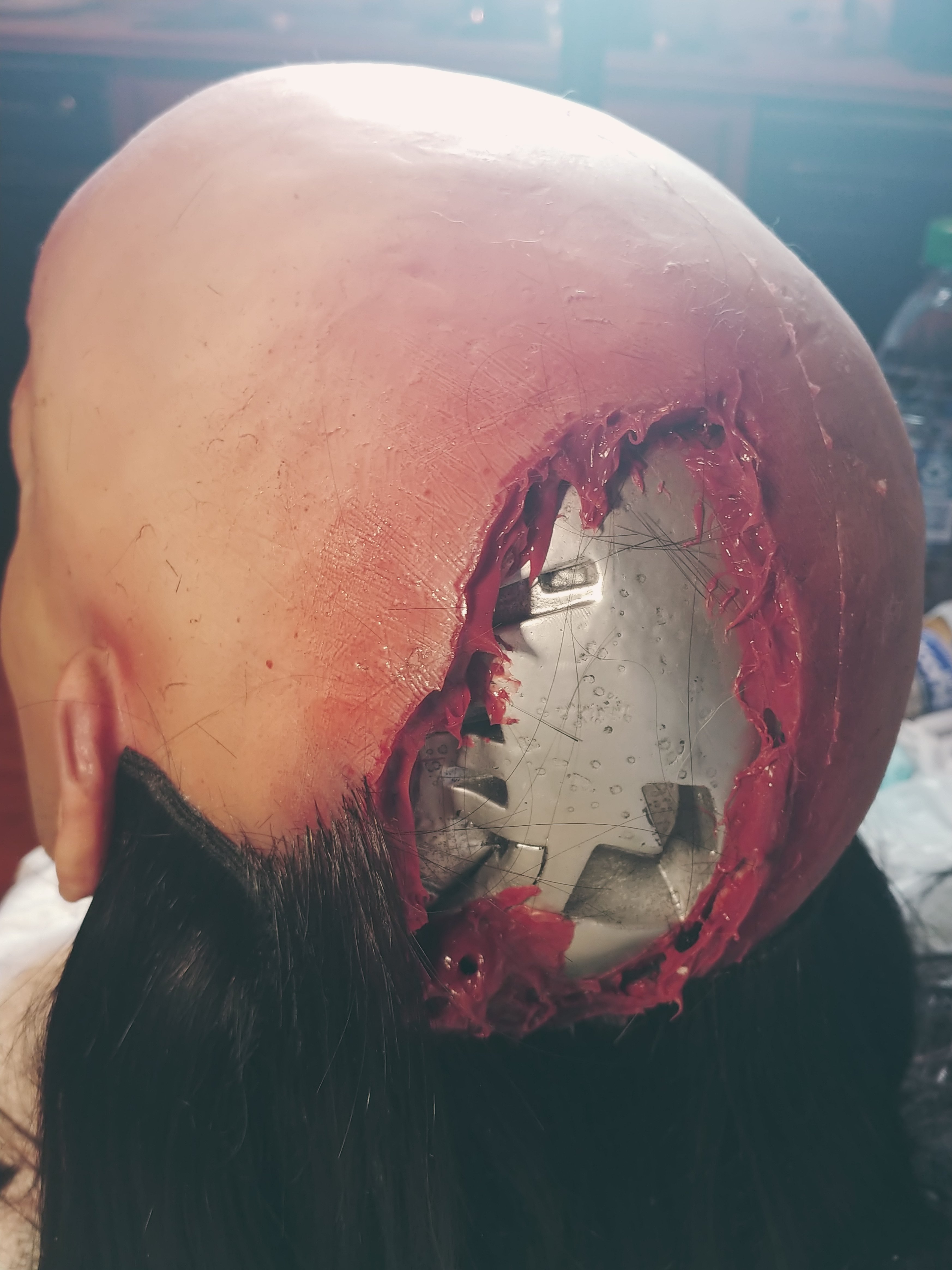

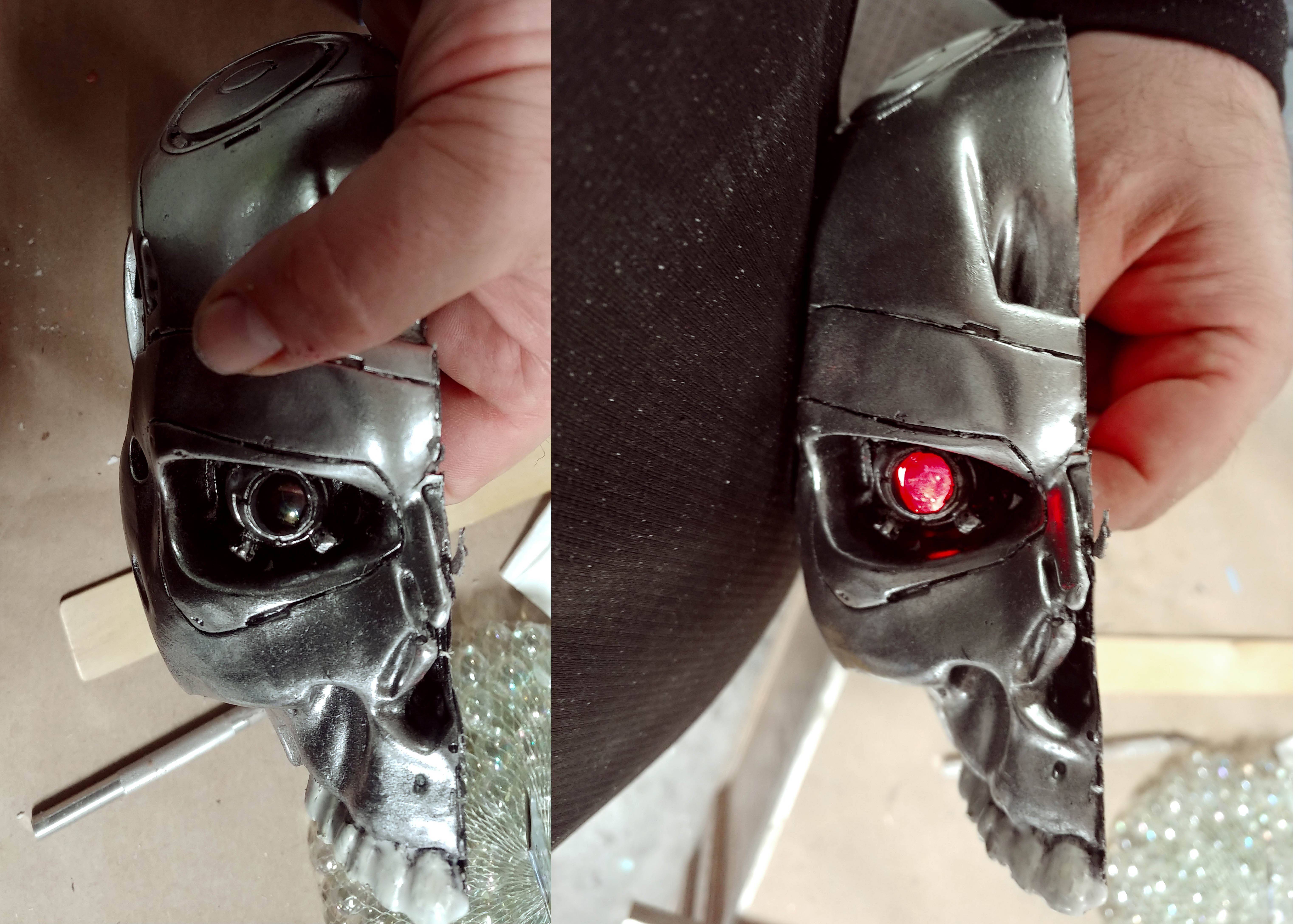

Went the route of a clear marble for the endo eye... old school T1 style, I like it:

Thus far... and no the shirt isn't staying, was a test fit.. I got the right tshirt...

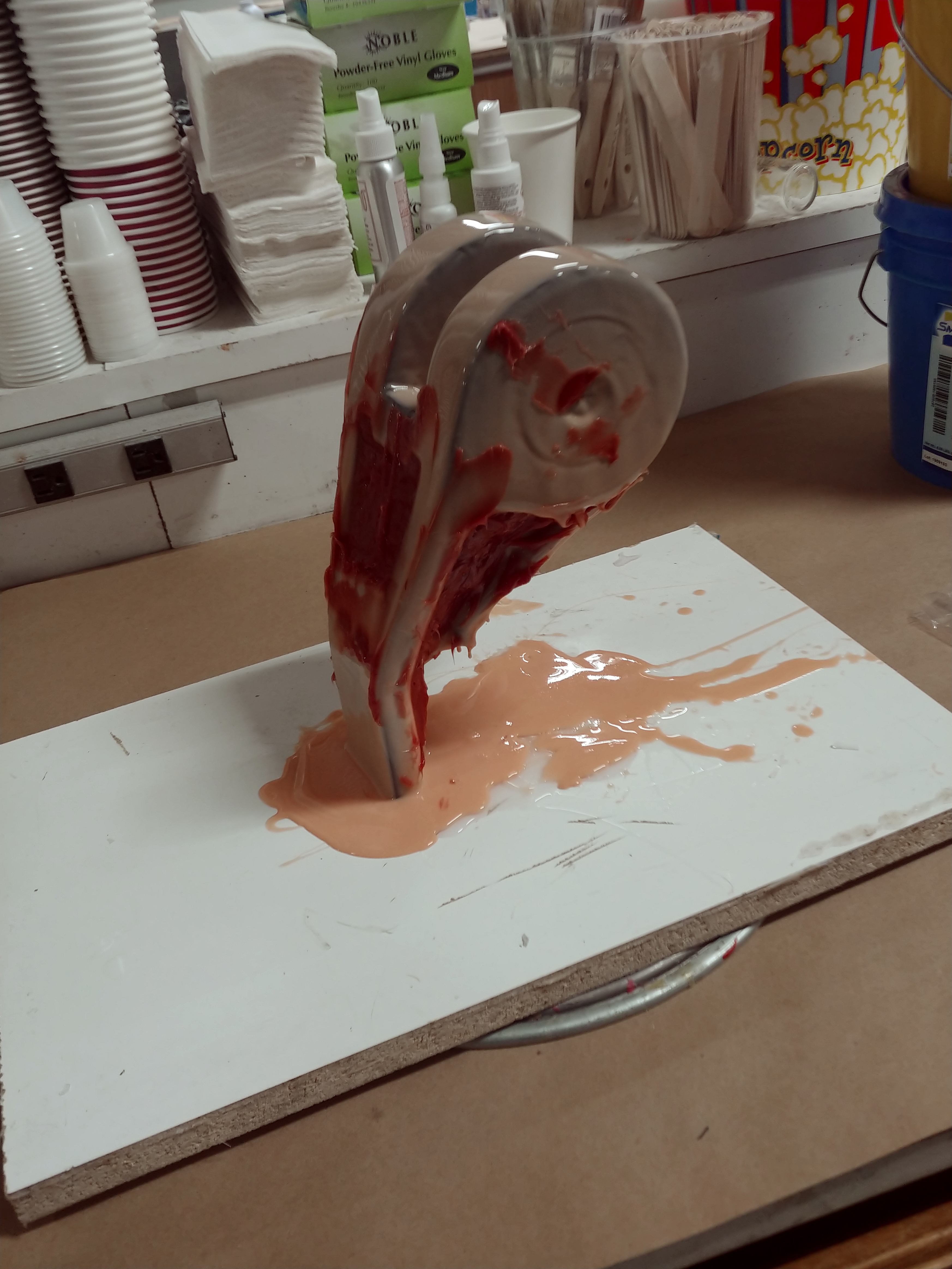

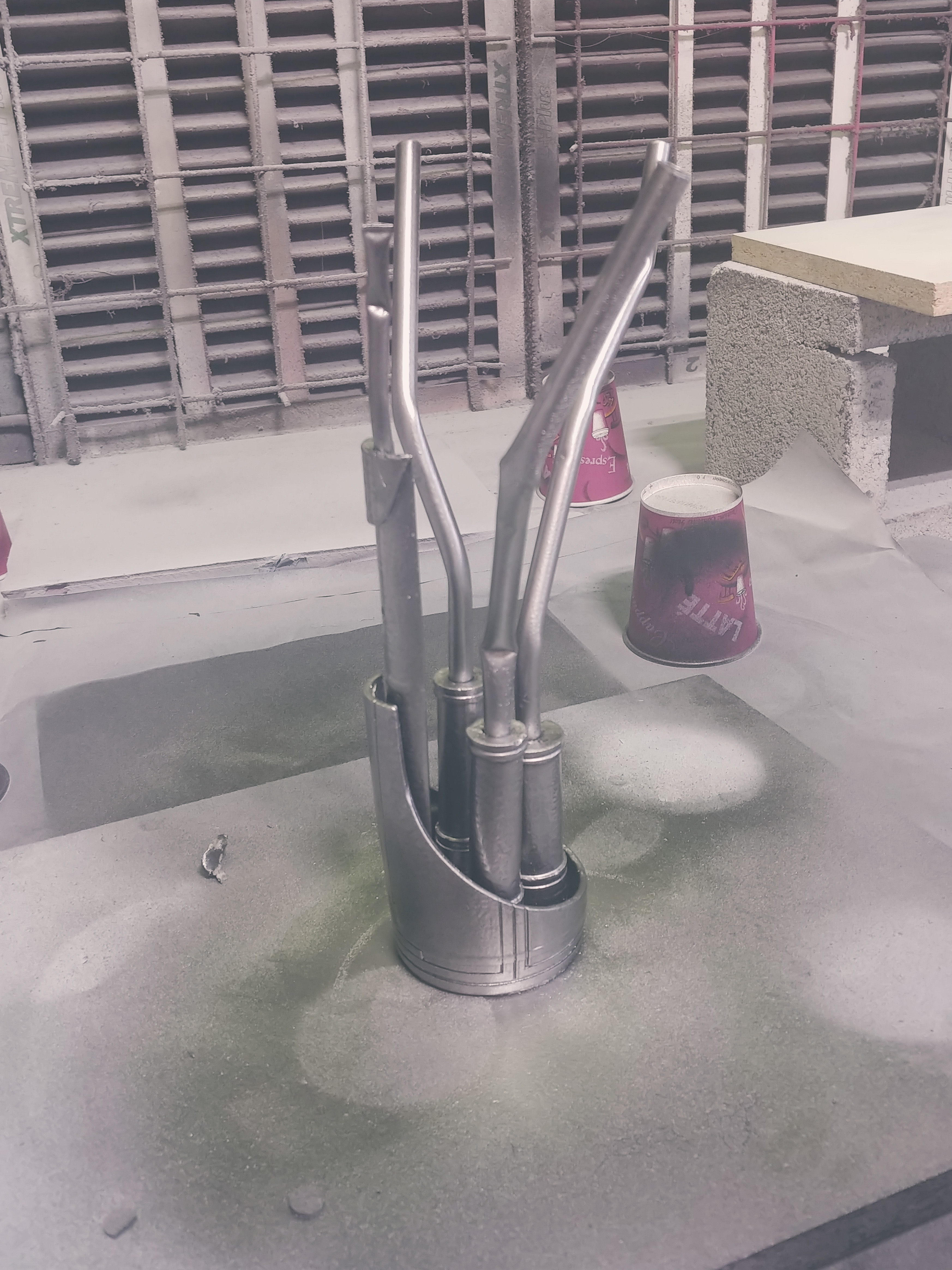

Knee is starting it's journey under rubber.. bottom knee with any luck will start it's journey under rubber tomorrow:

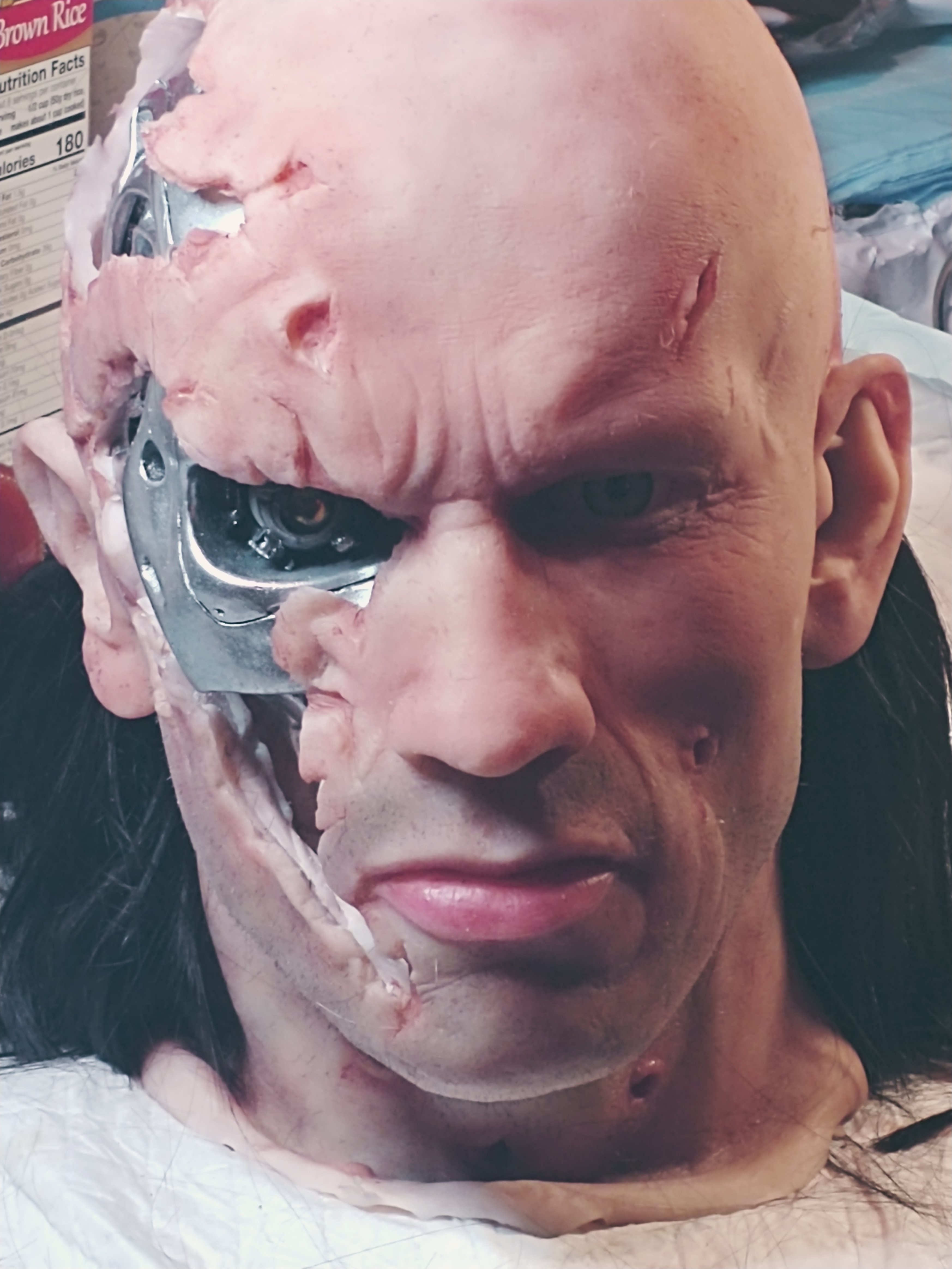

Head, wish I was further along!!!!!! Got stubble done.. looking a little like jeffrey statum or razor ramone so will need to cut back the stubble to a shadow... starting the rest of the hair tonight yet... ugh:
