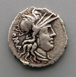

Roman Republic silver denarius:
I chose this particular replica to go with the image, because out of the examples that I acquired, this profile of Roma most closely resembled Mignola's drawing. I found no evidence of denarii without any numerals, letters, or other markings around the head. This example is a denarius of Marcus Tullius, circa 120 BC:
This example is a denarius of C. Serveilius, circa 136 BC:
And this example is a denarius of L. Saufeius, circa 152 BC:
So that makes 3 denarii, just like Pope Gregory VII used :D
