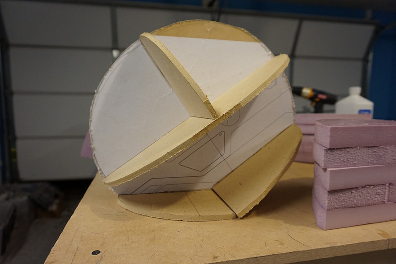

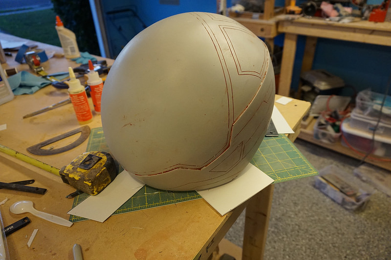

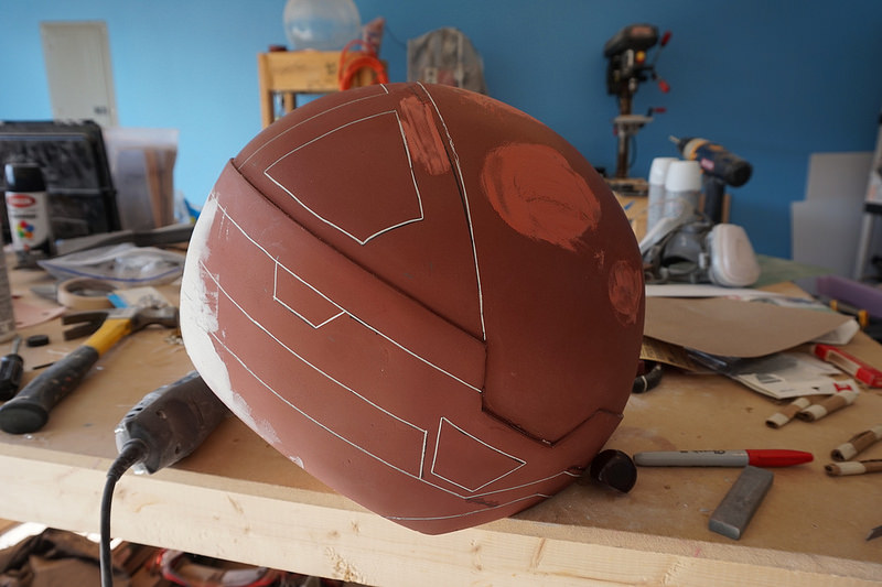

I want to stress that nothing on my suit is 3d printed or CNC'd
The helmet was sculpted from foam using Captain April's 2D post. I build an MDF skeleton and sculpted the helmet from bondo and pink foam.
DSC01854 by 2StoryProps, on Flickr
DSC01855 by 2StoryProps, on Flickr
DSC01882 by 2StoryProps, on Flickr
DSC01892 by 2StoryProps, on Flickr
A mold of the rough sculpt was made and two casting pulled. One became the positive for the final helmet mold and one was made into the vacuum forming buck. The visor is 0.09" PETG pulled on our 24 x 24 inch protoformer.
i understand you scratch build it i was only asking as i was told that the visor could not be vacuform, but now i know its possible to pull a visor the with the dimentions to fit my helmet i now just need a bloody big vacuum form
You did it old school, I am glad that my drawings helped.

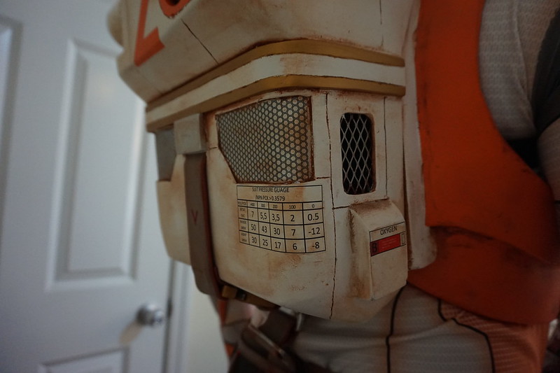

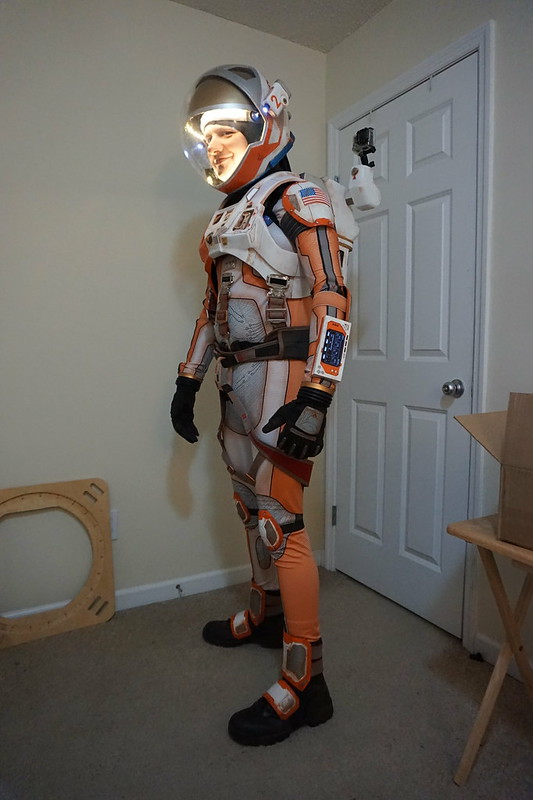

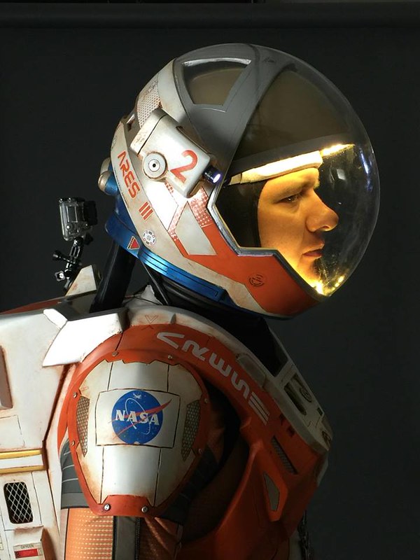

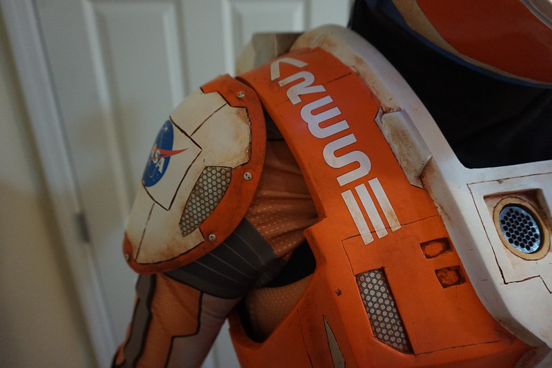

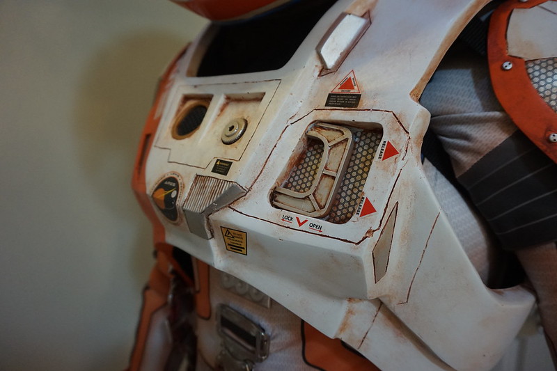

Finished weathering this evening. I need to add some padding to the back of the torso to hold it in the correct place, but here is the full suit.
DSC02021 by 2StoryProps, on Flickr
DSC02022 by 2StoryProps, on Flickr
DSC02025 by 2StoryProps, on Flickr
DSC02027 by 2StoryProps, on Flickr
DSC02031 by 2StoryProps, on Flickr
DSC02033 by 2StoryProps, on Flickr
DSC02034 by 2StoryProps, on Flickr
Wow, now I know the decals fit. Looks great.
I called several sign shops and nobody had clear vinyl. The one I went with printed the decals on white and pre cut them as well. A few of them, like visor and the pressure lable on the cheak i did on waterslides.
The decals worked great. I would make the suggestion through of including the meatball if you revisit the decal sheet. On my helmet castings the meatball is about 2.25 inches tall.

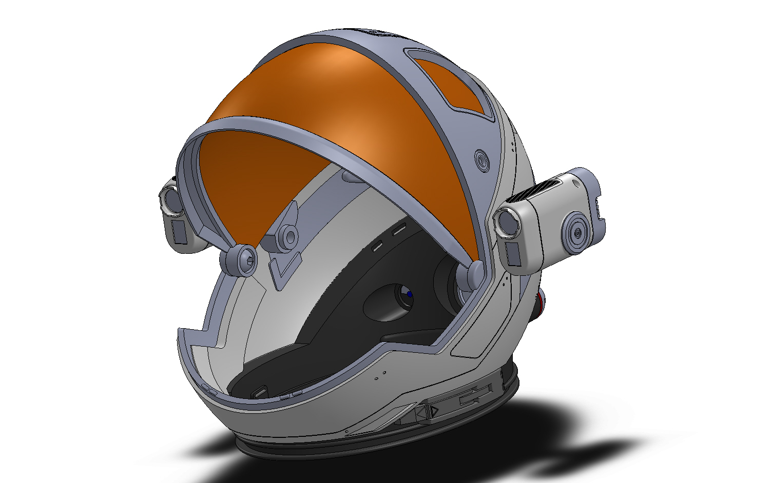

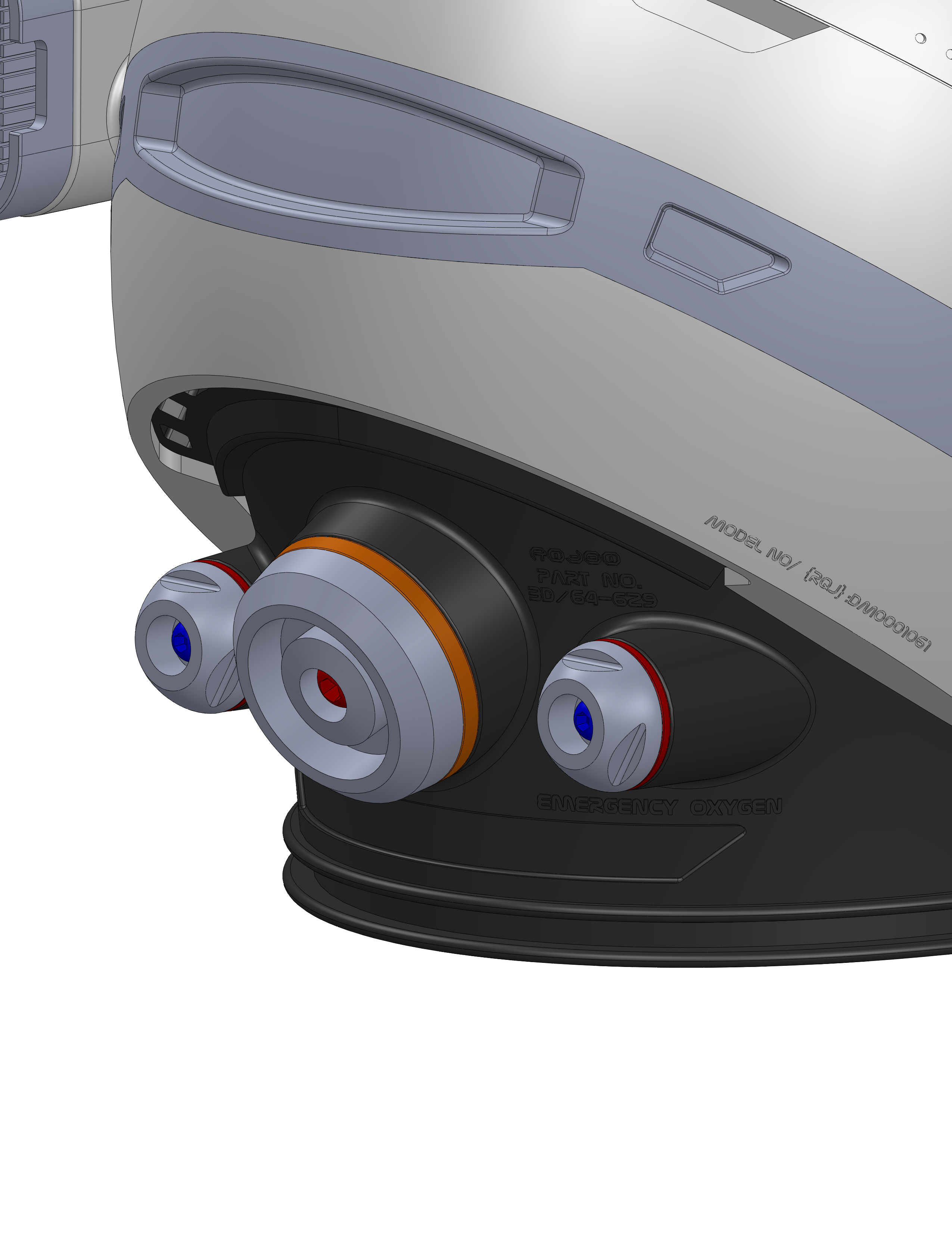

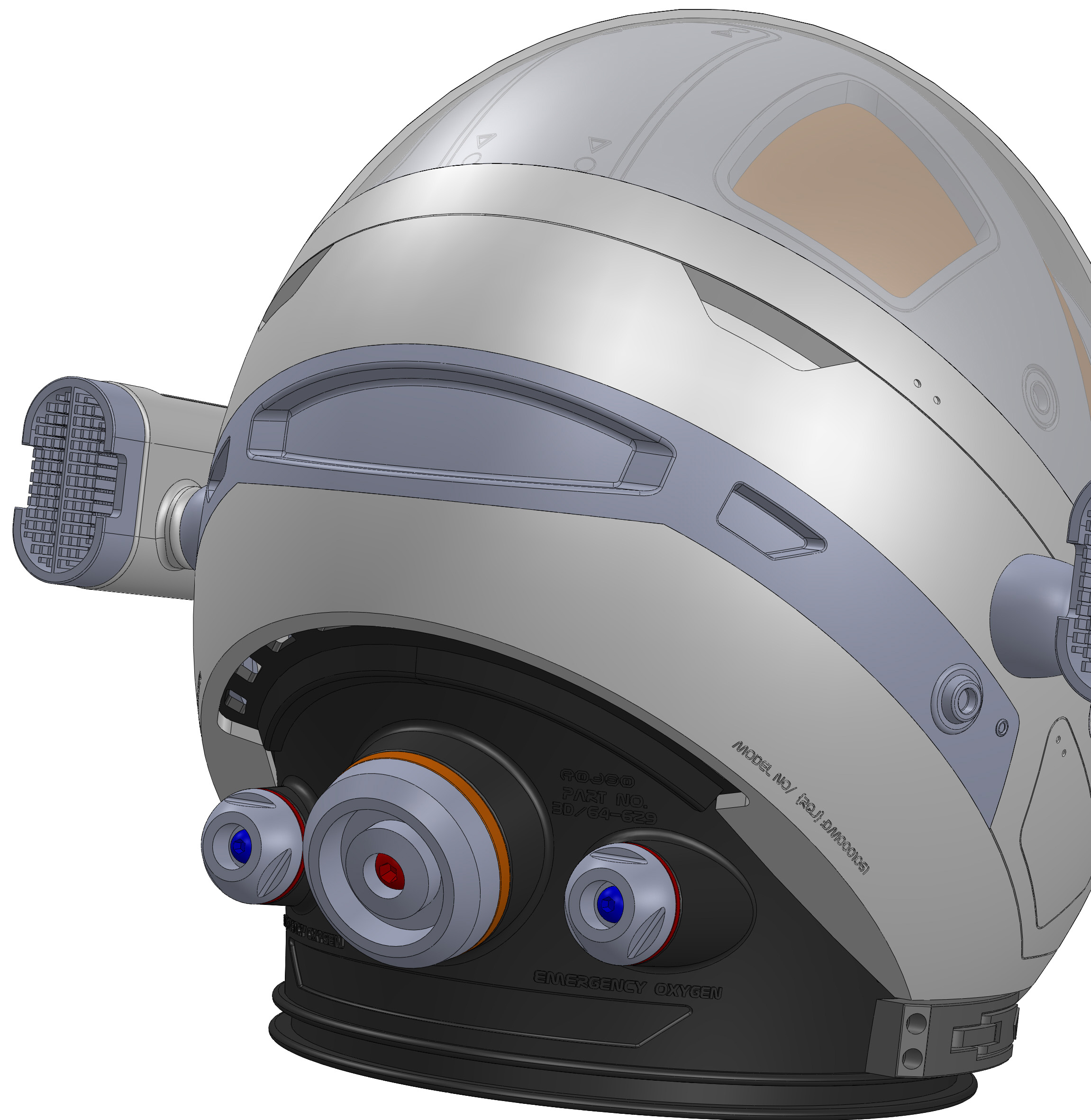

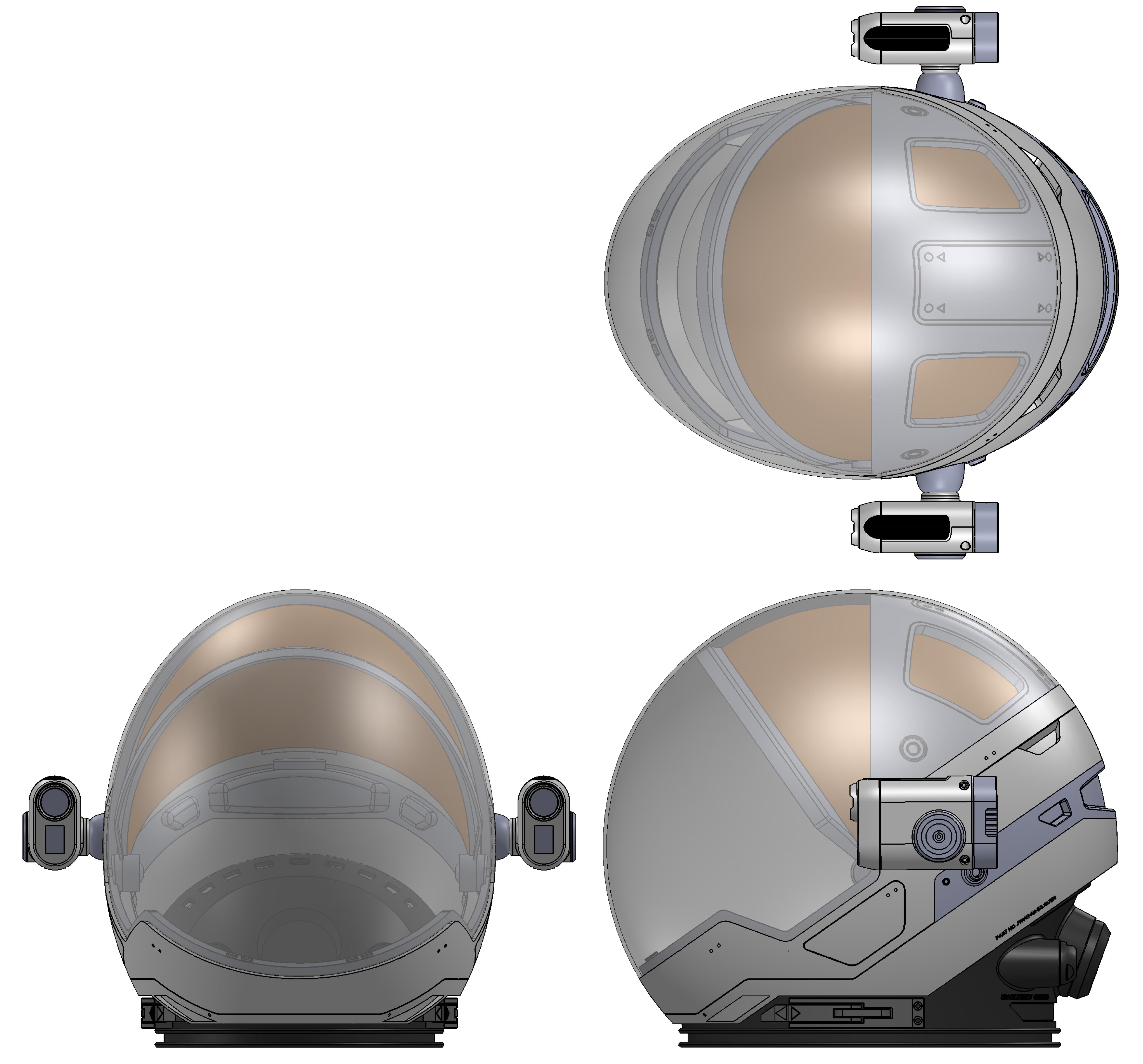

The work of BCFX has inspired me to revise my model. Enough time has past that I can review the model with fresh eyes, and not surprising I have found a couple of mistakes but more important I have added details that I overlooked or just missed. I have also added tabs to position the parts for assembly.Here's the final version unless someone points out something I missed.View attachment Pressure Helmet Assembly-W-Dims.PDF
Many of you continue to ask for the 3d model to build your own helmet, I have decided to offer the files for purchase, I figured out a price and if anyone is interested please PM me, the price is inline with what one would pay for a large scale garage model kit.
