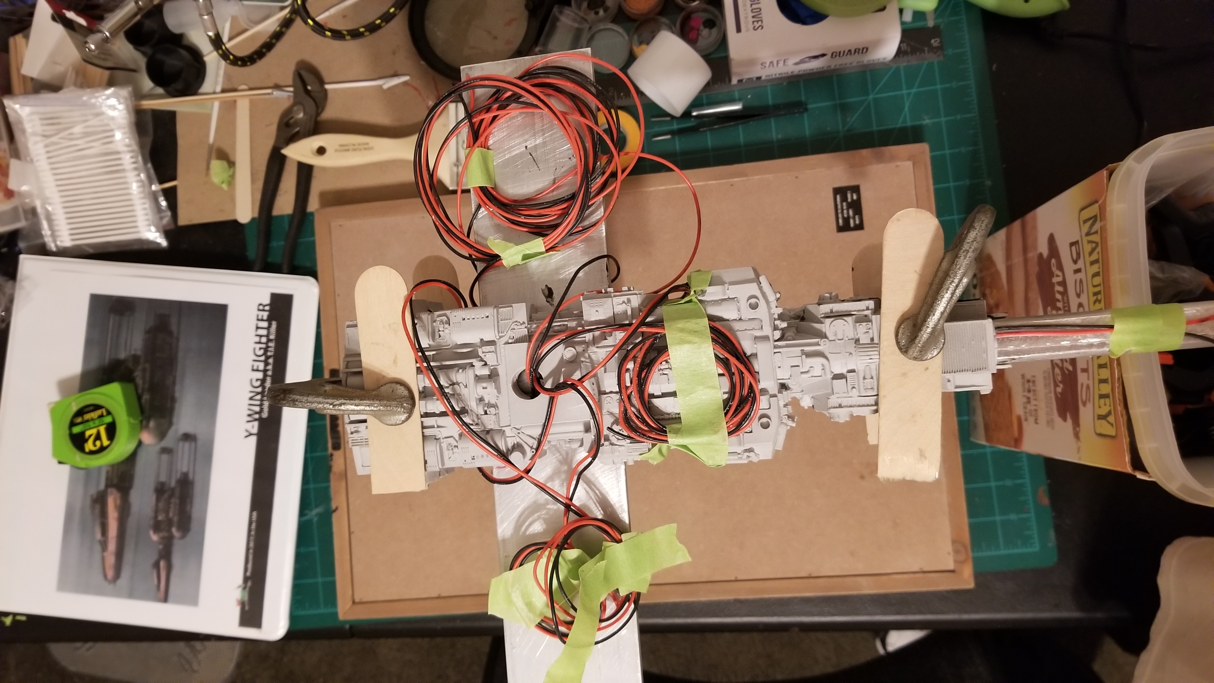

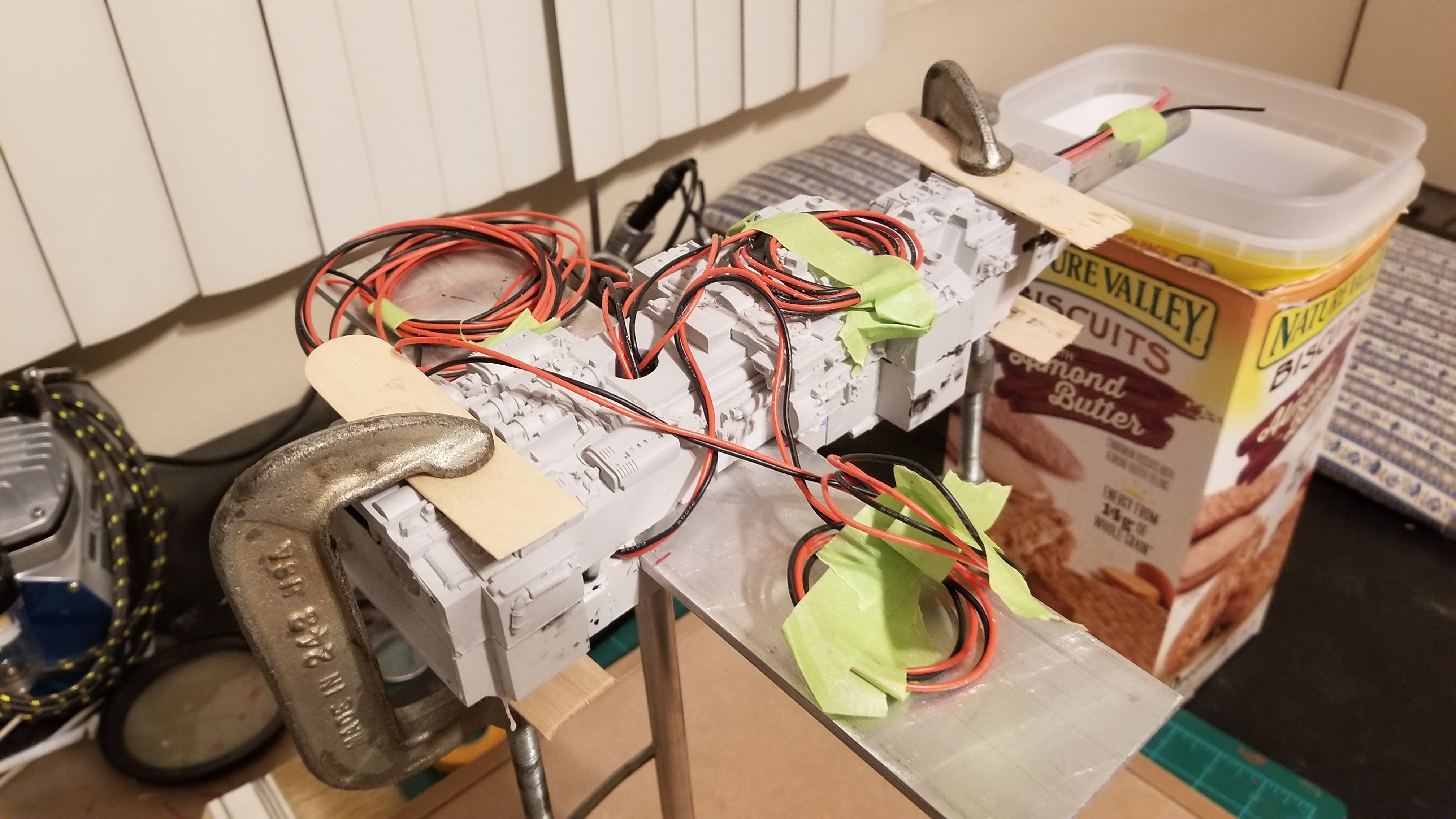

Thanks Jkirkon, I got everything glued and epoxied up last night with Medium ZAP CA & JB Weld. With an extra set of hands from my wife it looks like it set very well.

Guns... the guns have stopped.
Where are your top turret guns, Jkirkon? They fall off, you lose them, break them, or are you in the process of building super-detailed guns with turned metal barrels, vents and all?
Holler if you need guns. I have a good 2-part mold to replace the 1/24 Hurricane guns that go up there. Or did your squadron become pacifists? ; )

I hadn’t glued them on in that pic.
Is this better?

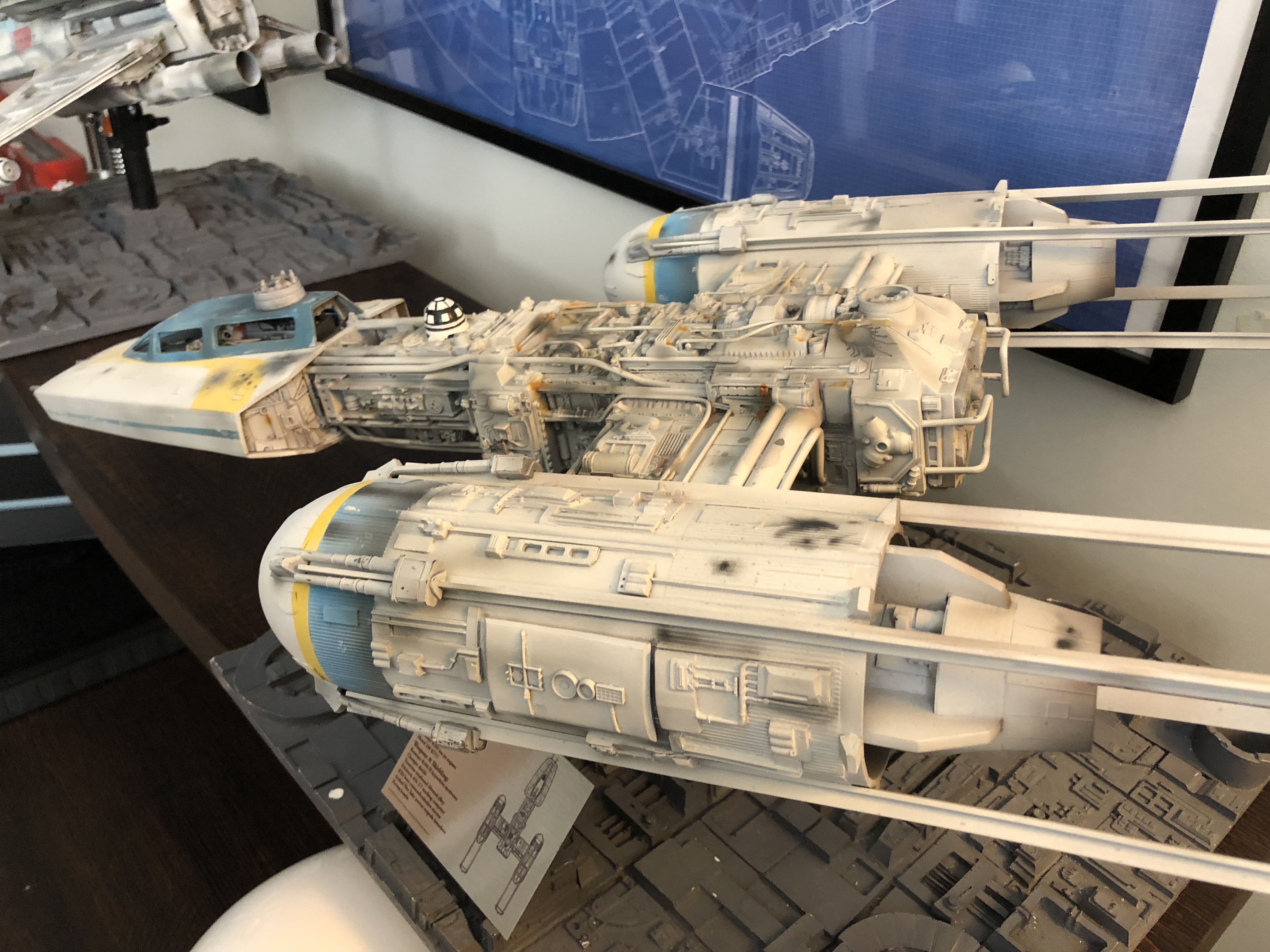

Looking good, Porkins. I remember when my Gold Leader was at that stage. This is it now.
Great looking Gold Leader Y Wing! I hope mine comes out half as nice as yours, paint job and blast marks are fantastic. Can I ask what color code or name is the baby blue on the canopy & other areas of the model?
Honestly, I don’t know offhand. I built it, but I can’t paint to save my life, so I farm that work out to another gentleman on this site. I know he uses Archive X paints.
Jkirkon: Ah, much better, I can stop OD'ing on my OCD meds now...
Pulled Porkins: The blue is Floquil #60127 GN Big Sky Blue, available from Archive X or if you get lucky in a vintage bottle on Ebay from time to time.
