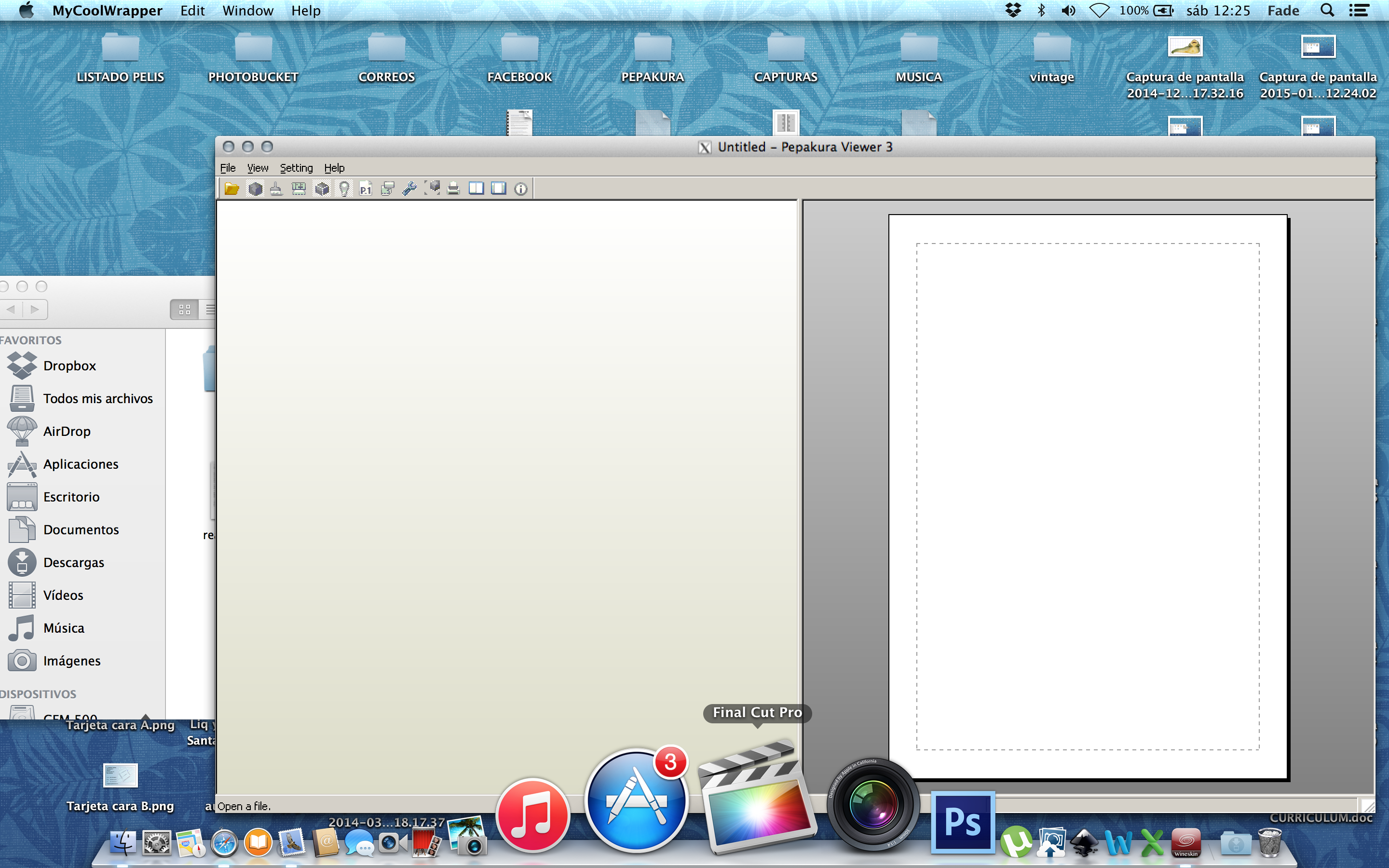

To use pepakura viewer on a Mac use MyCoolWrapper.
This is a simple skin to use windows programs on a Mac computer only dragging it in.
Download it on http://wineskin.urgesoftware.com/tiki-index.php?page=Downloads
Drag your pepakura viewer.exe over it and appears an error message.
Click ok and wait...
Enjoy your pepakura on a Mac :)
