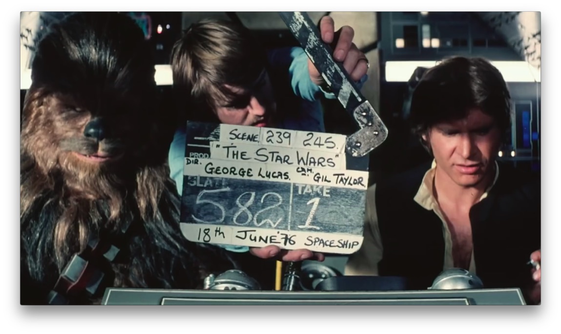

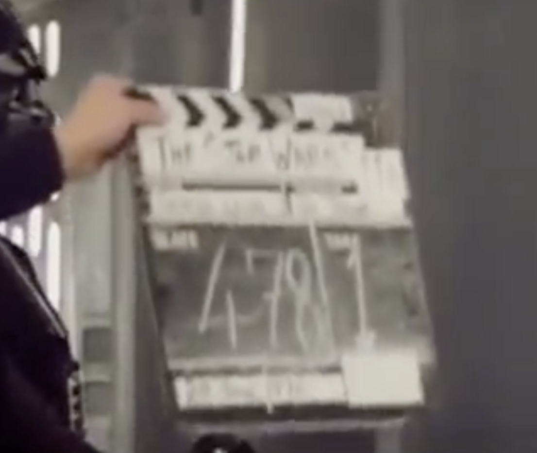

But why are the shots I've seen of the Star Wars clapperboards marked with really crazy high slate numbers? This one has a slate number of 582. That couldn't possibly have been the 582nd take since the last setup. Any ideas?
582 is the scene number. Obviously that's not the scene number, I didn't notice it was at the top of the clapperboard.
Yeah, the Star Wars board has:
- Scene number
- Production title (when it was still "The Star Wars")
- Director - George Lucas, but it could be an assistant director for second and third unit takes)
- Camera (DP/cinematographer) - Gil Taylor
-The aforementioned mysterious slate number
- Take number
- Date day/month/year
- Location name

Could it be "slates" equals scenes in total over all the days of filming so far, as opposed to slates/scenes from that day? So by this point they had filmed 582 scenes each with a "new" slate but they'd been filming for a few weeks. Depending on how many scenes they were filming each day this is somewhat plausible.
For what it's worth, a "slate" number is the camera set up and tend not to be reset each day. It would still refer to a scene and shot number - which can be marked elsewhere on the board, not always though - but it would certainly be listed in the supervisor's log. So slate 587 (for example) could be Scene 37 Shot 14. You'd then have the "Take" number. It's a system that I really don't like as it just feels unnecessarily confusing - you can't tell at a glance where you are.
The US set up, but the UK also use this too, so it seems quite interchangeable depending on the production you're working on, you'd have something much more obvious as to what you're working on, like Scene 12 / Take 4 - which would be a master shot. Move the camera for a new angle, lens etc, it'd then become Scene 12A / Take 1.
PB Props: Thanks for that info! It seemed clear that they couldn't have reset the slate number each setup, owing to the massive number. But it's definitely confusing.

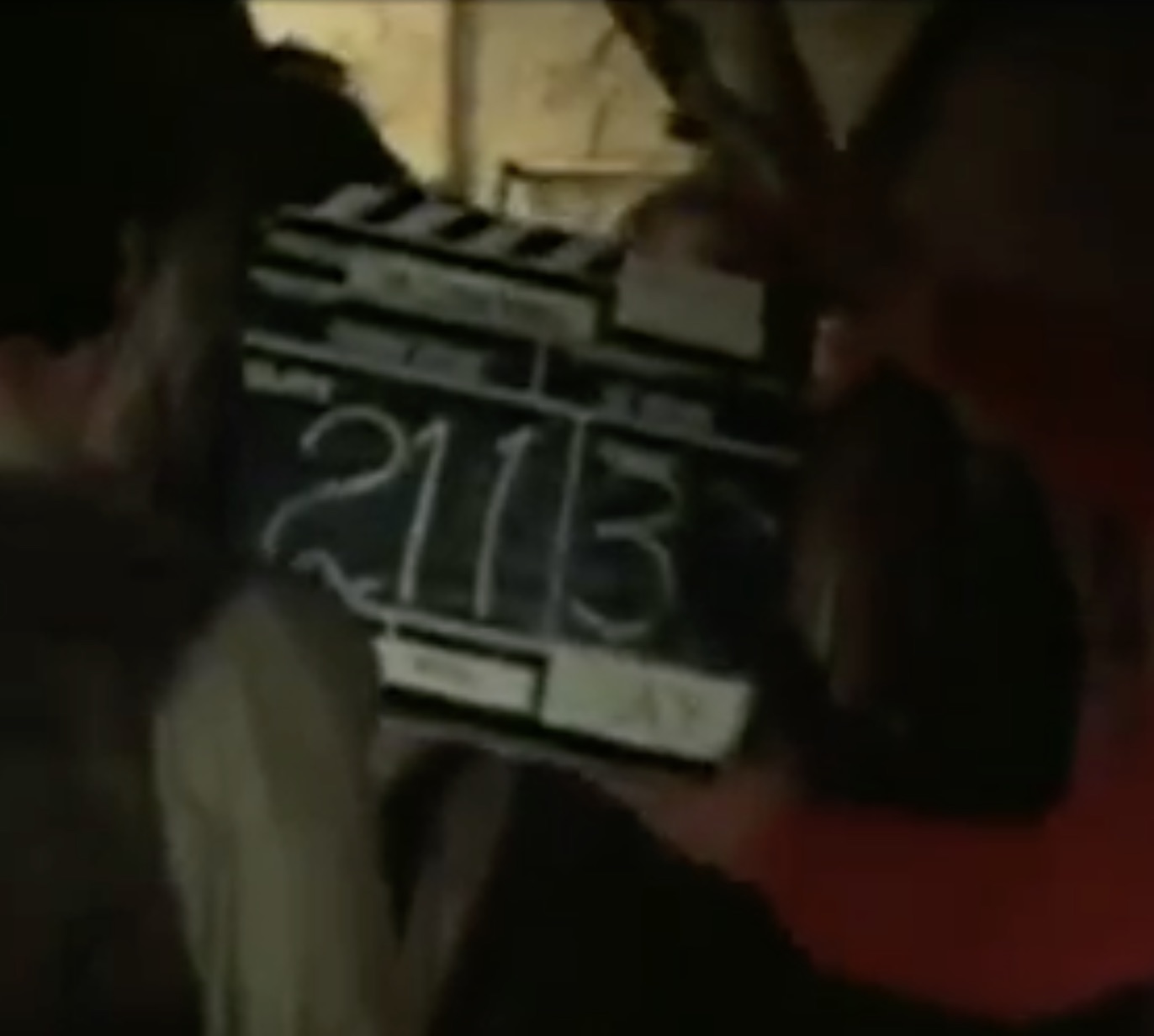

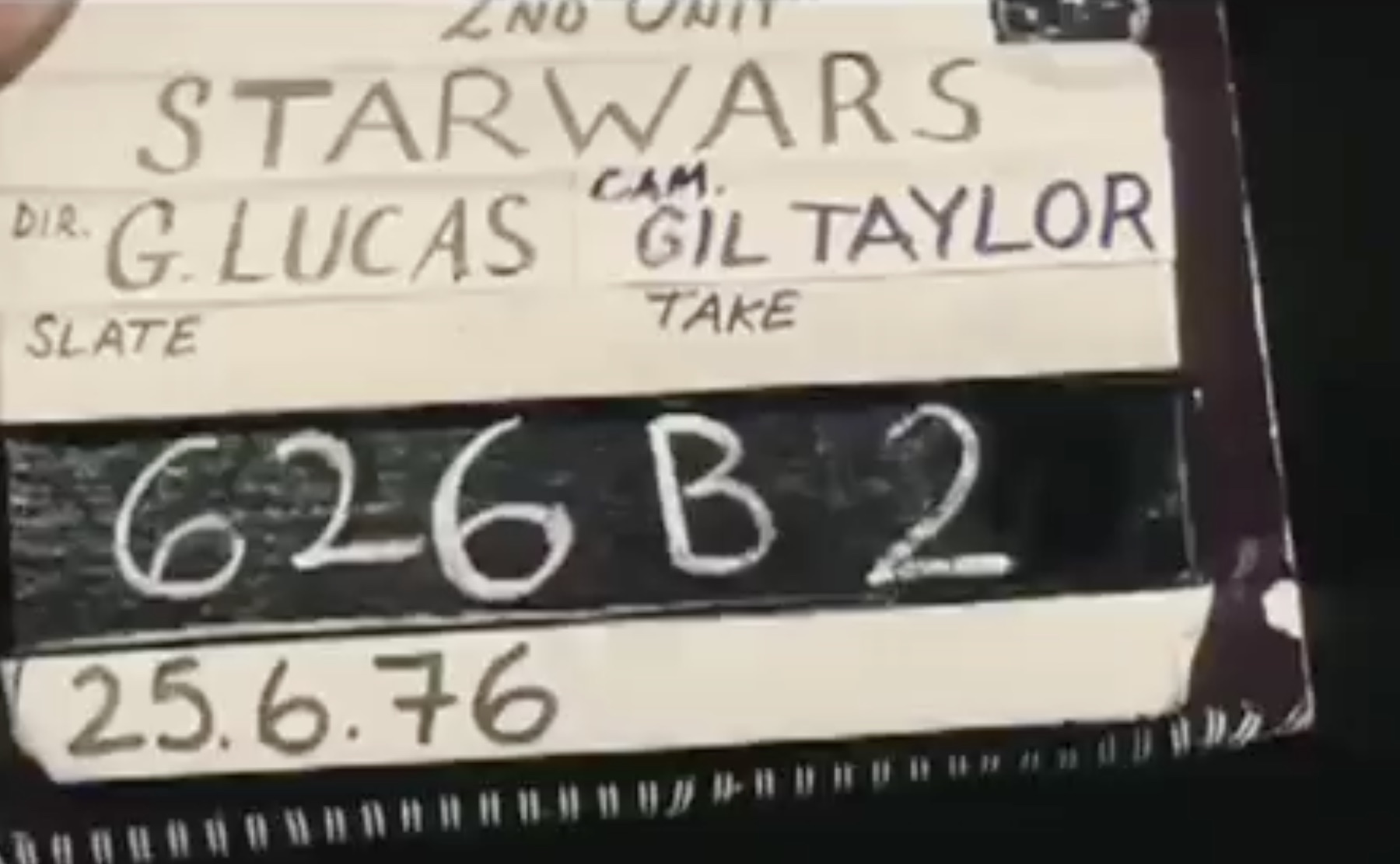

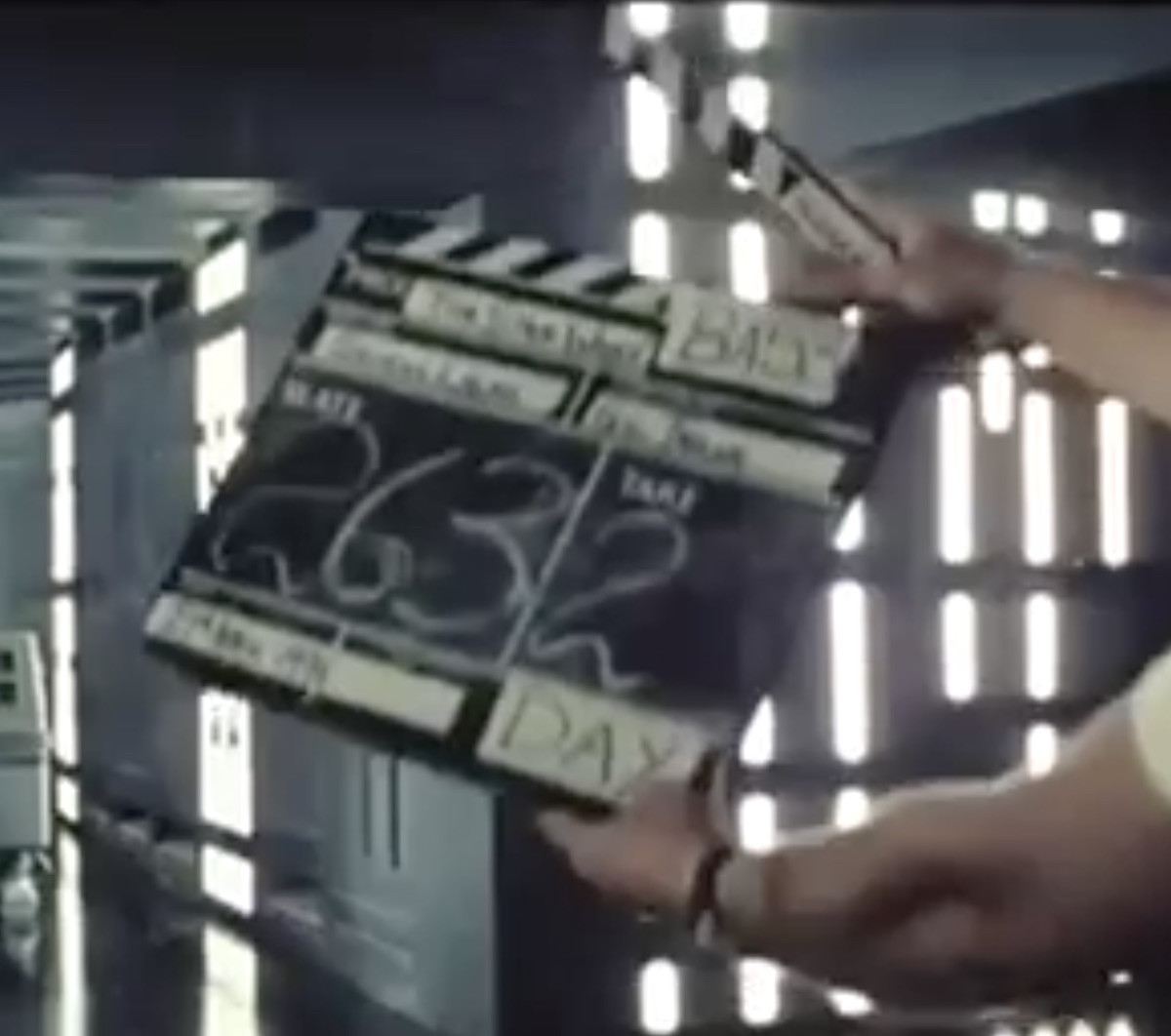

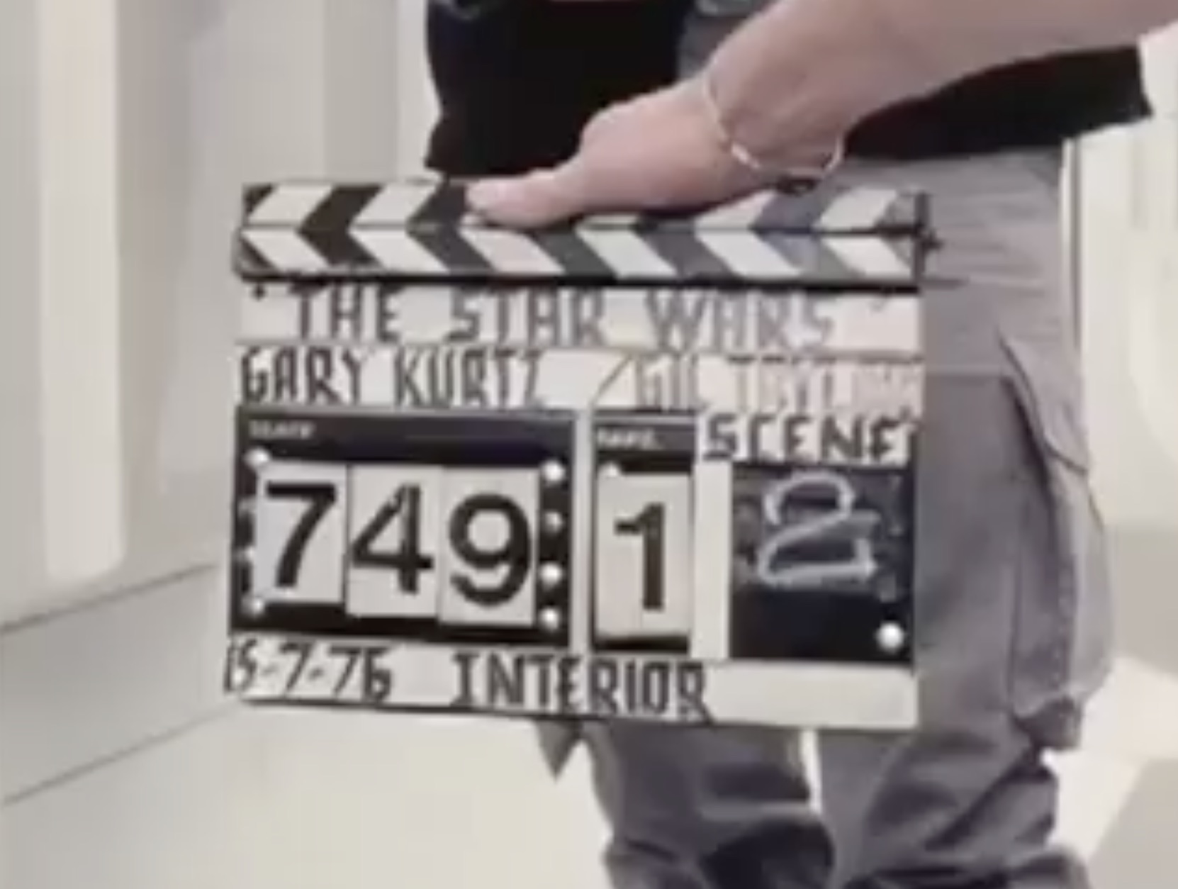

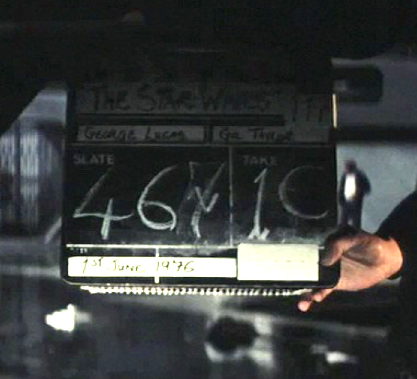

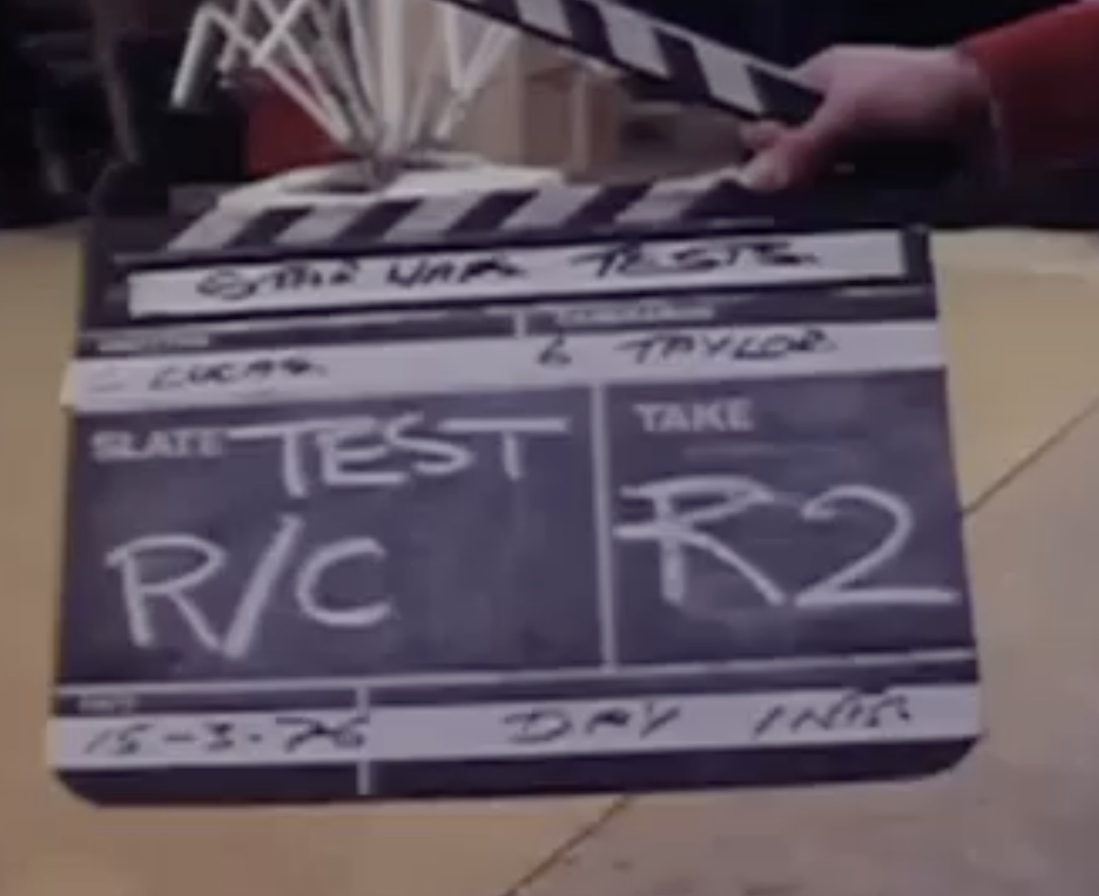

One other interesting thing is the variety of slate types that they used filming Star Wars. The white tape arrangements were obviously different, but there was also a lot of variation in the actual clapperboards themselves.
Yeah, slates / sticks / boards come in all shapes and sizes. Some are quite basic, others can have a tonne of additional information on them. It really depends on what the director and editor are looking for when marking up.
I see on some of your shots, a few of the boards even have the grey scale charts stuck on the back and flip down when needed.
