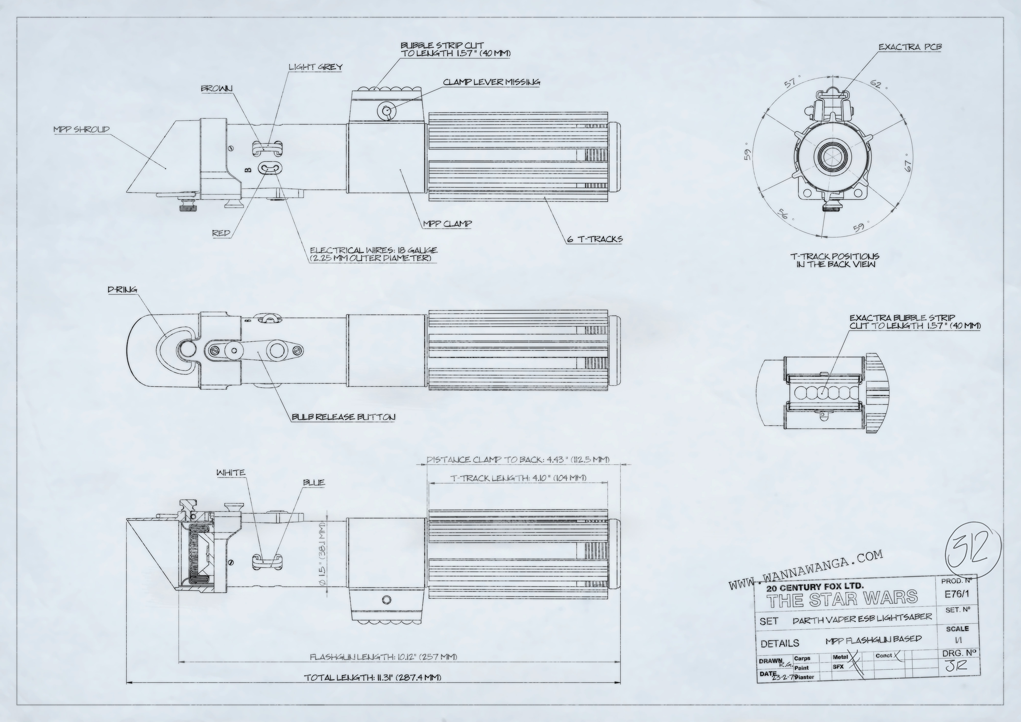

Wannawanga blueprint to show the disparity:
https://goo.gl/images/3zG8UV
I've looked around and have only seen a handful of finished hilts that have the same grip length and dimensions as referenced in Roy's guide, and most of them are handbuilt props using real MPP's.
Is this disparity in grip length and therefore clamp placement (since the clamp is always going to be right on top of the grips in an ESB config) an inaccuracy on the part of the MPP 2.0 AS WELL as the MR LE? Is 104mm the true measurement toward accuracy for the prop itself?

In my opinion wanna wanga's measurement is too short for ESB and rotj.
Do a search for Gino's specs. I personally like those more.
Wasn't aware there were other individuals who made reference data for sizing and proportions. I may do that, since it seems that in general, most iterations of the Vader ESB hilt use these longer grips than what is seen in Roy's blueprint.

Ok, so how long are the ESB tracks?
Depends who you ask!
Gino: 4.25 inches or 108mm
Roy: 4.10 inches or 104mm

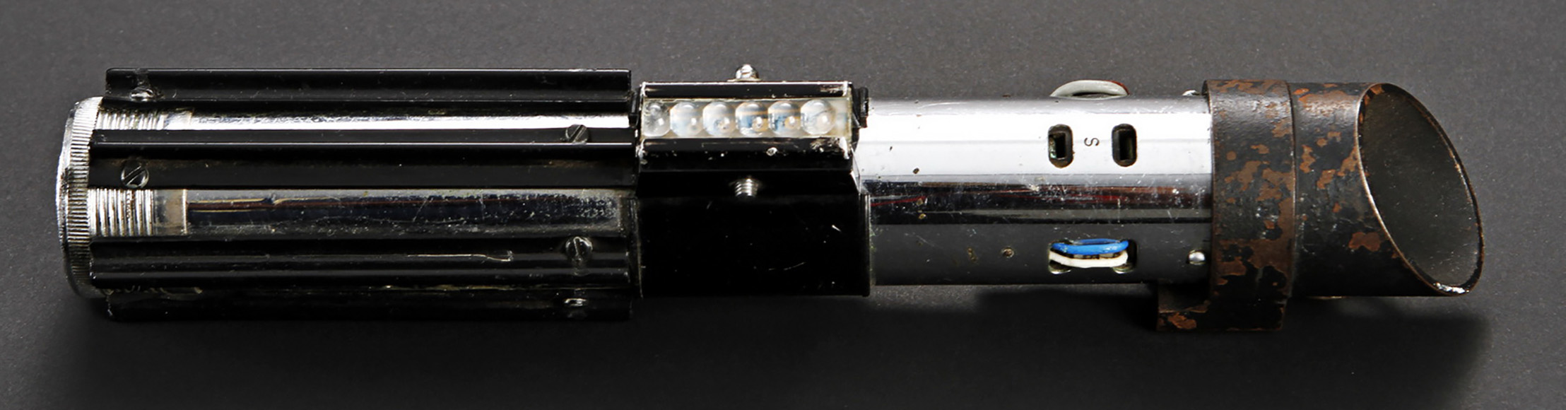

Hey guys, so teecrooz message just made me curious, so I took the esb prop picture seen from the side in photoshop, rotated it a few tenth of degress to have it perfectly straight. put it at the right scale (with 3.75mm tube diameter and 4.85mm clamp length) with that I get a 106,5mm short grips and 109mm long for the bubble lined up grip.
here is the picture put to scale that I used:
I guess this is exactly in between Roy and Gino measurements ;)
Now I also remeasured from the bottom to the first S hole and I get 19.5cm, in photoshop I get 19,7 with my scale. If I put that back to 19.5, I get 106mm for the short and 108mm for the long one which is still close.
I hope this can help

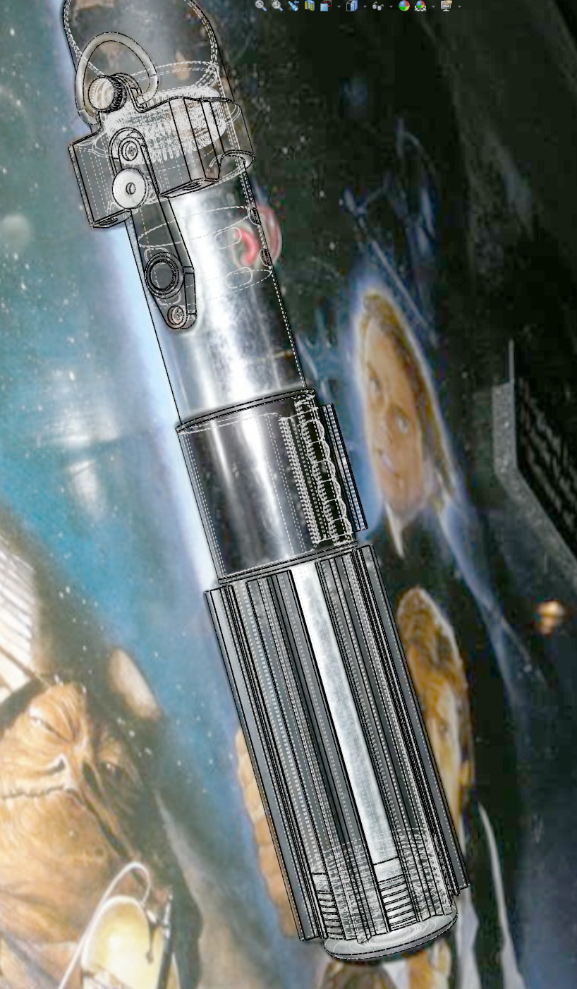

This is pretty close, but not close enough; this way you don't take the perspective distortion into consideration.
I did a perspective match with my CAD model of the MPP with the older images when the prop was still hanging in the museum. The view is also pretty much a side view and I came up with the length of the tracks as shown in my DV ESB blueprint.
I could try to do the same thing but with these newer images. I'll try to make some time for that soon.
thanks for your answer Roy, i really don't want to launch a debate but I think your grips are just a tiny bit too short on both ends in your CAD, in the picture we can see they really touch the clamp and in your CAD overlay, we can see the corners of the real grip on the bottom left that is longer than your model. also, it seems that totally randomly on that picture, the most visible grip on the right is a good milimeter shorter than the others for some reason. All in all, I think my average might be closer ;)
Not to start a debate, (please don't take this any other way) Roy's blueprint vrs the photo above looks like the grips are lined up differently. The picture above looks to show the grips lining up with the clamp card. Roy's print shows different. Am I seeing this wrong?
Roy, question for you. This scaled drawing looks like the grips run into the sides of the clamp card. In your blueprints, the track looks to line up with only one in the center. Am I seeing this correctly?
No, it's lining up with the clamp in the center. Here's a picture that shows how much centered it really is :
