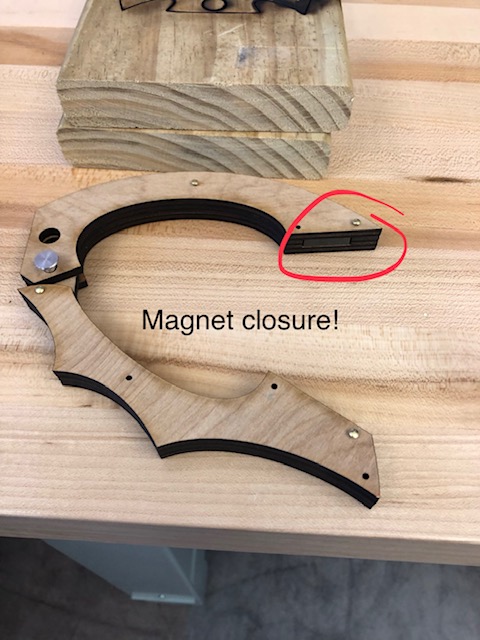

The cuffs are designed in six total parts (3 layers each for the top and bottom). The prototype looked pretty good but too thick! I designed them to use a bar magnet for closure.
I changed the outer layers to a 3/32" board and was able to get the total thickness to about .4".

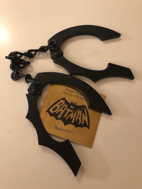

Here is the version that will be making the DFW Prop Party, might try going thinner next time. Chain is 9 links of 5 gauge jack chain. I have not attached yet, waiting on the paint to dry.
