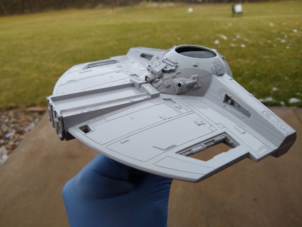

Those panel lines are particular difficult over the ball cockpit.Panel lines are always one of the hardest things for me to do cleanly.
Sometimes I'll hide my mis-scribes with blast marks or paint scratches [emoji38]

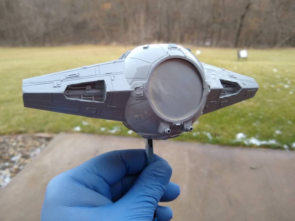

Actually, I've base coated black, will mask these "inside areas" and paint the ILM Stormy Sea frames.Makes sense, tbf the kit box looks okay as it is. Not to mention that it’s used in the ILM Tie bomber. Not sure about the angles. Masking and painting the solar panels black is gonna be a pain anyway.
Yea saw the primed pics. I did the other way around with the Bandai because then I had to mask only one black panel accurately at a time, but different strokes, I’m sure it’ll work out. Keep up the good work, really curious how the ILM Stormy Sea will work out.Actually, I've base coated black, will mask these "inside areas" and paint the ILM Stormy Sea frames.
Not necessarily easier but works good for me.

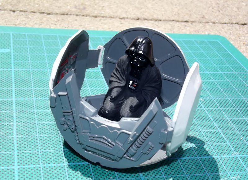

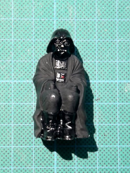

I'm sorry to chime in so late but I guess it is not too late. I too have this kit and wanted to improve the Vader figure. It is the weakest part of the kit. My first attempt was filling the strange ridges that go straight through the eyes and the helmet. Then I painted it. It looked better than before and really didn't bother with the rest much since I though it would not be seen prominently on the finished model.

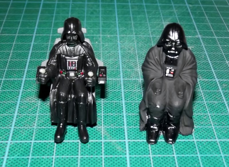

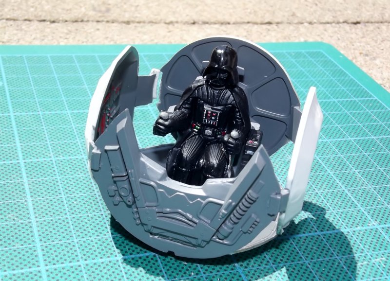

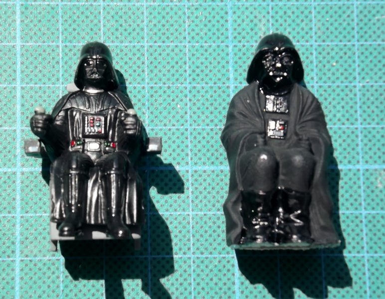

Then I got distracted and put it into its box again - for almost a decade! THANK GOODNESS - my laziness paid off because in the meantime Revell released their version of the TIE-Advanced. The whole kit is very similar to the mpc one with three major exceptions: It is slightly smaller and the cockpit interior was completely different. And the best part: It came with a new, much better looking Vader figure.
The Revell one is on the left, BTW.
This is how it looks inside the mpc cockpit:
A difference like night and day, if you ask me.
The smaller scale of the figure is not too bad. On the contrary, it makes the whole ship appear larger. Which is a good thing for a Sith-piloted craft.
