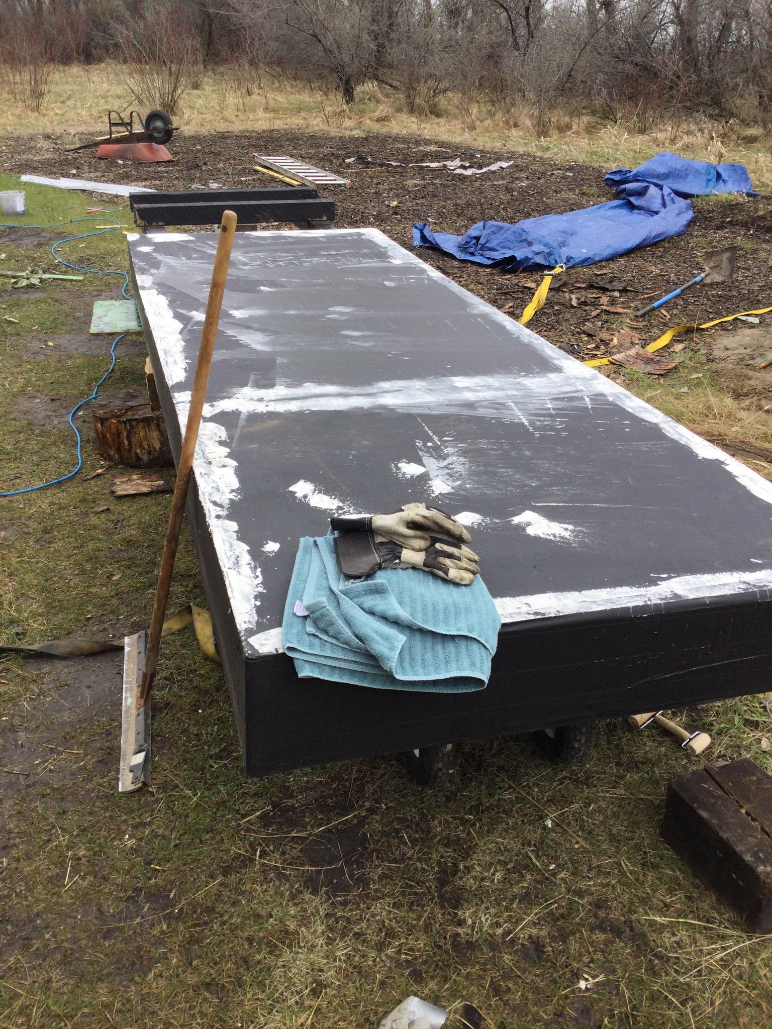

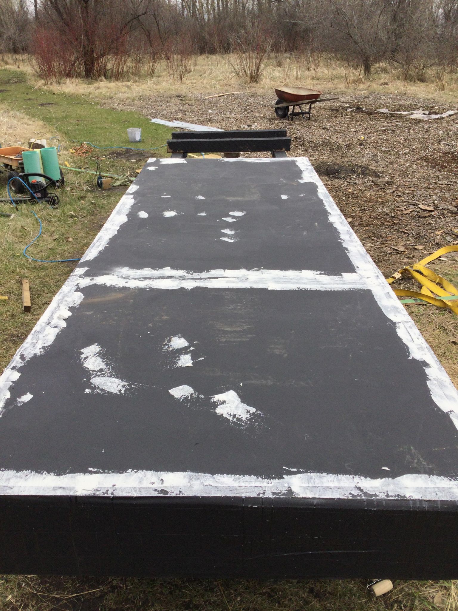

Due to the rain that is about to hit here soon, I decided the best use of my time would be to use a bit of drywall patch and fill-in any holes and scratches so that later they can be sanded down smooth.
with this done, I took this last photo and then covered the monolith under a tarp.
This might be the last Im going to see the monolith for a few days...

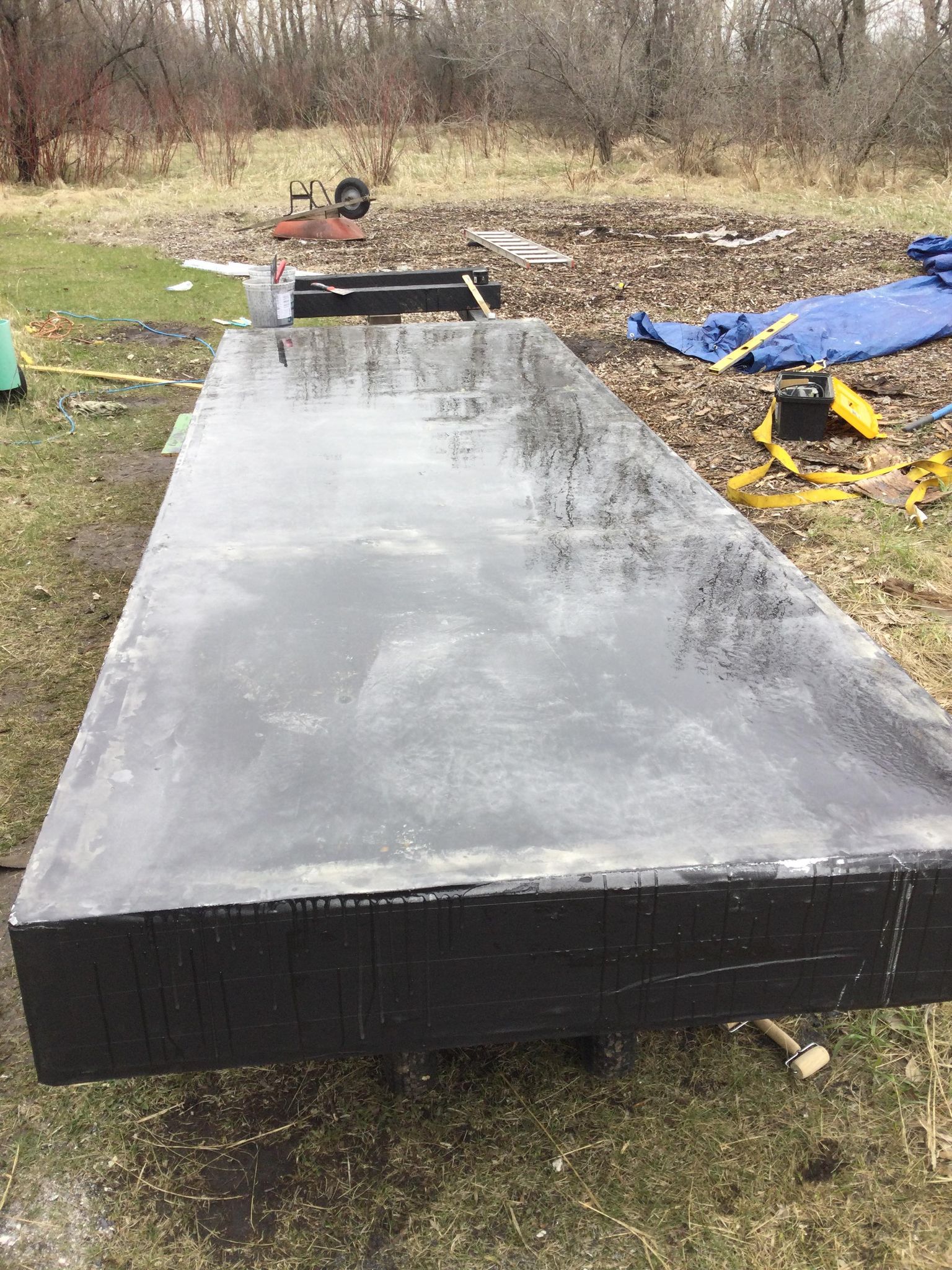

The rained stopped for a few hours, and so I went out to check on the tarp over the monolith.
and it has a hole in the tarp i did not see.
and the whole monolith is wet!
so rather than being able to sand everything, I can not sand anything.
Back to square 1
i took the tarp off and push the pools of water off the monolith.
There will be no sun today...so i doubt anything will be dry enough later to deal with.
But I will check in 2 hours...

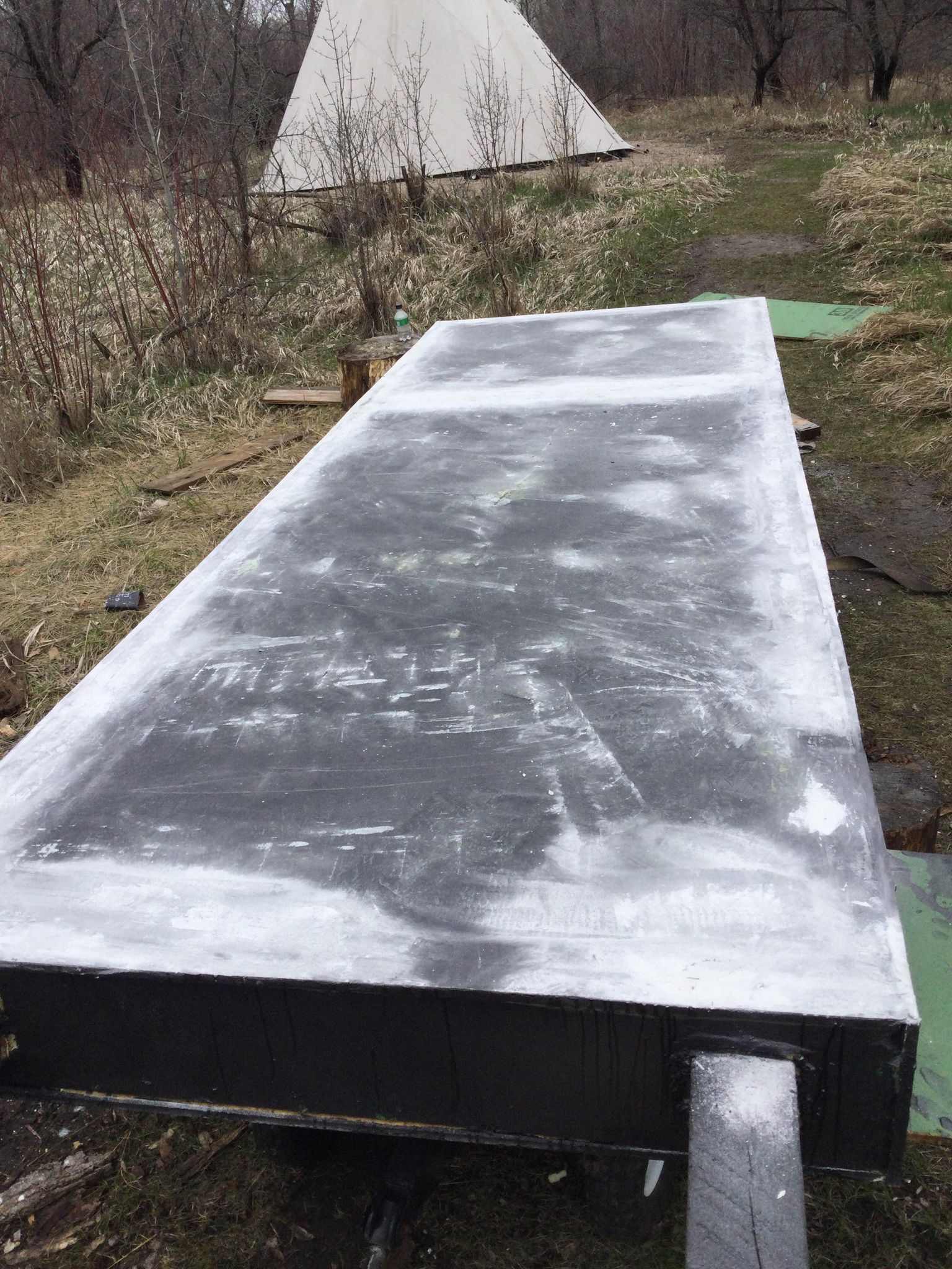

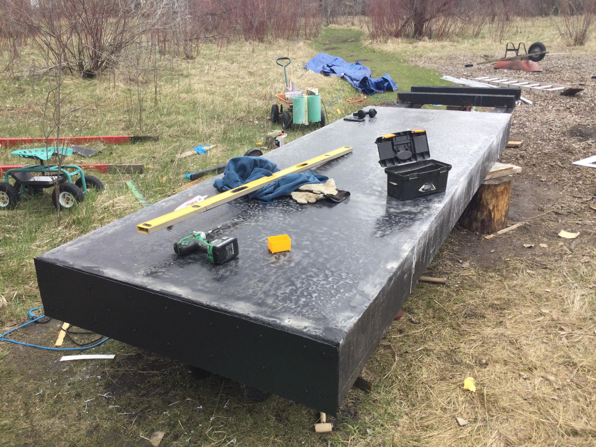

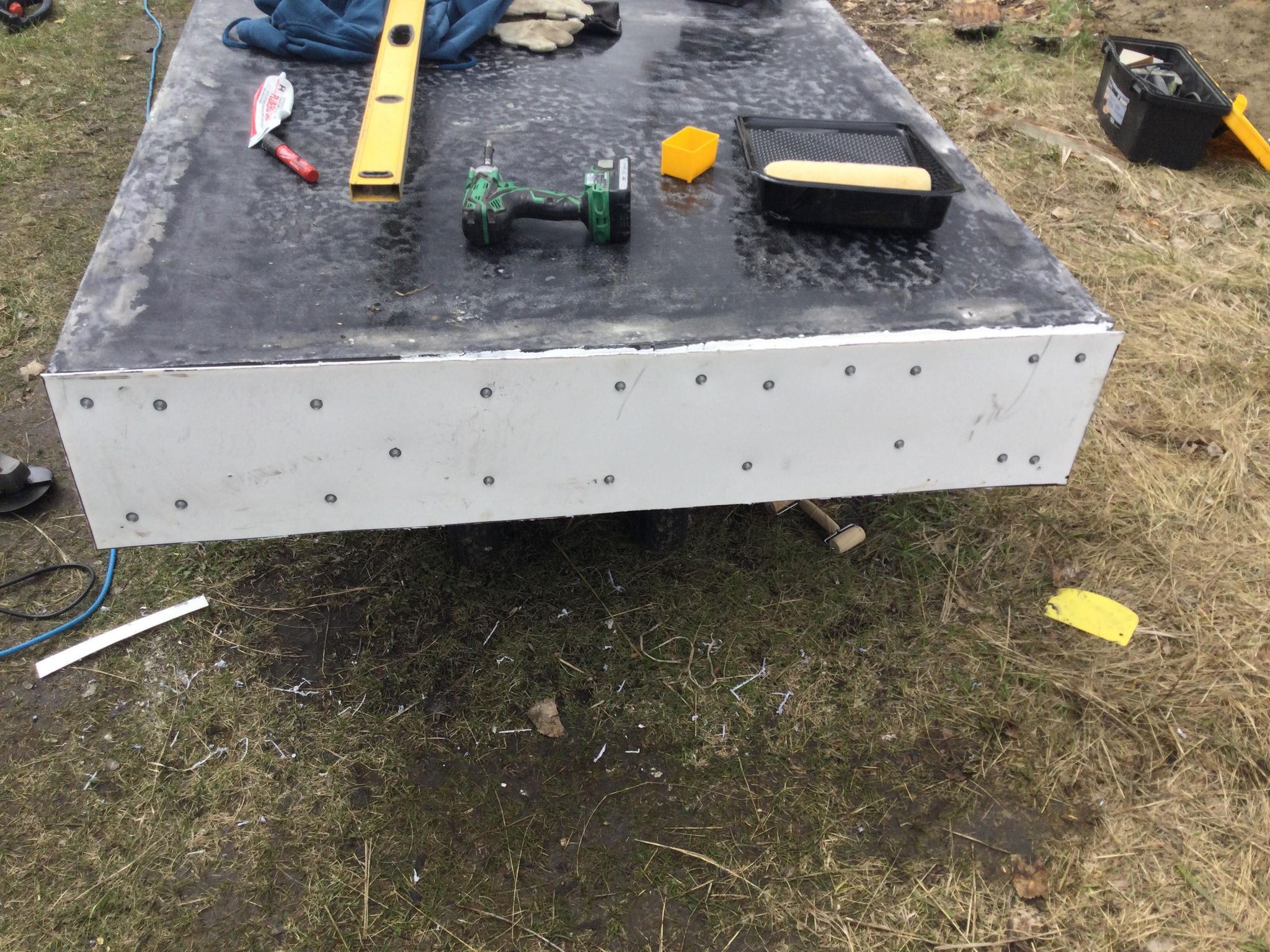

I sanded the first coat of Epoxy this morning.
I checked and , yes yet another huge batch of rain is due and the nice weather will only allow me enough time to address a few other issues today before I have to wrap the tarps over everything and strap it down due to the expected higher winds on the way.
But it was nice to get something done today for a change.
i checked the trench where I will be setting the Monolith and there are a few inches of water to deal with if I try to continue getting that ready.

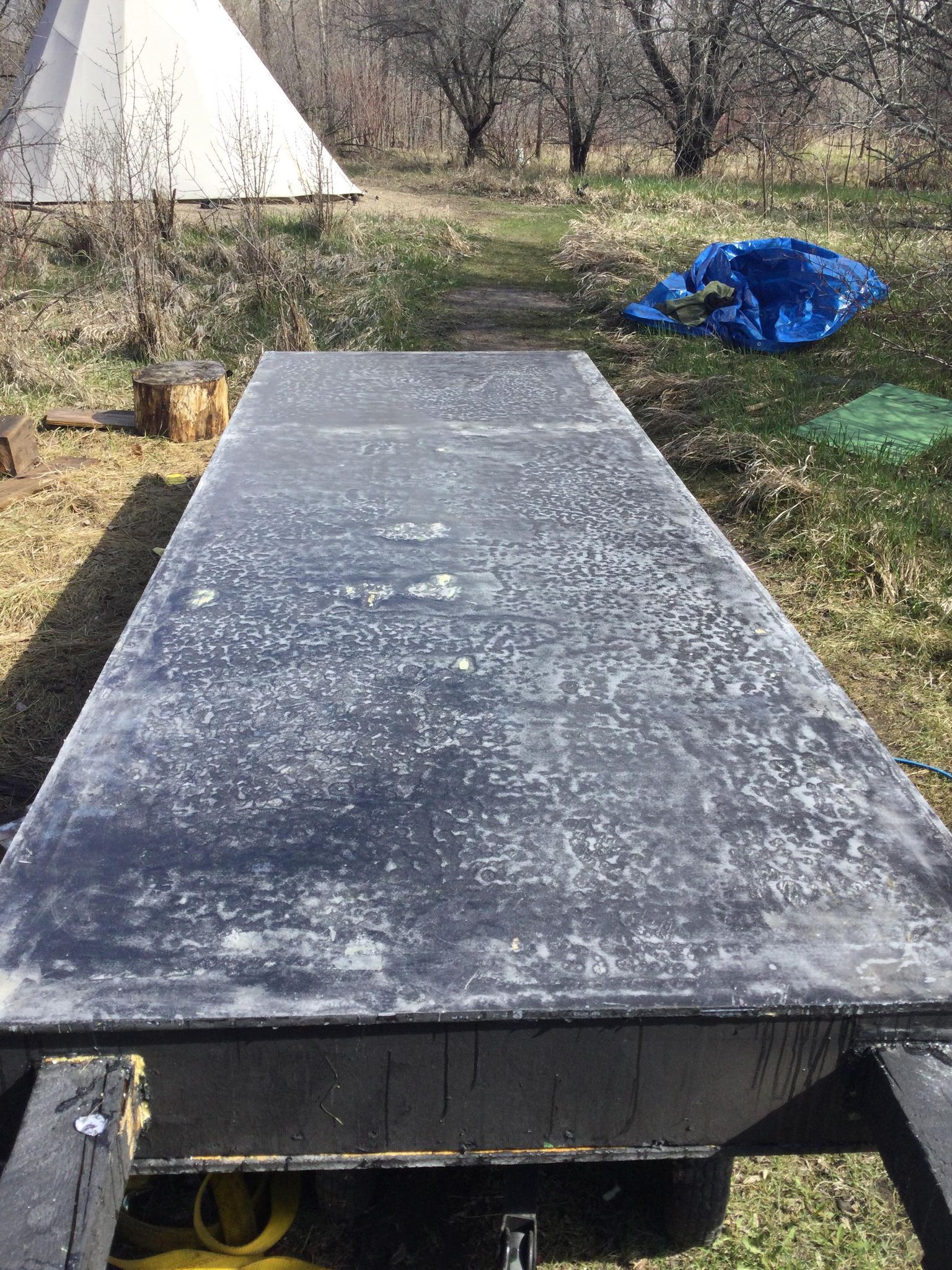

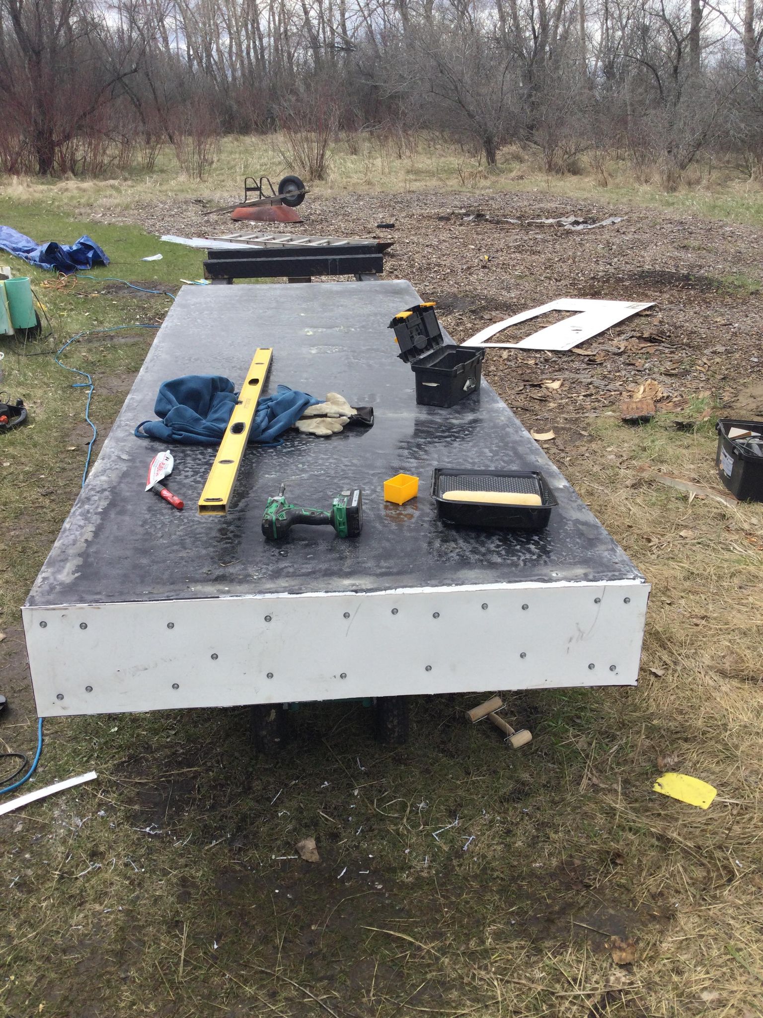

I decided that today I had enough time before the rain returns to work on the top of the monolith.
I always knew that I needed to have some type of a small waterproof overhang.
I looked around in my junk pile, (All retired old men have a junk pile to dig through, its required to own one when you get over 60 )
I found the thick plastic that was at one time our basement shower stall.
I cut it to shape , allowing for a 3/4 "inch overhang all the way around and screwed it to the top of the monolith
I filled the gaps all the way around with bathroom tub stuff, because...why not?
we will let everything dry the rest of the afternoon, then once again drag the tarps into position and strap them down...
Now the reason I went with an overhang is that I just wanted to try to not have water running down the front of the monolith.
I was warned by people that have built something like this project that water off the top will start to discolor the sides when it rains.
My hope is that the overhang will allow water to drip just a hair away from the sides.
Now will an overhang be noticed?...yes, that is likely...but I hope not too much that it will distract the eye.
