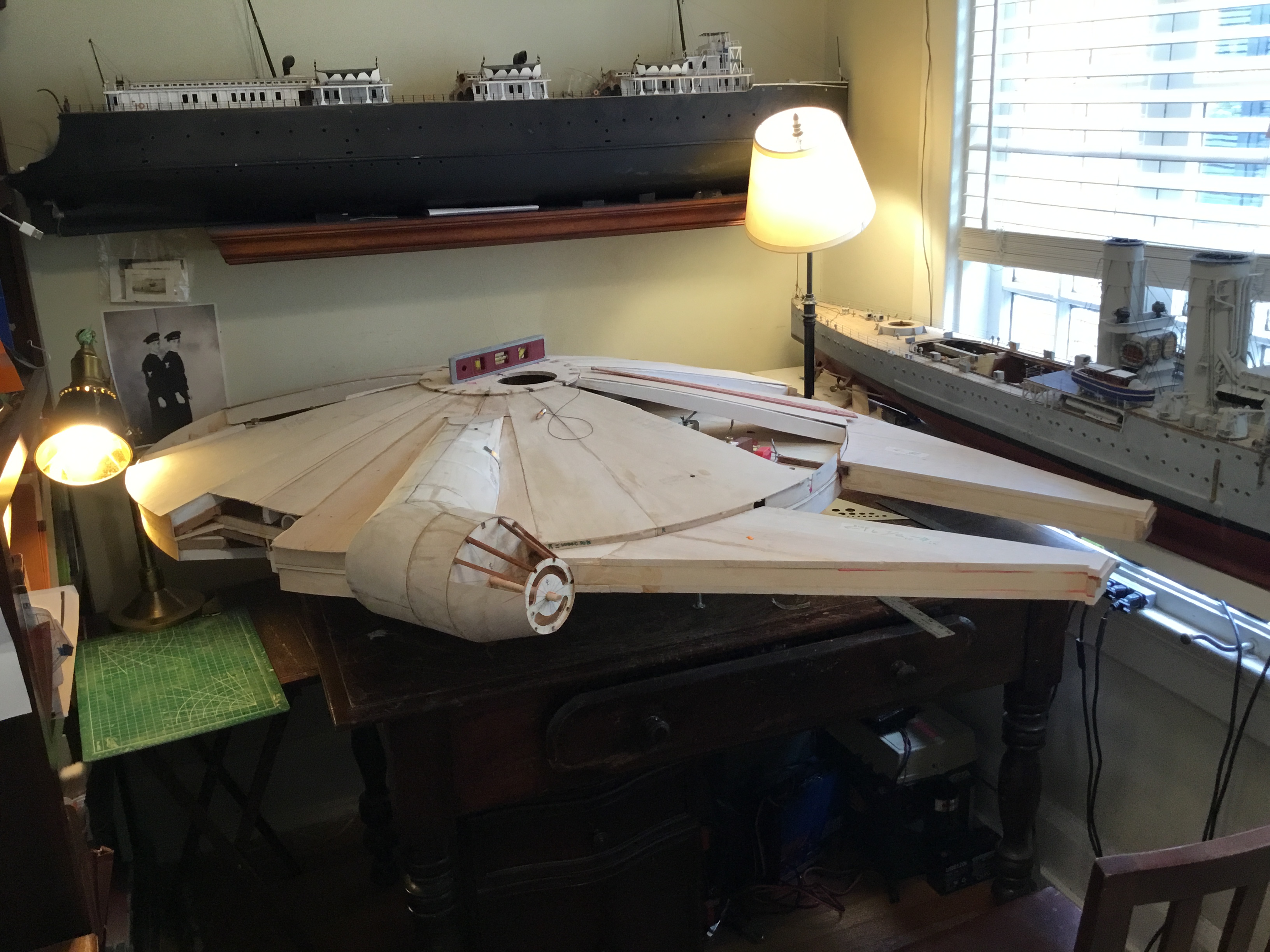

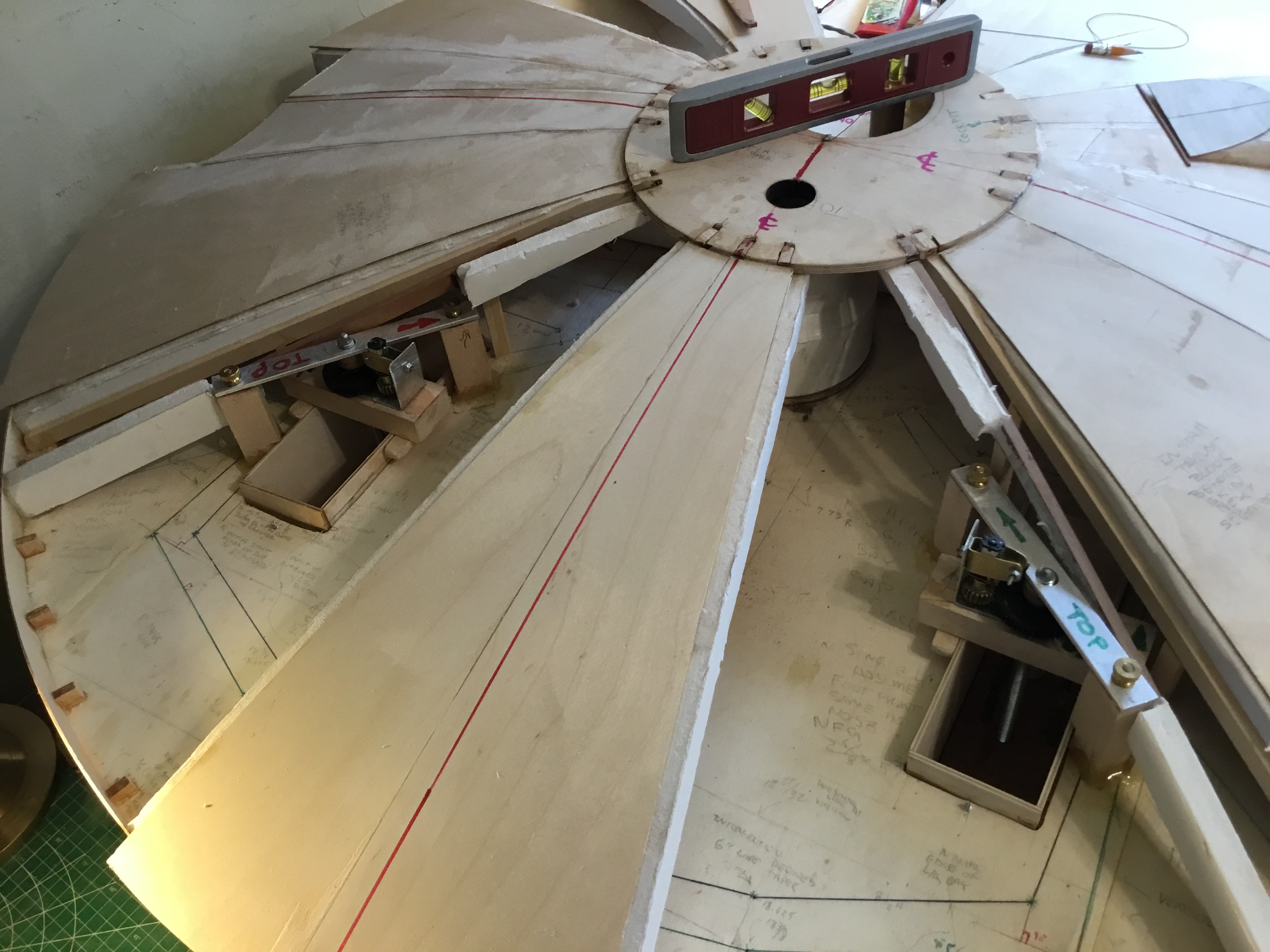

Finally got the nerve to start a thread on this site. Pictures show the model firmly standing on its tricycle, retractable landing gear ( a L/G fetish I have, but t’s another story). All major structure assemblies are removable for ease of building, detailing, painting and future access for servicing. My goal is a model of this incredible design that is structurally accurate to the open source drawings kindly provided by Andre and the “naked“ falcon renderings of Maruska. The plan is to apply aluminum armor after initial skinning, add a retractable air lock ramp, detail the cockpit, correctly position the (8) thruster jets for a smoke system, install lighting per original drawings, possibly design moving engine cowl flaps (another aviation fetish) and base it on a Cloud City helipad desk. Note I added side and bottom armatures for alternate flight display mounting. Beyond that, surface detail design, comes later.
Yes, I have knowingly taken the risk of “putting the cart before the horse” by not using kit parts or 3D fabricated greeblies to validate dimensions. However, time is of the essence. Have time left to build or collect rare kit parts, not both. My son is a serious Star Wars Collector and he looking into this for me. I am learning about parts maps.
Many thanks to Studio Kitbash, Sean, Eagle1, Gort and Geek1138 for response to PM’s on critical questions that have not been readily answerable in-spite of my rereading applicable threads. It is amazing to me how the components of a complex design fits together if one is careful to constantly watch material thickness and measure / level continuously. A real tribute to Andre and his team and those on this site who have offered advice.

Skinning will be .032 aluminum and copy the Bandai PG Falcon armor segment pattern. Nibbler makes perfect notches as shown by others on this site.
The story on landing gear fetish: Goes back to the mid 60’s when I did a hitch with the airlines after working fixed base on light aircraft. DC-6’s were still being used on the Martha Vineyard run from Logan. On my walk around, I noticed one of the micro switch brackets on the linkage was cracked. Located on each landing gear leg, these give a down and locked green light to validate slight rotation past 180 degrees. That physically prevents collapse upon landing. I made the deficiency entry but refused to sign the log book to release the flight. Most A/E’s ( now called A&P) will never risk their license when they spot something wrong. Management released the flight. Upon reaching its destination, that aircraft landing gear strut collapsed with a full load of passengers after taxing to the gate. My Falcon gear will not collapse.

Thanks. Yes, built from original drawings and pictures. They are remote control. Unfortunately, I have there removable super structure off at the moment and the pictures are terrible.
Years ago I did an approximate 7 ft. Disney Nautilus skinning it in .032 brass plates that were drilled and riveted before application. Since I now know about this site and it‘s large size qualifies somewhat as a Studio Scale, I will post some pictures when next visitI get my son’s house. Some of these models take a long time to build as you all well know. Hence, even now retired at 75, this is why my focus on the Falcon needs to be prompt-dedicated effort. Good thing is I got my COVID shots. That buys me some time.
