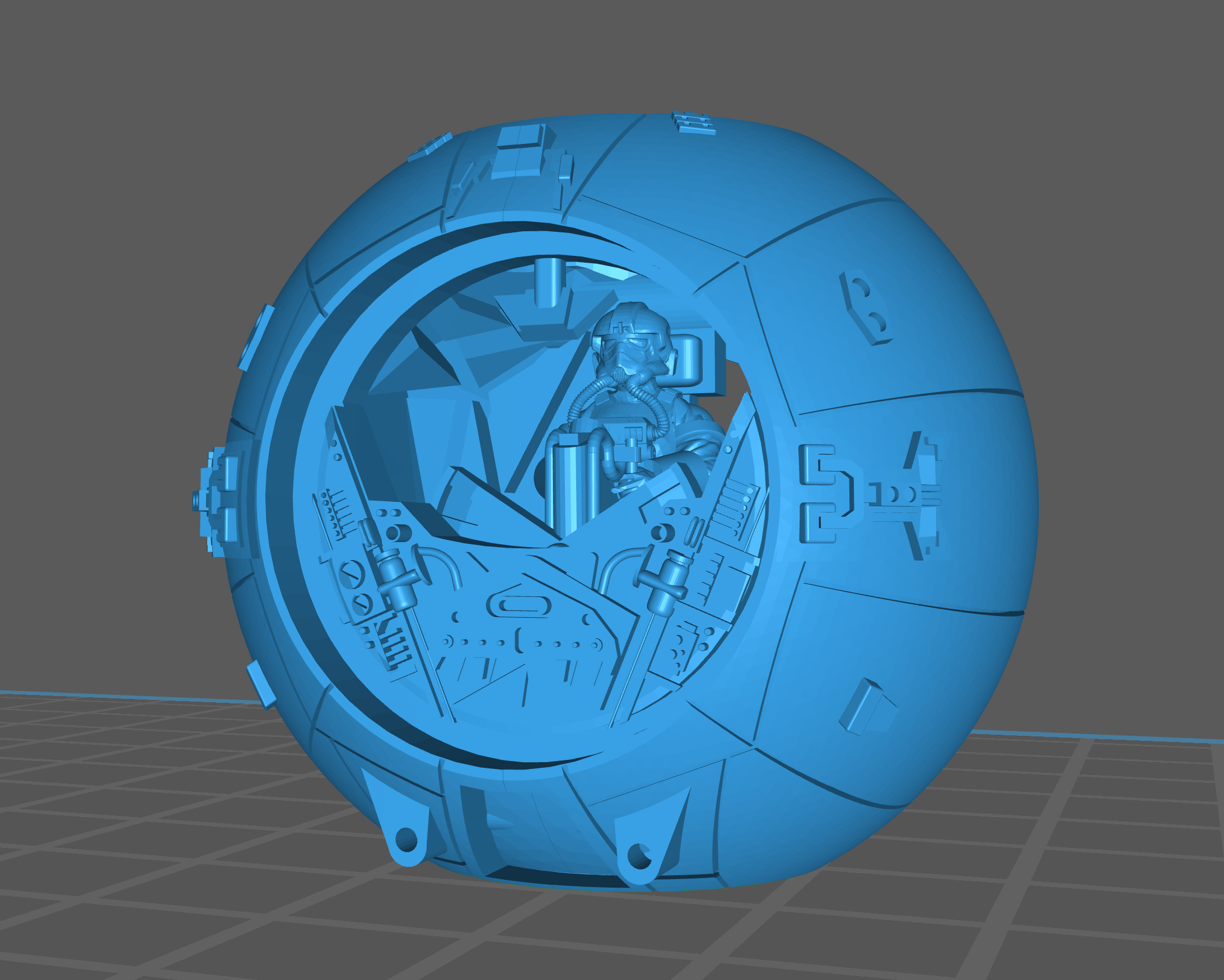

Then I ran into a hitch. The way that this is designed, the ball is split vertically into two halves. I didn't think this would be a problem, but after printing, support removal, curing (and resulting shrinkage), the two halves didn't exactly line up.
That cockpit consists of 5 pieces, and there was just too many things going on for it all to fit together well. SO! Back to the computer I went. I brought all 5 files into MeshMixer:
And combined them all into one part: (MM makes the preview of the model pretty low-rez. The actual model is fine)
With that, it was saved out as a new STL file and brought into ChituBox, with supports being added:
This might not be the most optimal way of printing/supporting a sphere, but it printed perfectly on the first try, with just a few support marks on the back of the ball to cleanup.

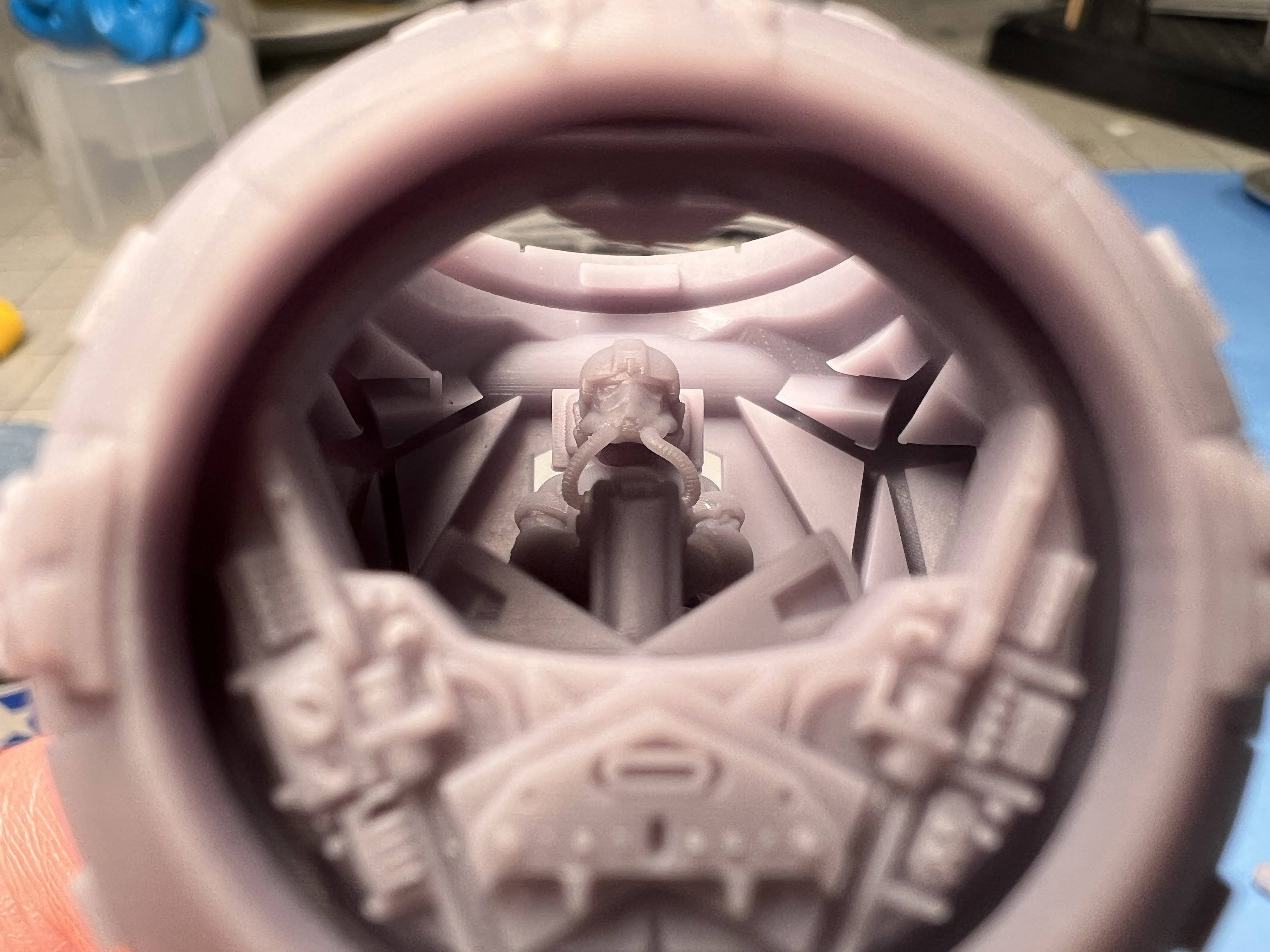

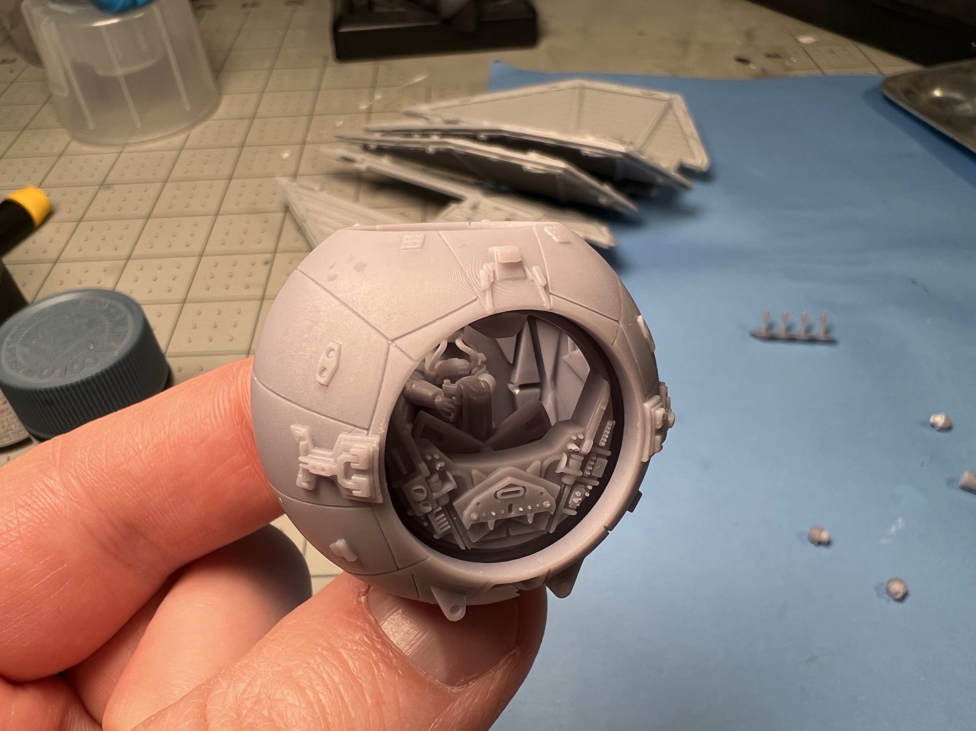

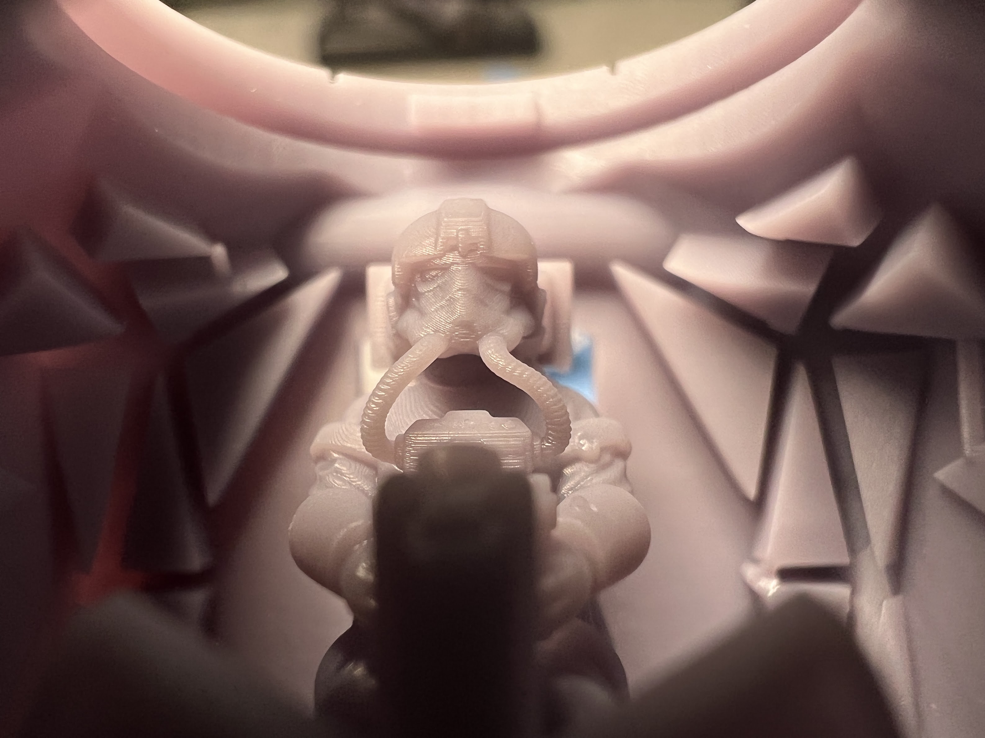

You can see a few layer lines in there, but I think between primer and a bit of sanding, those'll go away. It still blows me away that you can just print stuff like this. Here are some closeups of the cockpit and pilot: (and remember, this is all one part now):

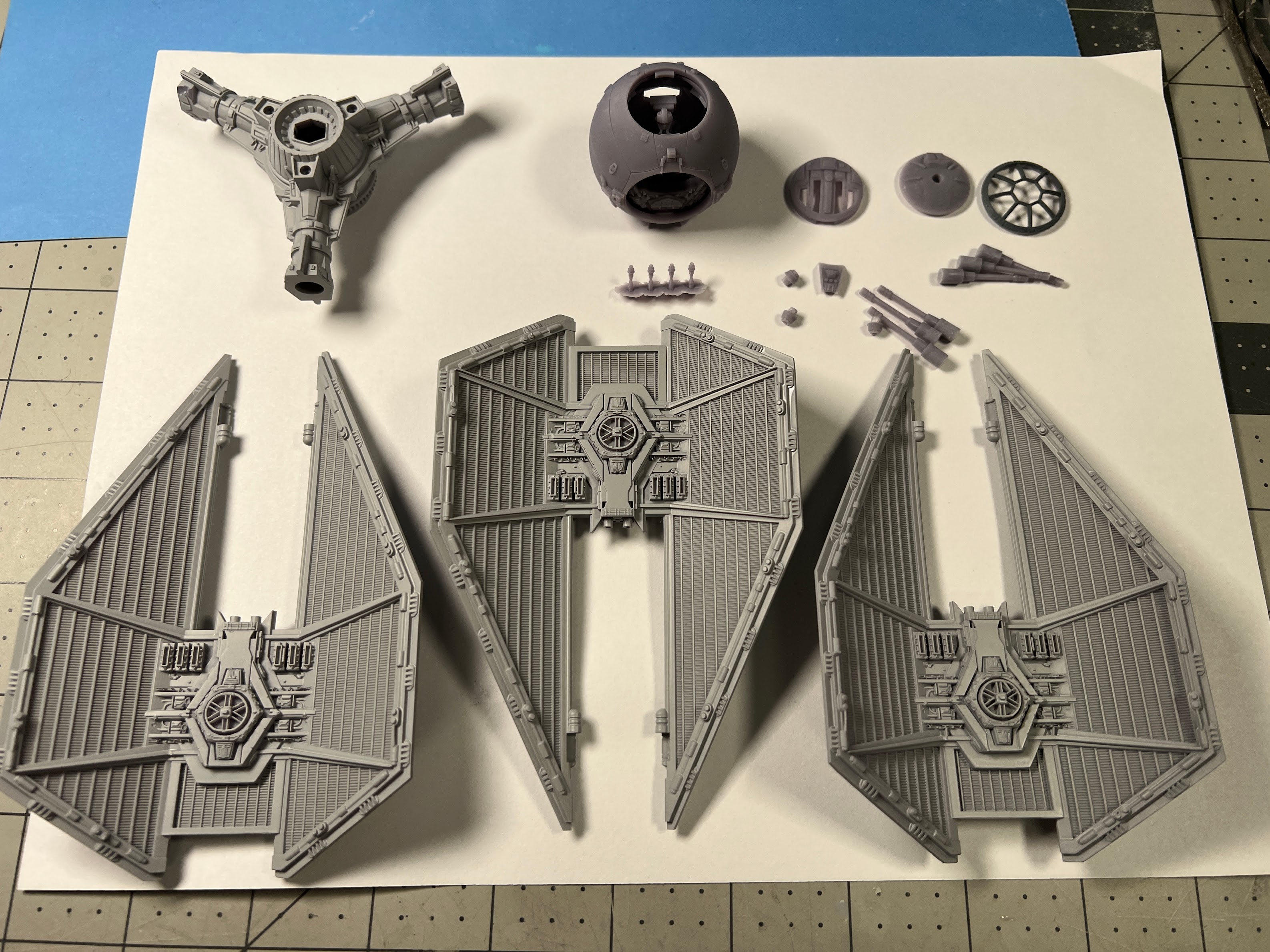

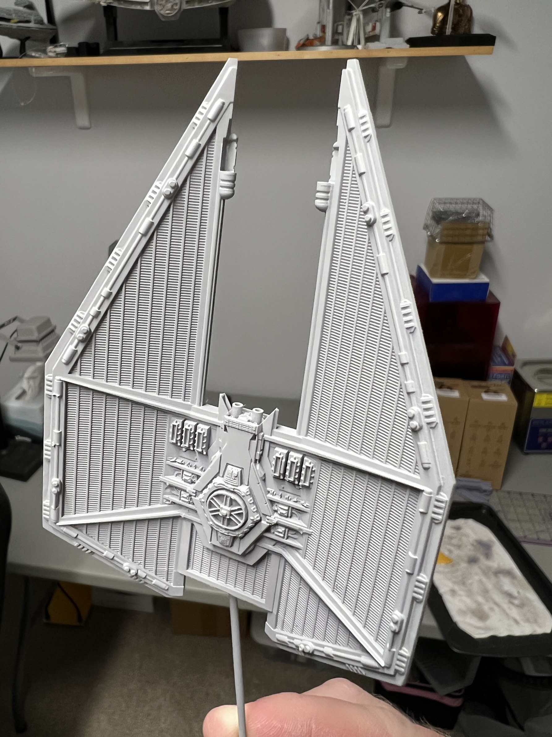

I cleaned up the supports on the wings and the engine tri-section, and those got a layer of Tamiya fine surface primer:
Here is a group shot of all the pieces together. A simple build, really.

It's not shrinkage in the usual sense of the word - printer resin is pretty dimentionally stable, but what you do get is deformation due to support and suction issues from the printing process. These usually only occur on the side that faces the build plate and can be eliminated with the right support, but that is a black art that I for one have yet to master.
It's very hard to visualise the problems in your head beforehand, even with the help of slicer software - I usually end up with a trial and error process, but that can get costly in wasted parts :(
The downside to getting the support right, is that you usually end up trashing any detail on the areas where you have ended up with tons and tons of support. There's always a catch :)

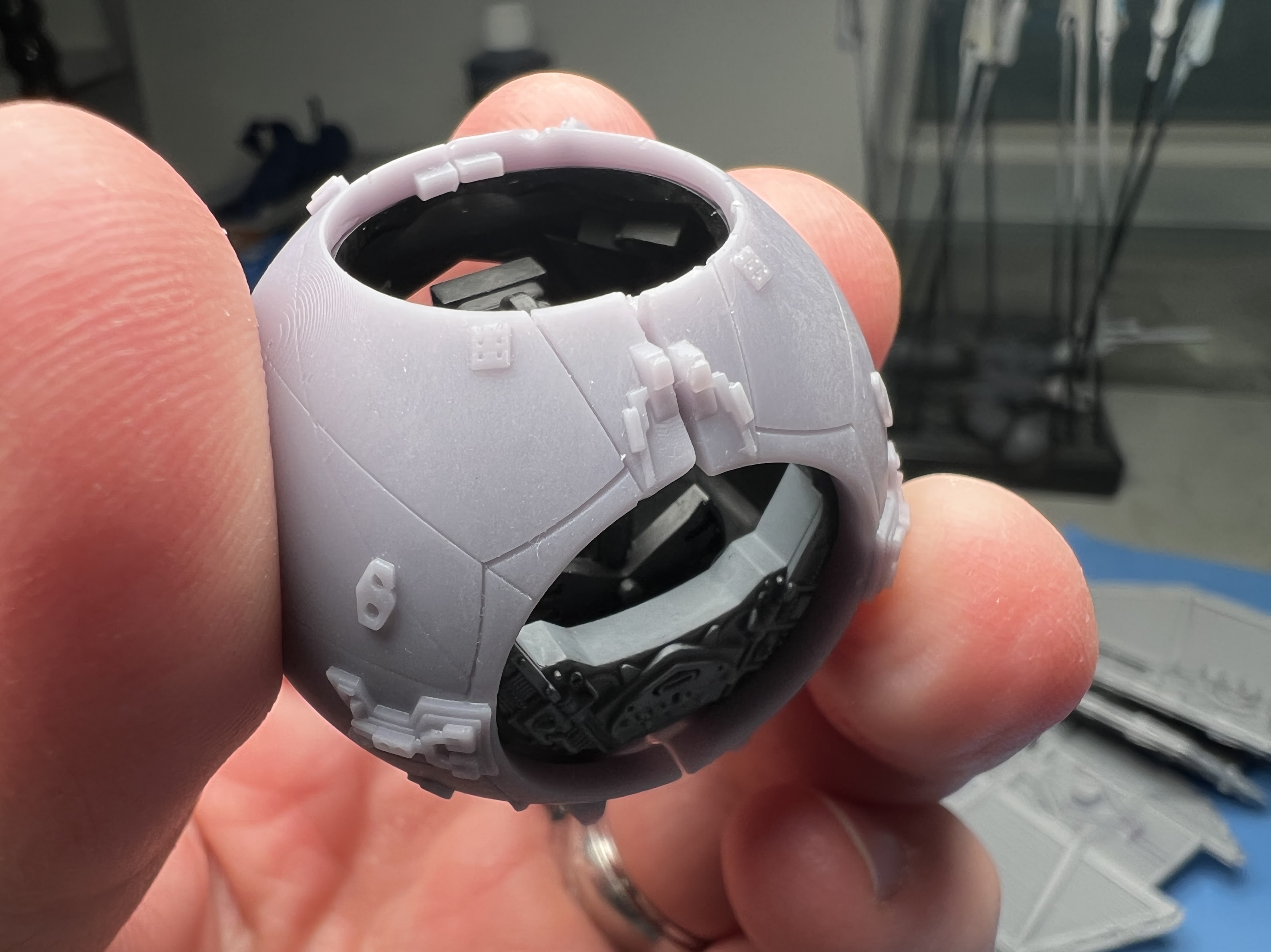

I painted the cockpit black. I didn't worry about any detail painting inside because you won't be able to see it at all.
I then glued some styrene in the back of the engine section, closing it off:

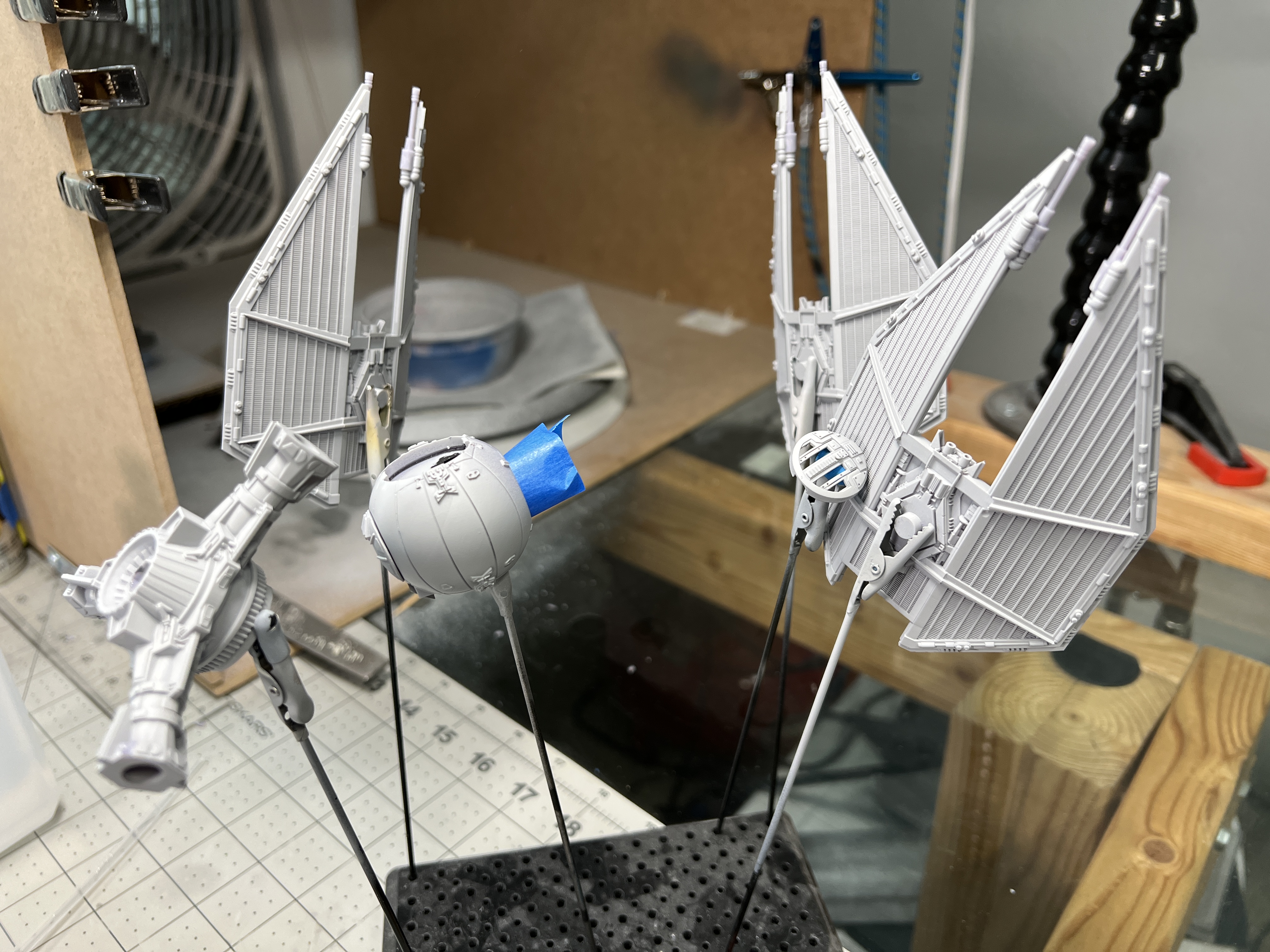

Here are all the primed parts ready for paint!
I came up with a Tamiya mixture that I think is a good mix of gray and blue. I used XF-19 Sky Gray and XF-18 Medium Blue. The ratio is like 5:1.

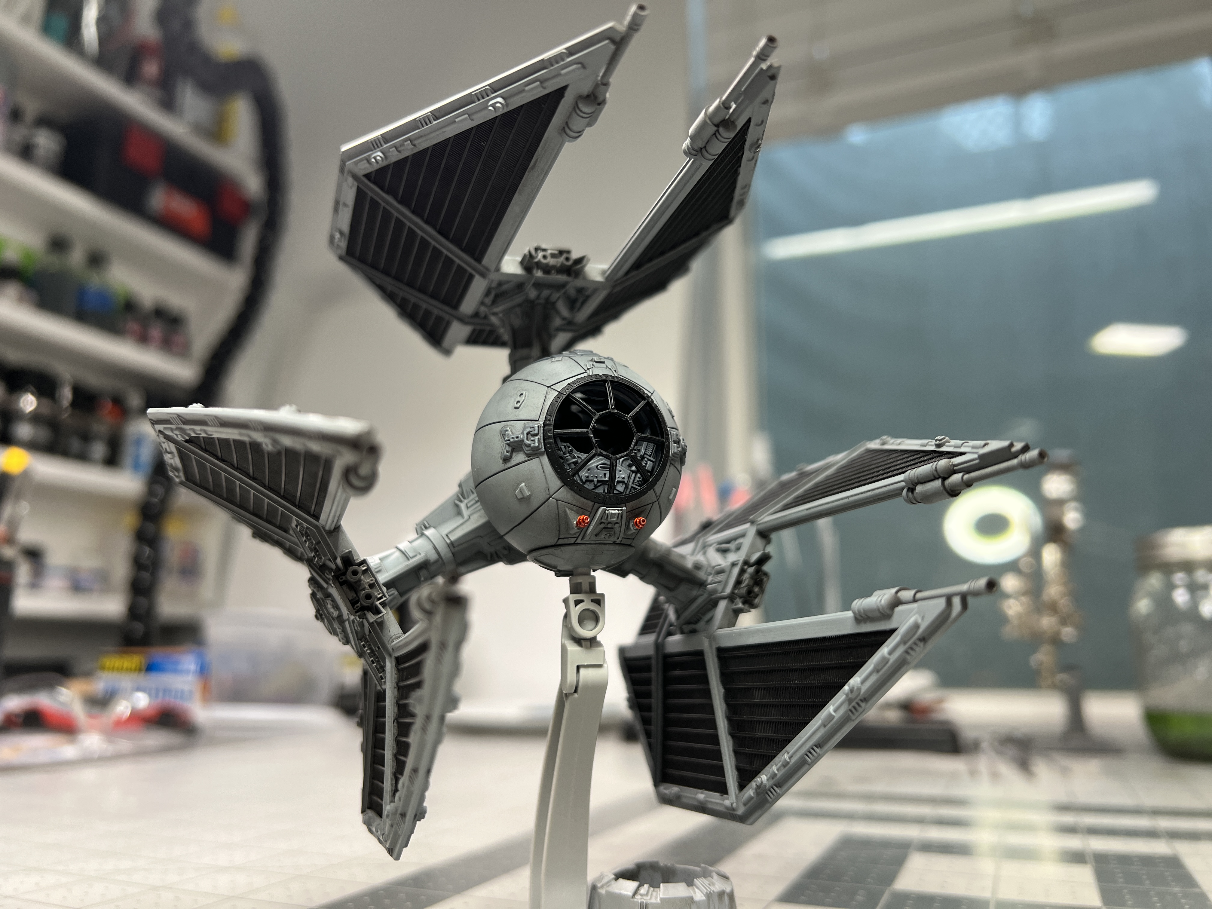

Finished this up over the holidays. Picked out some details with XF-53 Neutral Gray, and then gave it an overall Starship Filth oil wash. Broke out the airbrush and painted some subtle streaks and scoring around the gun areas, and then I topped it off with the addition of the red guns and I'm calling this one done!
Thanks for following along. The last post will be a photo composite. Just need to think of something.......
