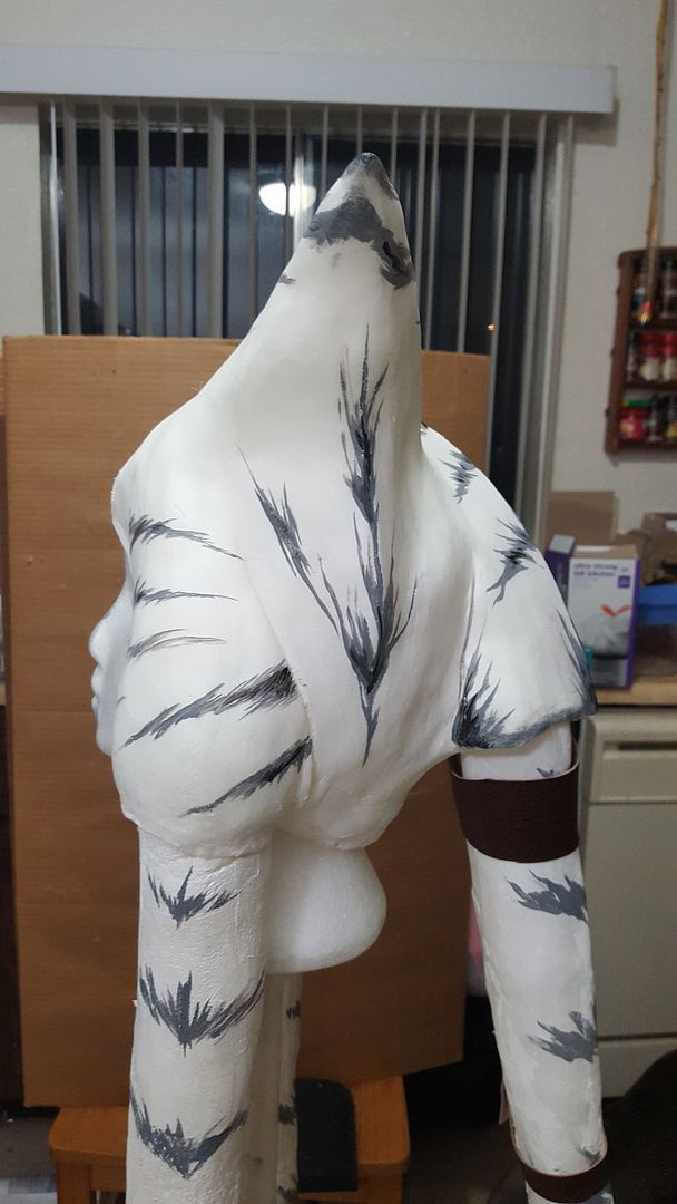

So I finally FINALLY got the headpiece I'm going to use for Ahsoka all put together... AND PAINTED. (In the right paint job!)
Lookee!!!
I'm so happy with how the colors and pattern came out, did it all freehand so it was fun. xD The colors are pretty much perfect, too. They look greyish until some full spectrum light hits them, then they show up beautifully blue but not obnoxiously blue, you know? I'm very happy with it. I used PAX paint (Pros-Aide + water + heavy body acrylics) for this paint job since it helps seal the foam as well as remains flexible enough not to crack or flake off. The seams I hid with siliconized caulk. I'm over all happy with it, though I wish I had thought to pat it with talc powder as it was drying to dull its shinyness up.
