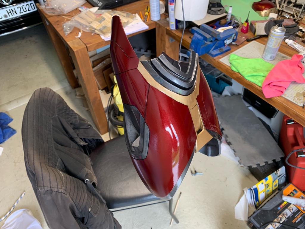

blickfangQ2- Iron Man XLV Mk 45 Build (3D Printed)

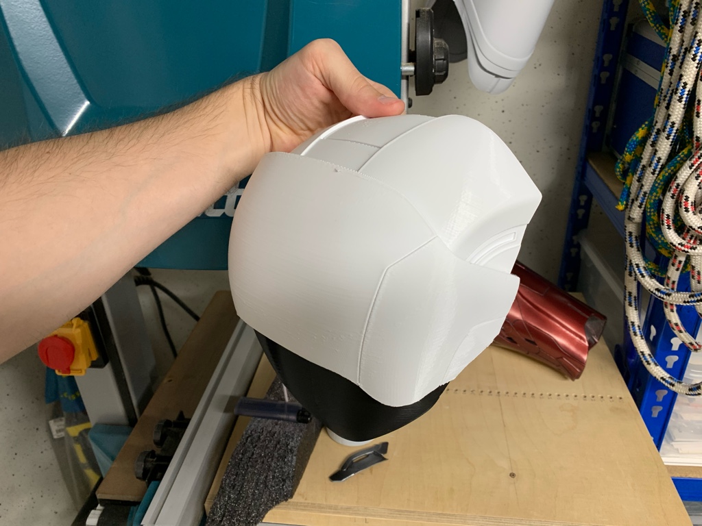

Glued in some details:
Unfortunately the superglue was too aggressive and the silver paint was damaged a bit. But nothing too bad...

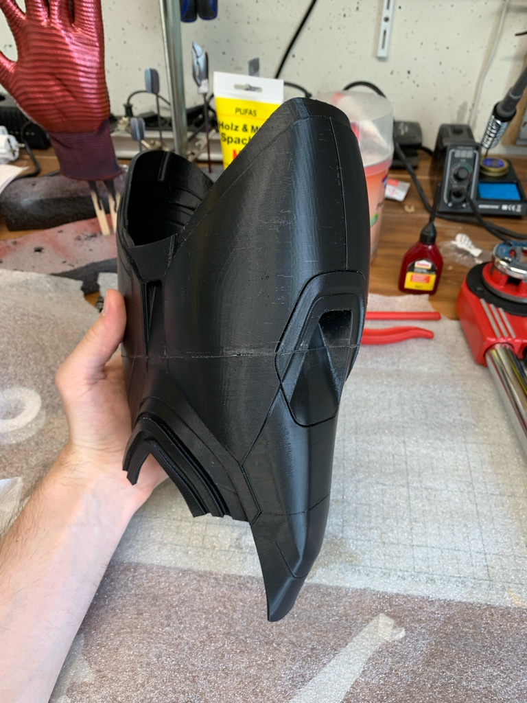

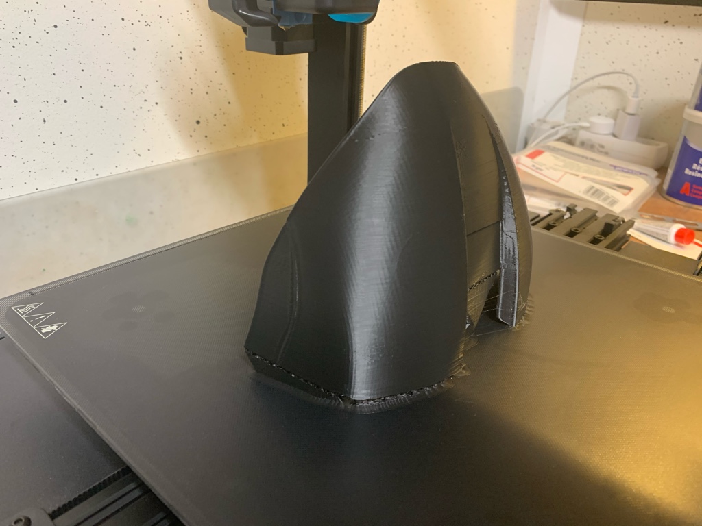

I printed the Biceps:
I cut it in half with meshmixer so I barely needed support! :)
I adjusted my print settings further.
0.20 mm Layer height ist a lot better than 0.28 and still fast enough. I love my Sidewinder X1... so fast... printed at 100mm/s (walls 50mm/s)
About 6-7 hours for each half :)

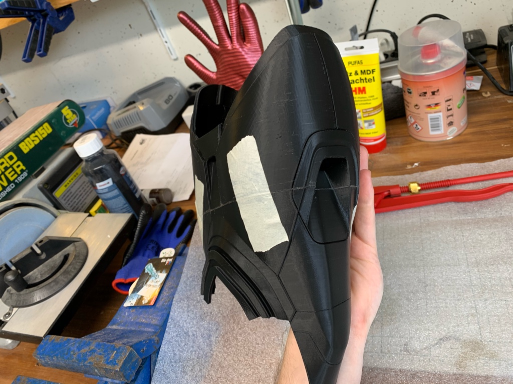

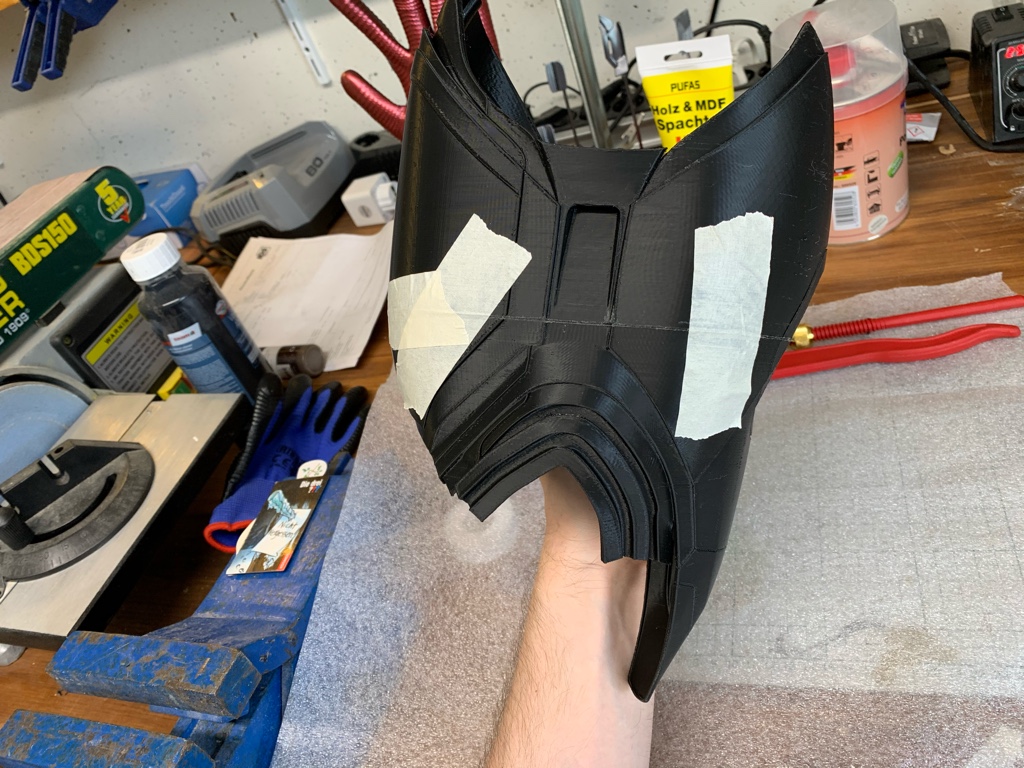

Back to topic... more progress:
Fixed the pieces together with some tape and soldered them together with the overhang Brim that was still there for buildplate adhesion :)
Will start sanding now [emoji1303]

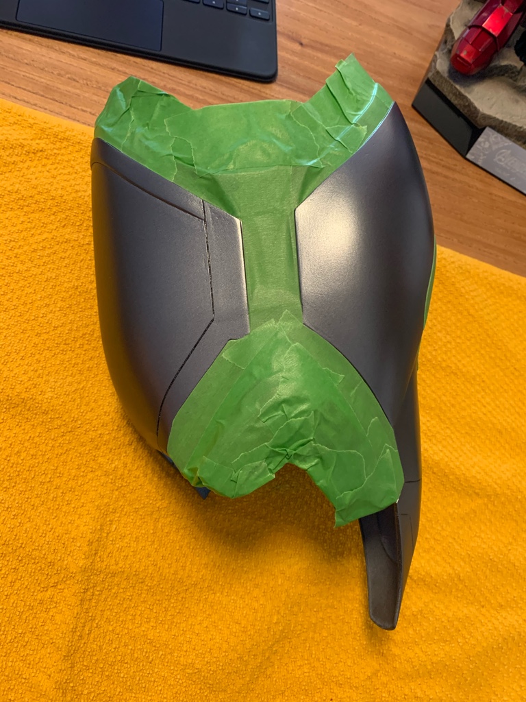

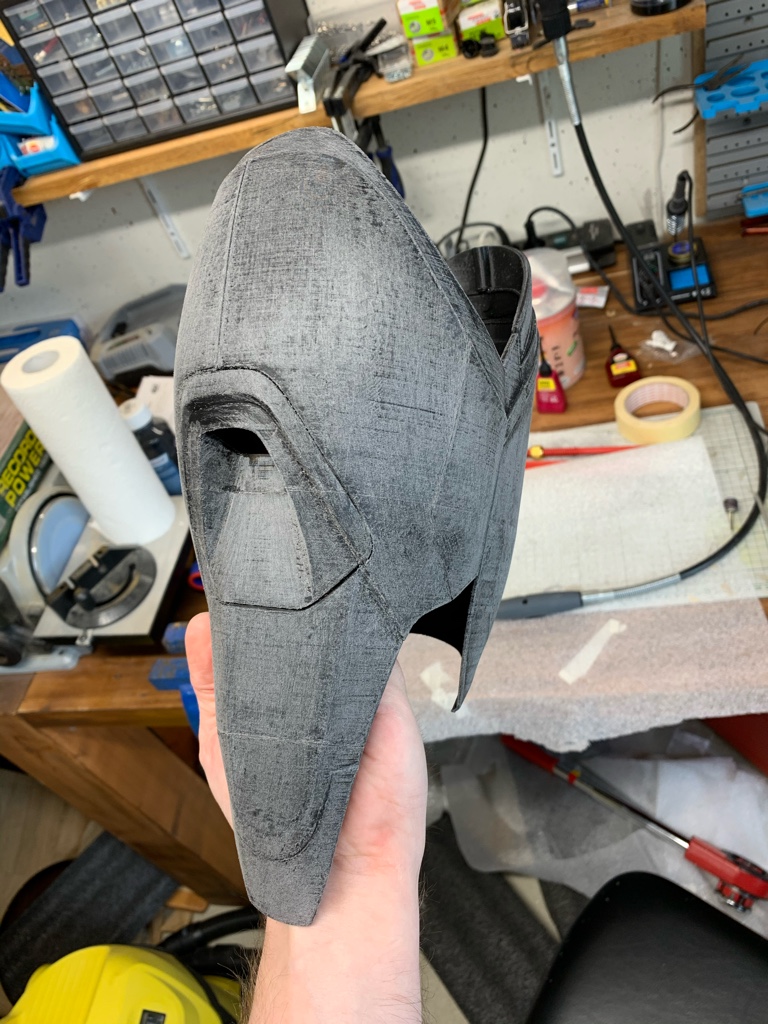

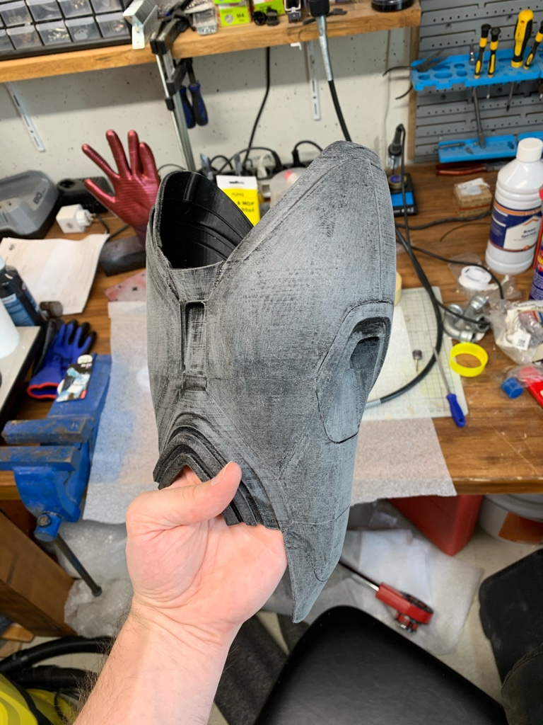

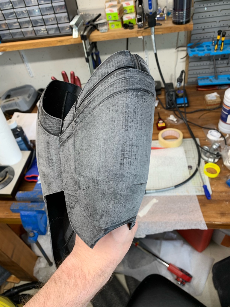

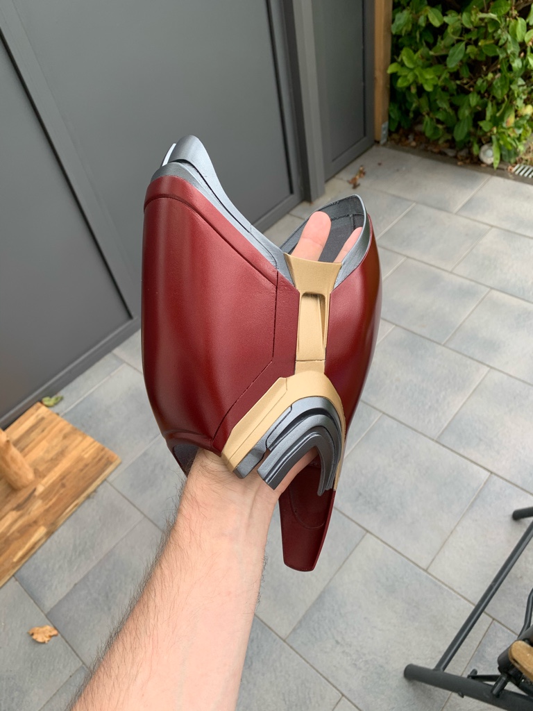

Here is more Progress:
- 100 grid paper on a Dremel drum
- 150 grid paper by Hand

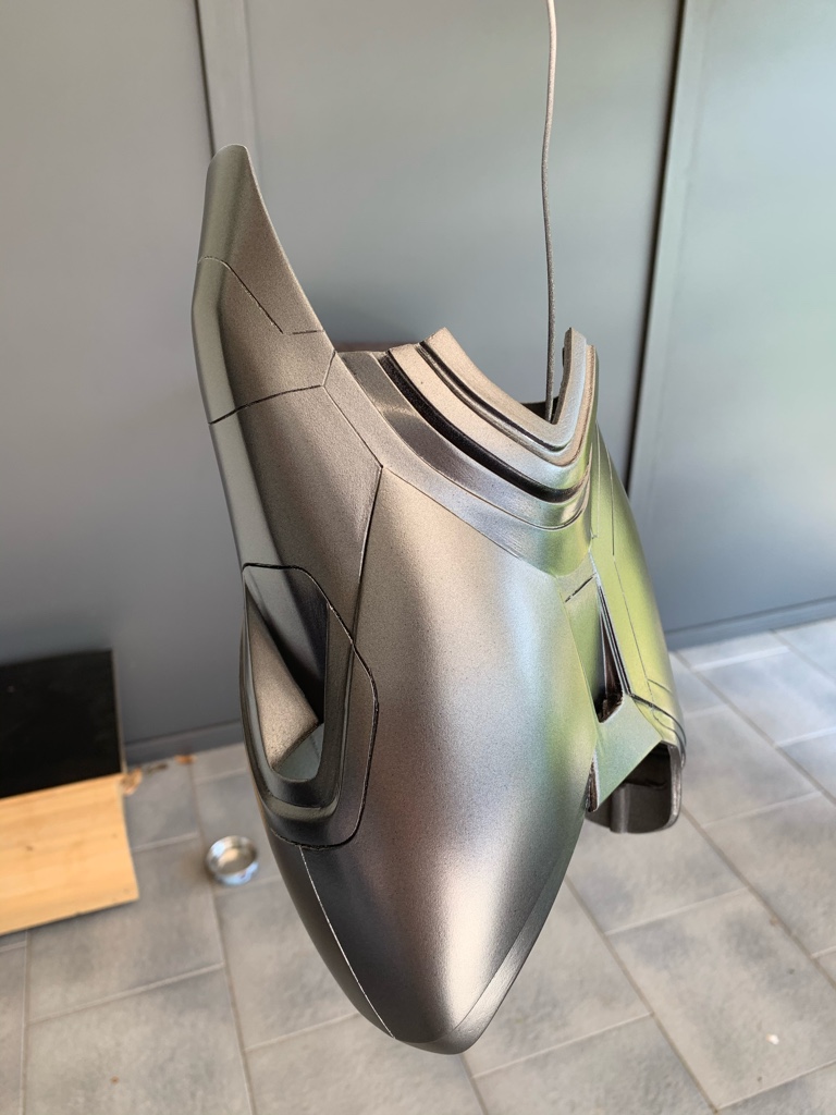

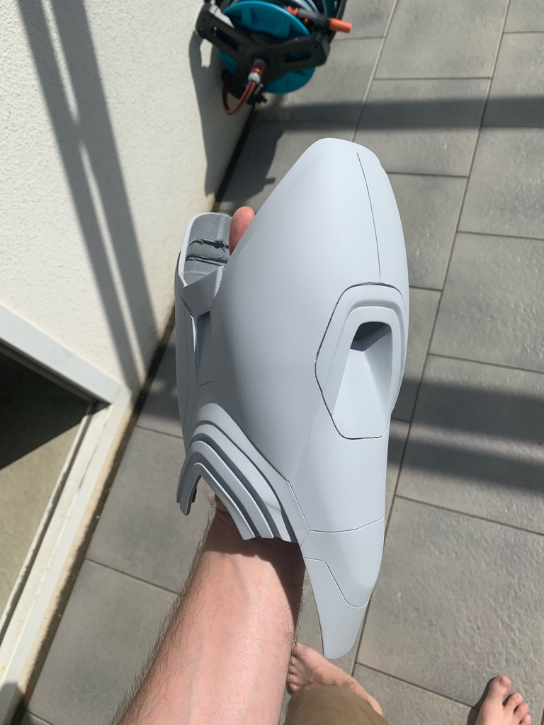

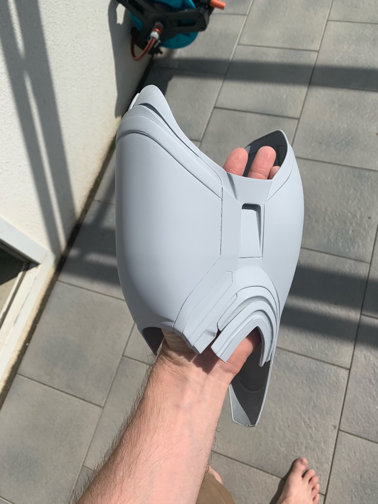

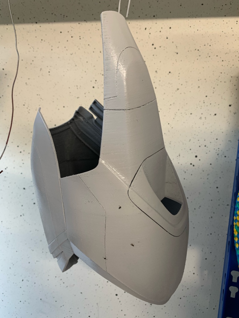

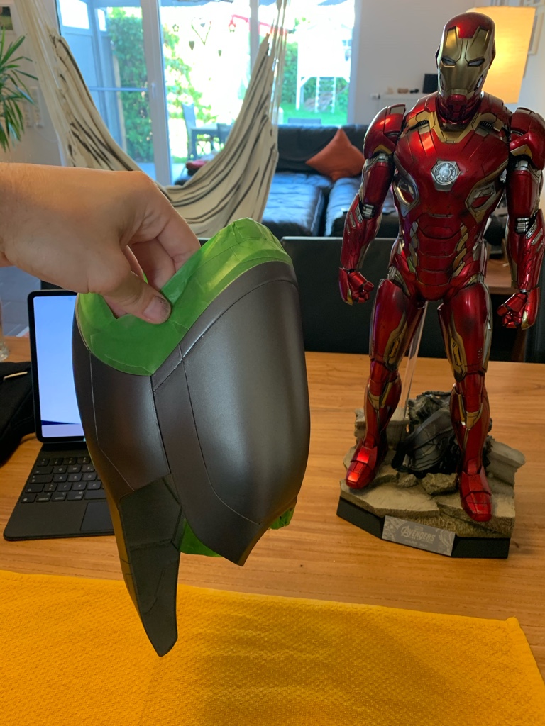

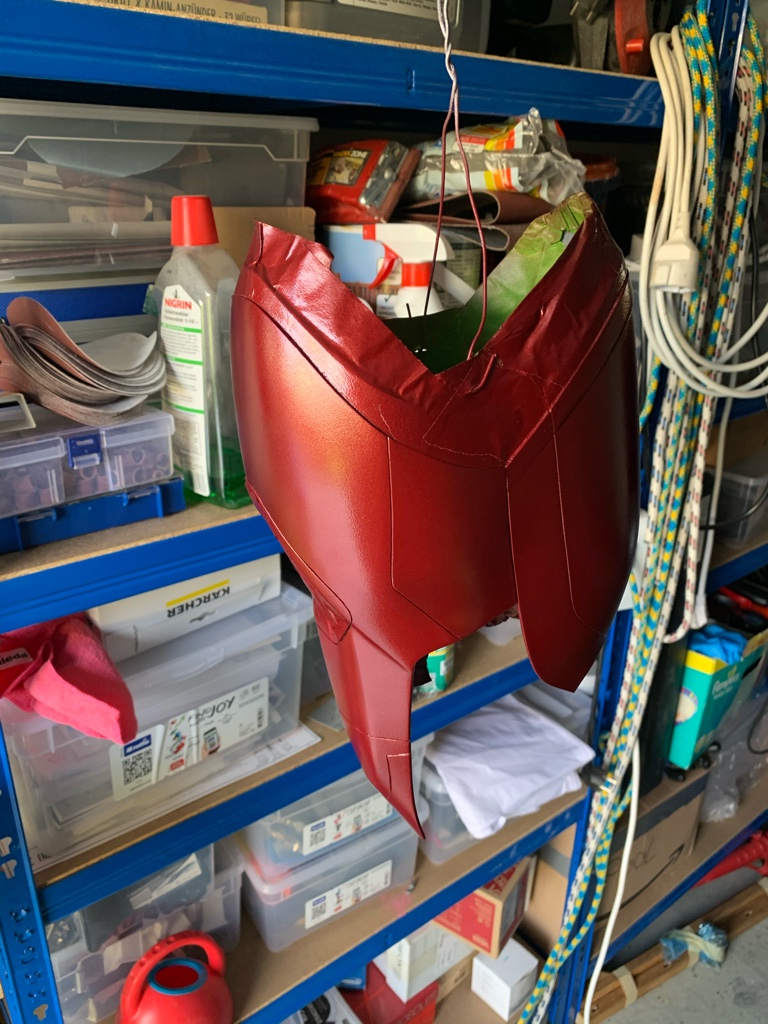

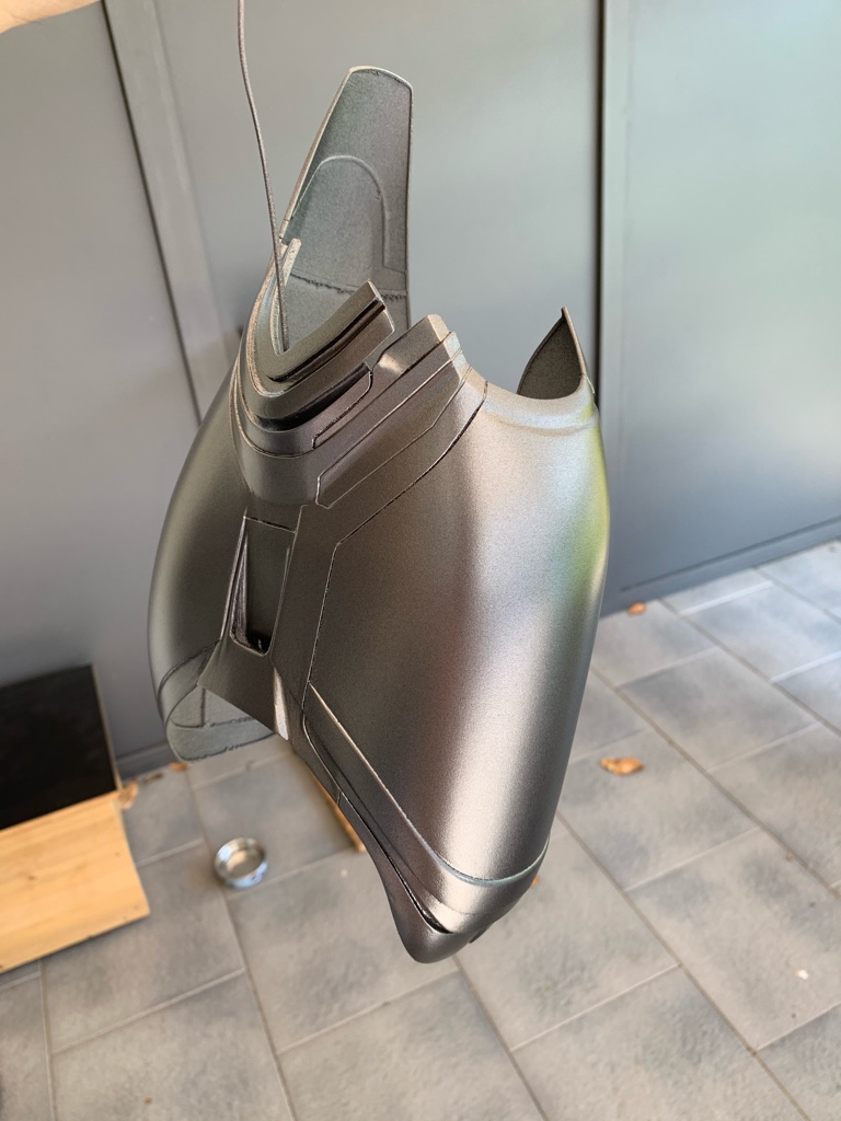

First coat of filler primer to see where I have more work to do... I managed to catch a few flys [emoji28]

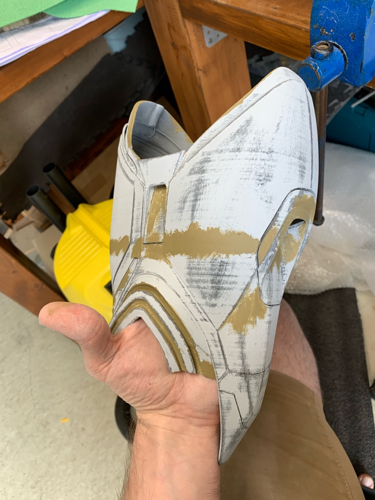

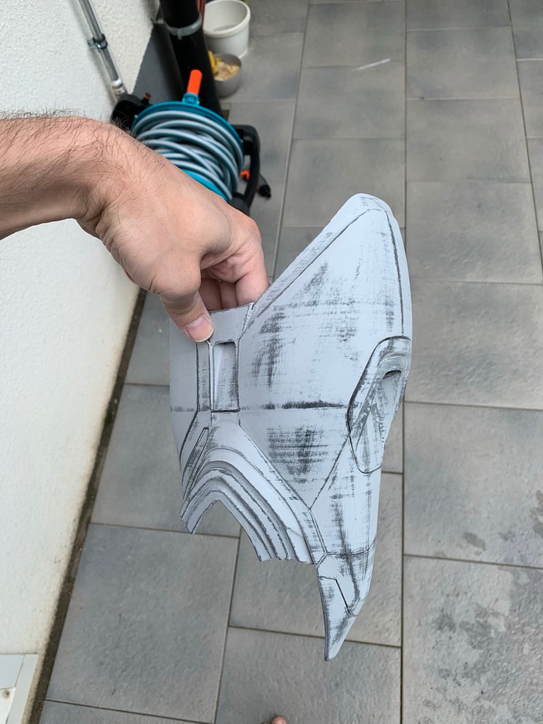

Sanded it by Hand with 150grid Paper again:
Some presto filler:
And Boom [emoji2956] not too bad! But still lots of little dents and a few layer lines...

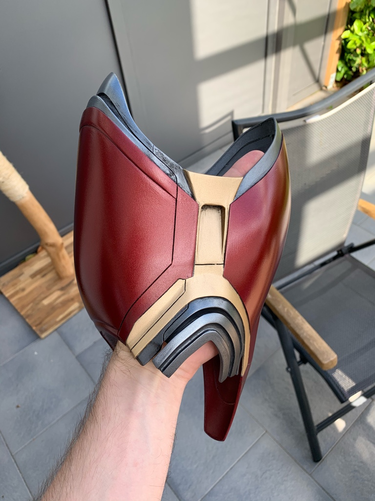

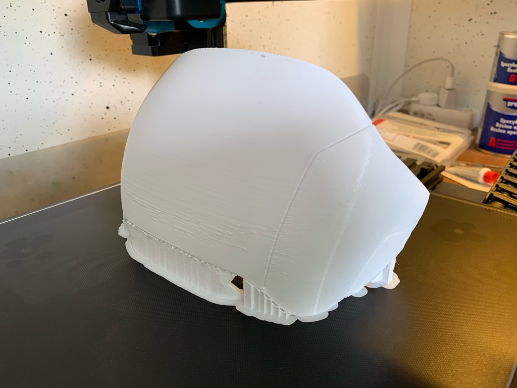

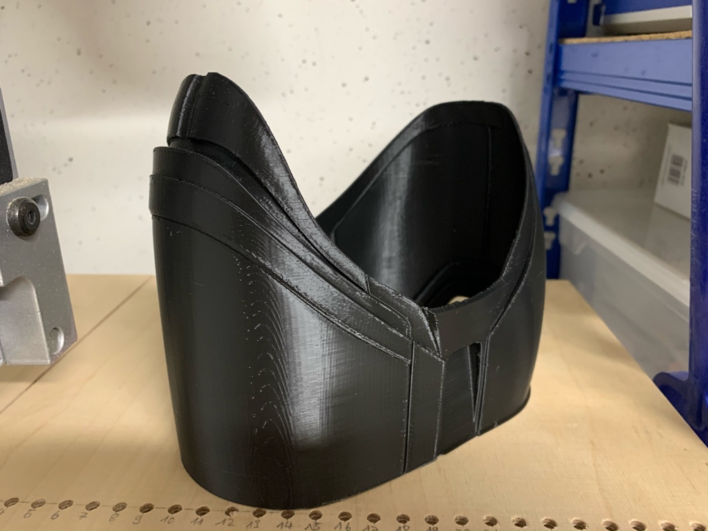

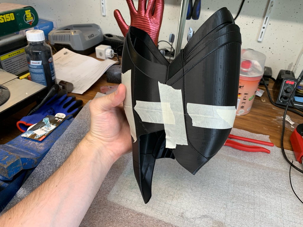

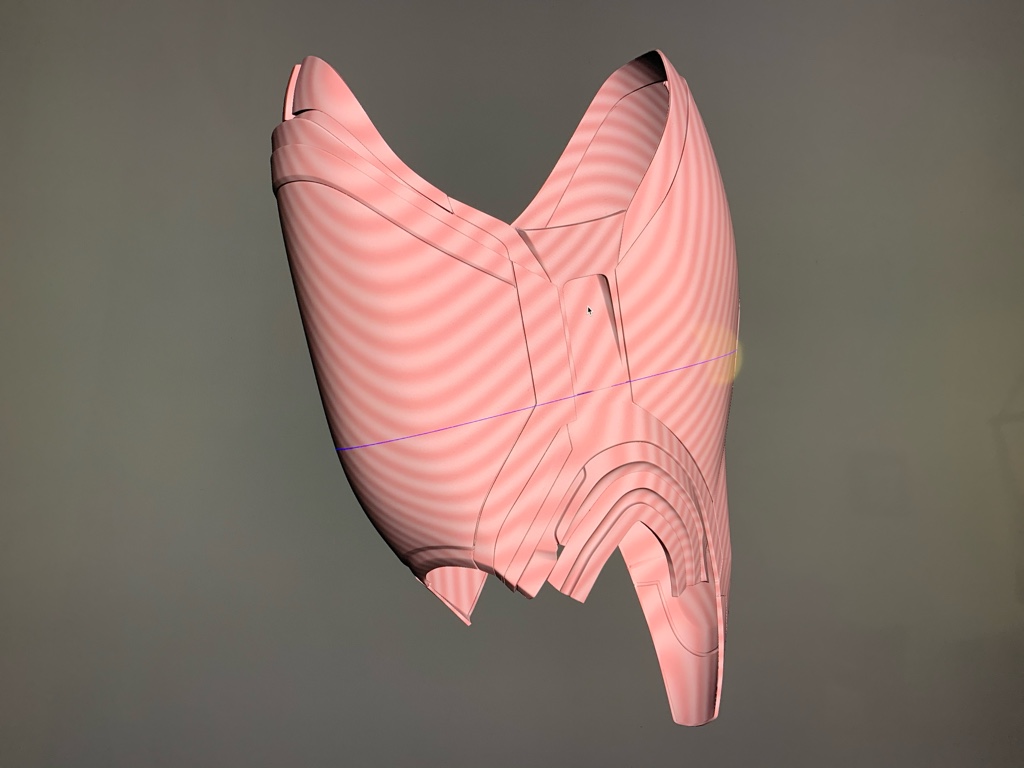

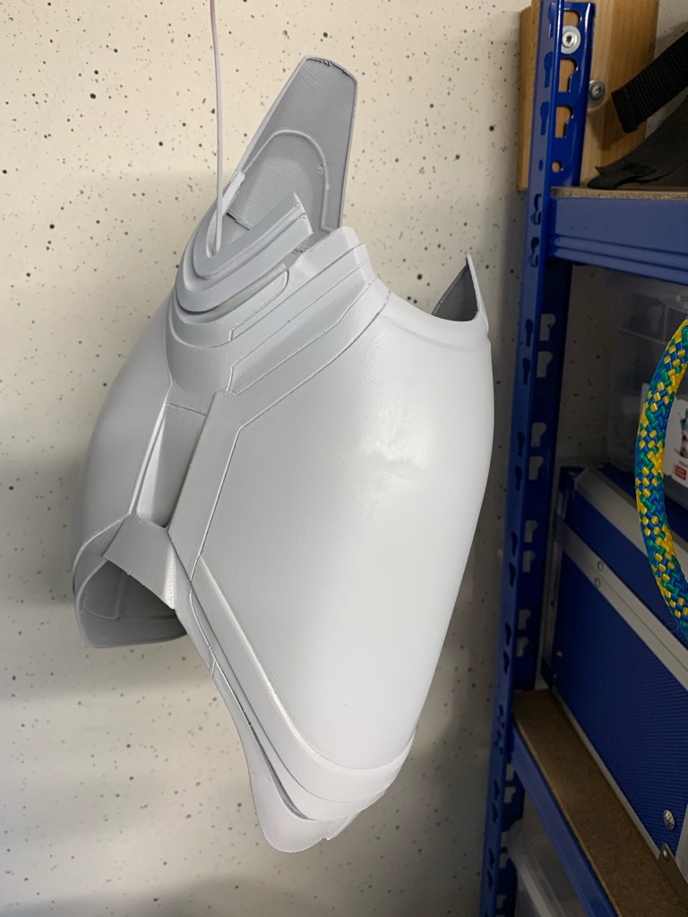

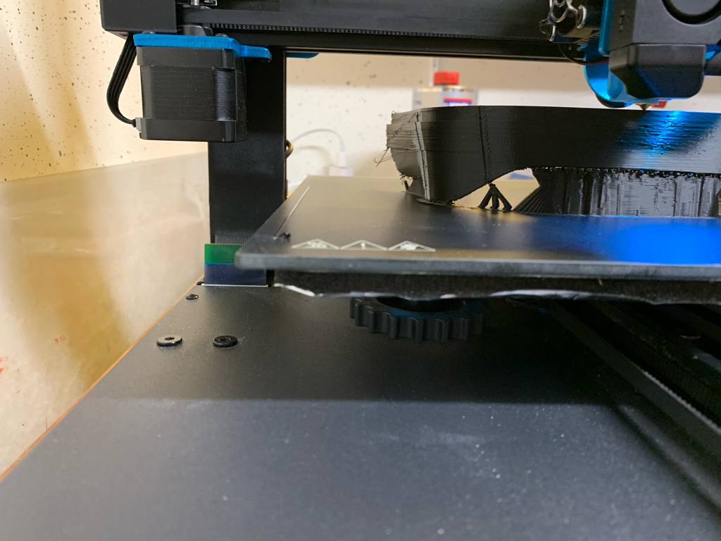

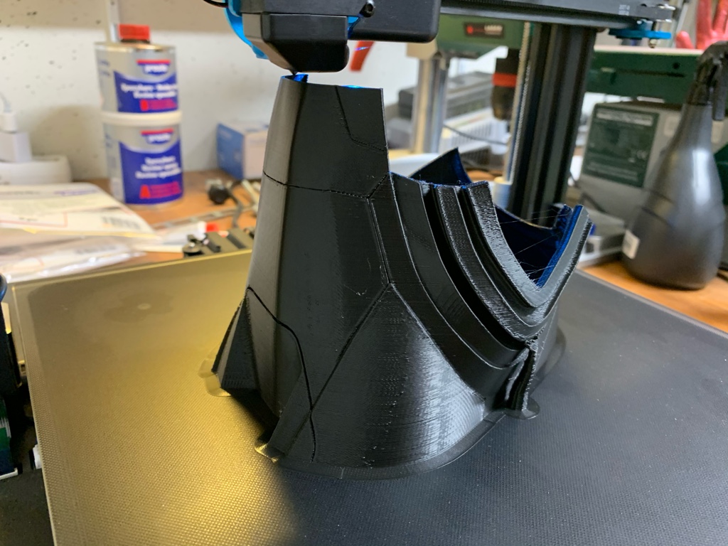

Next up: Shoulder

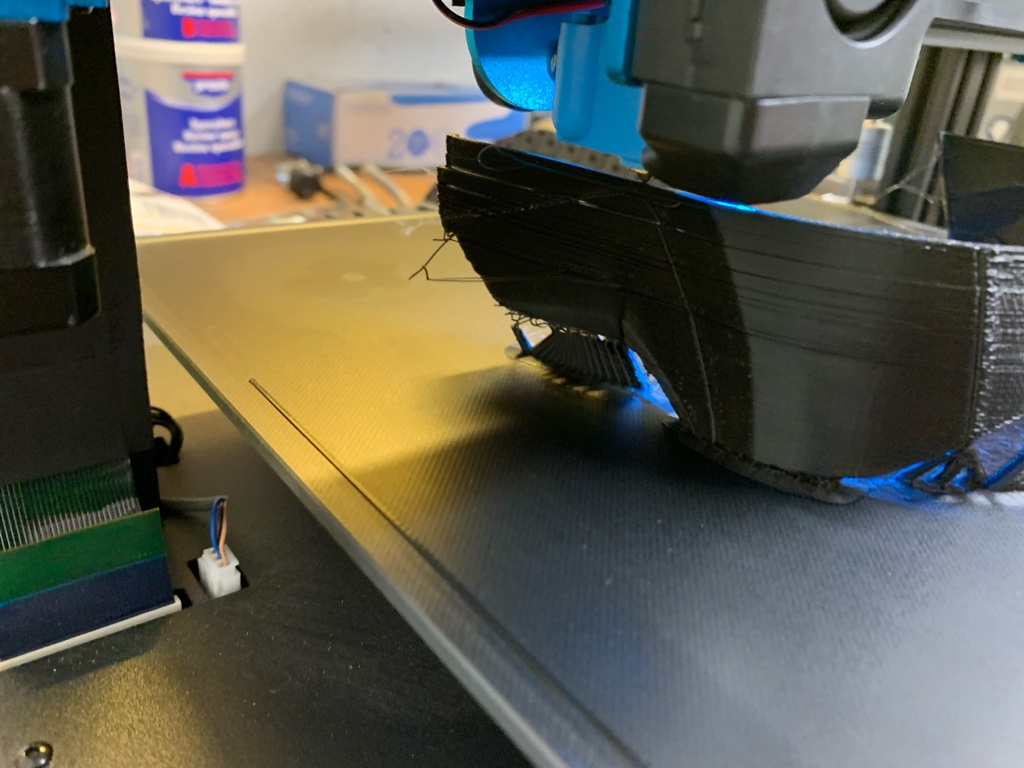

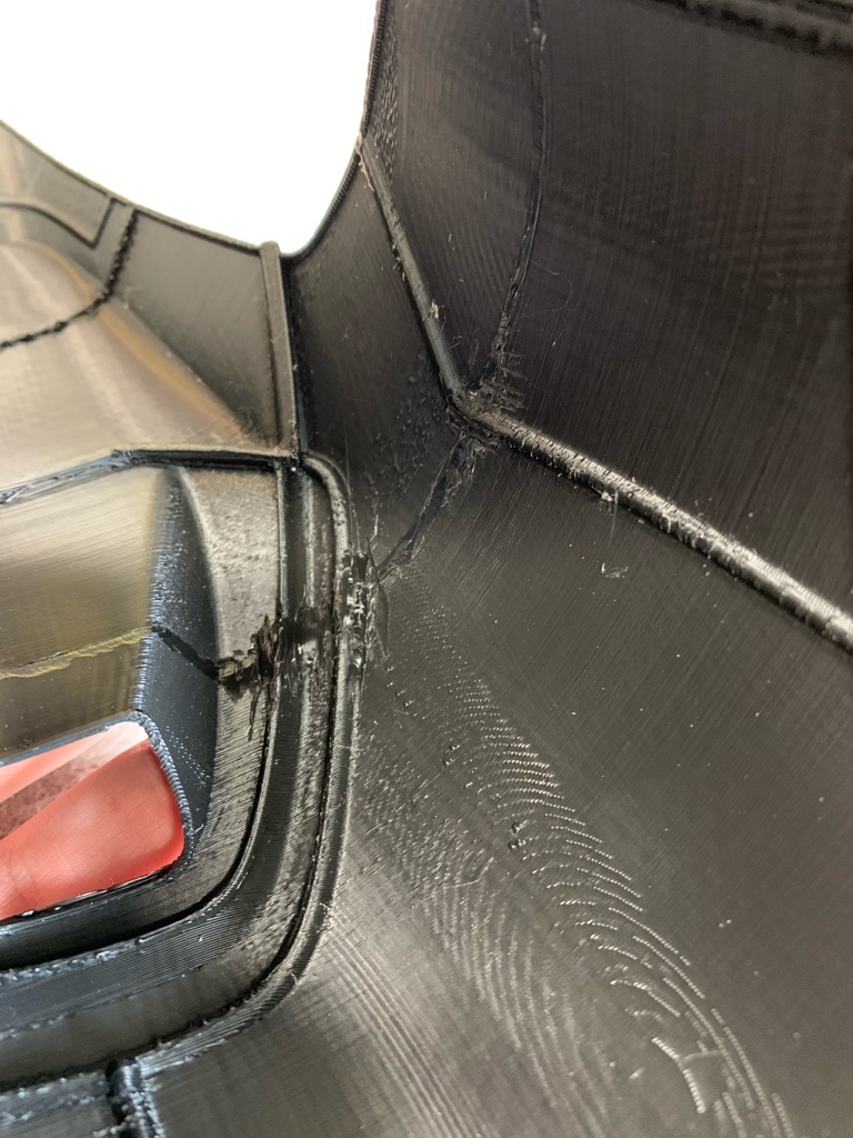

It’s a 3 part section. Bottom one printed very well
The middle one not so much. The supports didn’t stick to the print and I got layer separation [emoji52]
I’ll rework the print setting and add some more support...
