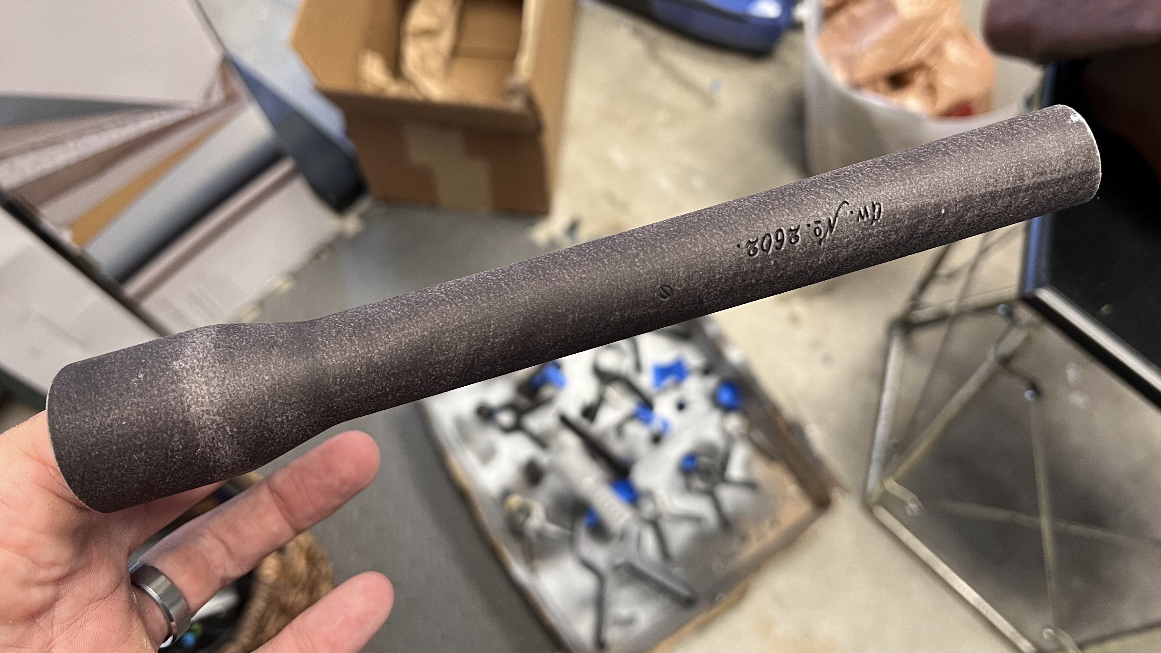

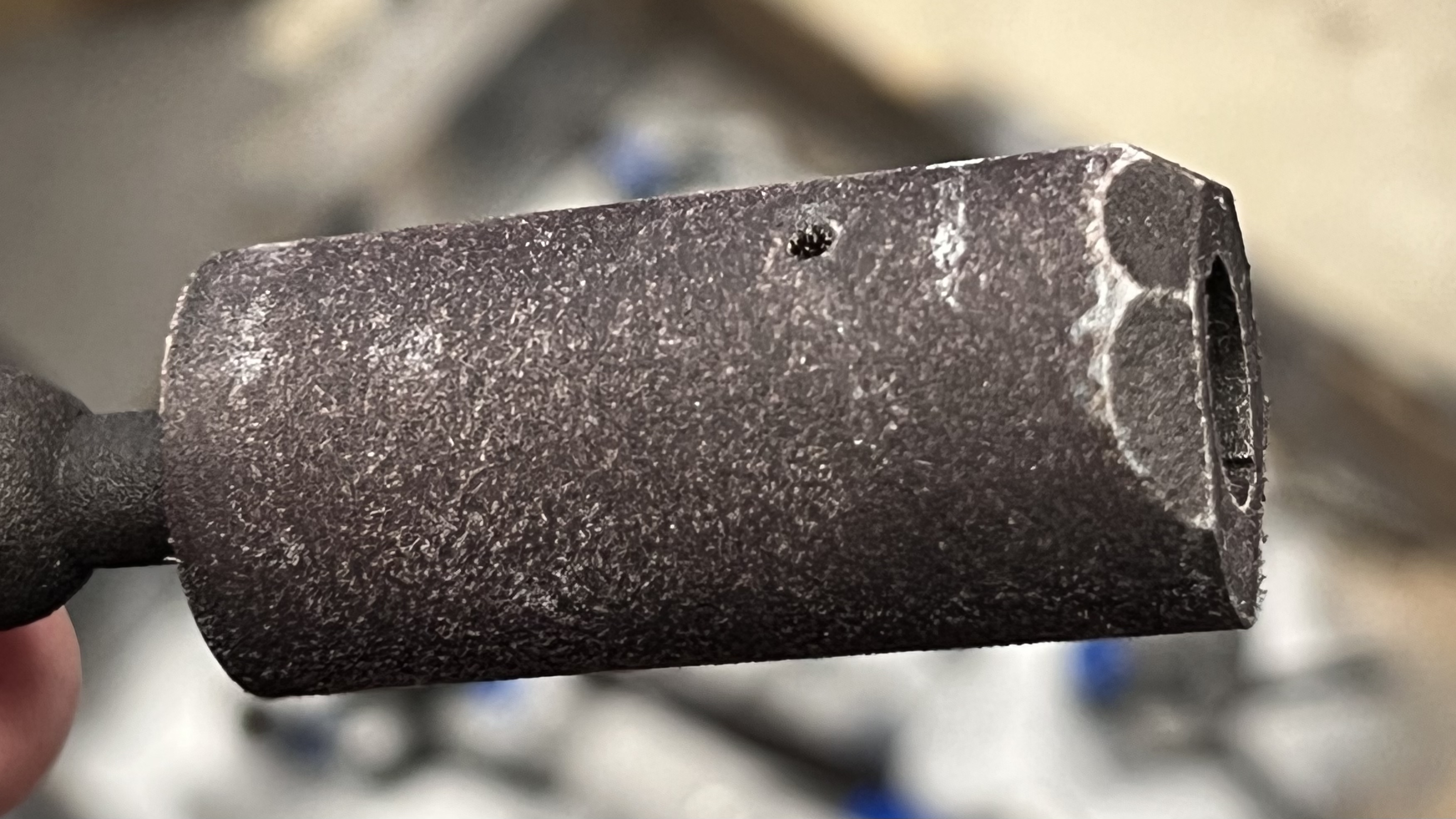

I’m curious how you smooth up the textured finish? Does it sand smooth, or do you use filler primer? I’ve noticed the same textured surface to parts you’ve printed in the past for various projects, and the final product always looks great.
Thanks bud. Honestly it truly doesn’t take much. Couple coats of primer, sand with 400/600 sandpaper… and that’s it. Rinse and repeat if needed but it definitely comes out smooth pretty quickly. It’s actually much smoother than the pictures show it off to be. My only concern with this specific model is the “lettering and numbering” that’s been added to the design itself.

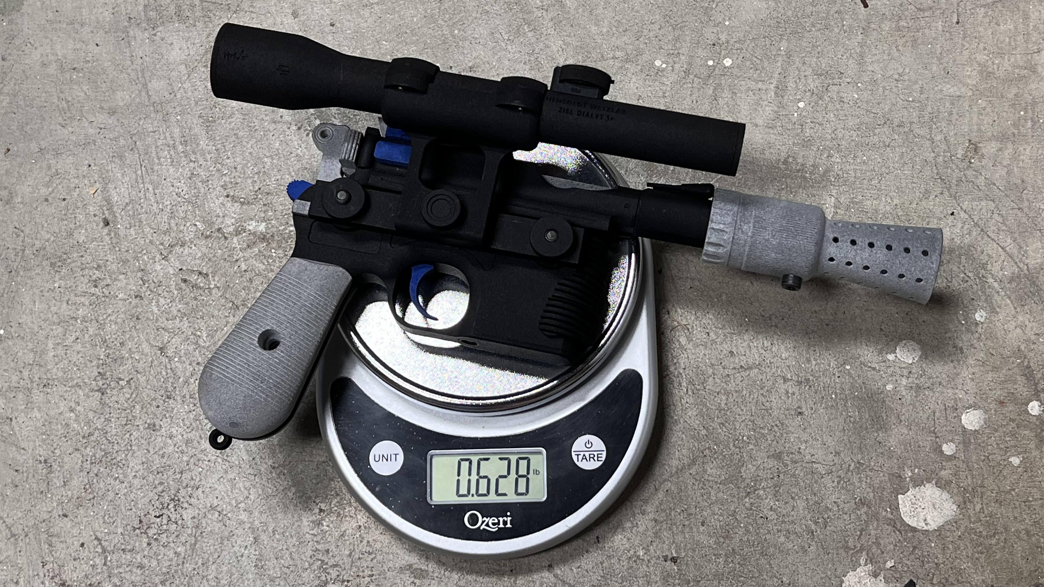

Awesome. I’ve read through some of your older posts. I actually bought an “mgc” style replacement hammer for my greedo killer from shapeways that I just realized was your design. Kudos! I’d love to get my hands on this bit of kit. How’s the weight?
How’s the weight?
Well.. not to much to it to be honest.

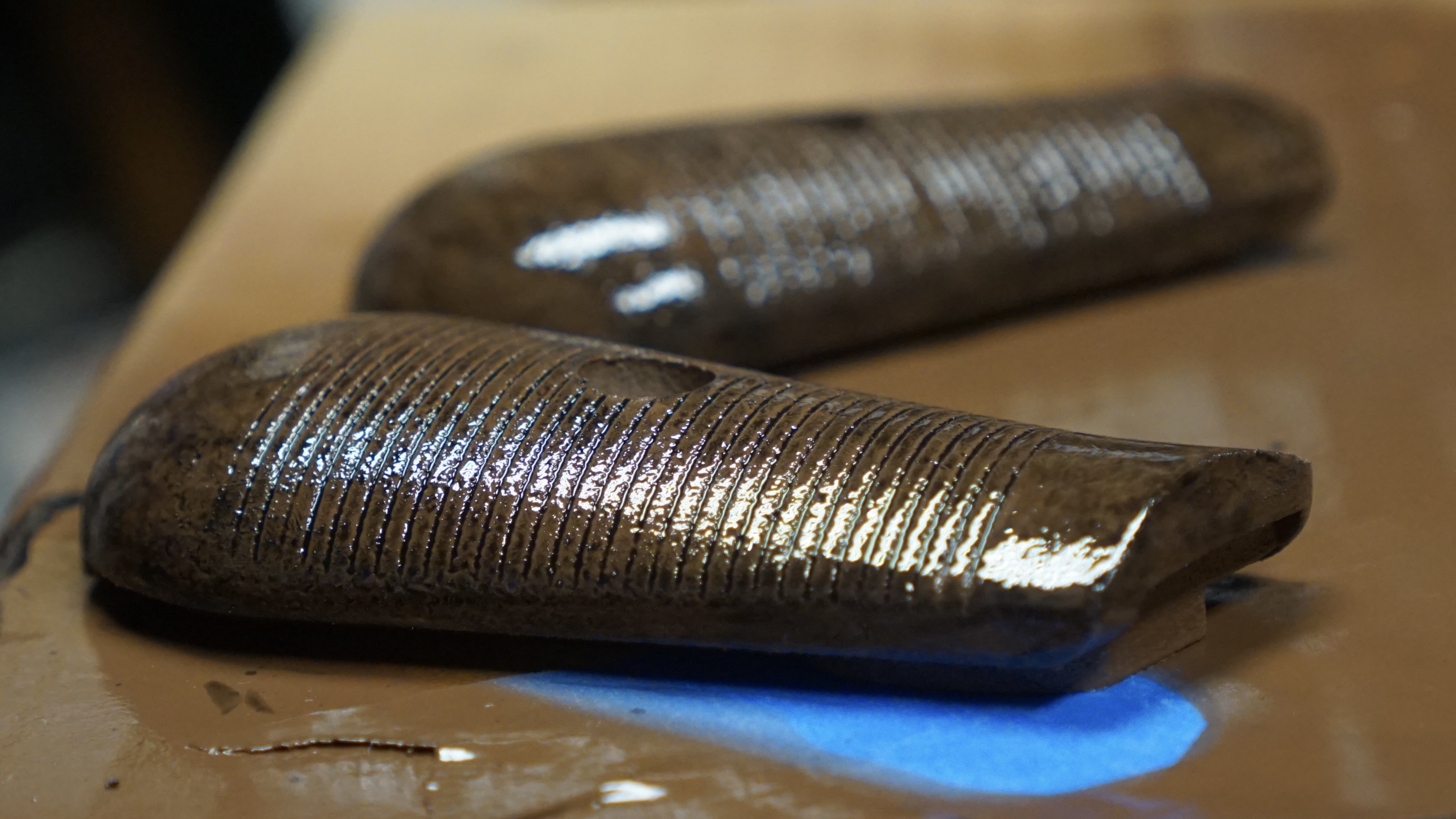

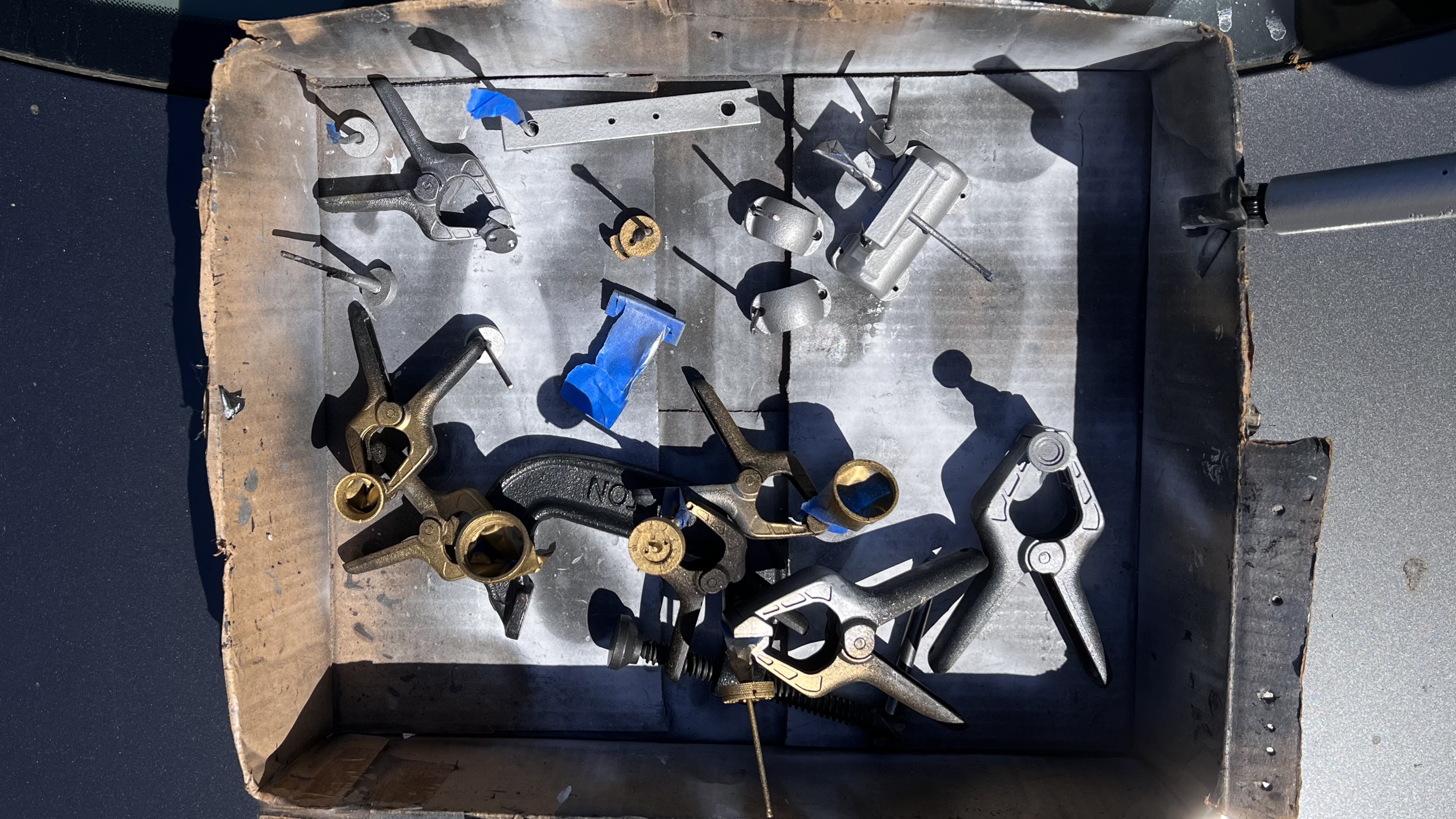

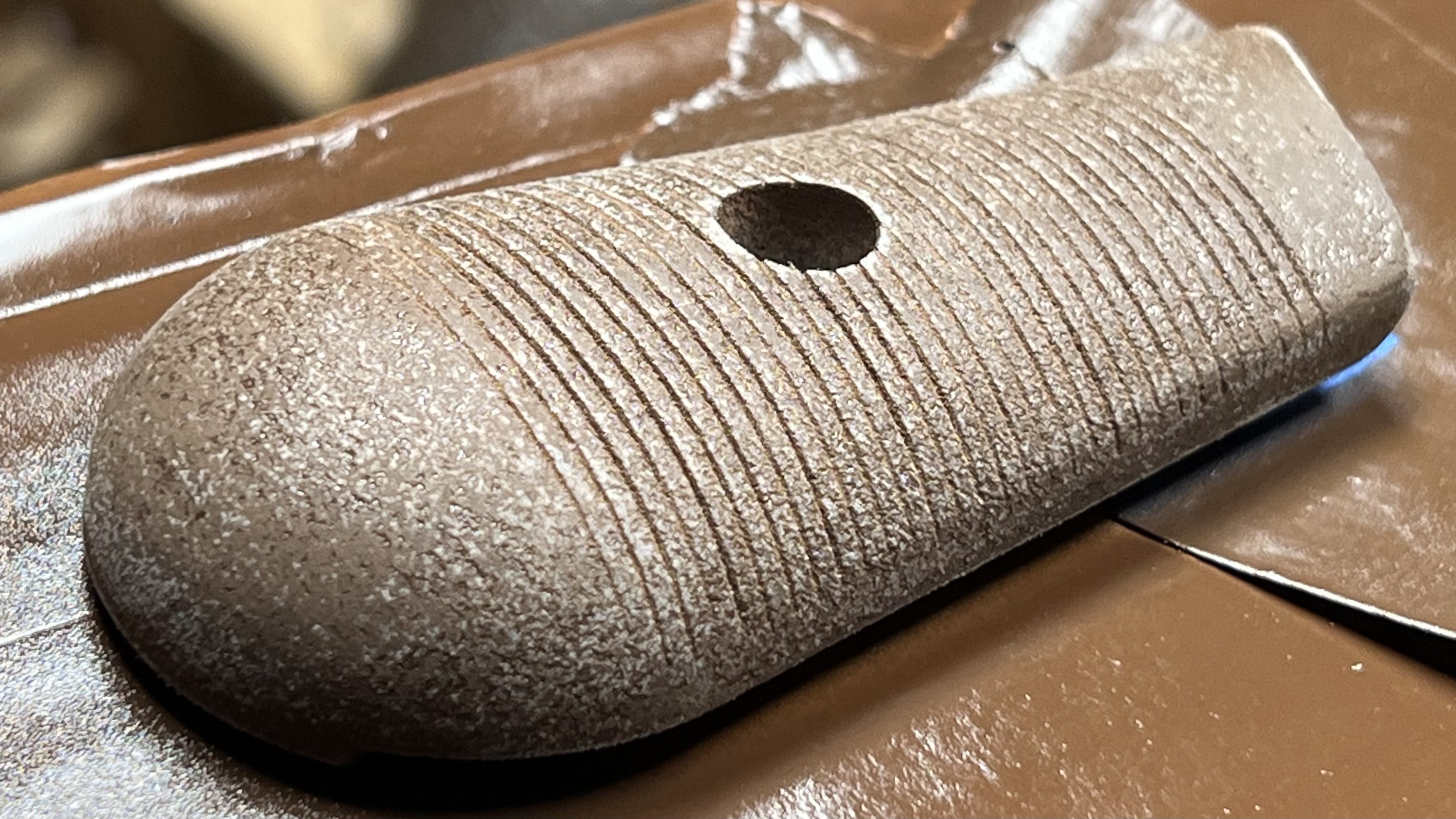

7-11 Jedi you got me curious. This is without any primer, simply starting with the paint itself. Let’s see how this plays out.
Also side note as far as not adding primer for these parts. Primer will fill the letters/numbers but with jumping straight to the paint, the details hopefully will stick around. The groves here in the grips already start to become more prominent with simply paint being added. Definitely a positive..

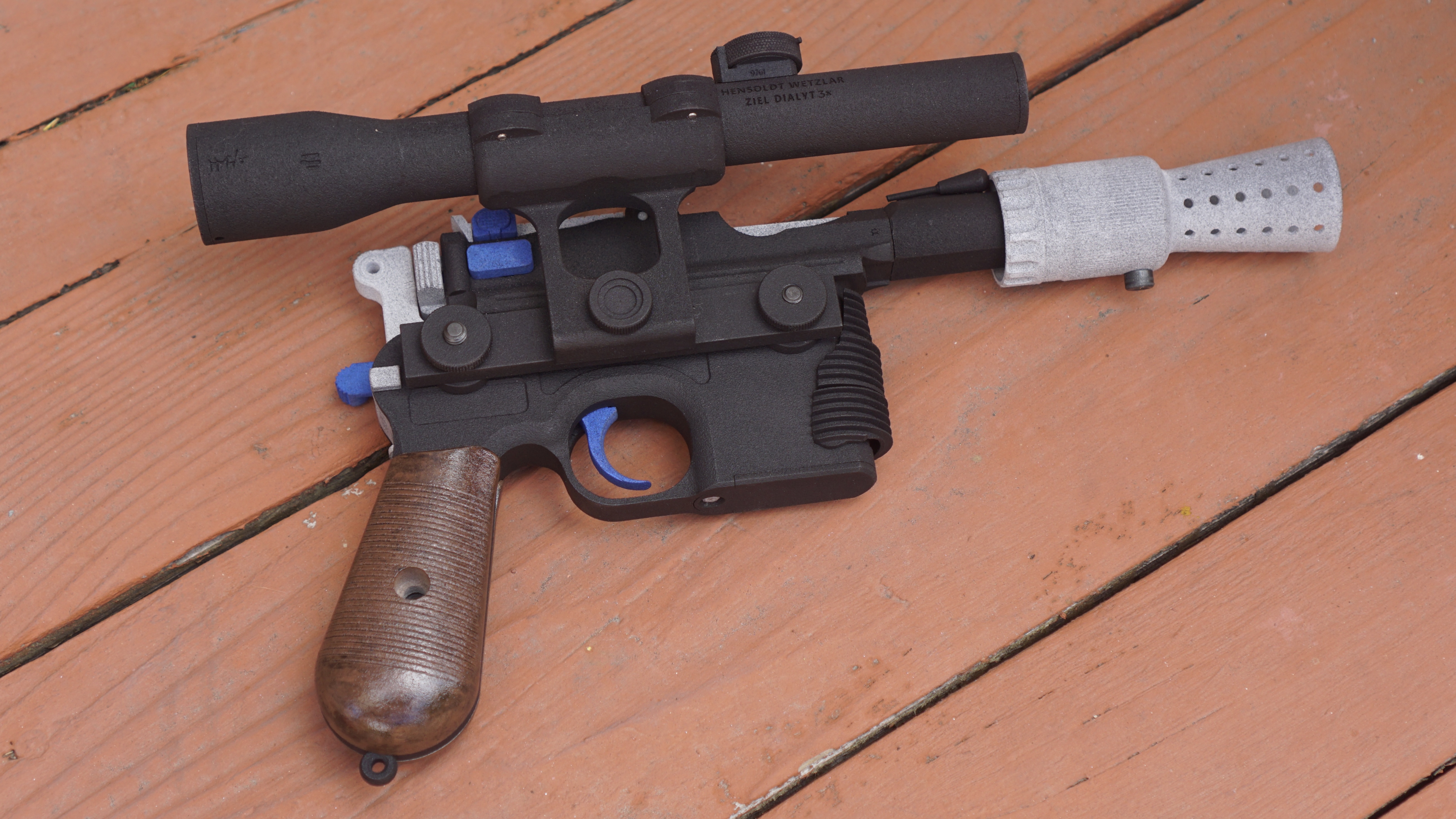

Looking good! On the grips, the texture is actually a good thing, in my worthless but frequently spouted opinion!
Is it bad I kinda like it with the blue accents? Lol. Makes it sorta otherworldly…
You mean the blue parts on the printed Mausers itself? Truth is on real c96 all those parts have a tint of blue actually to them. It’s not as predominant as when printing but I did choose blue for a reason :)

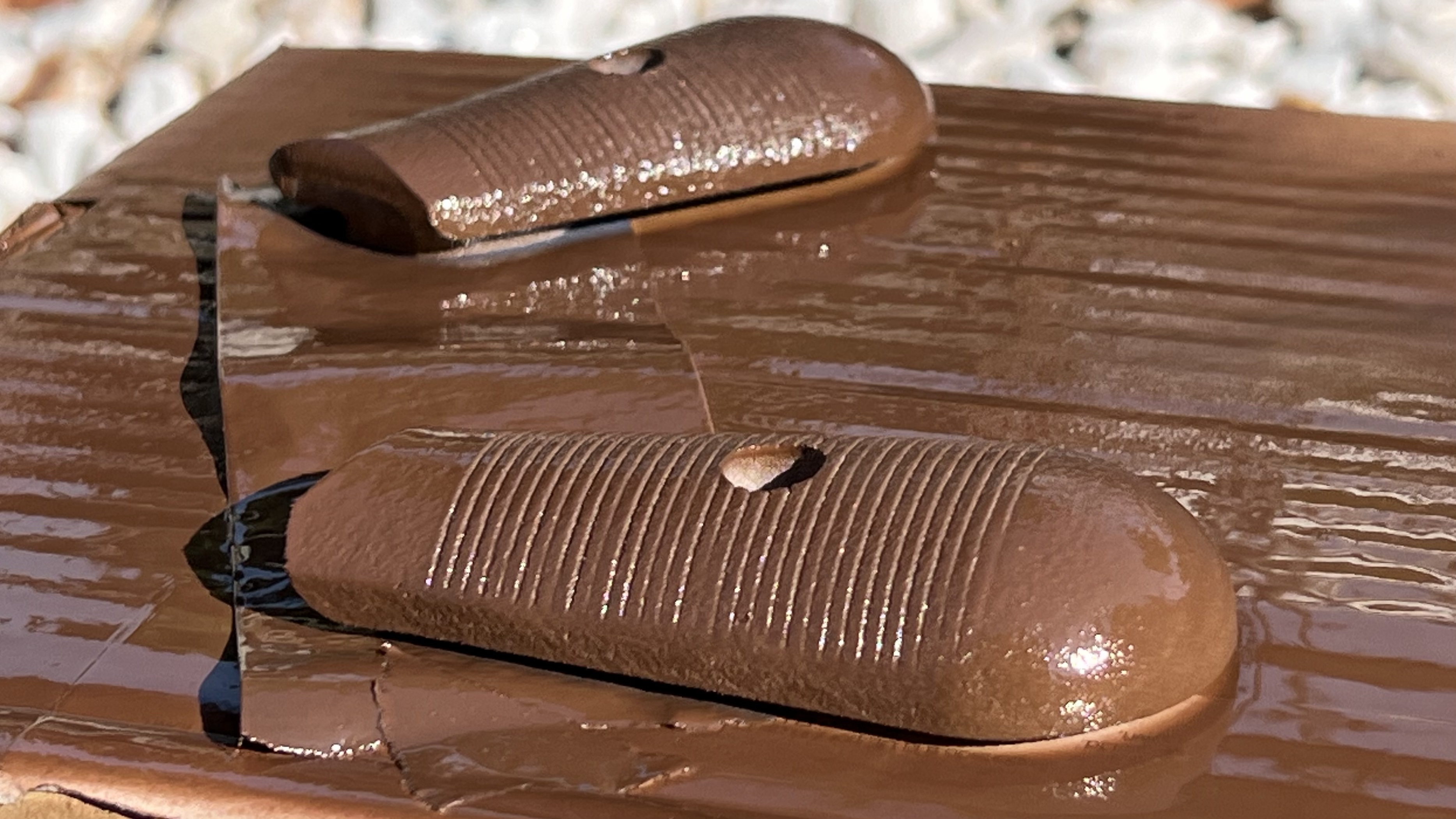

Update on the grips.
First, here’s one grip fully dried..

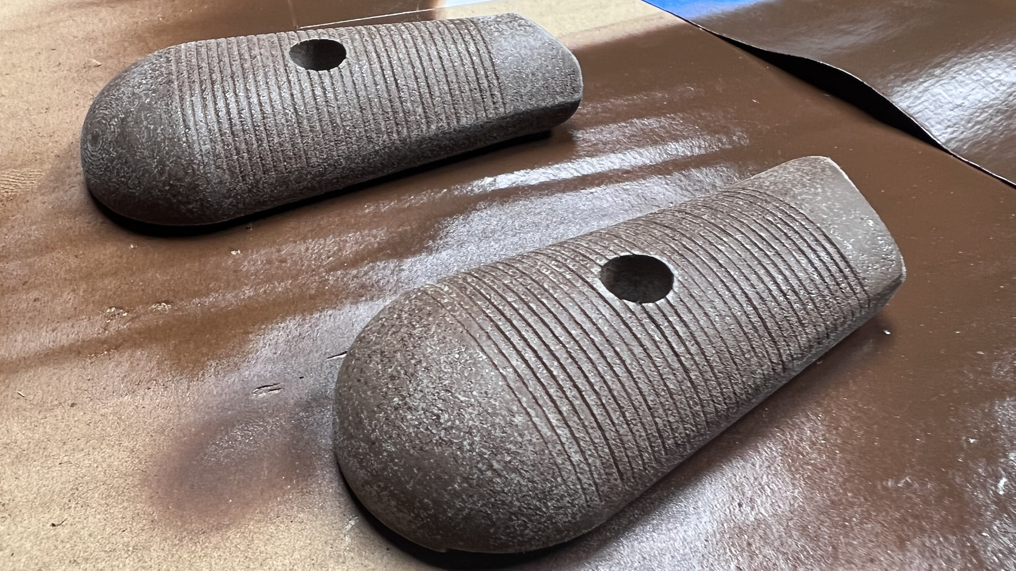

Next after sanding each with 400 gran sandpaper..

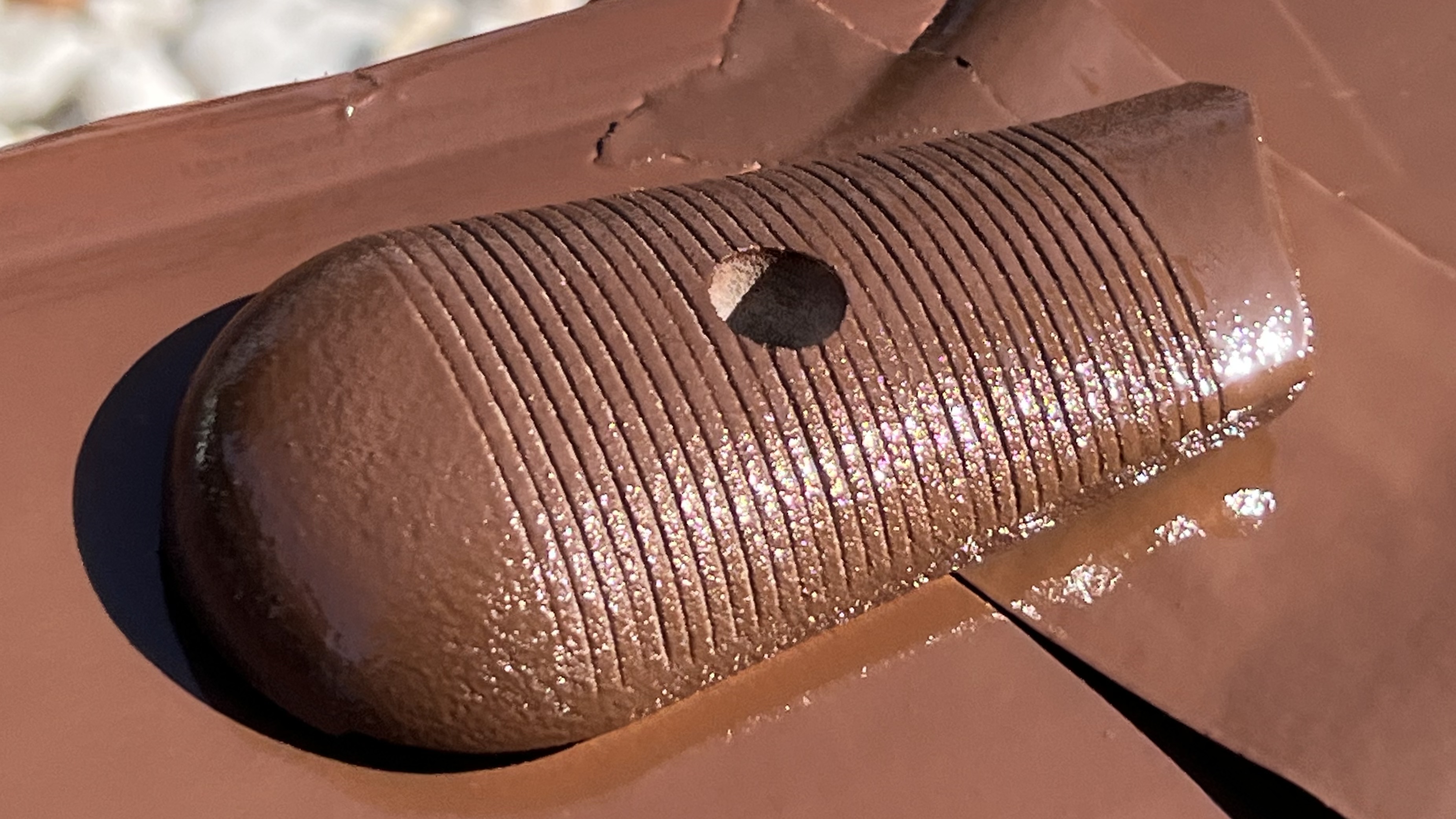

And now something I probably should have put off until the sun is back up tomorrow. I re-added another layer of brown spray paint. You can see even without primer and only one sanding they are already coming out much smoother..

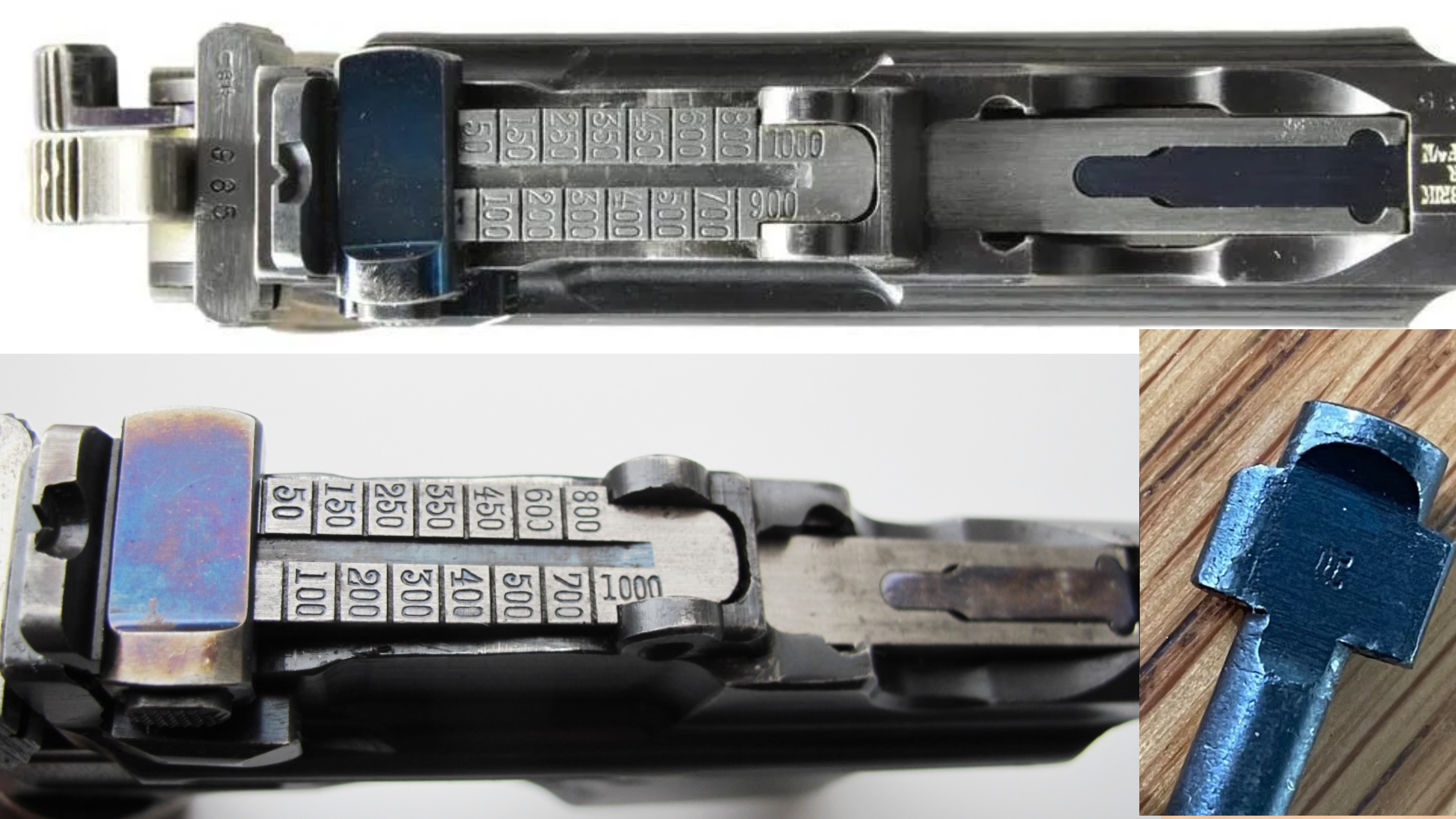

The blue color is case hardening, it hardens the surface of the parts but keeps 'some' flexibility due to not hardening the part throughout. And the bolt (except the knurled grip portion) was left in-the-white, for some reason. I guess wear, but hard to say. I've always been surprised how well parts in-the-white keep over many years, like the polished, raw steel on bolt action rifles for example..never figured that out. Bluing is supposed to protect the steel, yet being left raw seems to do well on it's own?
But, great work on all of this man, these turned out great! I'm glad the trigger issue wasn't too faulty, I tried to make sure it was functional.. =b

You mean the blue parts on the printed Mausers itself? Truth is on real c96 all those parts have a tint of blue actually to them. It’s not as predominant as when printing but I did choose blue for a reason :)View attachment 1616599
I would think that's just an effect of the - wait for it - bluing? That is, the process used to protect the steel from rust and corrosion. My understanding is that, depending on how heavily it was applied and how it's decayed since, blued steel can look more or less blue.
Meaning that all the parts you printed in black should also be blue, if that's the reason you chose blue.
I'm perfectly ready be told I'm wrong, though!
Anyway, this is pretty amazing. I'm quite certain this 3d model is now functional enough to be of questionable legality in Canada or Australia. :p
Thanks Vagabond Elf and I don’t think your wrong at all. Some parts appear more blue than others and those are the ones I simply printed in blue to stand out. But ya the whole mauser would have a tint of blue to it, except for the parts deadbolt just mentioned above.
Carson your model is perfect bud! The part I created to hold the trigger in place is what I thought I screwed up on. But it’s actually working and holding pretty well.. once I got it figured out that is ;) It’s was these exact parts I was nervous about working properly and was looking to get a run down on but so far so good! In fact one other very small part wasn’t shipped other than the grip screws. Its a part I designed to hold the spring in place on the lock frame. Right now I’m using cardboard to do the job so it’s a little lose right now.

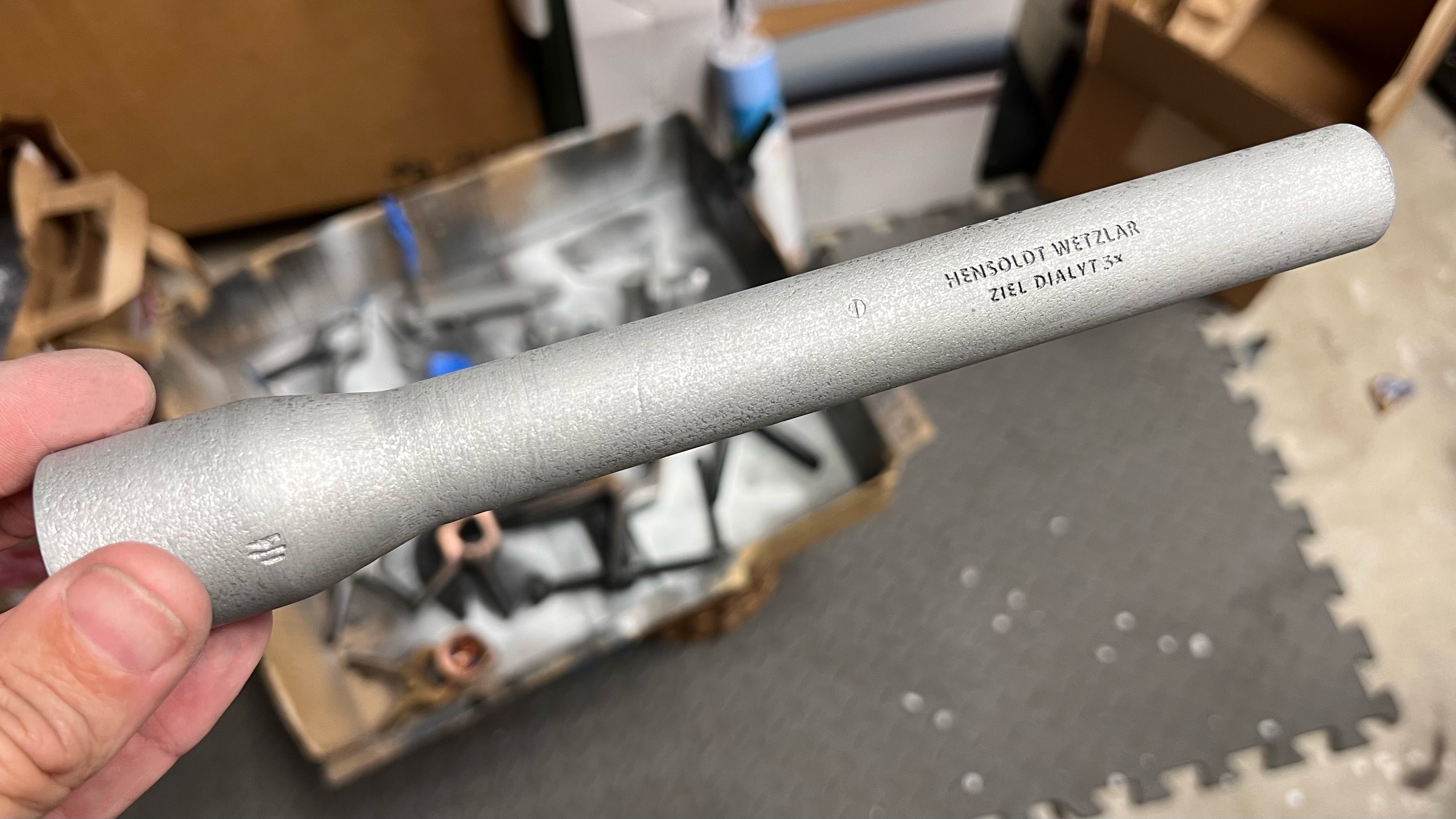

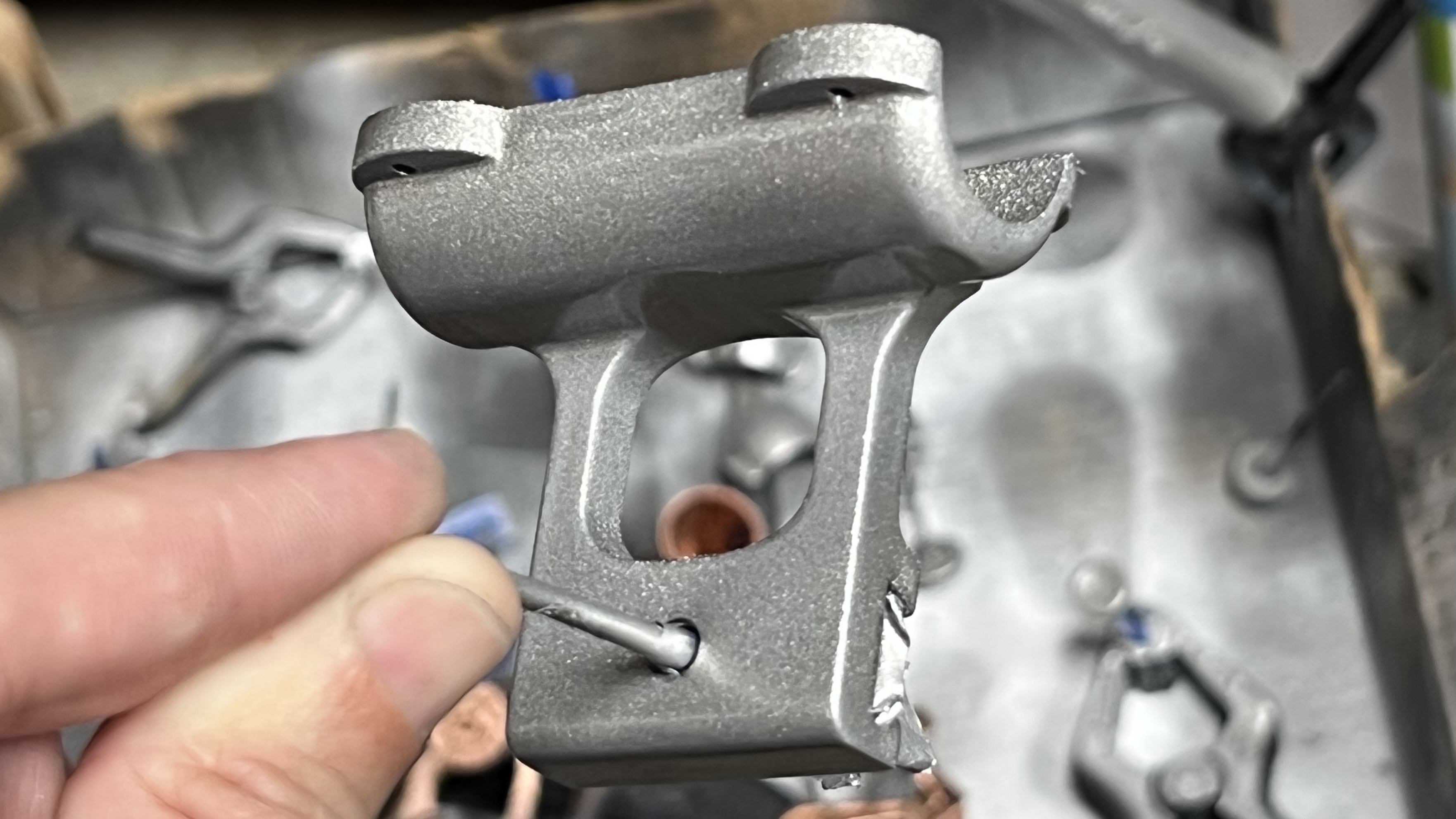

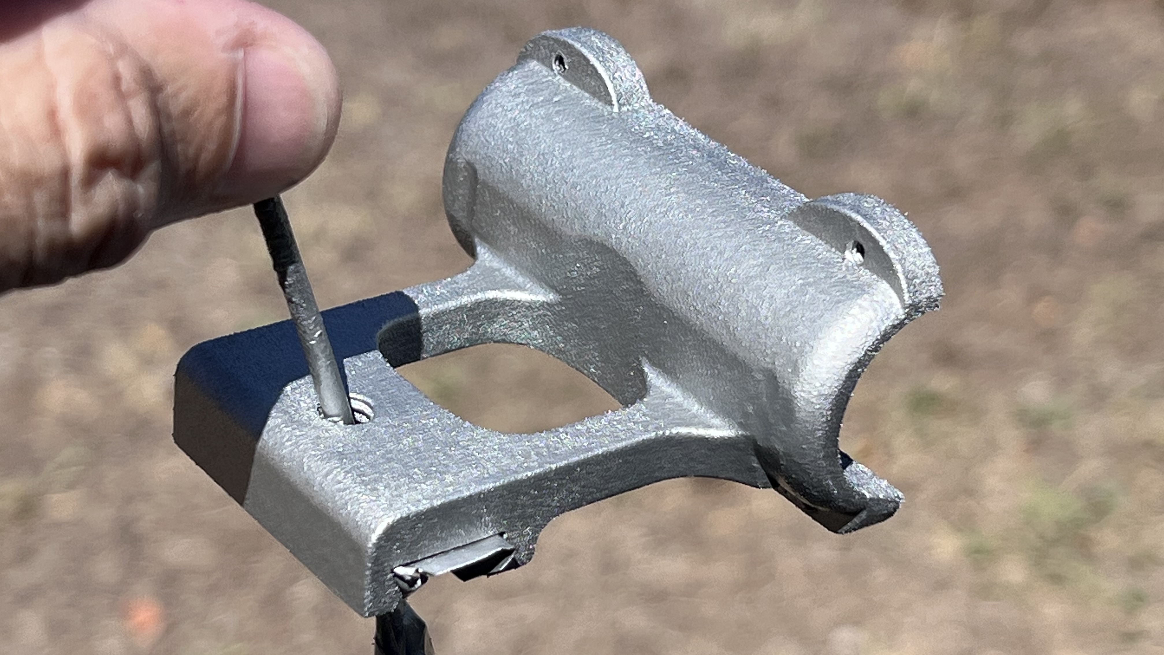

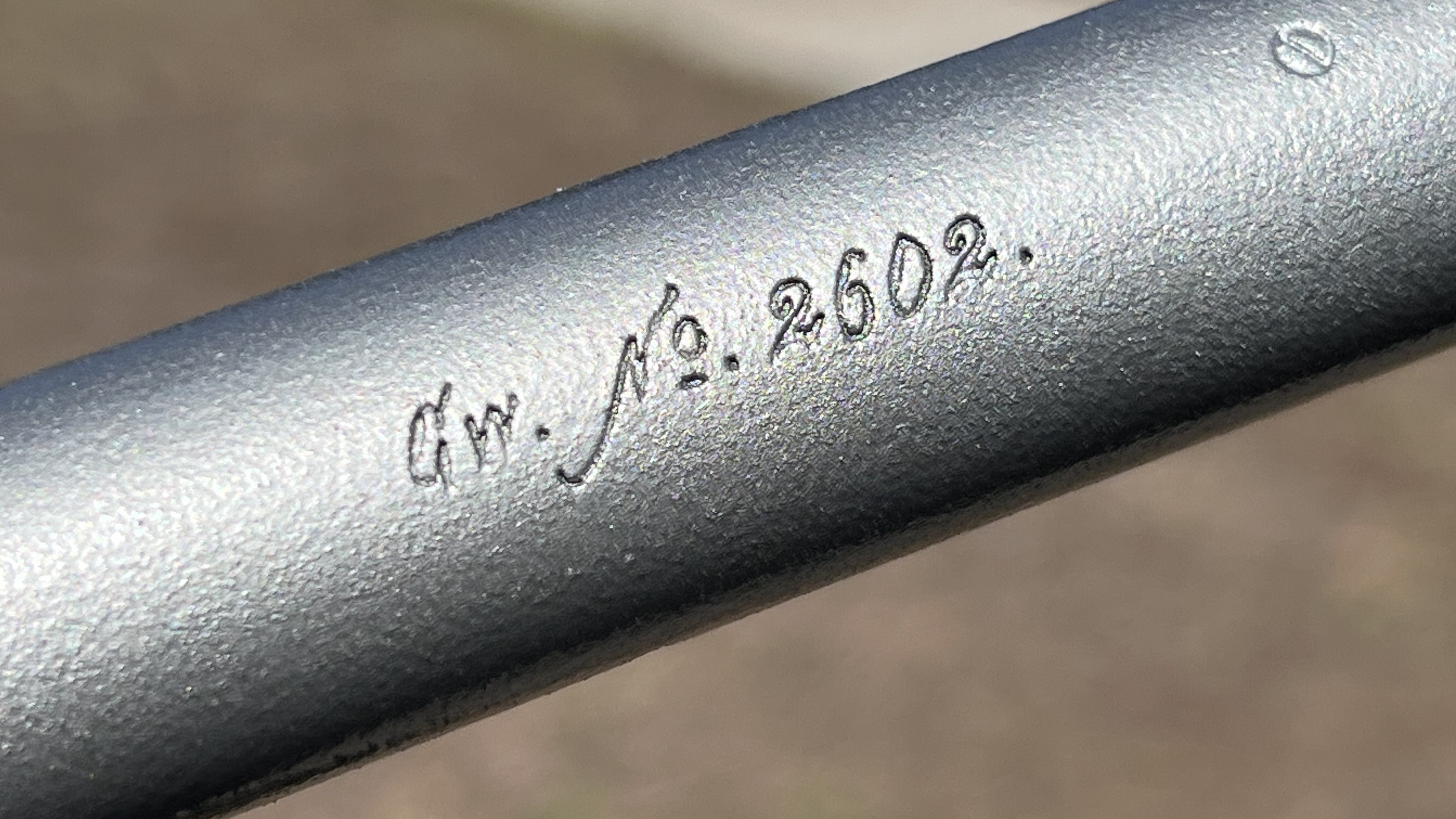

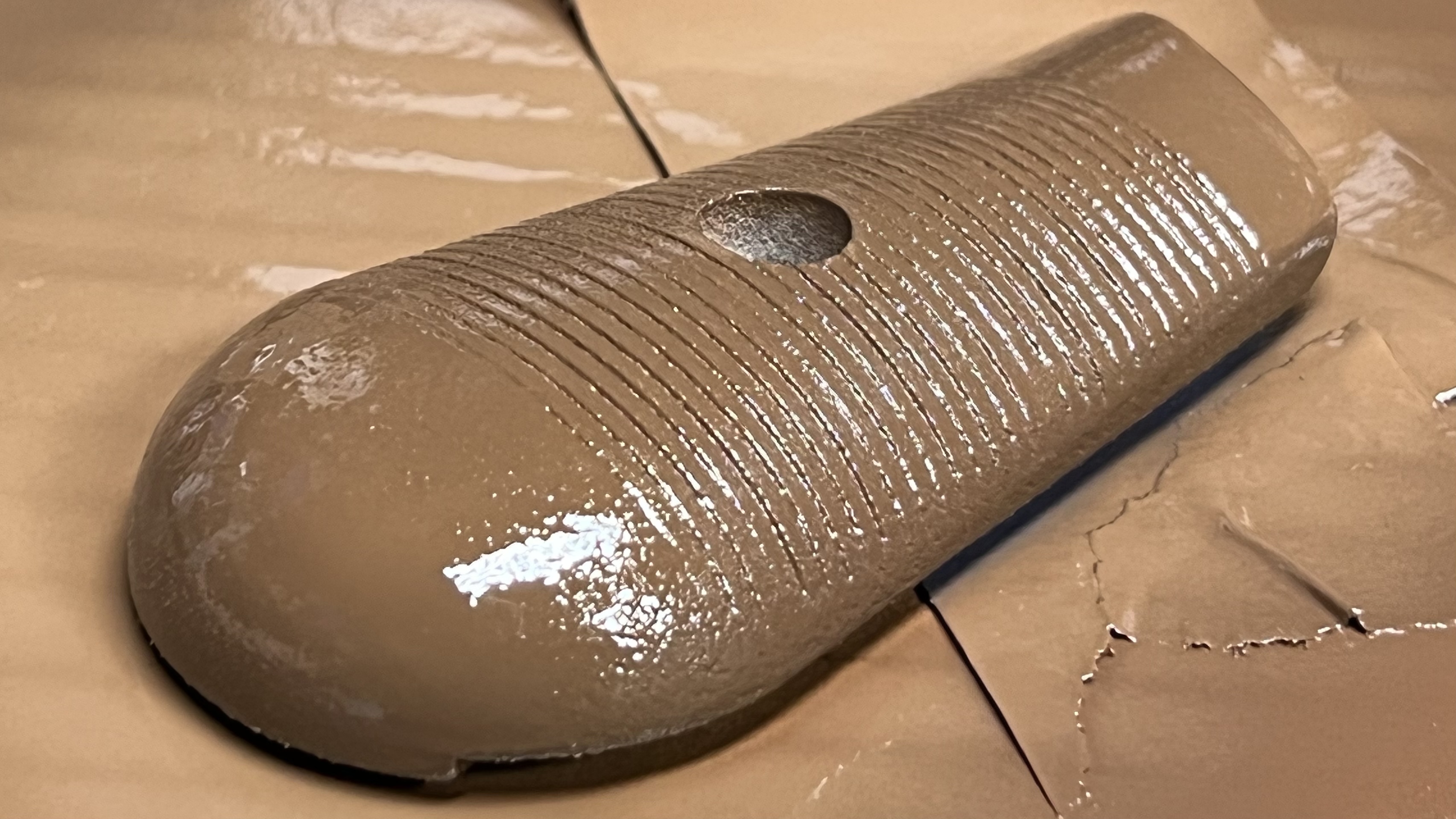

Continuing with this *no primer series to see how it turns out. I sanded all the parts down first this time before I even started painting which should help. *Full disclosure for the silver paint I did use a “paint and primer all in one” as that’s what I had on hand. It doesn’t work at all like regular straight up primer so it still fits the bill. The brass paint is just regular brass paint but I ran out so I was only able to aply one coat..
Here’s a shocker to absolutely no one. Moving forward.. simply use primer first. I have to sand it anyways after the 1st coat of paint regardless. Primer will simply make the sanding easier and smoother. Paint does work as you can see but primer still obviously works much better..

I agree, primer isn't necessary for adhesion of paint. I always found it pointless on metal. But, it's best quality is being more easily sandable than standard enamel paints, it's great for filling in un-wanted details and such. Also good for showing us every single flaw we left behind too, haha. It's handy for certain reasons, but just like glues and such, it depends on the application. A good amount of people assume locktite can be used on anything or everything, just like super-glue or gorilla glue. It isn't, you gotta have the right tool, for the right job so-to-speak =b
I always just used primer mostly to show flaws and for filling them, since it's much more sandable than standard paint, especially glosses. It's basically a filler these days, not sure why it's a standard to prime everything. In this case, it's a good idea I think. It tends to shrink considerably too, so it helps fill in the printed texture without loosing too much detail.
