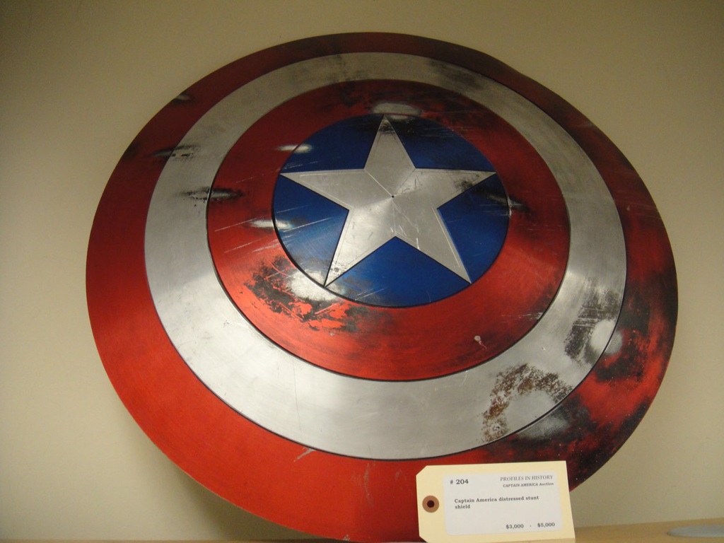

From what i saw last night the small one has a thinner inner ring. The big one he used at the begining where it is unpainted. This one also has a different handle. Also at the first raid it looks like a big painted one. The small one seems to be used the rest of the movie because he is either fighting or wearing it on his back. So i get 3 different ones. An unpainted big one with metal handles, a painted big one with battle scortches and a smaller painted one with scortches or battle damage. There were probably more made though.

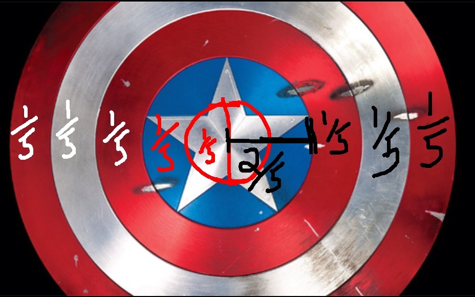

From what I can deduct it looks like the shield has 5 equally spaced rings, the first 2 encompass the star and blue, the third and fifth are red with the forth silver/white. I have read that have multiple shields for the movies that range from different sizes depending on the shot. Because of this fact I would have to think all the shields would have to be proportional to one another so an obvious difference can't be seen. This is why I believe the dimensions would be down on a scale instead of actually inches so regardless of the size of the shield (24,25,26,26.5) they would all look the same regardless.
I would also like to point out that I have look over photo at exhausting rates and not sure if my eyes are playing tricks or if the images are of different shields or maybe stretch a little bit in the photos but it looks like the blue circle is just short of 2/5 on some of the photos and is exactly 2/5 on others. It's going to be hard to tell until someone gets a shot of the shield with a ruler next to it. Recreating exacted dimensions from a photo is incredible hard as most of you know. There's such a limited amount of data.
I would love to know how everyone feels about this?
-M. Perillo
its not exact but it's close, my first guess was 2 3/4" rings with 9 1/2" star cause it equalled 26" (a nice round number) and looked good on paper but then I read about how there are different size shields used in the movie and it made me wonder how they measured to make the shields used in the movie.. It is possible when they made a different size shield by an inch or inch and a half, they just made it close enough and figured people wouldn't notice but I find it odd they would take that chance with such a essential prop with major screen time... There is also the fact the curvature to the shield, if the flat diameter is 26" then the surface diameter will be bigger because of its triangle (2D) or cone shape (3D) shape. Wish I could just hold a ruler to the actual shield
Mathematically, I think that is EXACTLY how the rings were laid out.
That's how I modeled this shield also.
