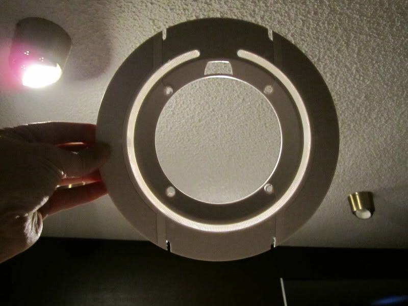

Im working on a white disc right now, but my cback C-ring is dim and yellow, the outer ring is kinda dim and yellow too (getting a replacement for it, it doesn't fit) but the front C ring is nice and bright white. plus im getting light diffusing through the white plastic of the disc. does anyone have any tips on how to improve this?
For the white disc, there is quite a bit of extra work involved if you want to block out the light from shining through the plastic. I have a couple different techniques I use for my white discs. One is to paint the inside black. This will take about 4-5 coats and requires quite a bit of time and patience. I hold each half up to a lamp periodically to catch any spots where the light is still shining through. Here are some pics:
Even with this technique, your still going to get a little bit of light bleed. (I forgot to paint out the button on this one)
I have another technique which I currently am using that involves foil tape to block out the major regions. I'll see if I can find some photos of that.
