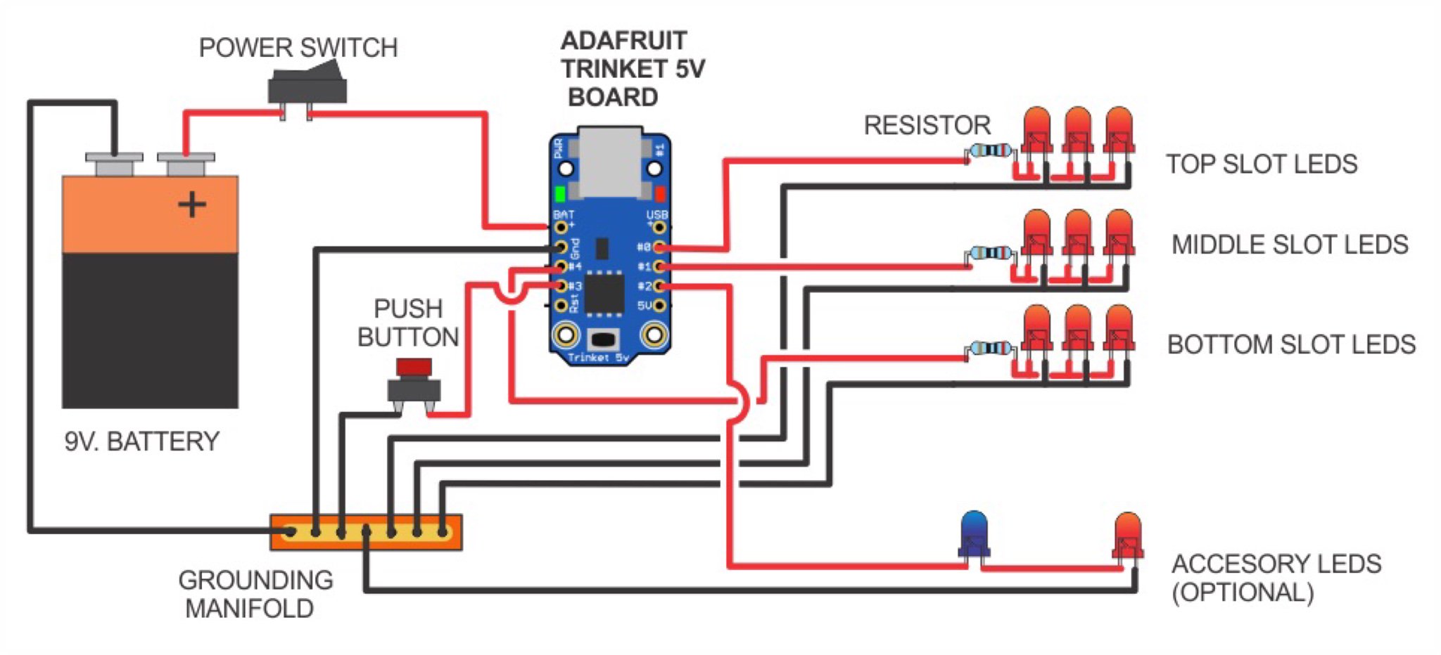

So what I used is a little controller board from AdaFruit electronics called*Trinket which is arduino programable and ready to use, and is quite cheap (around $7 dlls). There is also a Trinket Pro which has more features, if you already know your way around electronics and arduino coding, give it a go perhaps you can integrate sound as well. (perhaps the respirator sound ... maybe?). You can find more about it here:Adafruit Trinket
One thing about the Trinket is it has only 3 analog pins that can be used with*PWM (Pulse With Modulation), which means they fade the light slowly on the leds. Those pins are numers 0, 1, 4. (*note:Trinket Pro has x2*PWM pins).
So those pins ; 0, 1, 4, will be the pins used for the slot lights.
Pin 3 will be the momentary push button to switch between sequences.
Pin 2 is optional for accesory lights, I use them to light up the blue and red acrylics slightly.
Pin BAT is for power or battery.
Pin Gnd is for Grounding the circuit.
And so, the diagram of the lights looks like this:

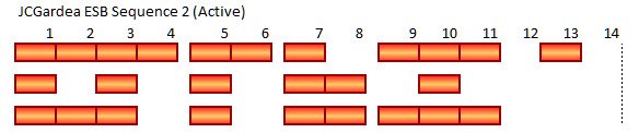

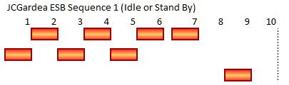

Now on to the sequence... The first sequence I defined is the "ESB Idle sequence" ; small pause between 6 and 7, and full pause in steps 8 and 10.
The second sequence I used is the "ESB Active sequence" ; with small pauses between 4 and 5, 6, and 7, 8 and 9, and full pause in steps 12 and 14.

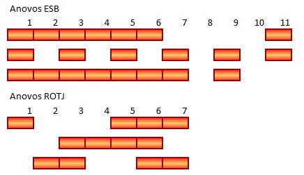

Just for reference below are Fettronics and Anovos sequences.

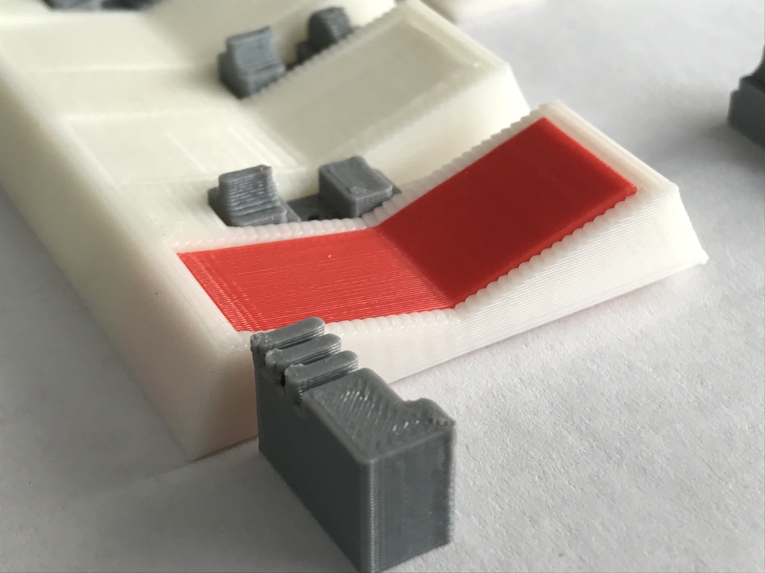

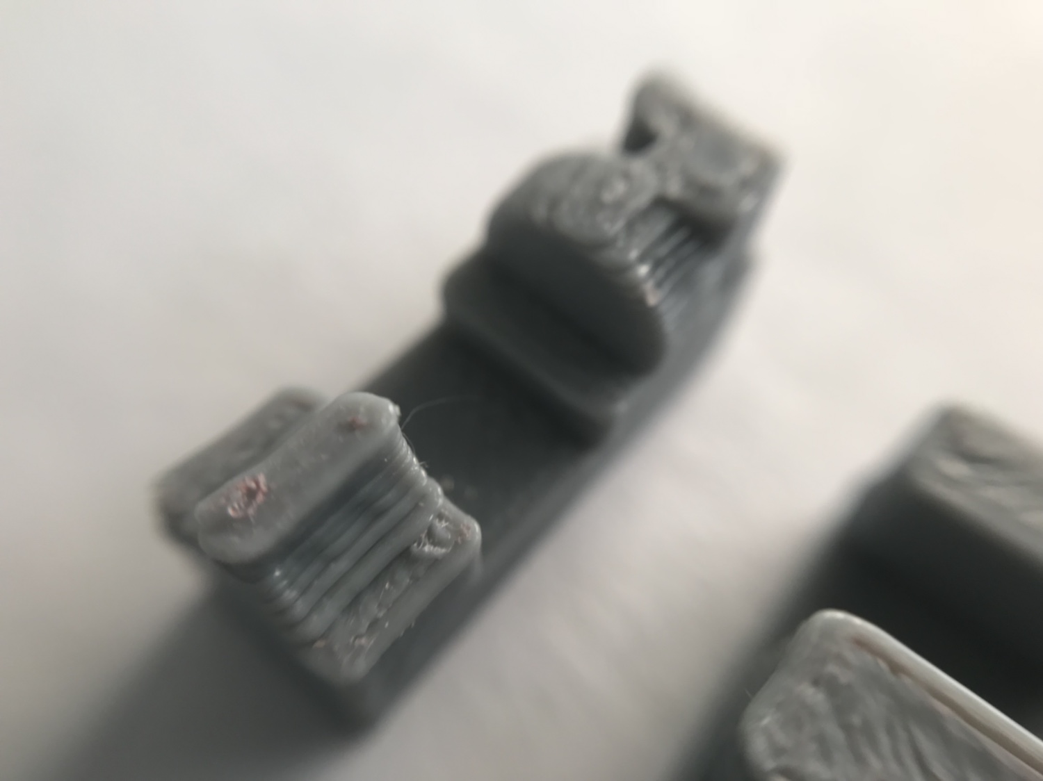

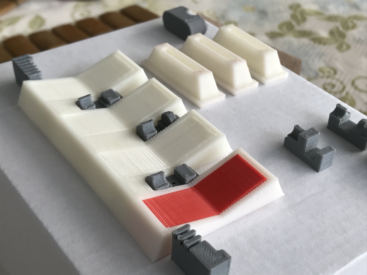

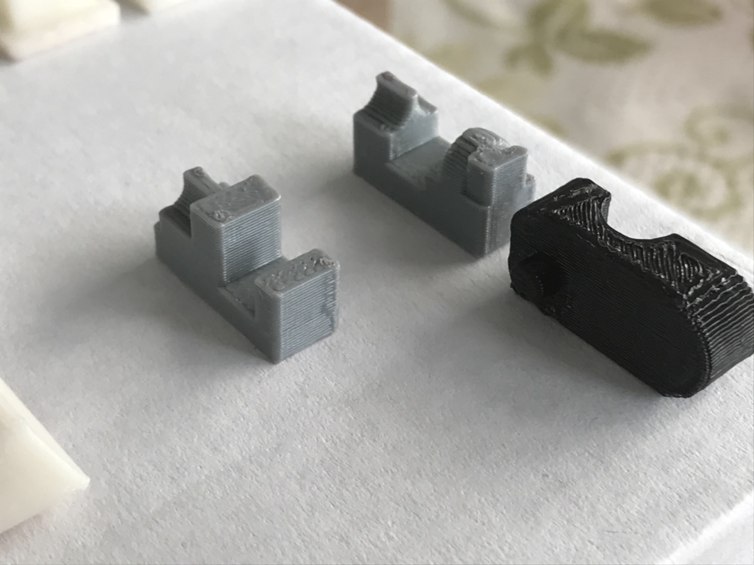

Well, I’m updating my chest box and I 3D printed my own modeled greeblies, but now i have a question, how do I get rid of the printed texture and stepping? This pieces are quite small, and I don’t know what would would work. Filler primer? , spot putty?, poliesther resin? Bondo?, Rondo? Guidance for tiny pieces needed.
Hi! Yes, you have to sand the pieces, then apply putty/bondo and sand them again. Primer and paint. Be patience... is not a one-day project. Good luck!

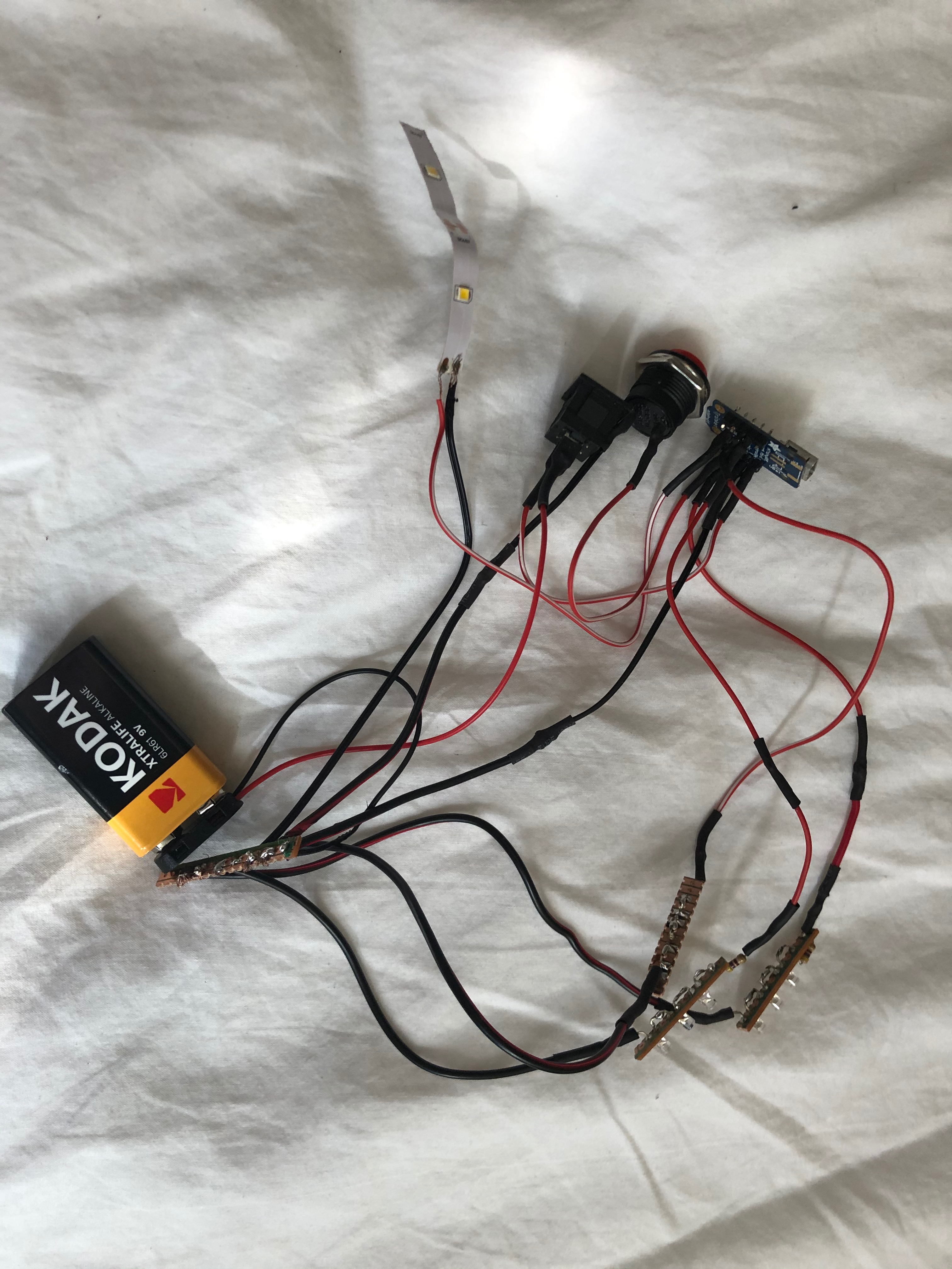

Thanks so much for uploading this. I've made up the circuit as above and plugged in my trinket and uploaded the sketch, but the red led lights are not working at all. Any ideas?

Help! Thanks so much for uploading this. I've made up the circuit as above and plugged in my trinket and uploaded the sketch, but the red led lights are not working at all. Any ideas?
Are you sure you soldered the red lights to pins 0, 1, and 4?
Make sure you downloaded the correct drivers to upload/flash.
Check the neutral for fault connections. Inverting polarity on the battery , maybe?

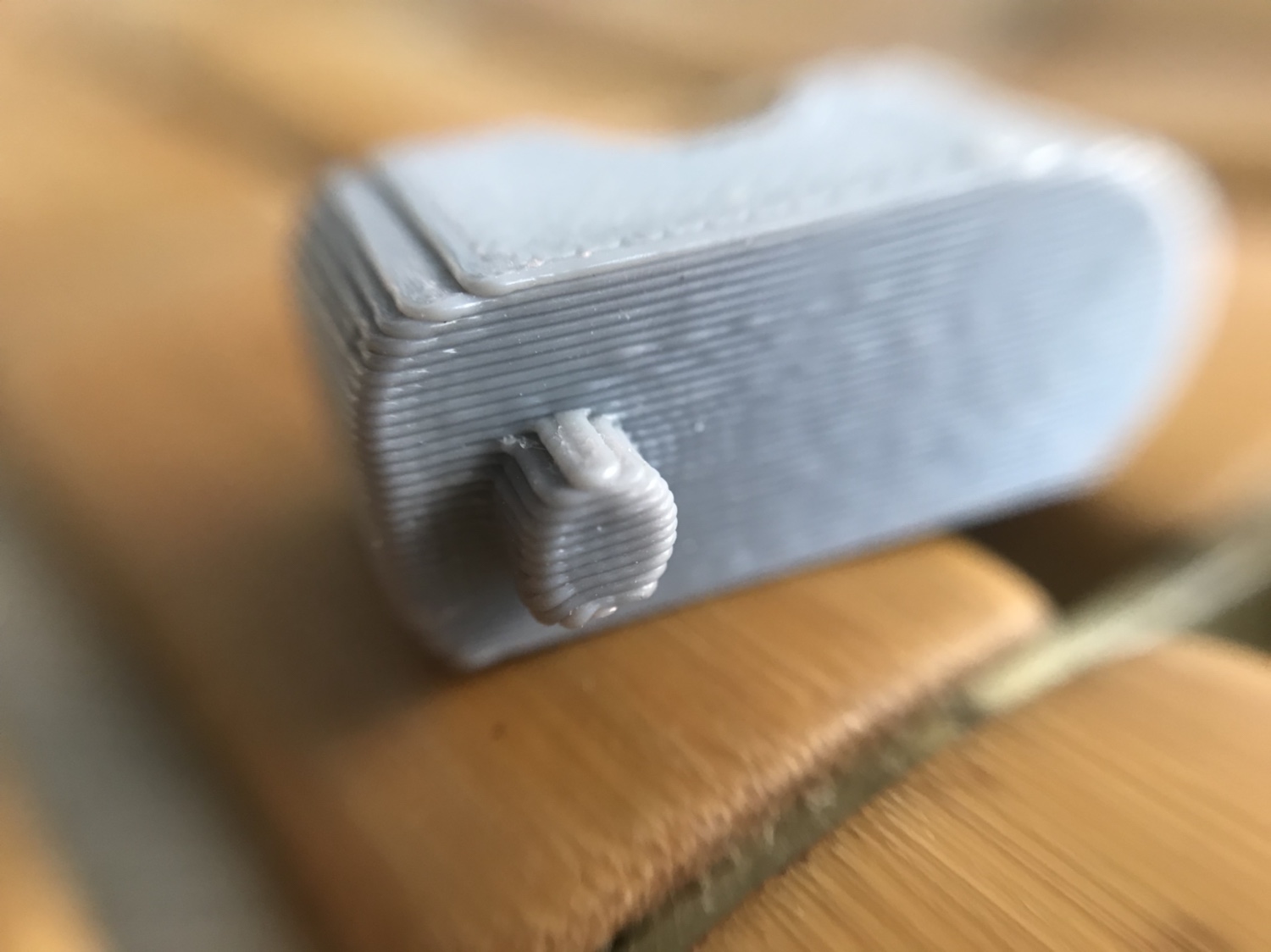

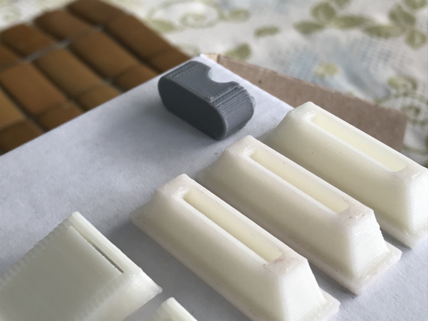

I lost a greebly for my chest box , does any one seek these? Is there a file to 3D print s replacement ? Any help would be greatly appreciated
I attached photo of the one I lost circled in yellow
Thanks!!

Thank you xiion. I modeled them myself after seeing as much as reference photos I could find and comparing them to the other boxes from different sellers. Some of the greeblies seemed at little “off” to me, thats why I modeled my own. I uploaded them to shapeways:
Frankly, for the boxes I found 3D printing still quite expensive where I live, so I made them out of wood. But the greeblies are definitely worth it.

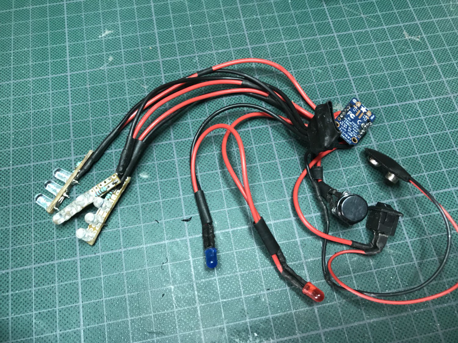

And so, the diagram of the lights looks like this:View attachment 1050976
Now the slot leds I grouped them with the help of a pin board, and cut it with a rotary tool so to fix the resistor and have the leds evenly spaced. And because of all the grounding are* to be connected in order to close the circuit, I used a pin board again to connect them all together to try to keep the cables tidy. I tried to use as much shrink wrap as possible to protect the solders*and avoid the cables from breaking. I tell you more than 1 cable broke on me while soldering the others.
And this is what the completed lights rig looks like.View attachment 1050977View attachment 1050978
Now on to the sequence... The first sequence I defined is the "ESB Idle sequence" ; small pause between 6 and 7, and full pause in steps 8 and 10.View attachment 1050979
The second sequence I used is the "ESB Active sequence" ; with small pauses between 4 and 5, 6, and 7, 8 and 9, and full pause in steps 12 and 14.View attachment 1050980

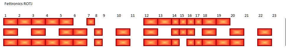

Just for reference below are Fettronics and Anovos sequences. View attachment 1050981View attachment 1050982

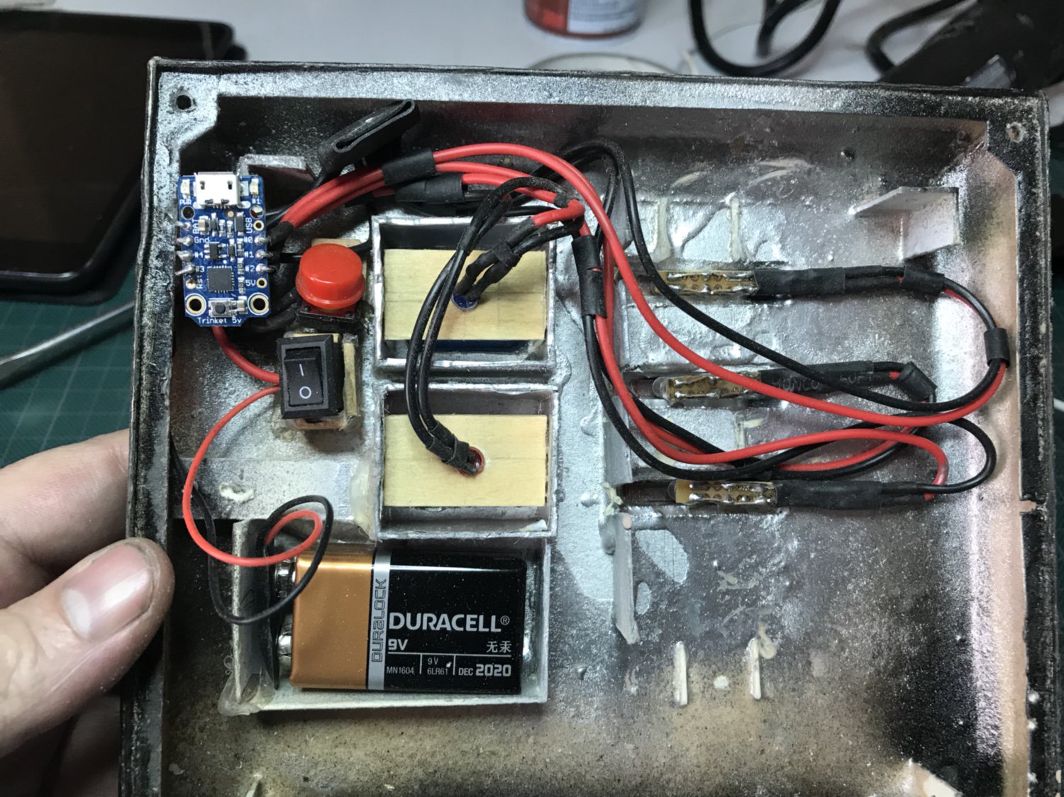

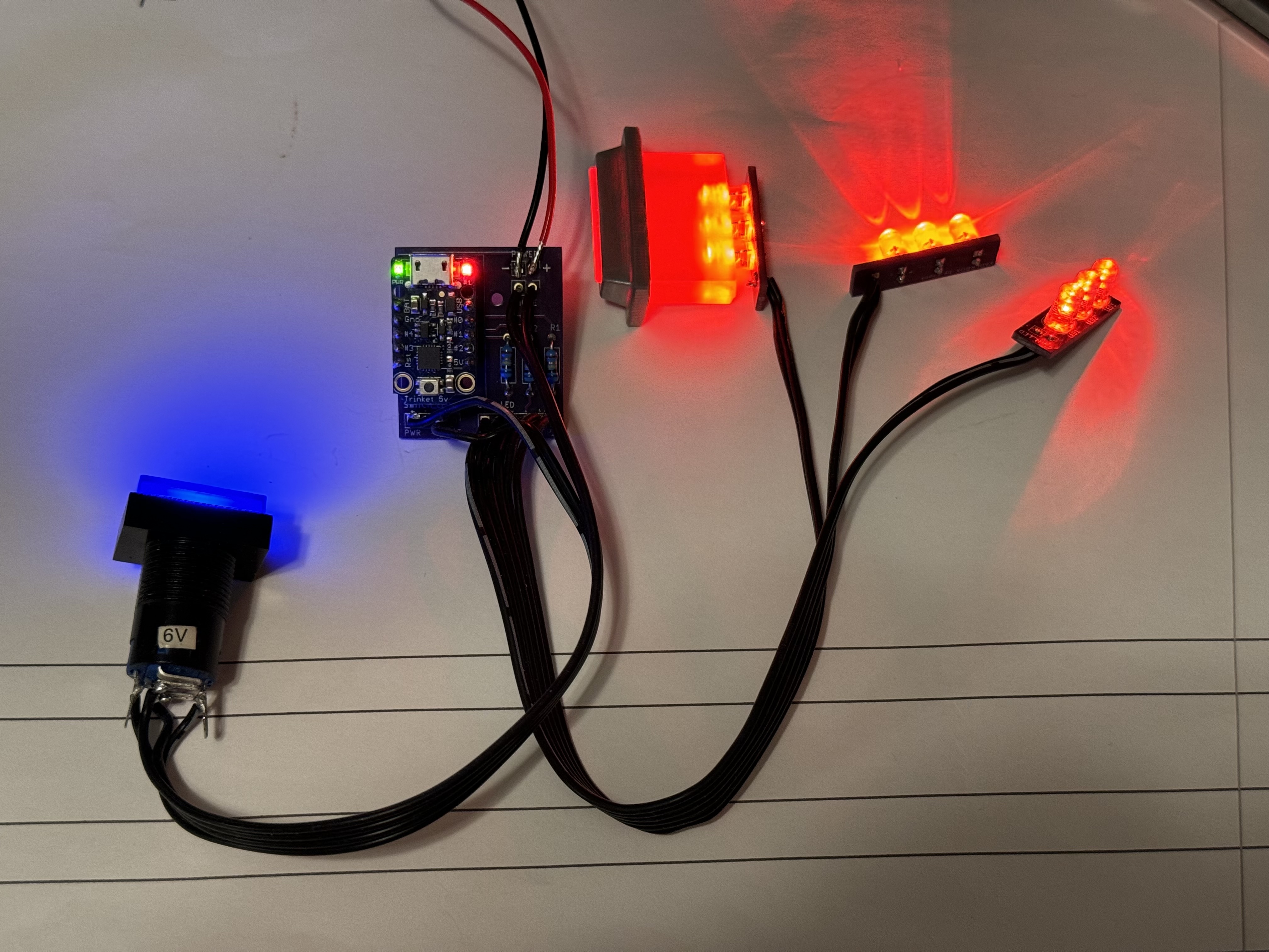

I wanted to also share how my "version" of this came out!
I started with the 5v Trinket, and added a 9v battery holder, with a door that'll mount in the back of the chest box. I am using a 3d printed chest box, along with the greebles, switches, etc printed on a resin printer. The rods currently are resin, but, currently working on turning aluminum ones on a lathe. The coin slots AND the translucent red parts are also printed in resin.
The big thing that may jump out, is the circuit boards that are used. Based on the digram, I created a simple set of PCB's to mount both the trinket to, and also the LED's for the coin slots.
The programming was modified to fit my own ROTJ version, along with adjusting the programming to have two modes for the ROTJ, one with the button lights on, one with the button lights off. I am using the switches themselves for power and mode. They will get a final modification of shaping and a new outer bezel to properly mimic the original bezels better.
