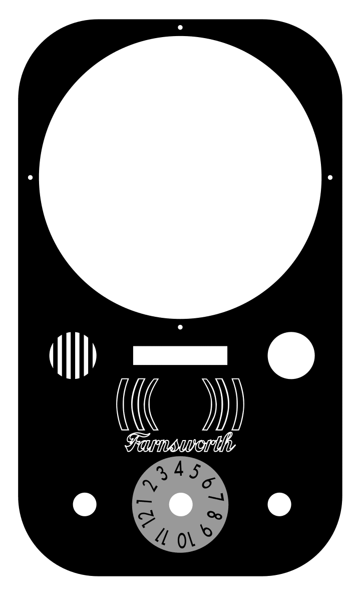

Thanks to Kylash I am updating the template now and will post a final one once I know the exact corner roundness.
Cutting a run will take a little longer than I hoped. Cutting 2mm brass seems to need a 1kW Laser, which is not too common and deep engraving the number circle will need a CNC mill, laser cutters seem to do only surface engraving on metal
Final version unless someone wants to object. Checked the size and think I found the perfect corner roundness to fit a Wheatley. Will do a test cut with fake brass soon.
Feel free to use attached zipped SVG file for your own projects
  • farnsworth.zip
