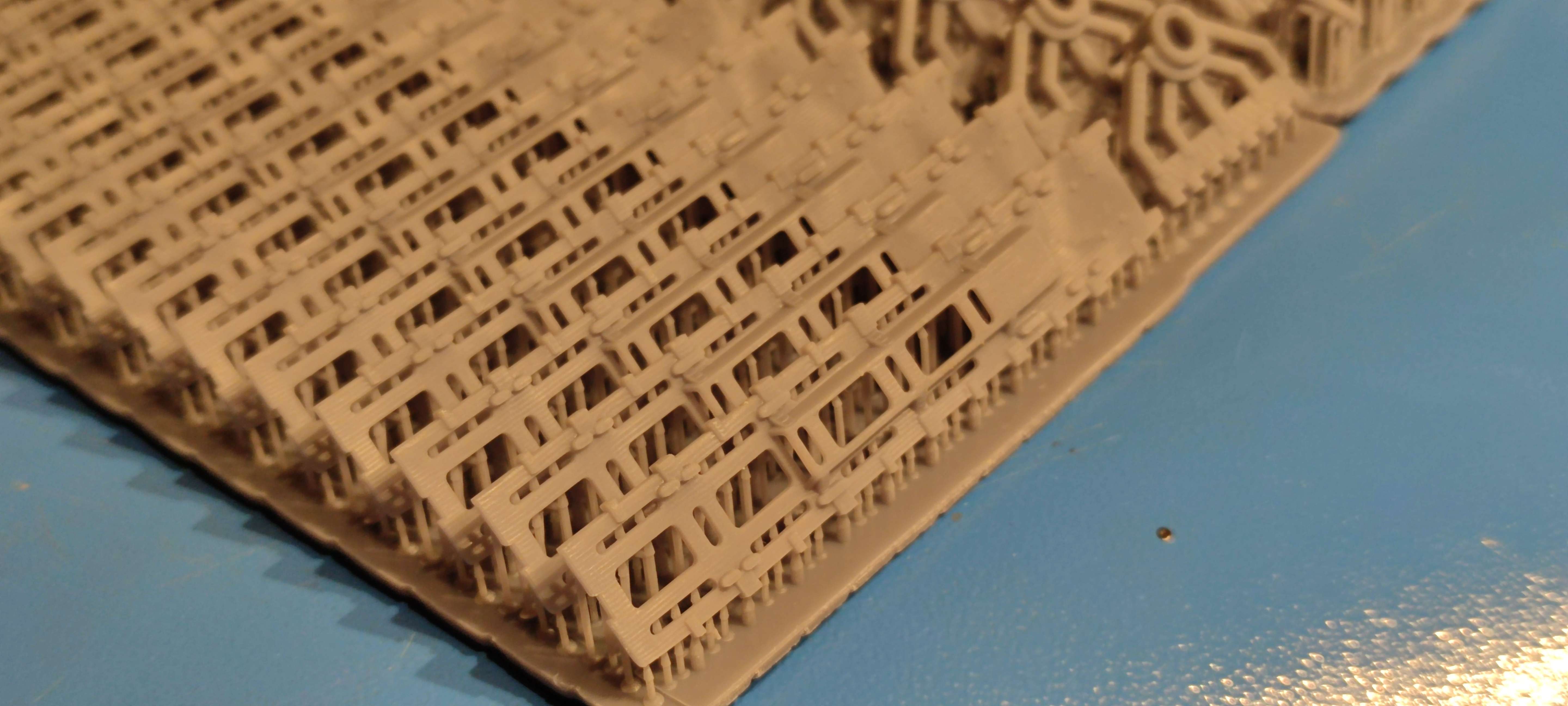

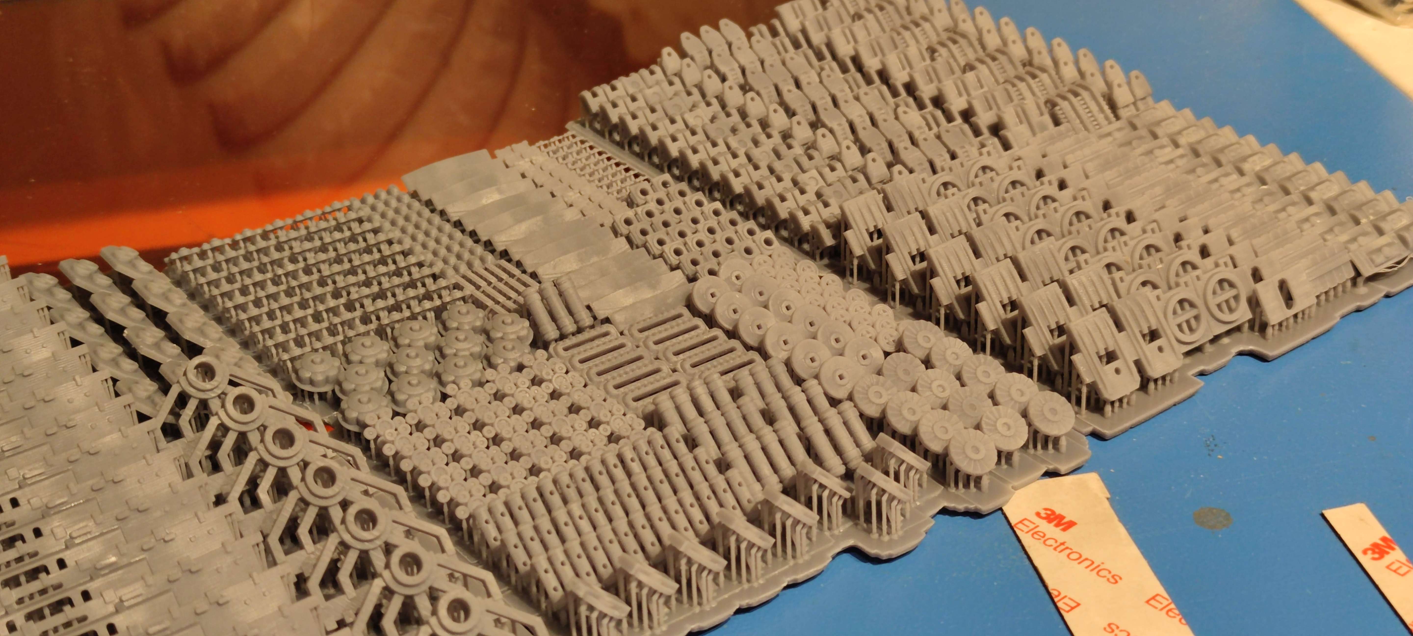

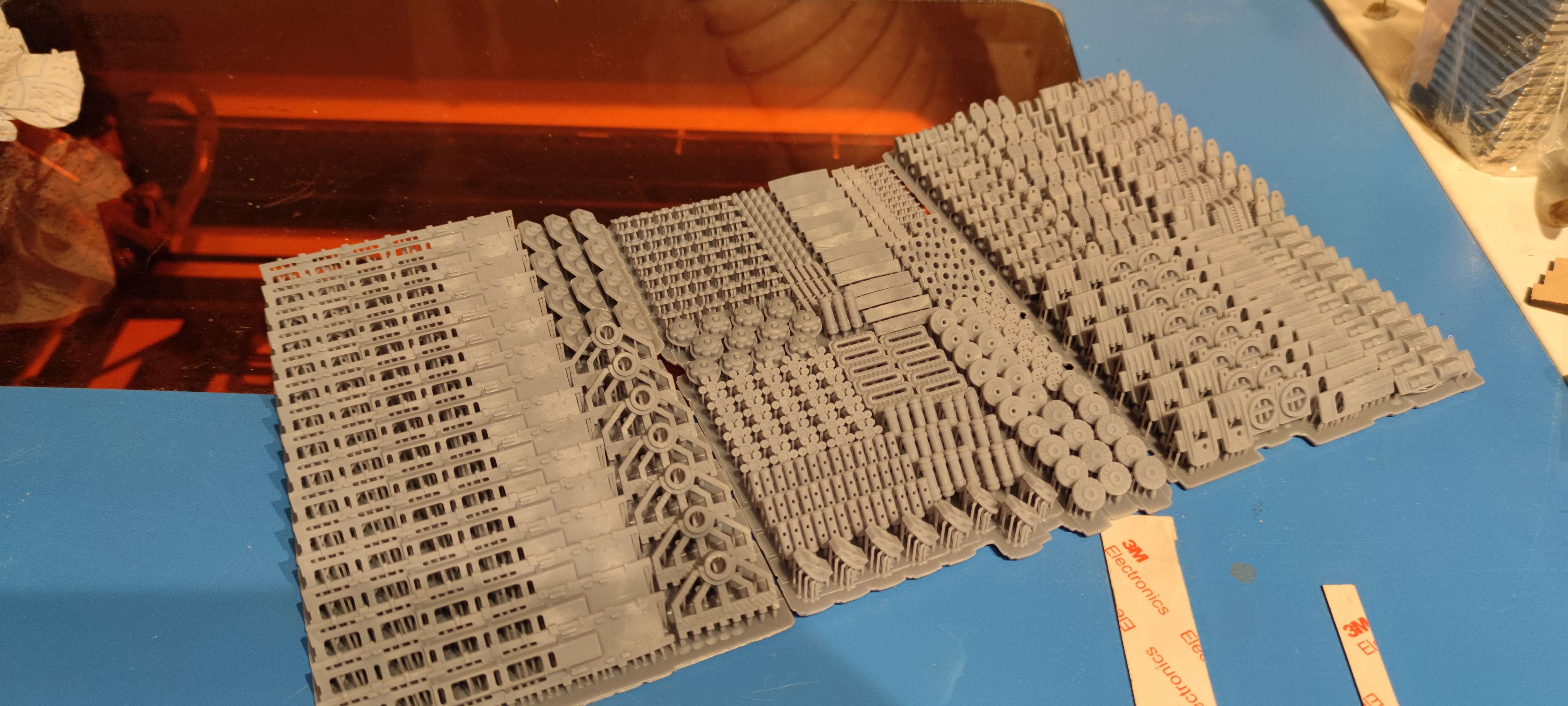

Been printing off the modelled greebles I've done so far. Mostly roughly eyeballed from what I can see on the ILM cube Duncanator worked on.
The Uni Greeble is in there too :D A couple scales of it.
And bellow this again eyeballed from the model kit. Spotted it on the ILM model, comes from the same rail artillery model kit as the uni greeble :D

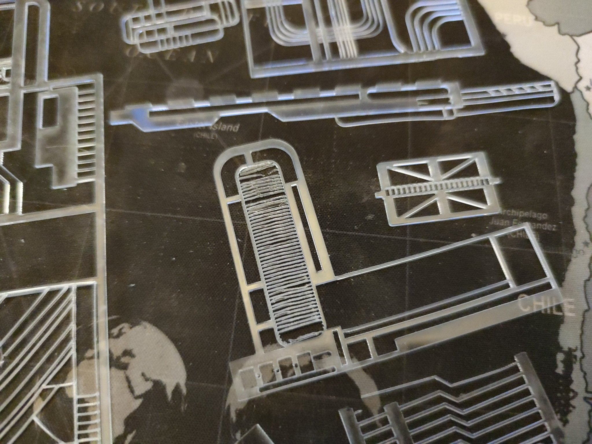

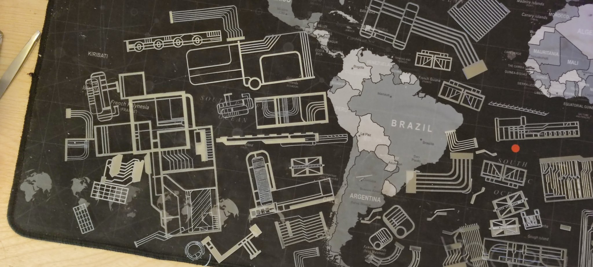

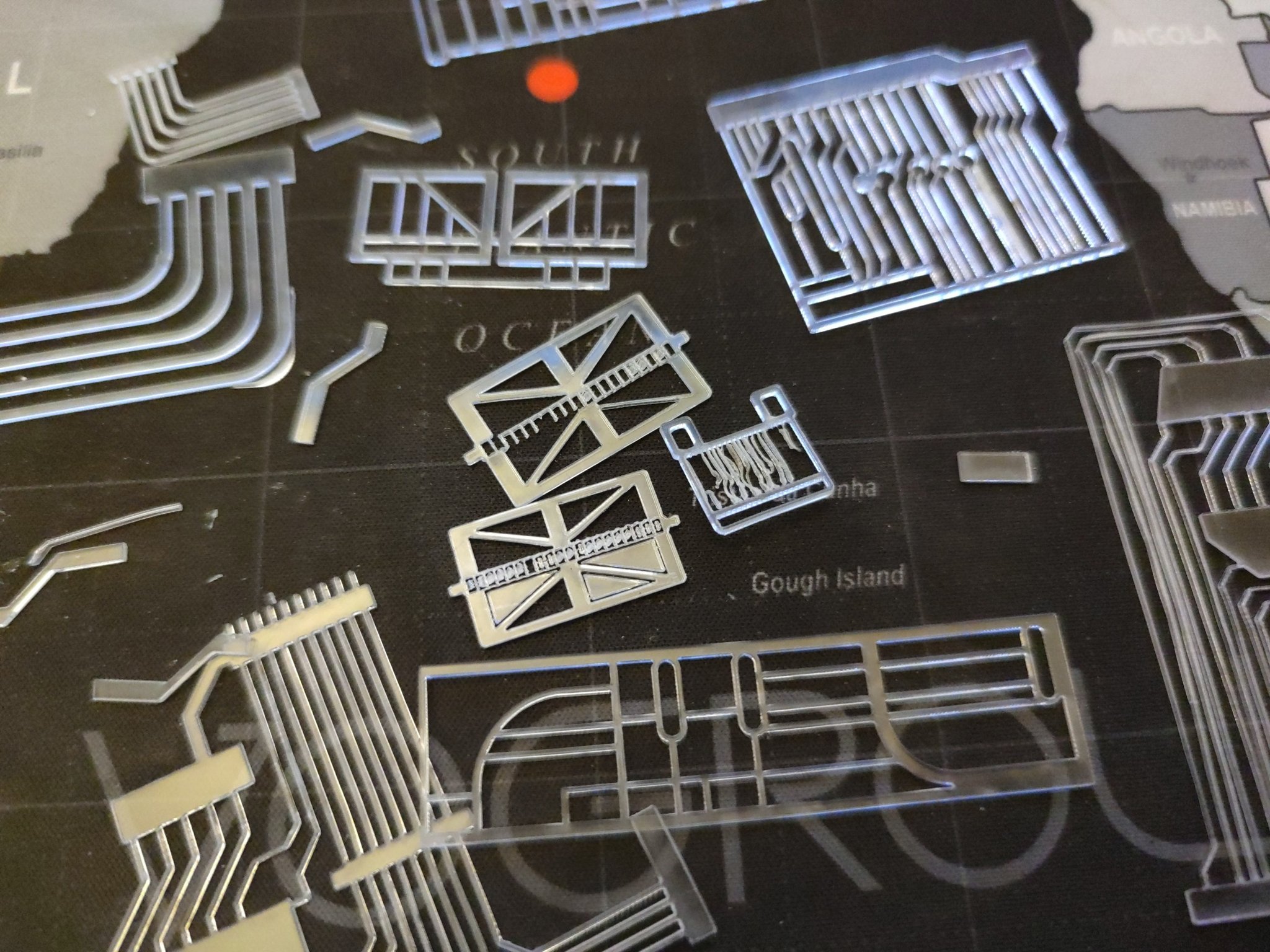

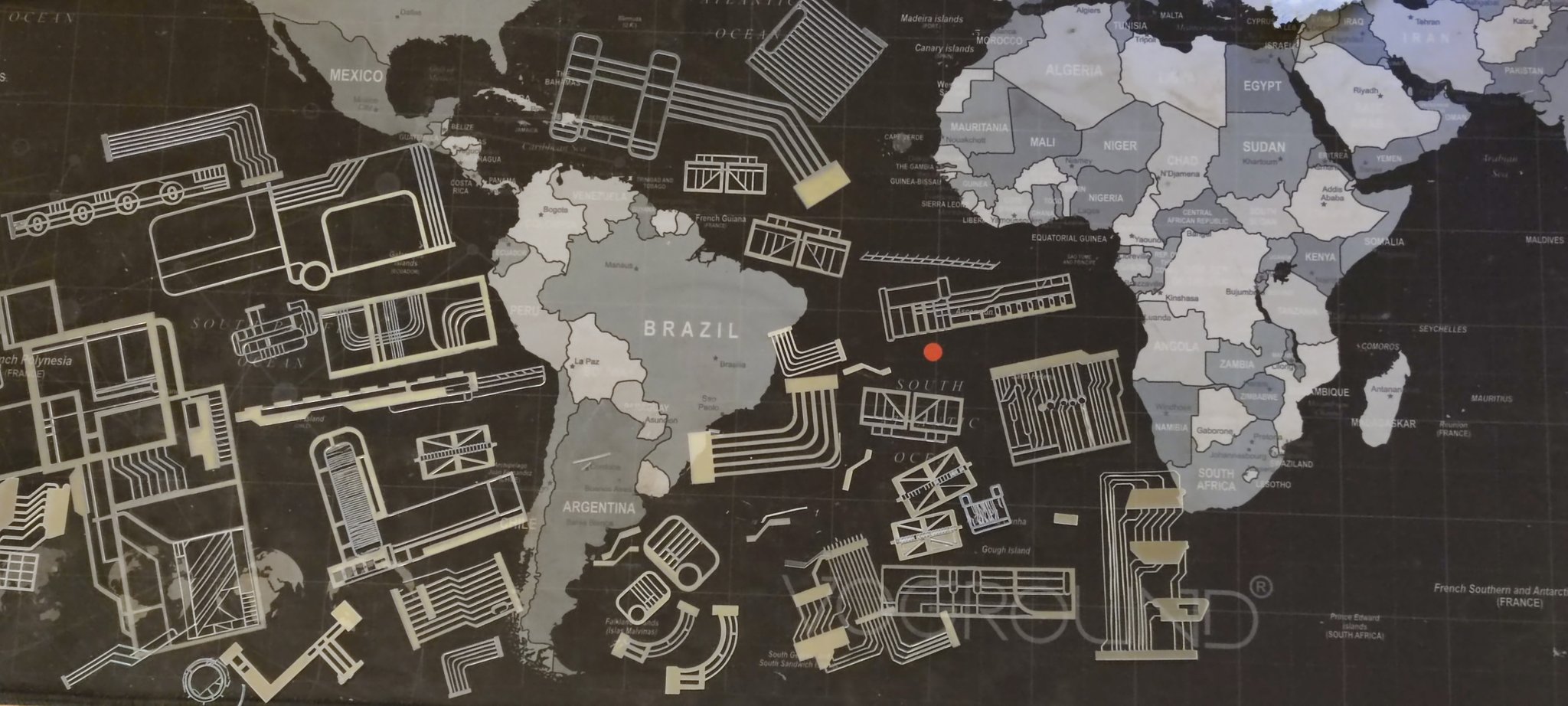

Did some 1mm layercut acrylic. as a test. Some parts came out ok at this scale, but some not so much... Some bits ill have to beef up some thicknesses, and will also have to look at changing cutting settings. Maybe even a slow very weak beam. Or multiple passes with a weak beam.
I also had a little issue with debris getting in the way.
I will be using brass etching, but thats going to be for the third layer. This is second layer stuff.

You sure crammed a lot of parts on the 3D print platform. The laser cut parts are tricky when they are that thin.
I've found that having the laser move as fast as possible when cutting reduces the dwell time. Longer dwell time seems to heat up the area around the cut, which can cause warping of the parts. It's a tricky balance to find a power setting and cutting speed that does the trick.
When cutting out repeated shapes that are separated by a thin strip (like vent slots), I'll set up the cutter to do every other slot on the first pass, and then do the other slots on a second pass. This gives the material time to cool between laser passes, which helps reduce warping.
Yeah been trying to figure out how best to get lightburn to do that. I so far cant find a cut order thing.

And yep crammed as much as I can on the build plate. :D Saves on print time
