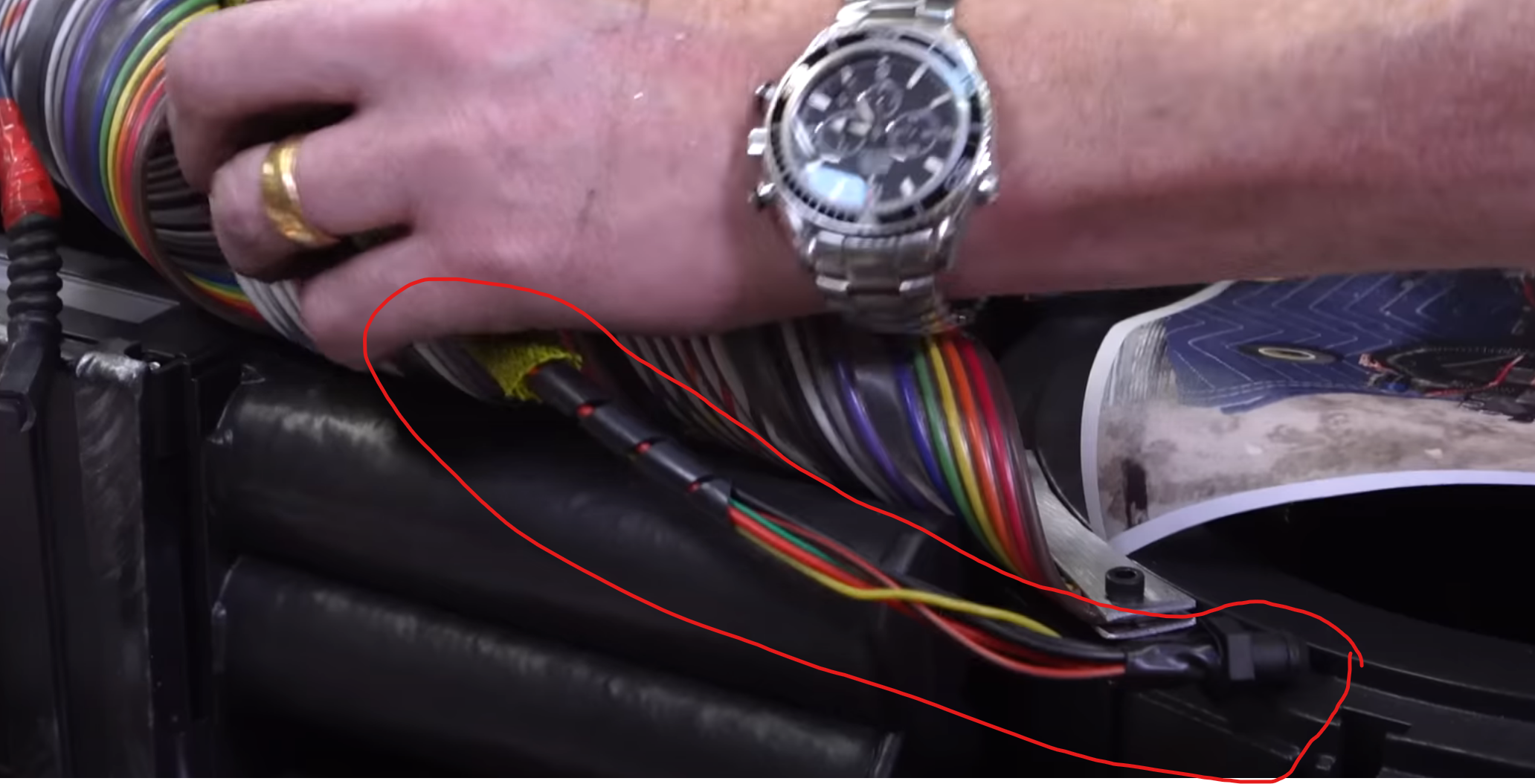

Does anyone know how Adam managed to swap out this part? I see he removed the old one and replaced it completely, but how did he take the old connector and taped the wires to it? and where does one get the wires from?

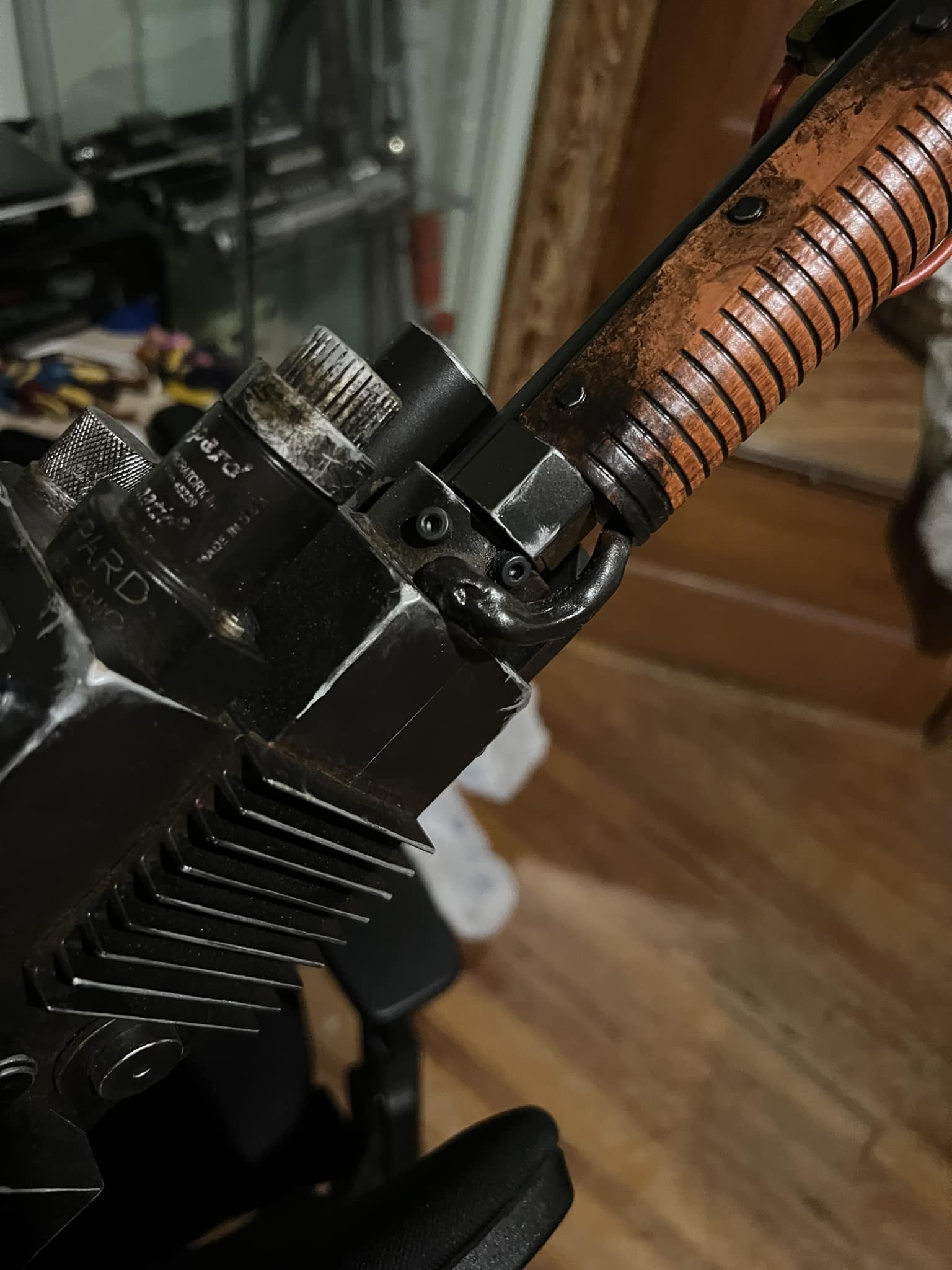

I finally added these screws. I did have to use a metal cutting dremel attachment to cut them down to about 2mm long so the screws don't interfere with the pop-out mechanism. Also be very slow and careful while drilling. I made sure to get just far enough to open up a hole without letting the drill push into the cavity. Oh, I also used a dab of super glue on each one since they aren't threaded into the hole.
Does anyone know how Adam managed to swap out this part? I see he removed the old one and replaced it completely, but how did he take the old connector and taped the wires to it? and where does one get the wires from? View attachment 1657273
From the looks of it, he cut the hose off at the fitting that goes into the cyclotron and then drilled a hole in the middle to accept the new wires. He probably just secured the new wires in the fitting with some CA glue.
That maybe it! .. but where does one buy the wires?? Sorry if it sounds like a stupid question.. I have no idea lol.
Adam said it was a wiring loom of some kind, but you could buy the spiral wrap and just wrap it around some coloured wires.
