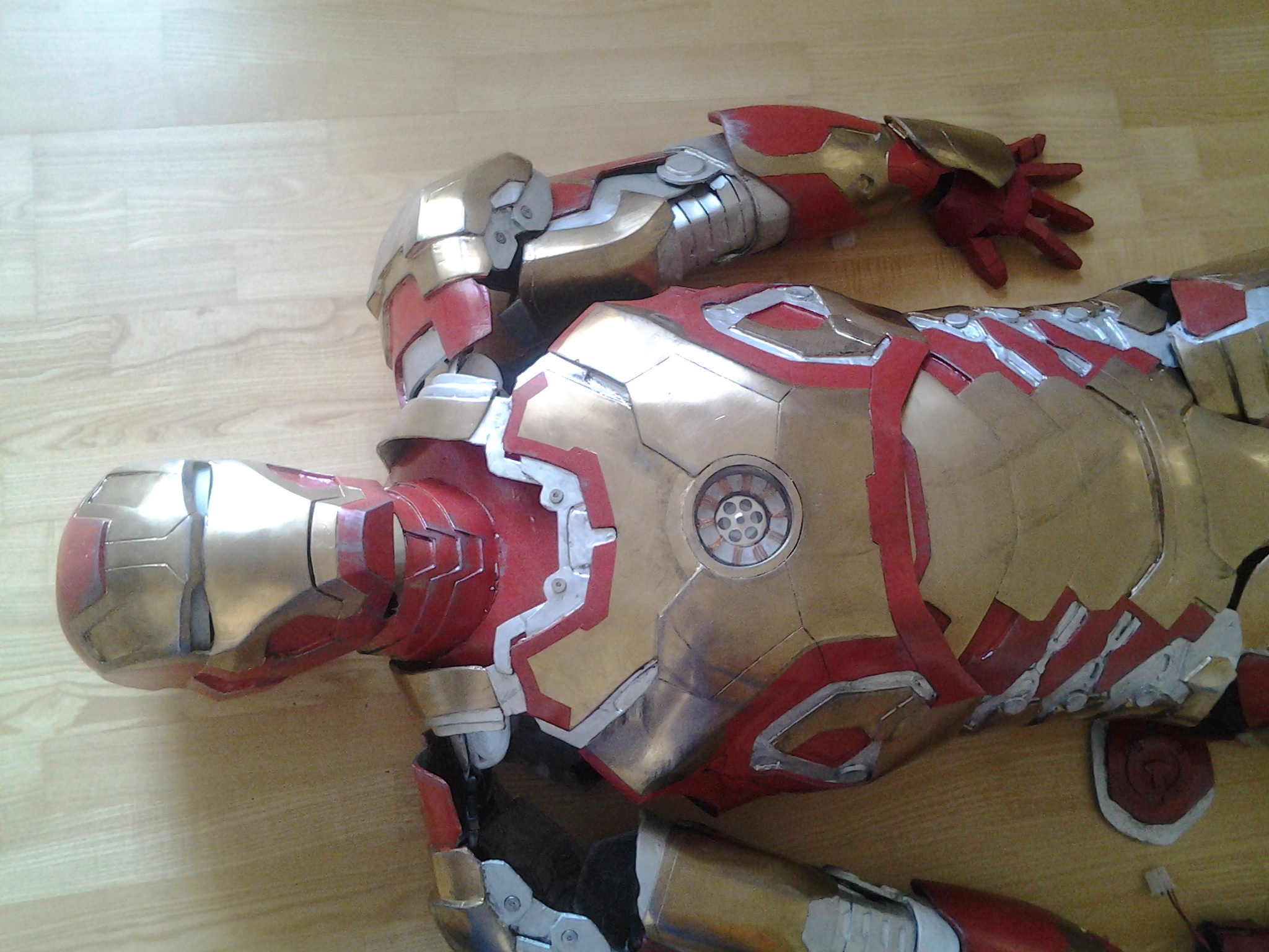

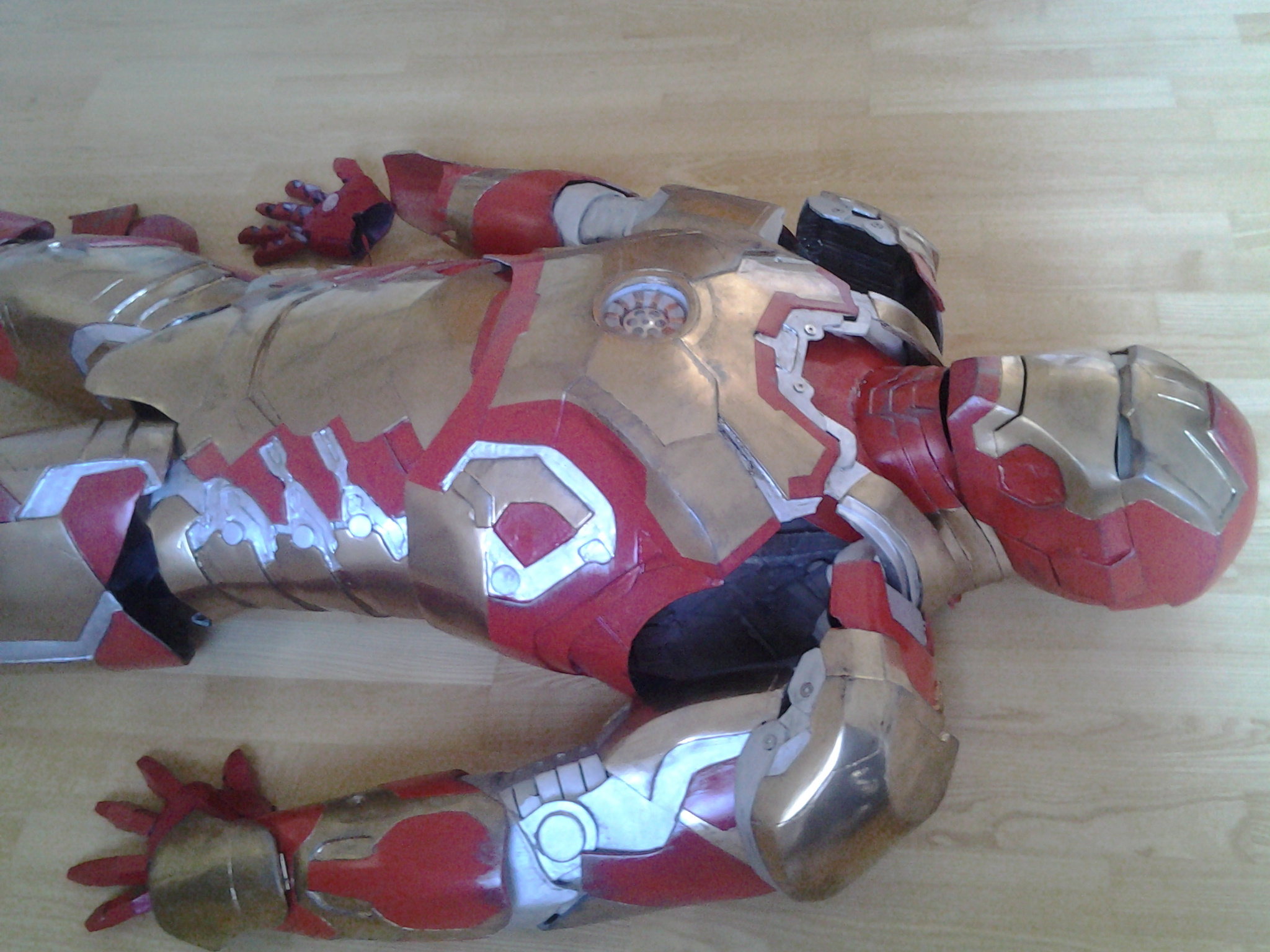

i finished my iron man suit last week using Helagaks files.
I finally made an account here because i want to say thanks for this awsome files and all the good and helpfull tutorials here.
I took a few pictures i hope you like it
wow! Amazing! How did you do the painting and did you harden it and how?
i am not native english speaker i will try to explain it as god as possible
I made it out of cardbord
i did 3 coats of resin and then applied whats called bondo body filler i think.
it had fiberglass mixed in it made the parts really hard and steady
an than came the sanding and the sanding and some more sanding. i could start a gangster career because i had no fingerprints anymore.
for painting is used some regular acrylic spray cans. 2 coat filler then again sanding with 240K paper and 2 coats the actual paint
at last i did some weathering with a rather hard brush an some leftover black and silver paint.
My next project will definatly be a foam build the amont of sanding work and all the toxic stuff i used, even with a respirator mask, is just insane.
