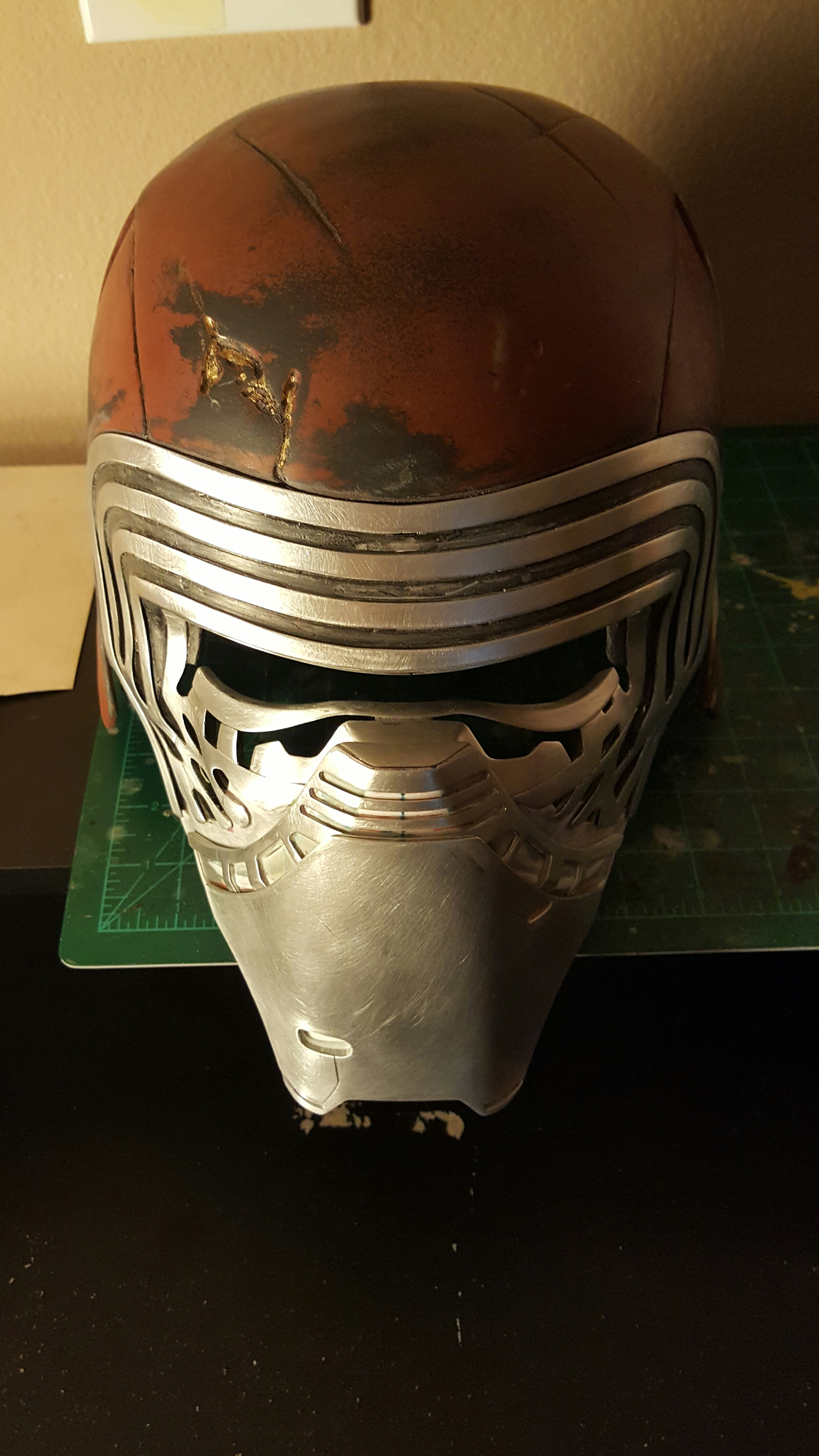

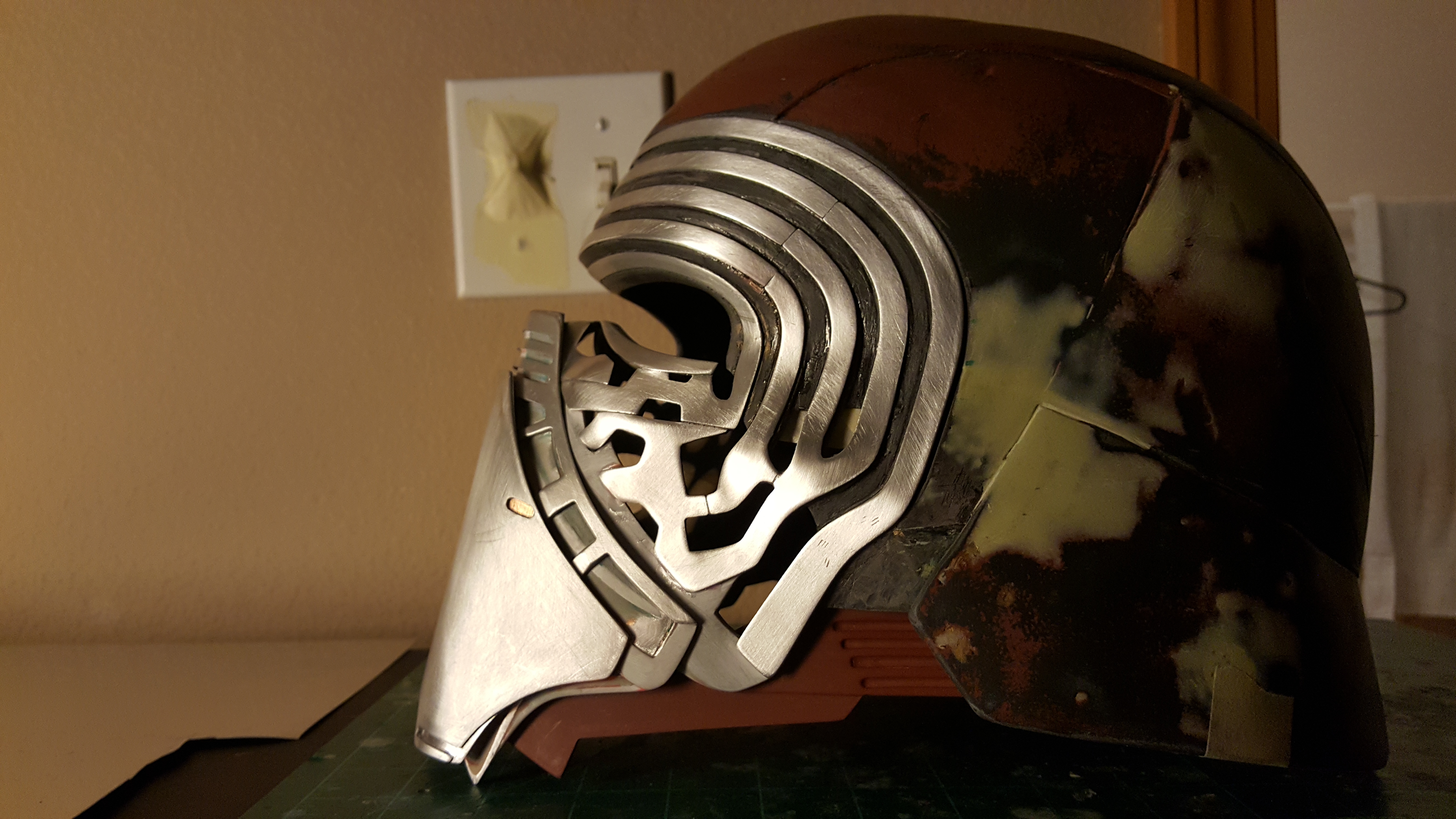

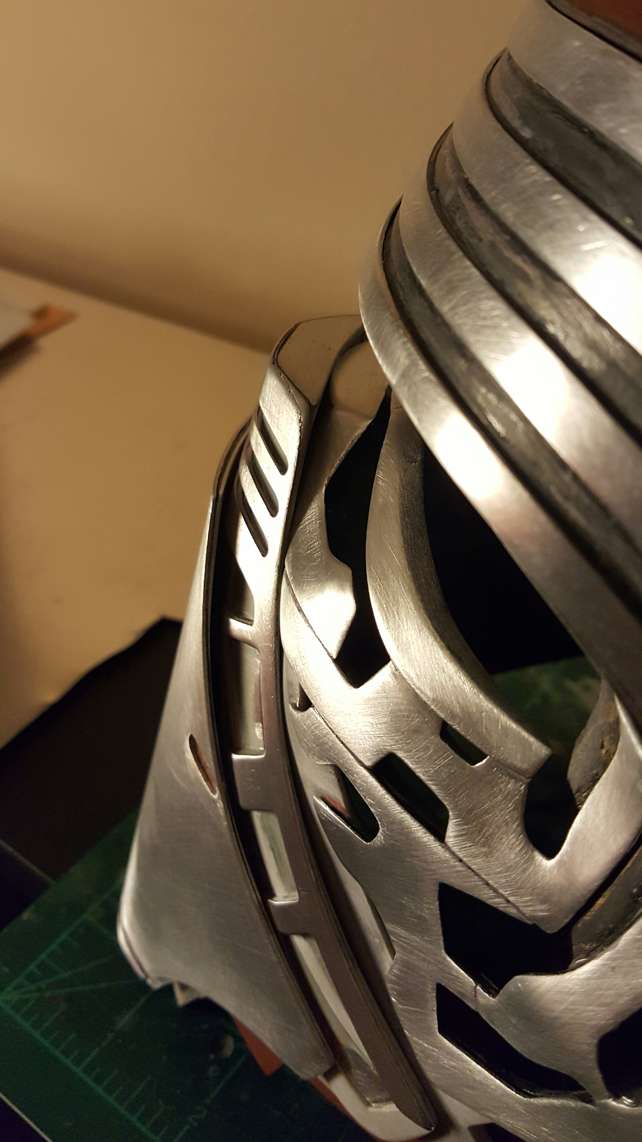

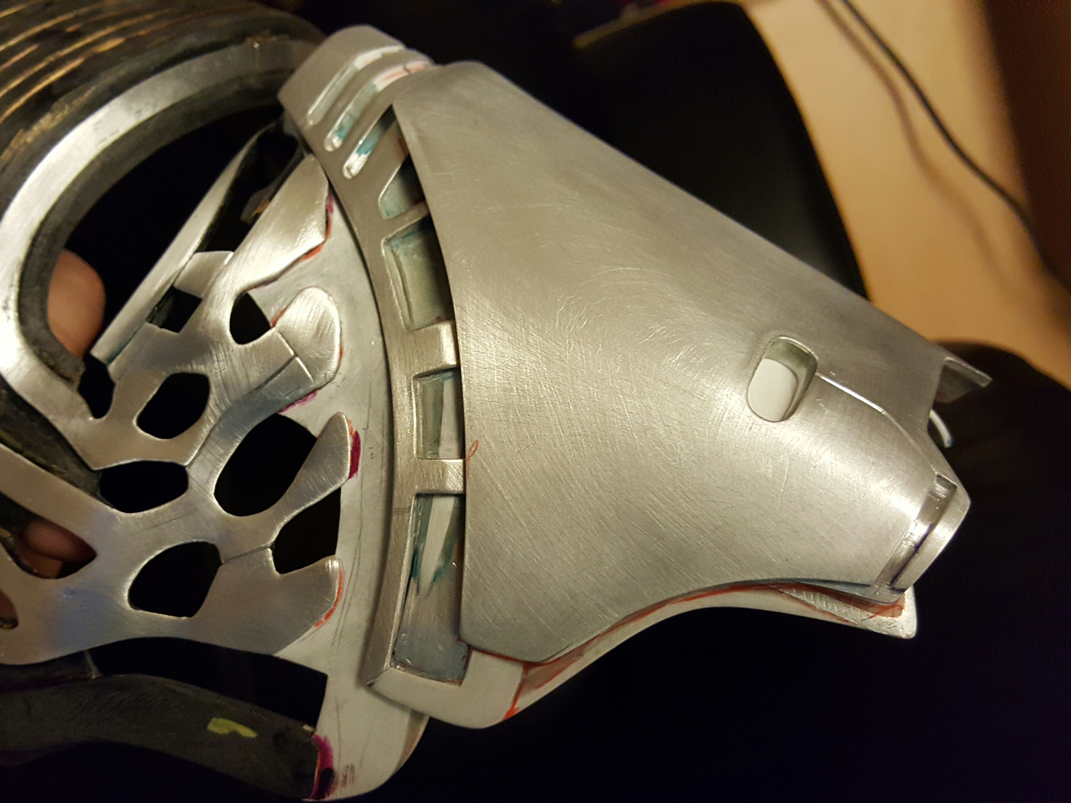

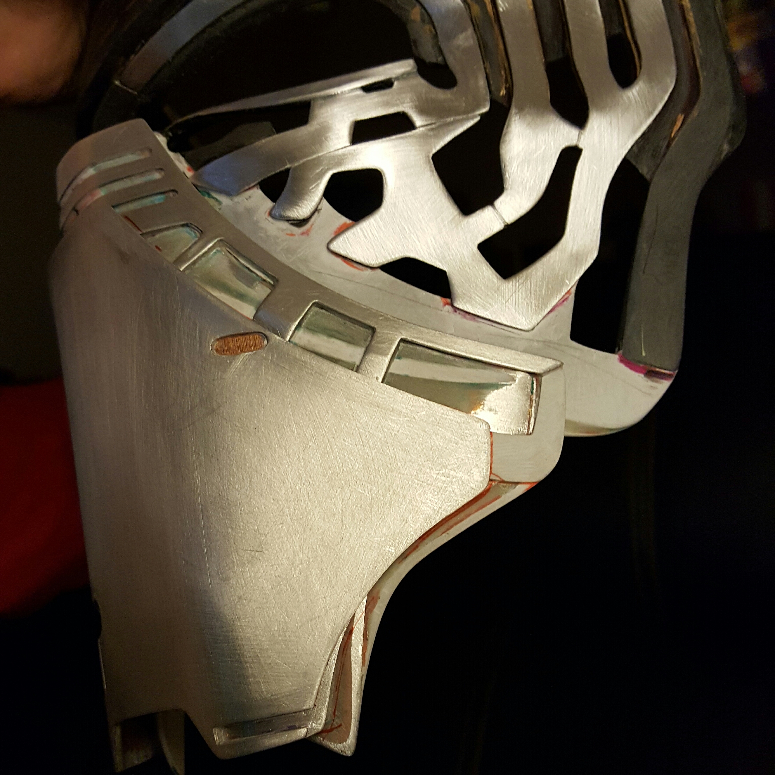

Punny. Haven't dedicated a lot of time to it since post. Some progress has been made though. Dont mind the seams, they will disappear and its temporarily assembled with tape so some parts aren't aligned properly.

What makes up the front of your build?
Ha... this looks great, I'm just wondering if this is mostly custom add on's... or is this just heavily modded parts from the other helmet?
How much is scratch built?
All the shiney stuff is just aluminum sheet metal and white stuff is sintra. The two mouth pieces are both scratch built using layered aluminum sheet with some sintra and apoxie sculpt (needs more scultp). Face pattern is more aluminum sheet layered over what used to be the chromed part of BS helmet sanded down, filled and shaped (basically just a backplate/dimensional guide).
That's awesome... Did you use something fancy to cut the aluminum? I've thought of re-building the mouth piece myself, but wasn't sure what to do it out of. That looks great, but my tools are minimal.
