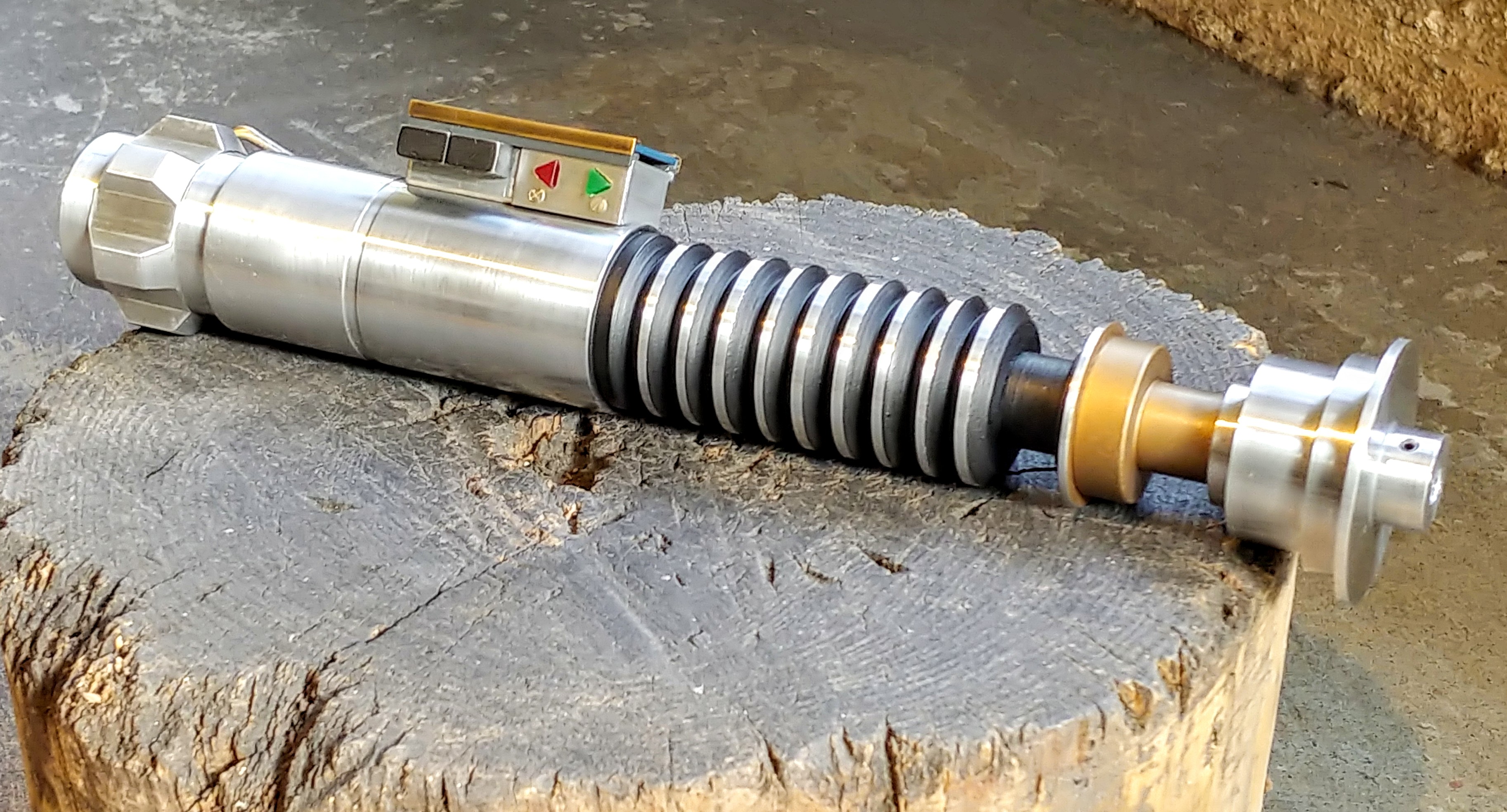

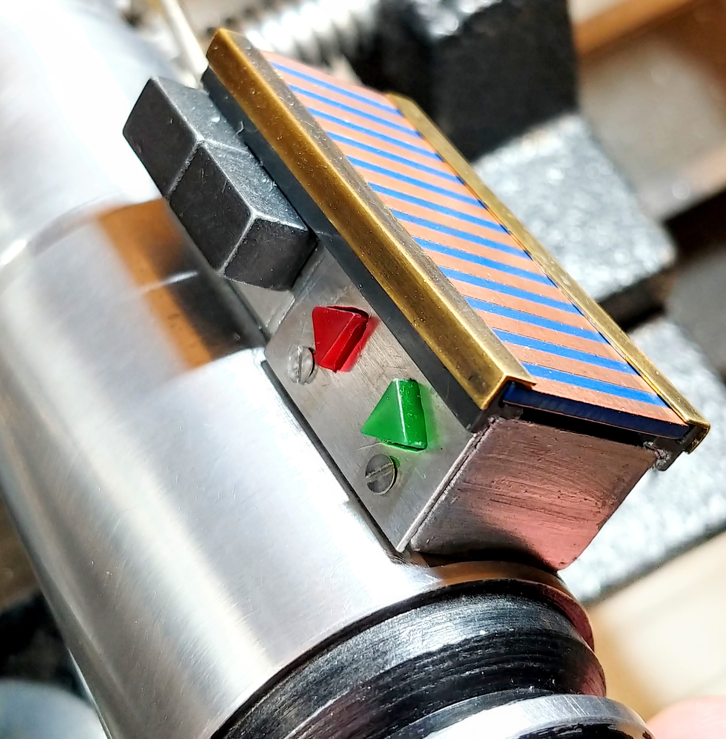

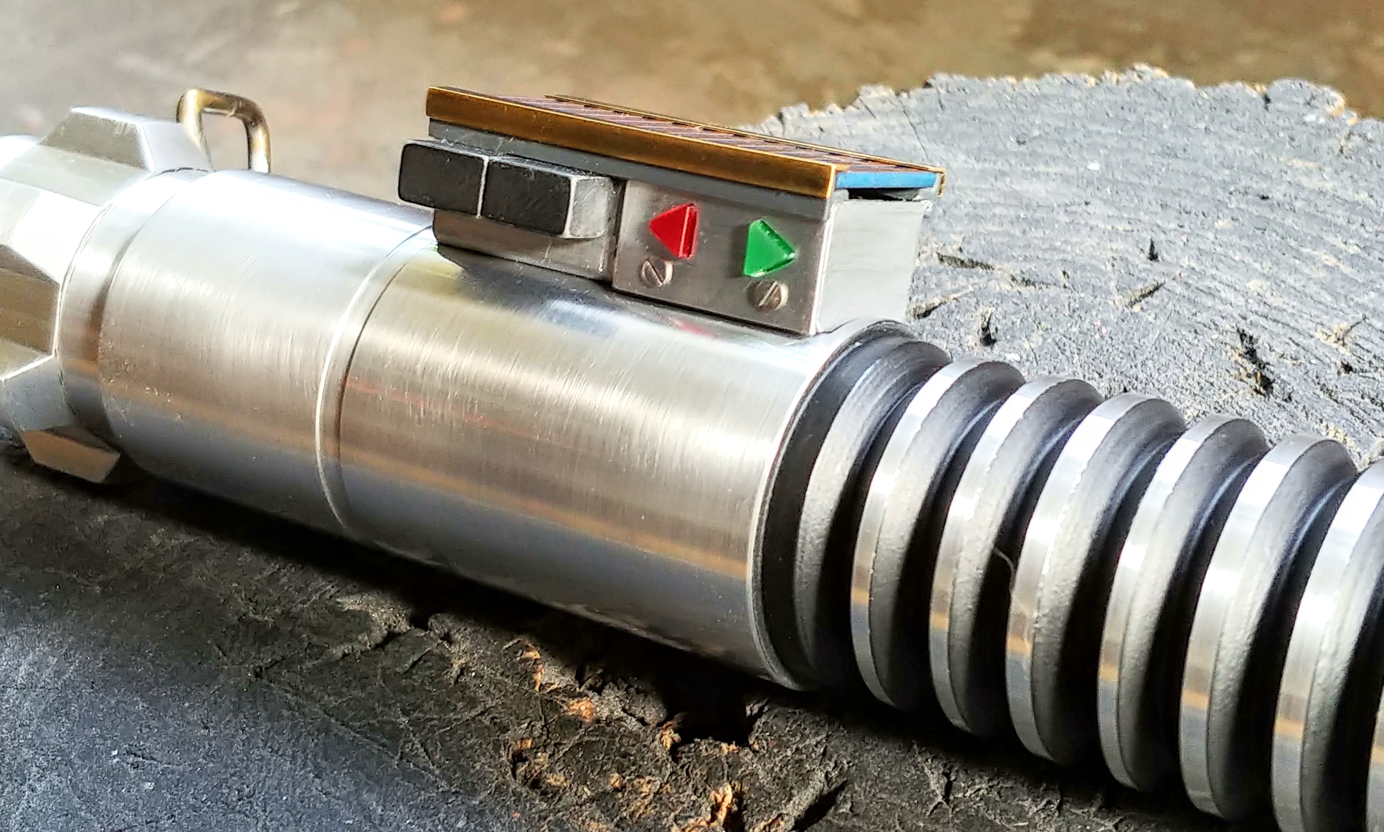

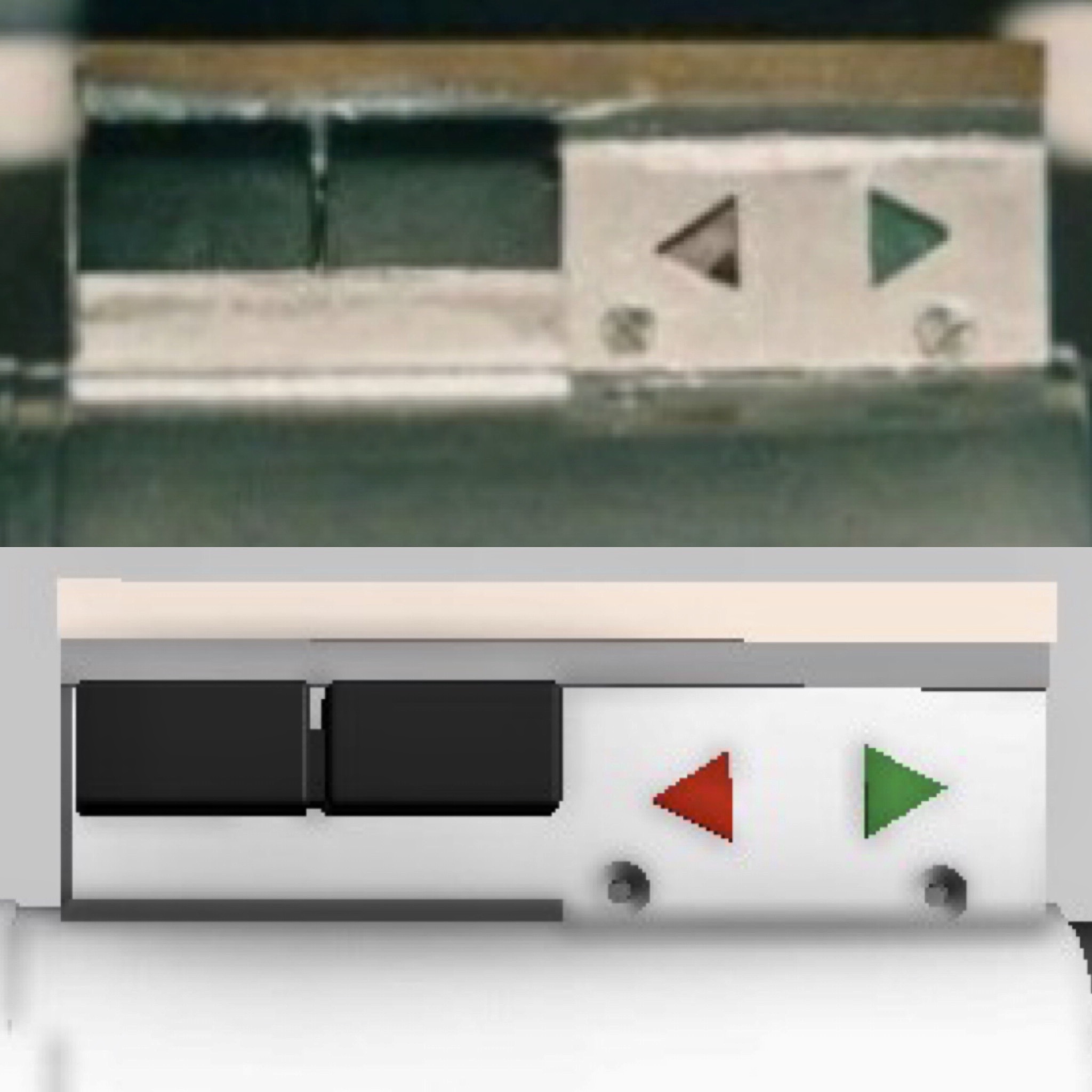

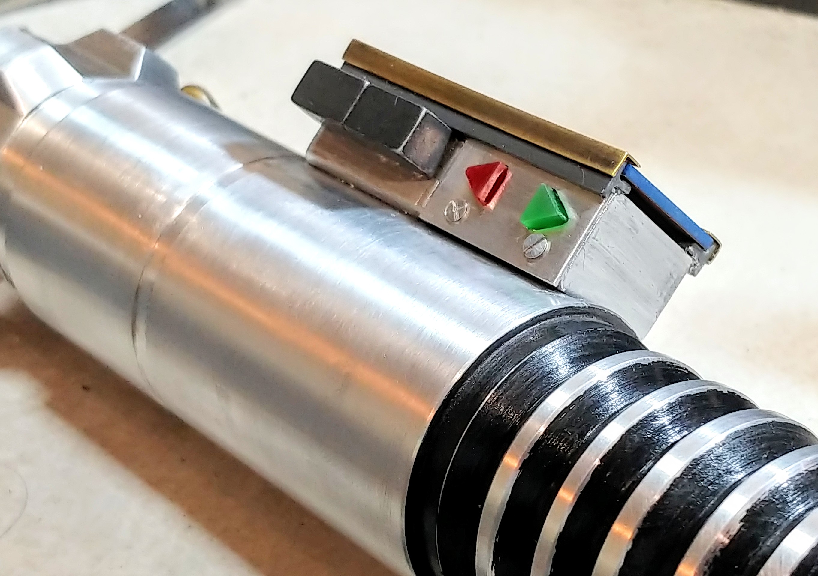

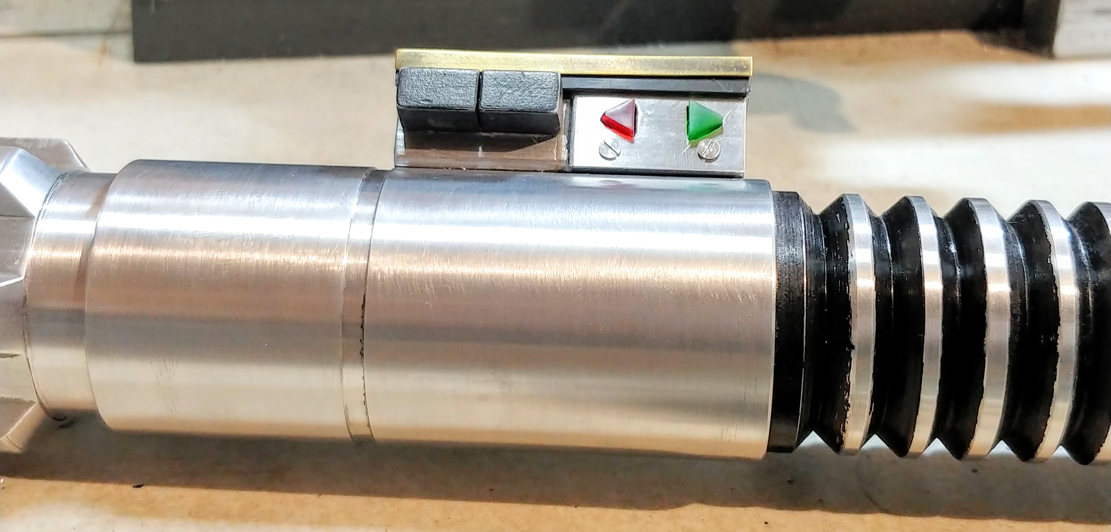

Do those arrows feel better to you?
This is with the ‘canon’ arrow faceplate including tilted/skewed arrows
They look great. The screw holes look to be a bit further away in the render vs the picture, although maybe it's because there is no screw in the render.
I see what you’re seeing.
Pulling out my magnifying glass and re-examining.

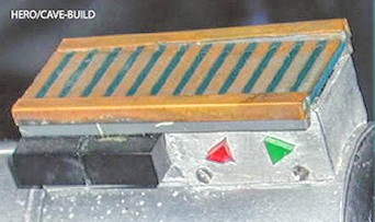

I’m just curious how the original arrow plate was made
Seems like a lot of work for the prop department
I watched a doc recently of ILM and how they made spaceships, and they used fiber optics, blinking sequences, etc in quite a few models. It made me a little more convinced this wasnt a PitA for them. the LEDs are big though! (deep)

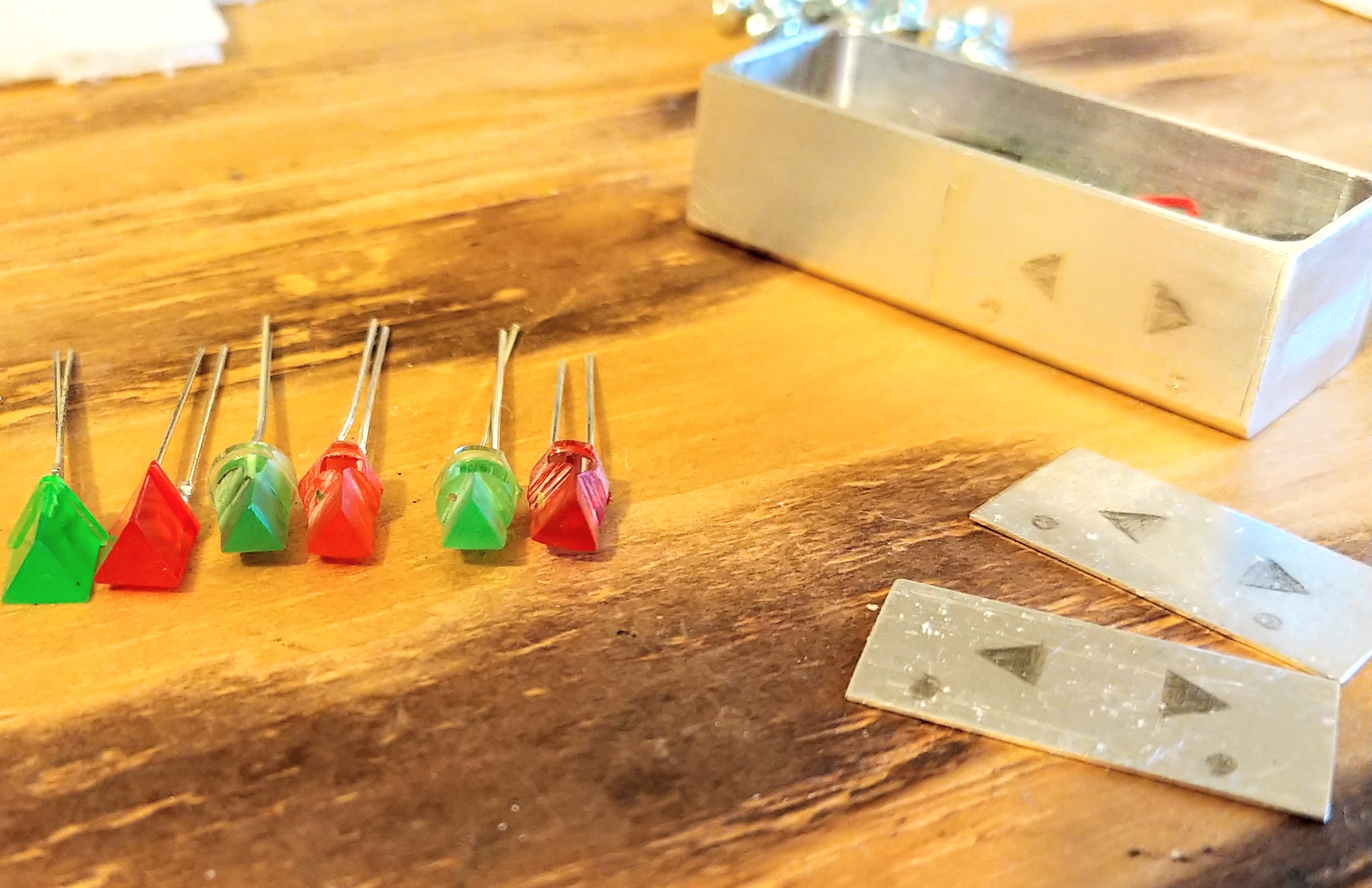

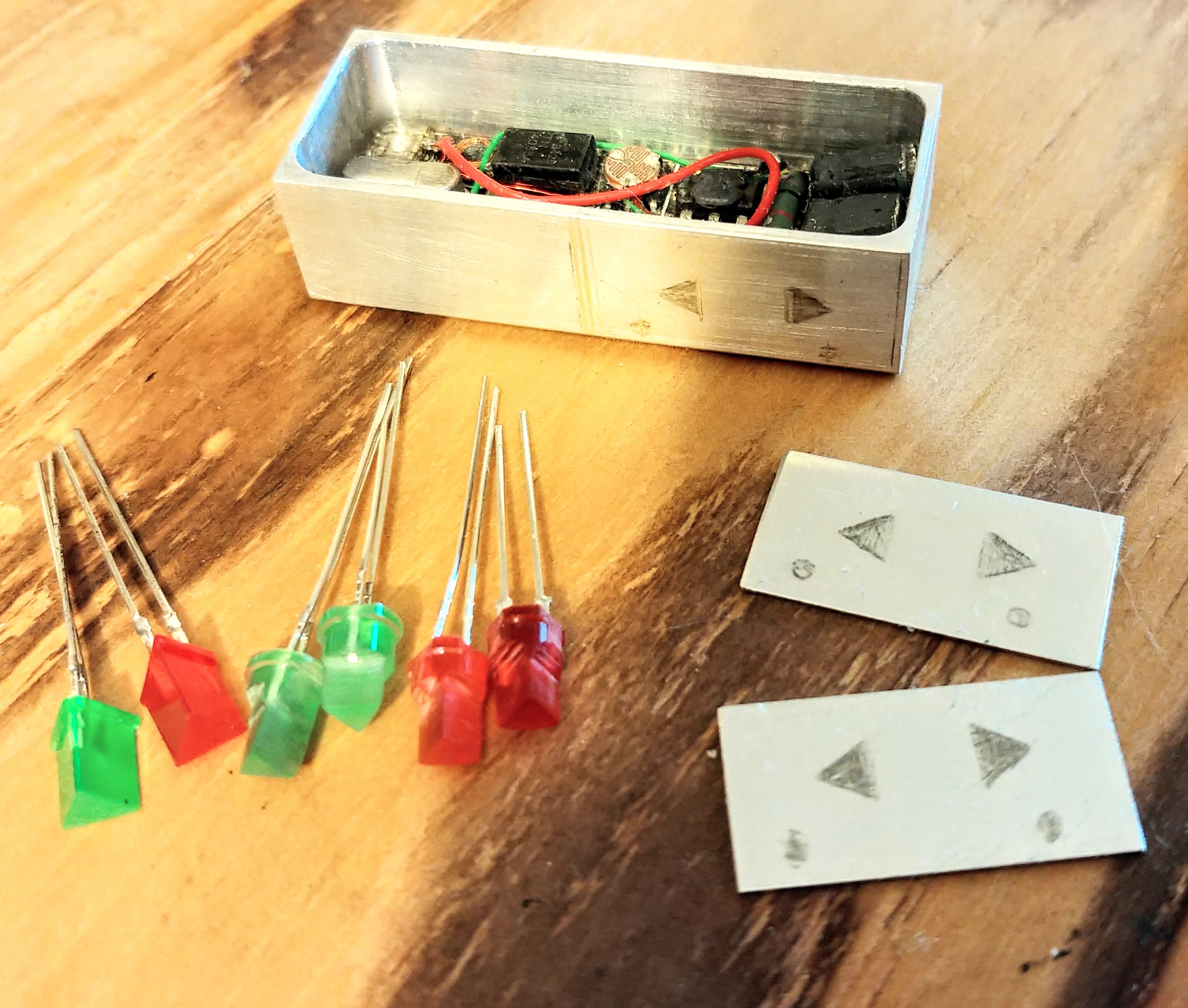

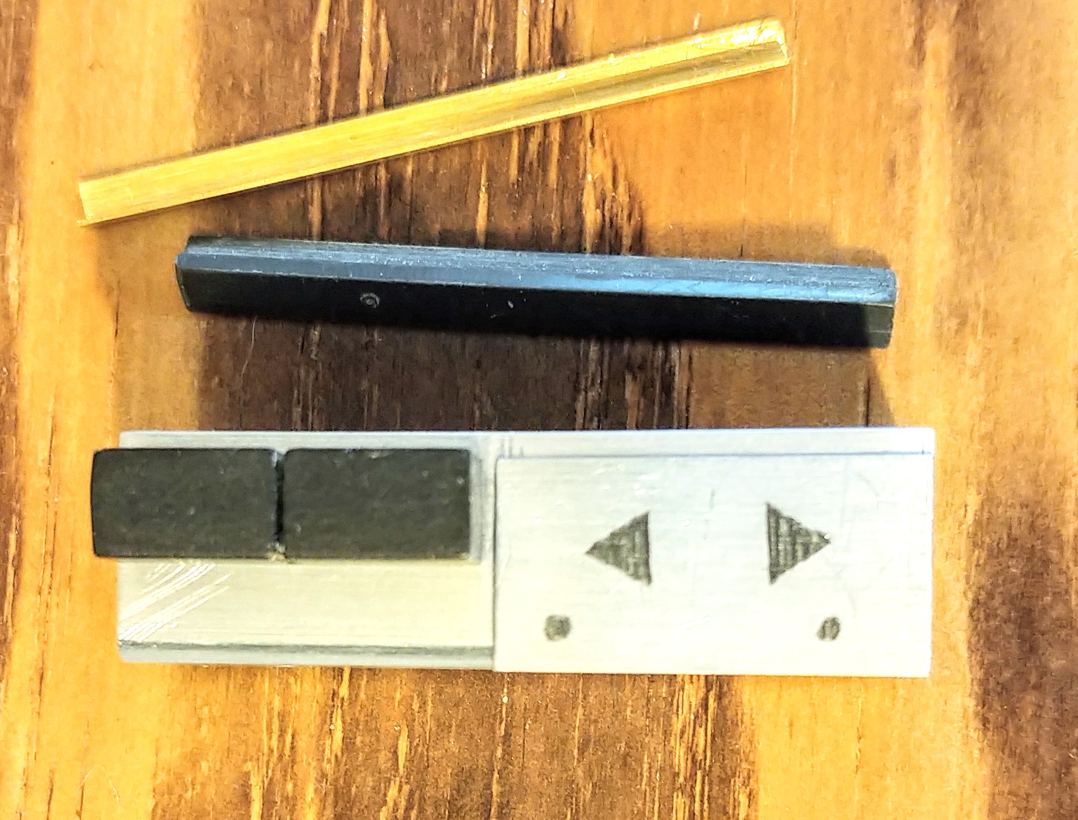

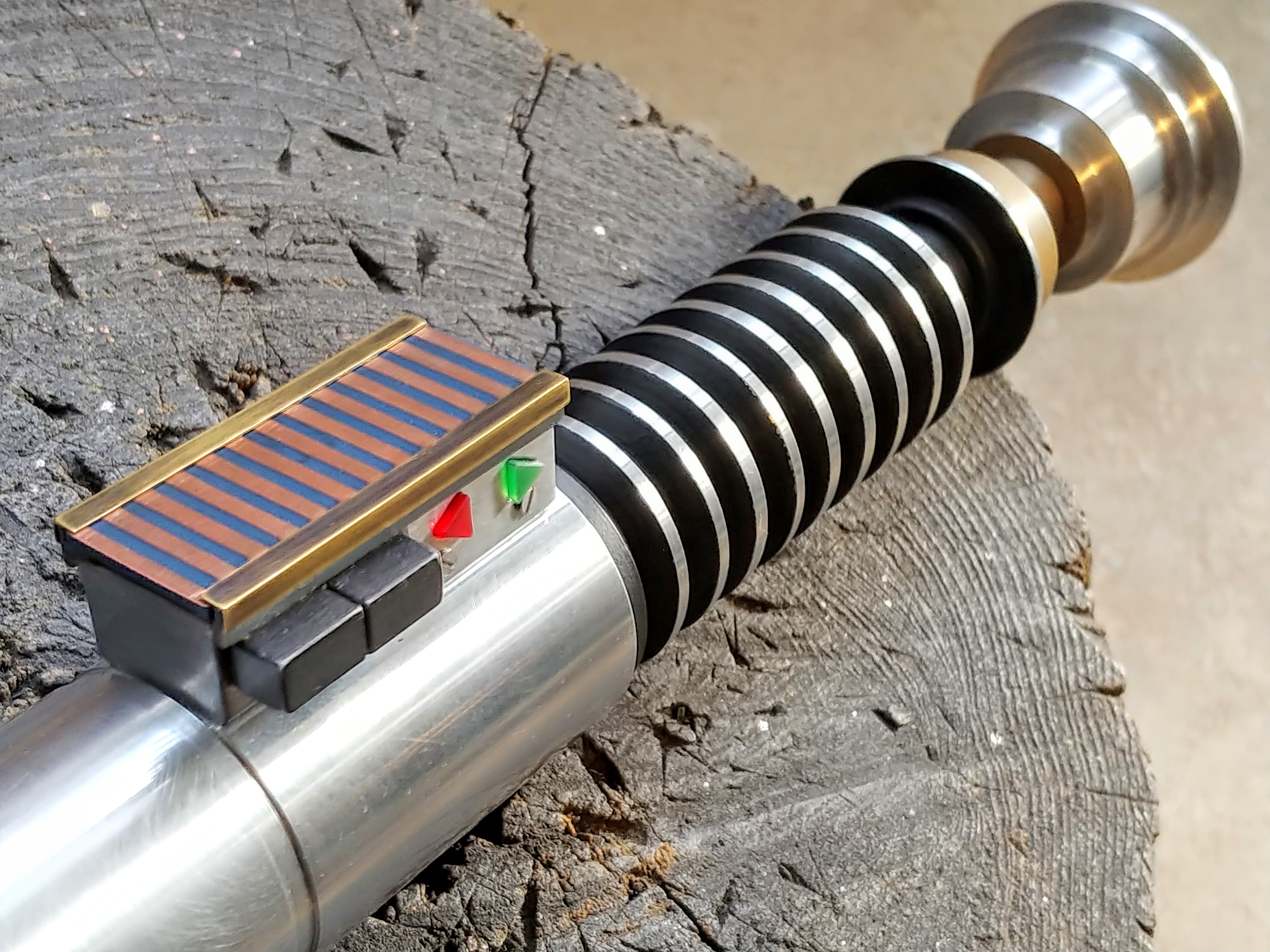

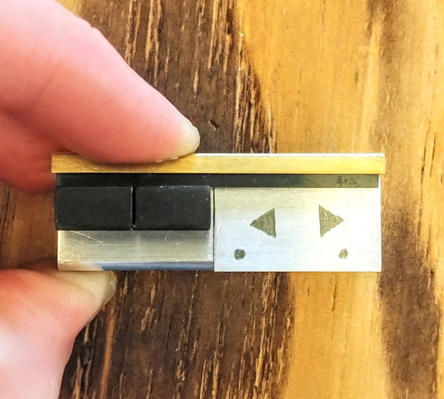

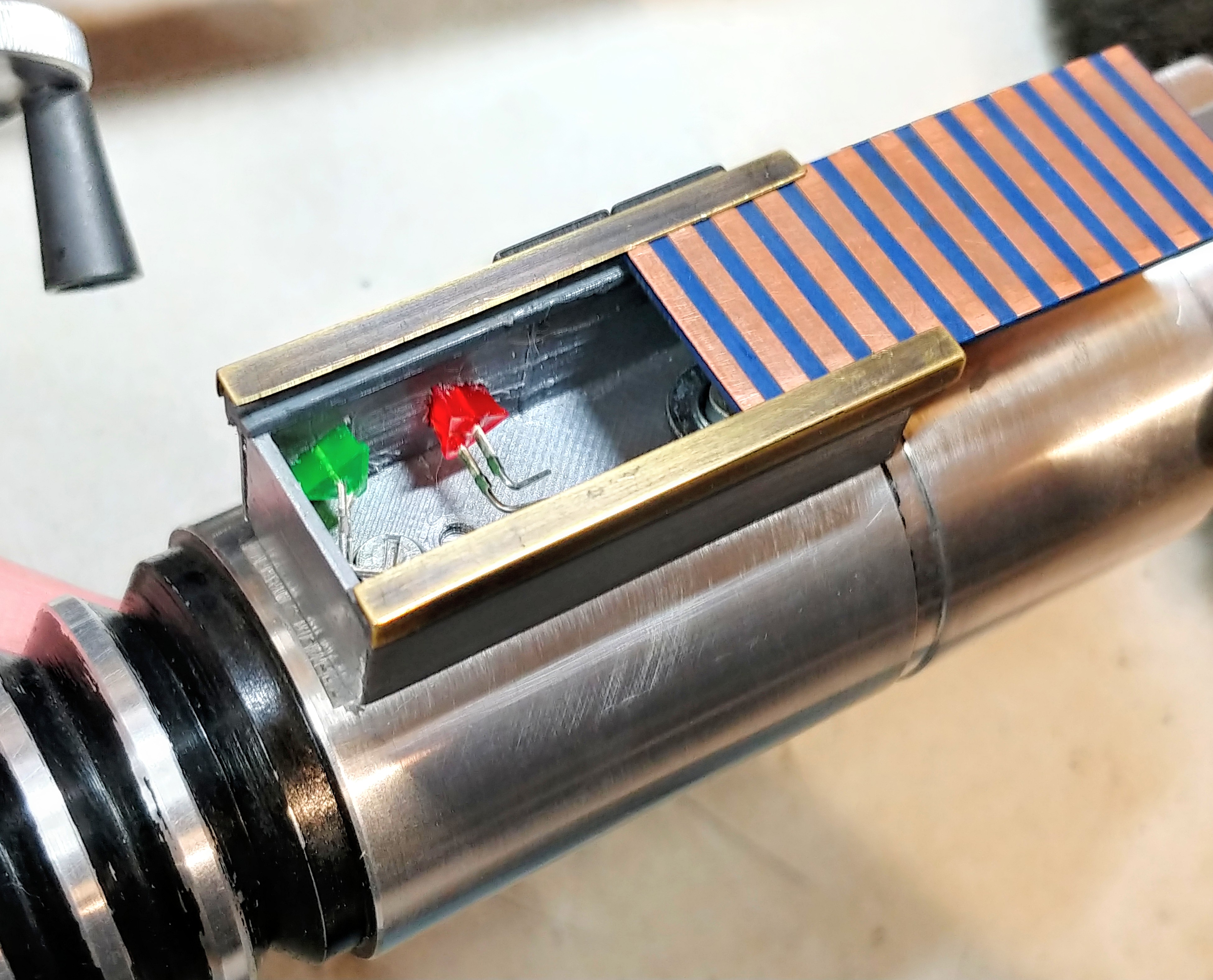

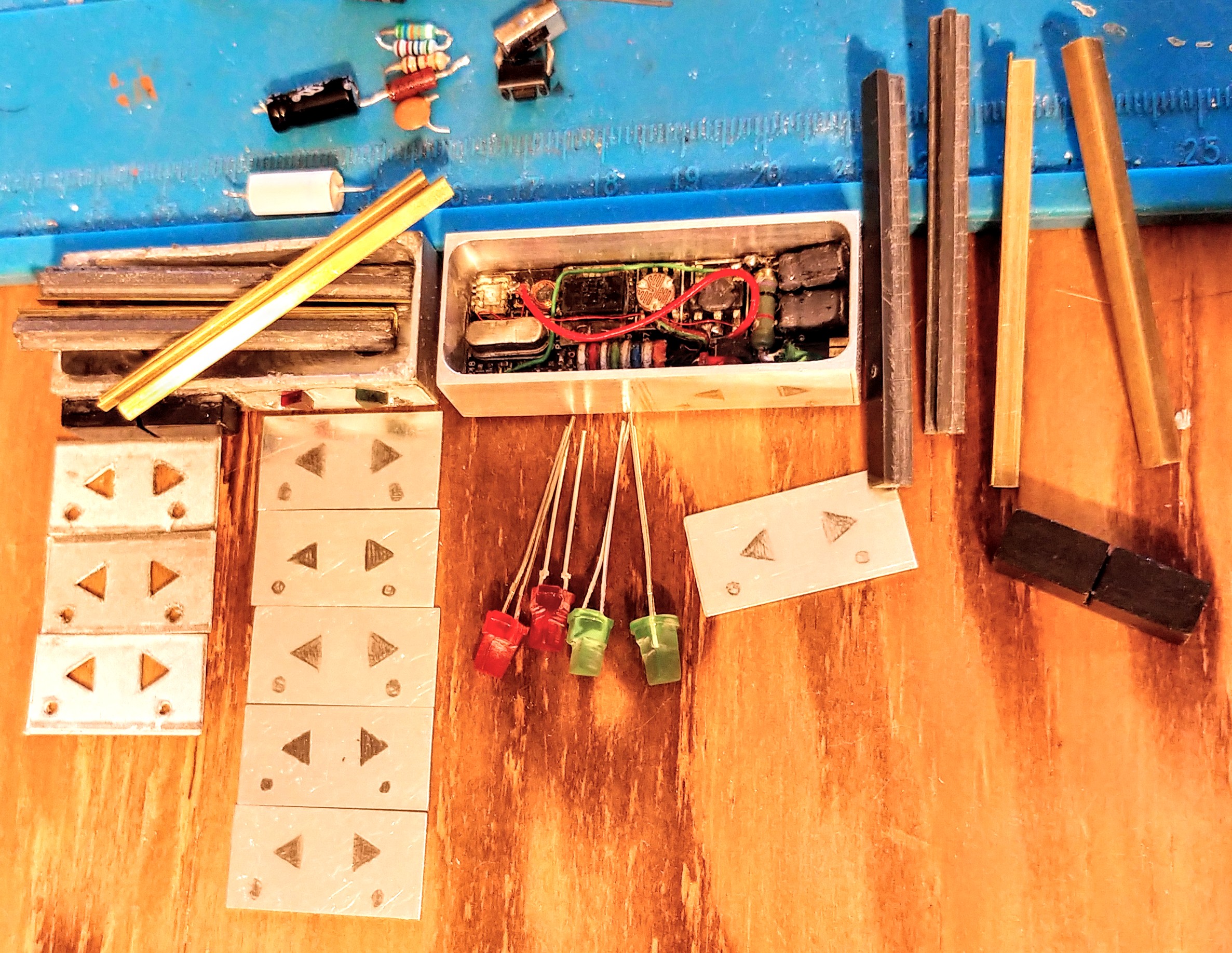

Here's where I'm at with the updated, more accurate plates. I made a few extra for if I screw them up.
Also, I'm starting to think these triangle LEDs are a little too large, so I tried my hand at modifying some regular LEDs.
And a quick mockup...
Aw man I just realized you have to mill a small amount off the box to get the triangle plate to sit flush!
I'm not totally sure it DOES sit flush.
EDIT: Now that I've bugged out my eyeballs some more, I'm beginning to think you're right, Tom. Though I'm still not one hundred percent sure, I'm beginning to lean that way. The bottom edge bevel certainly appears less prominent from that front corner.

Another question that I'm not sure has ever been definitively answered (at least I don't recall seeing any pics or reading anything about it) is whether a small section of the main box was cut away underneath/behind the plate. If so, how large is the cutout, and does it extend/reach up to the box lid, leaving only the cover plate for the rails to rest on?
I should also note the box has different bevels on each side, it's not symmetrical
or maybe it wasnt centered when they cut out the curve
noticed that on both casts I have
