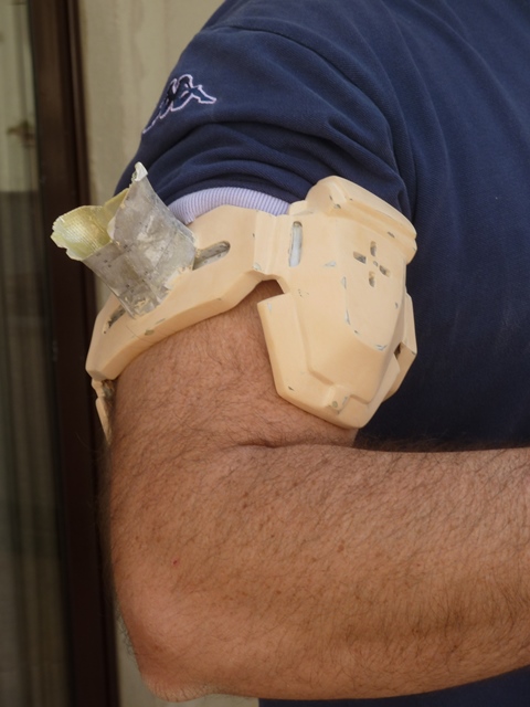

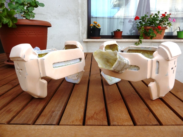

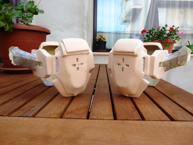

Assembled shoulder plates and biceps!!!!! The two pieces are assembled using two metal joints. The upper joint is glued and covered with bondo. The lower joint is fixed to the shoulder plates with 2 bolts, so that I can assemble them when I want to wear them and take the two pieces apart for storing:
How the two joints fix the shoulder plates and biceps:

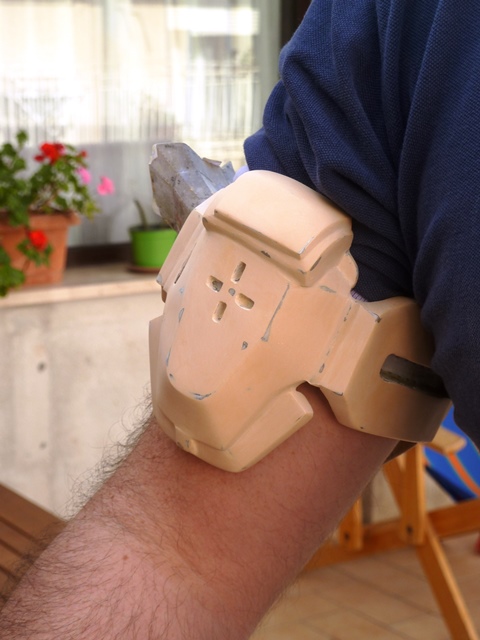

....and this is the result:
Shoulders_biceps_assembled_May2016 (4).JPGShoulders_biceps_assembled_May2016 (26).JPGShoulders_biceps_assembled_May2016 (28).JPG
