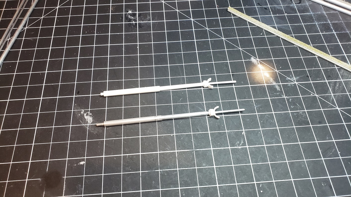

The one area I could not let go of was the guns, the plastic ones are off-center, tons of flashing, and I broke the tip off one of them just moving them arround.
So I took some of my aluminum rods and used the same process I had used on my 3D Printed 1:24th scale X-Wing and made some new ones, so much better!
