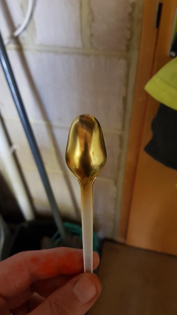

I've been having a play with getting a good gold effect. I think this combination came out best.
And next to my wedding ring for comparison
That's molotow sprayed at approx 17psi with a fine top coat of Tamiya clear orange x-26. The clear orange was thinned with Tamiya acrylic thinners x-20A at about 1:1, sprayed at the same psi. I was pushed for time, so it was a quickly run test, I will refine it a bit and take a bit more time.
I have found this method to be difficult to replicate consistently. The Tamiya paints just seem to behave differently every time i try it, and my airbrush hates it. Hell of a clean up job everytime.

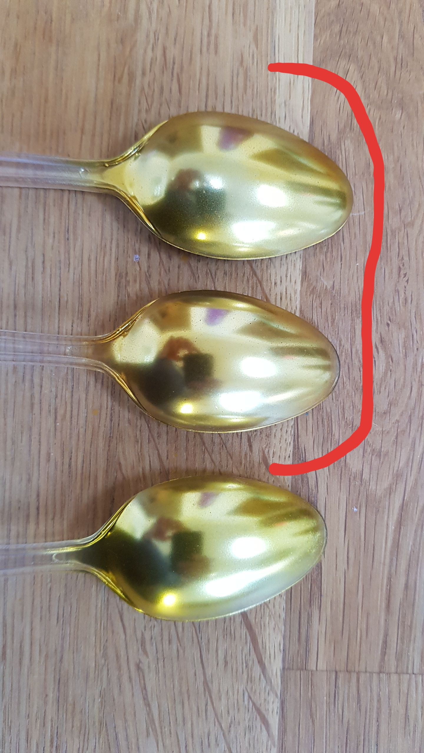

So Ive found Alclad candy golden yellow. This stuff is awesome.
Molotow, left to cure for a few days and a light coat of Alclsd Klear Kote to seal. Then hit with the gold candy yellow at 20psi from about 3" distance with fairly swift strokes.
The 2 highlighted spoons I mixed with Alclad transparent red just to play with it. That was 4drops red to 20 drops gold yellow. Its quite subtle but obviously can be altered to taste.

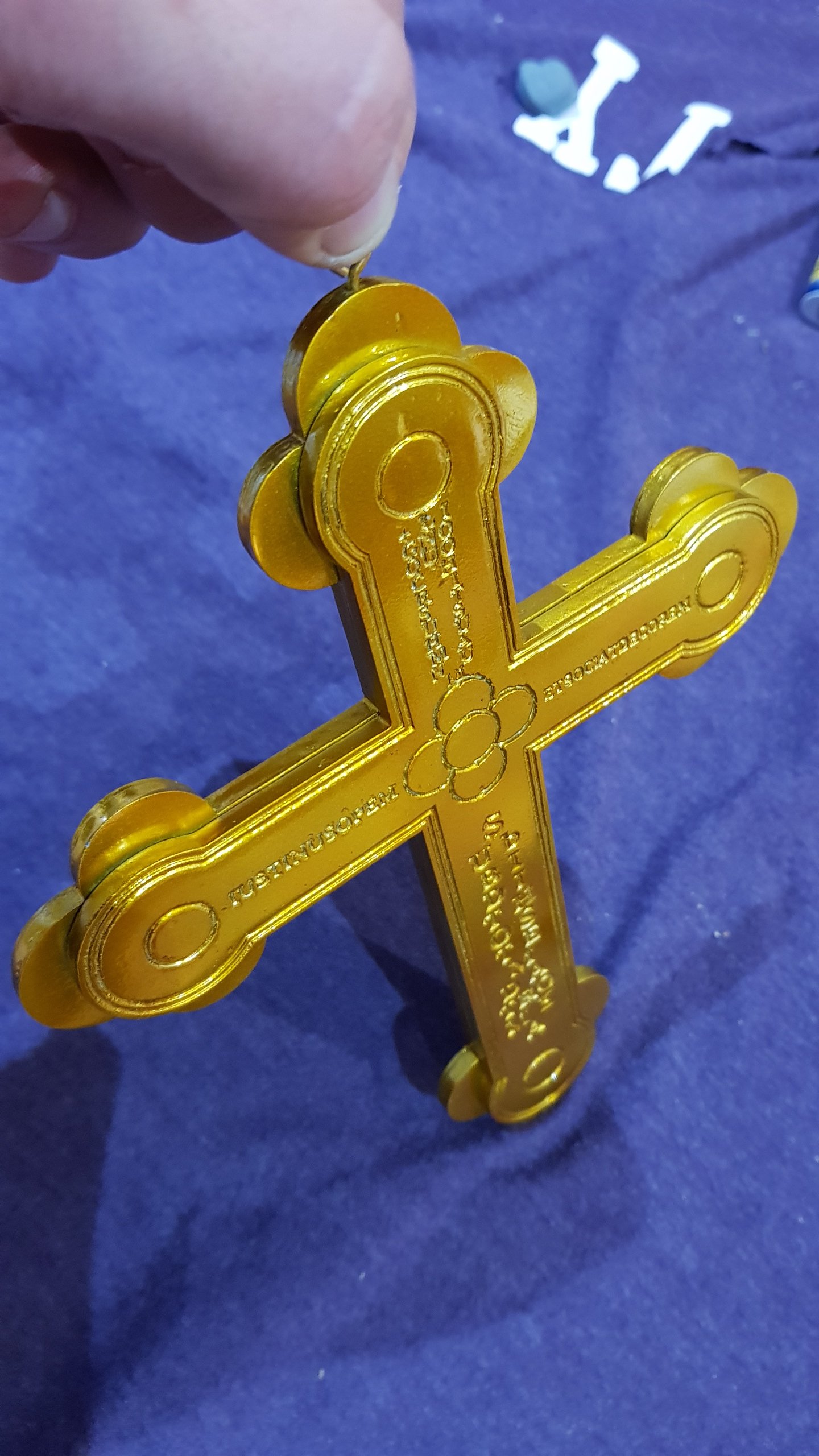

Ive just used it on my Cross of Coronado project and very happy with it.

Also used it with candy gold yellow (outlined in previous post) on my coronado cross project.
Hey! I know this thread is a bit old, but I was wondering if you could give me some advice here, the gold color on your cross came out phenomenal!!
So you hit it with Molotow, cure for 2 days or so, hit it with the candy gold by Alclad and let that dry? Or do you clear that candy gold as suggested? Do you think I could add a drop of green to that candy gold to bring out a richer gold tone? Thanks a ton man, again this came out awesome!!

I did clear coat the candy gold finish, with alclad KearKote 2 gloss. As someone said earlier it may not need it as the candy gold is enamel. Definitly experiment on a couple of spoons first. It doesn't harm the finish as any shine that will be lost from the Molotow will be lost at the candy coat stage and is minimal.
I added alclad transparent red to play with it and it had no adverse effects to the finish. It mixed perfectly fine together. I think if you used a transparent green you shouldnt have any problems. I dont know for sure, and would defer to anyone here with more experience, but I would worry that a non transparent paint mixed in may effect the translucency of the candy gold.
I'm not big into paint or know a lot about compositions etc so I try to keep everything the same, in terms of brands when I mix colours. Alclad do a transparent and candy green, so I would think they will work.
Please post any results if you try it, would love to see how it comes out.

When you say you “highlighted” the spoons and did the mix as shown above, did you mix the red into the candy gold layer, or mix it into a clear coat and apply after? Again thanks a ton!
I mixed the red into the candy gold.
By highlighted, I meant the 2 spoons that I bracketed in red in the pic.
