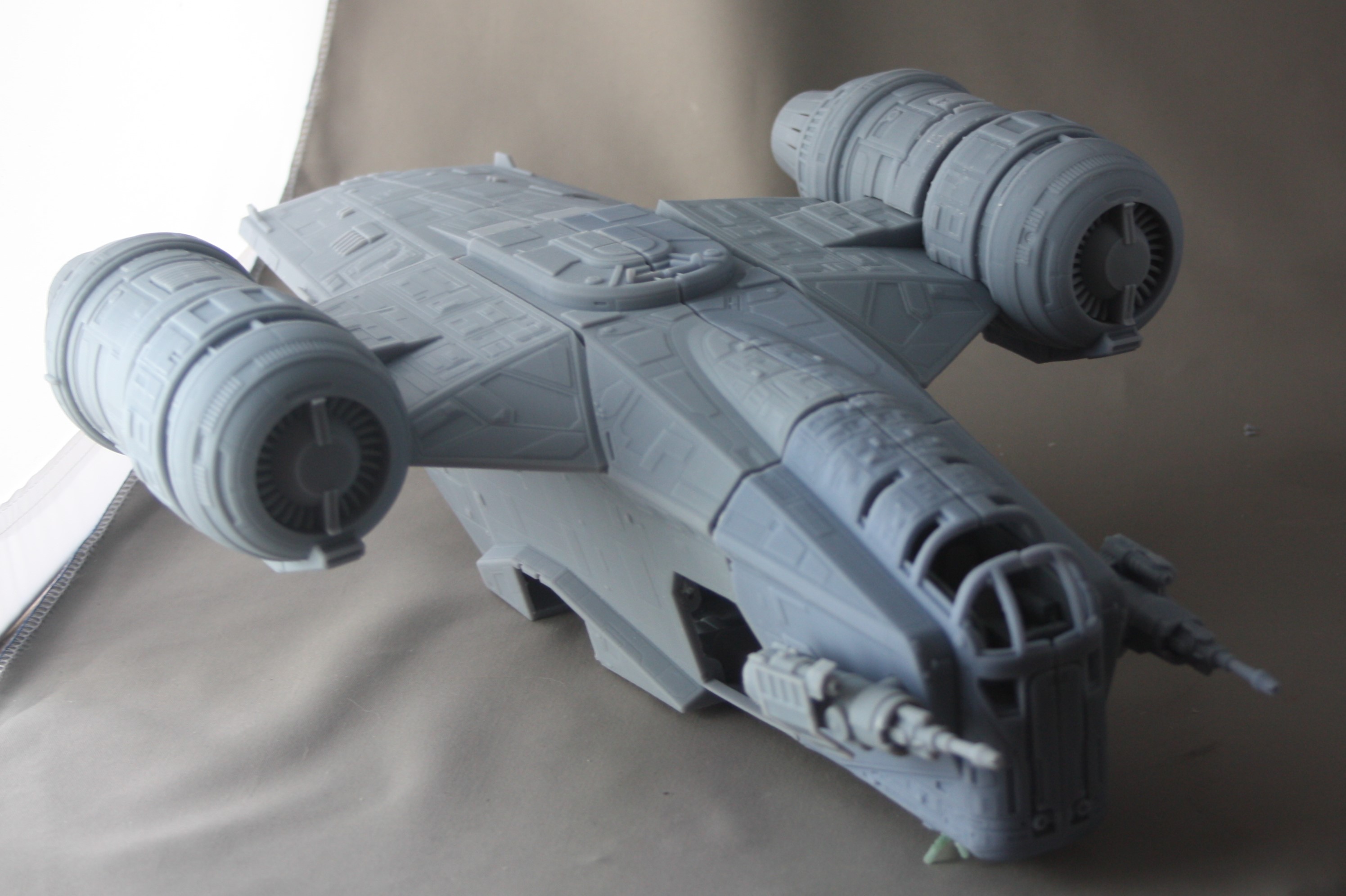

I upped the exposure to 10 seconds and without changing any support setting that seems to have fixed one of the problem areas where it was splitting. After doing so the other side turned out prefect. Thanks for the advice!
I have to reprint the one turbine section that split still, but for now this is where I am at...

The print is great quality in that I do not have to sand smooth parts since the layer lines are virtually non-existent. Due to the limit of my build plate size I had to use the stl files that were split in smaller parts rather than the ones that could print the body in whole sections instead of divided in half lengthwise. That also limited how I could rotate parts for supporting which in affected how some parts print and ultimately fit together

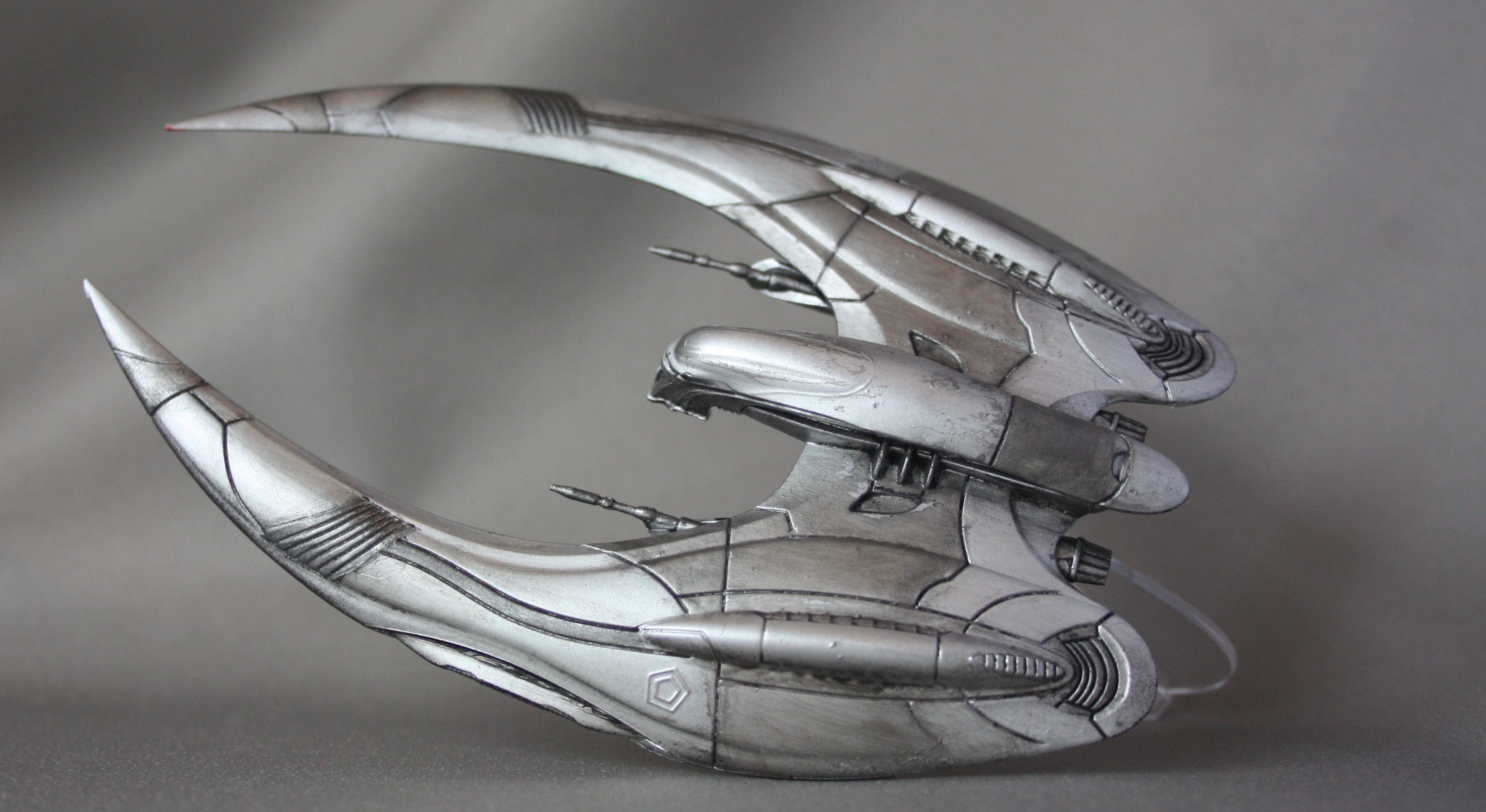

Th darker areas here are the Gun Metal and the lighter ones are the Gloss Aluminum
I also added some oil paint washes and pastels which dulled it down a little
This one is the Gloss Aluminum

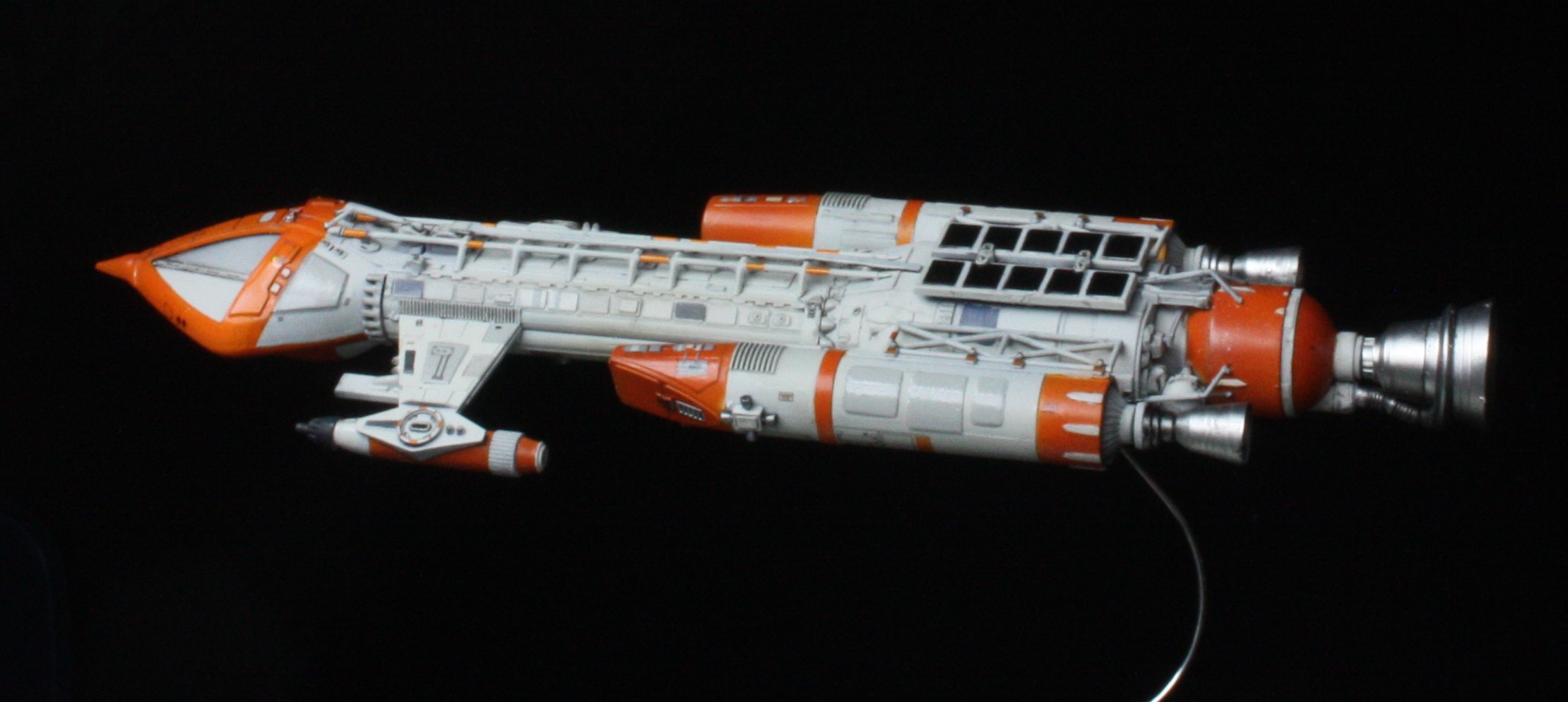

the engine bells on here are Spaztik Chrome
It works best over a black surface, and the more gloss the surface, the more mirror like your finish will be
Personally I love how it looks over a matte black. Just shiny enough to be reflective like metal, but not overdone mirror like chrome which can look out of place on smaller scale models
And surprisingly it is pretty durable. You can mask over it without issue (at least with Tamiya Masking tape)
Space 1999 Hawk Mk IX

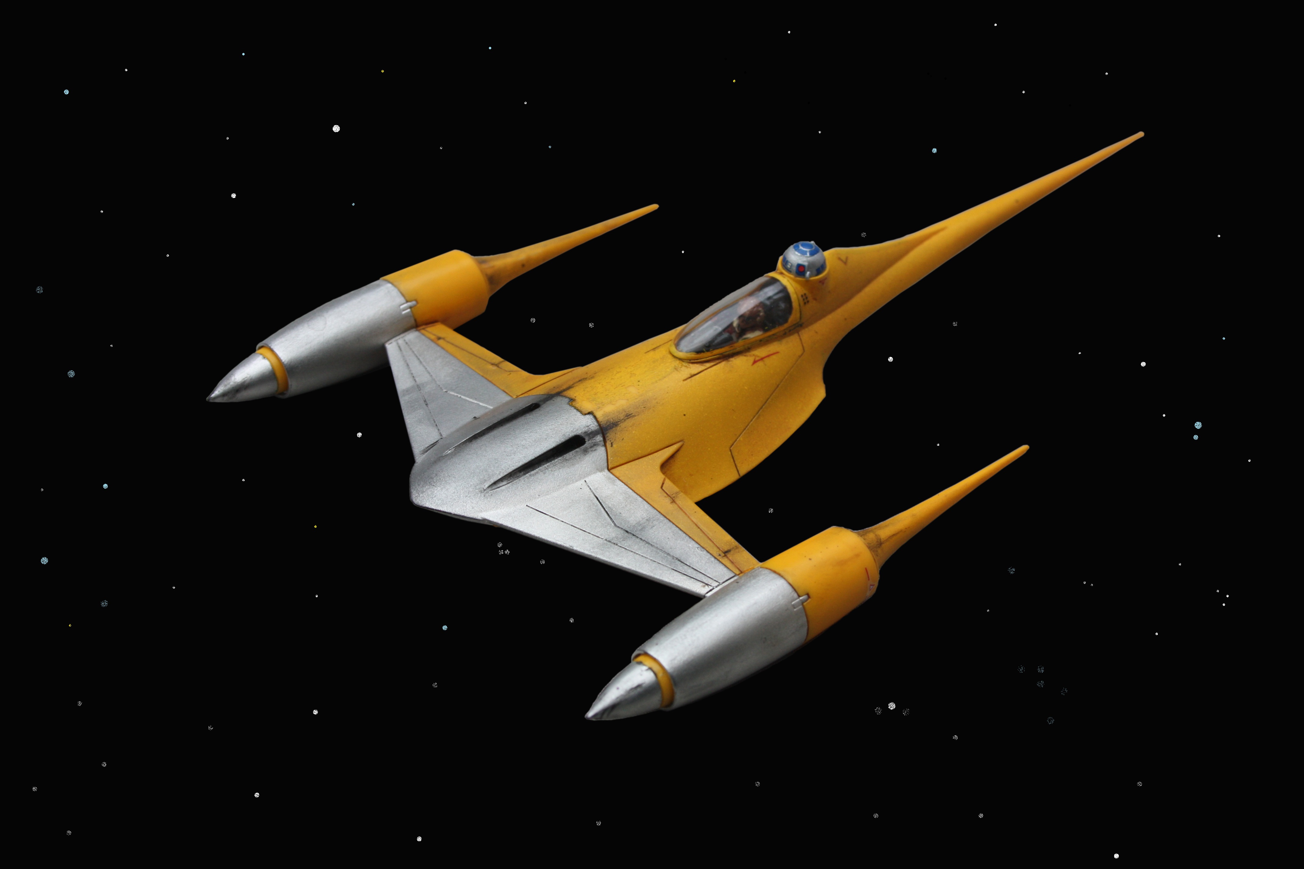

And the front of the Naboo star fighter is with Spaztik Chrome
N1 Starfighter 02

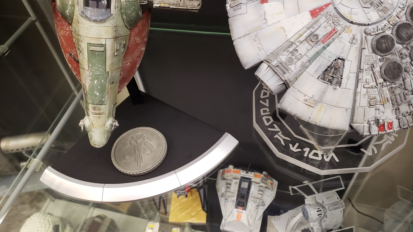

I just updated the base last night for my Slave 1, here is the Rust-Oleum Silver along the front of the base:

The N1 is the Spaztik Chome. It is a little more reflective than the Tamiya Aluminum
