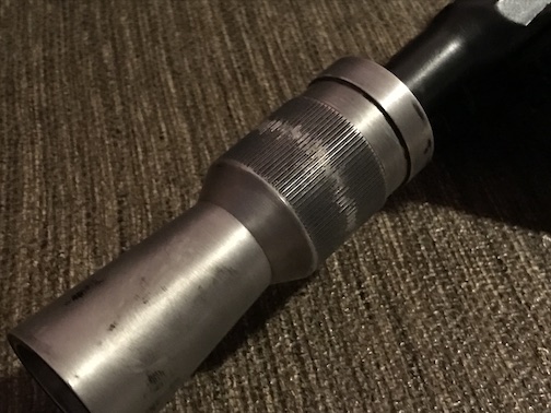

Good point, I forgot haha. I do want to! This anodizing is tough, are we talking sandpaper?
I'd go gently with a file at first, to remove anodizing a little quicker in certain areas.
Then yeah, maybe some sandpaper. To even things out.
I did most of my weathering with a file, though.
thank you! I'll try this out tomorrow :)
by the way those Numrich grips have a couple problems. 1) they're not as long as the Denix grip length and 2) the screw hole doesn't line up. I chopped out my cross brace so I had a fully open grip frame like a real gun/MGC That way I was able to close some of the gap on the shoulder of the grip area and shape the inner step.
Sometimes I'll even use the back edge of an exacto to remove paint and finishes in smaller areas, like the knurling, and other edges. I just scrape it away real careful like.

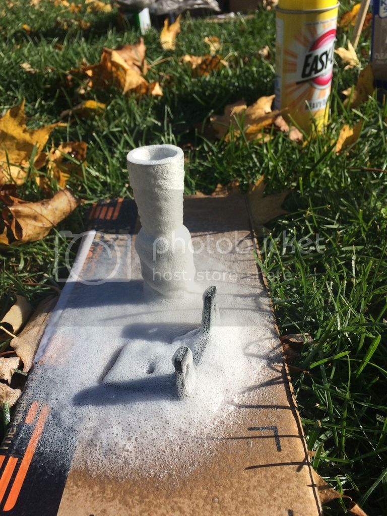

the anodize is tough!! i tried the oven cleaner trick to remove it and it didnt even budge! it turned it purple and had black circles everywhere. i can to sand it smooth, then paint
