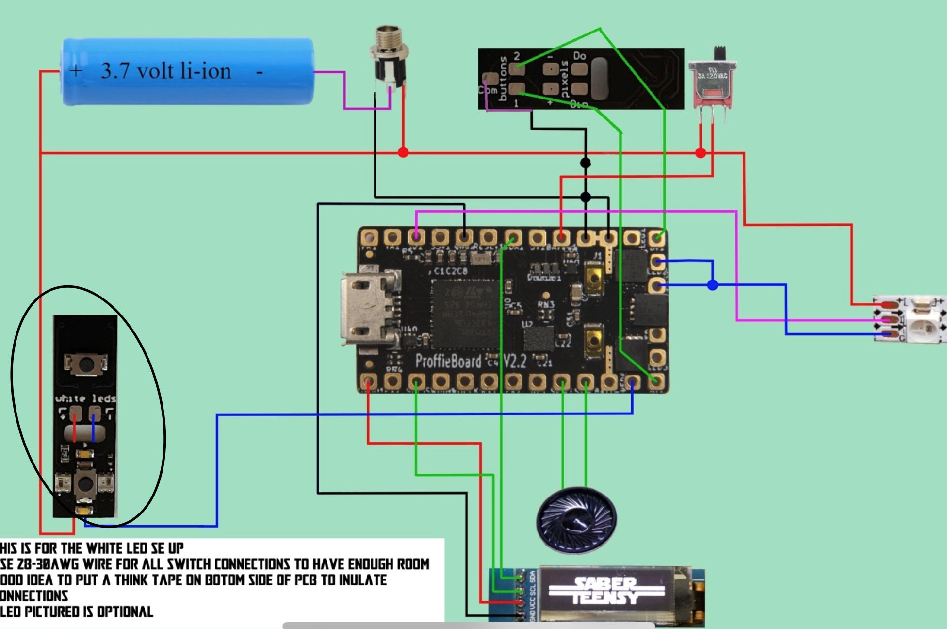

Hope all well, i just finished wiring my Saber Bay Darksaber and i have just a small question regarding the config file for the switch LED (Circled here on the diagram).
For the moment it doesnt light, so i guess i need to add a line in the config file. Would anyone help me giving me the right line to add to make it work ?
the saber is wired exactly as the diagram.
Here is as well my config file, all works perfectly except those tiny LEDs that don't work.

Quick question, on the switch PCB, if I’m also using the white leds (and it’s pads on top), does that change in the config to a RGBW or keep as RGB?
If your using the white LEDs they are standard LEDs that require + and -. No data required for a standard led so rgb or rgbw has nothing to do with them.
They are off or on in patterns set forth by your sound board .

Ah ok so they just go along with the other RGB LED's. Gotcha. Thanks!
This are mostly called accent LEDs in most manuals
can i simply connect the white leds + and - to 5v and gnd of the proffieboard? i would like it to be always on fixed when the proffie is on :)

On the installed version is there a setting to make the blade light up constant white without flickering? I've gone through all the sound/FX selection options and haven't found one.
Also, after I scroll/light up; and then fully retract the light in the blade (using the primary round lit button) until the blade is unlit, if I click on the secondary (black) button one short press the blade scrolls/lights up blue with no sound effects and the light only extends about 75% from the base to the tip of the blade. This happens with all of the different sounds selections. Is this normal? Thanks
Not sure about your first question, but that second function you mentioned is a battery life indicator.
