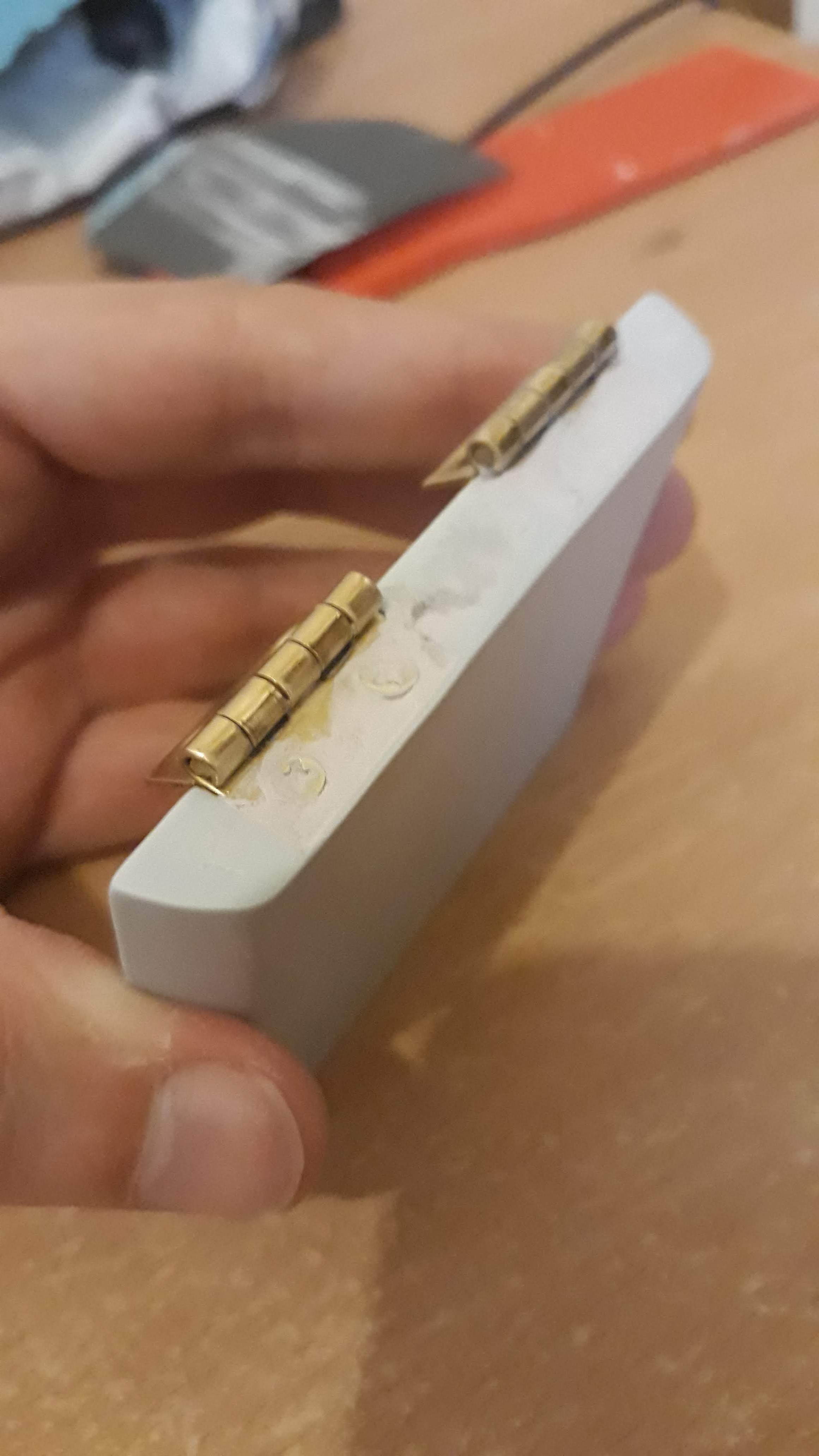

With that now in the post, I've started to get the door hinges putty filled in and sanded - I'll use this door for a static medical tricorder, and the other for my working science prop.
Pass one of putty came out nicely and very smooth after sanding. I reckon I'll need 2 more passes to completely cover the hinges and level it out.

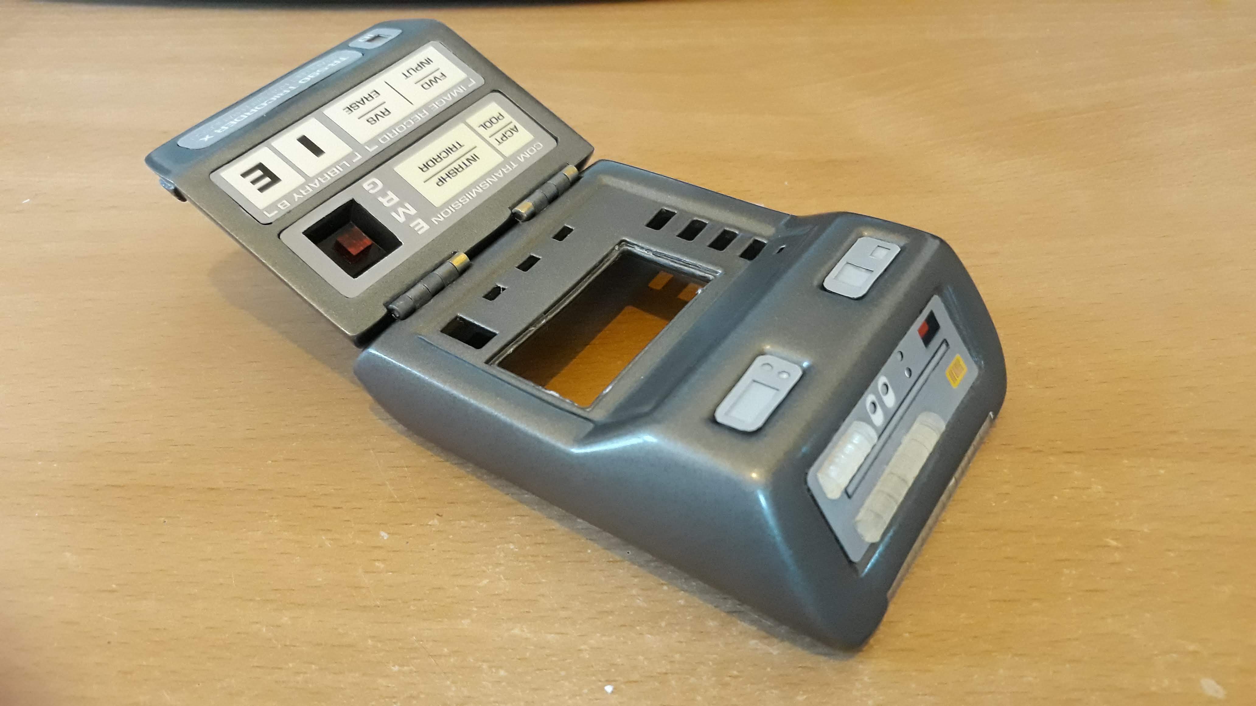

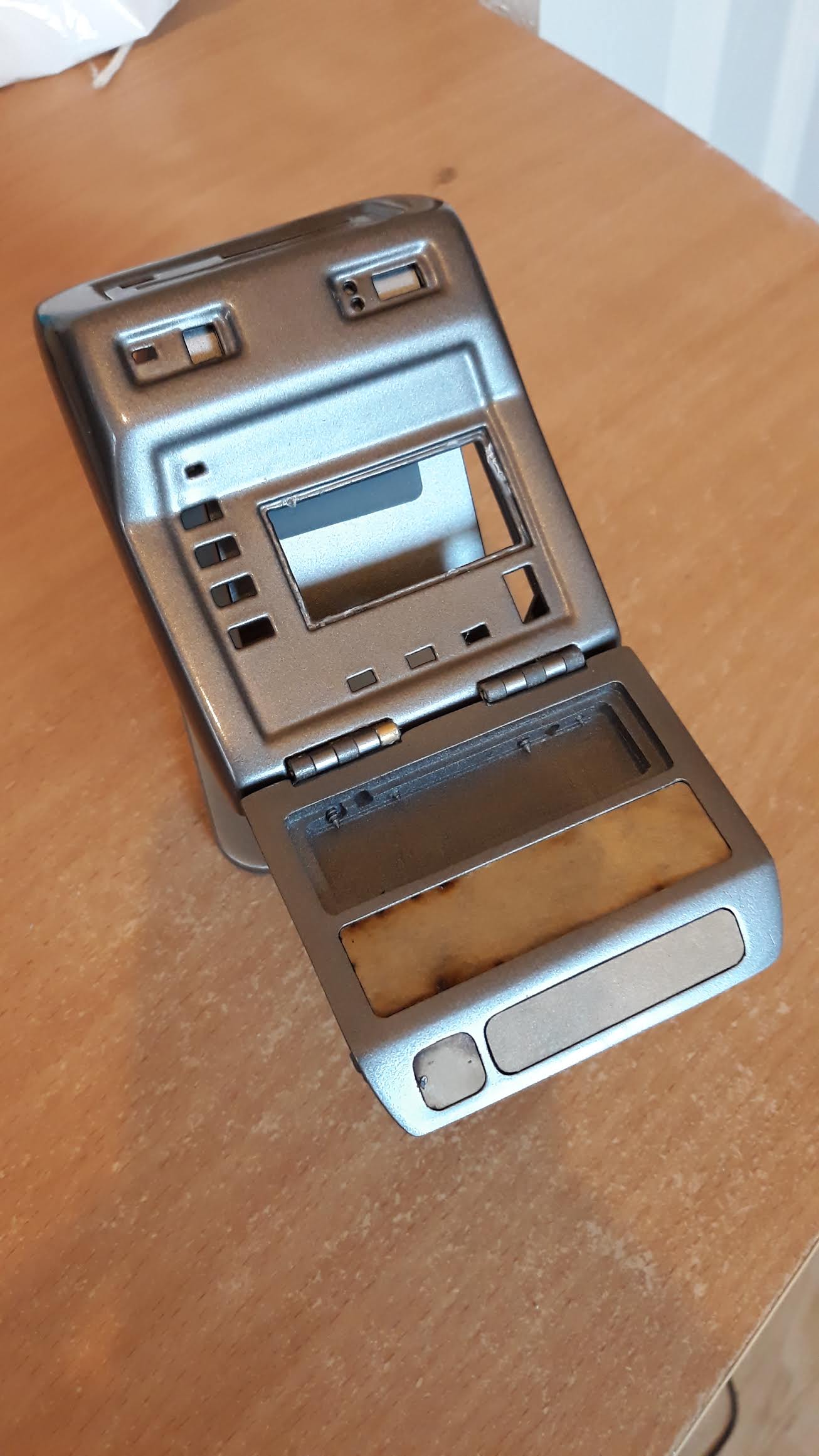

So good news and bad news...
Good news is that I got the door and hinges filled, primed, painted and attached to the body.

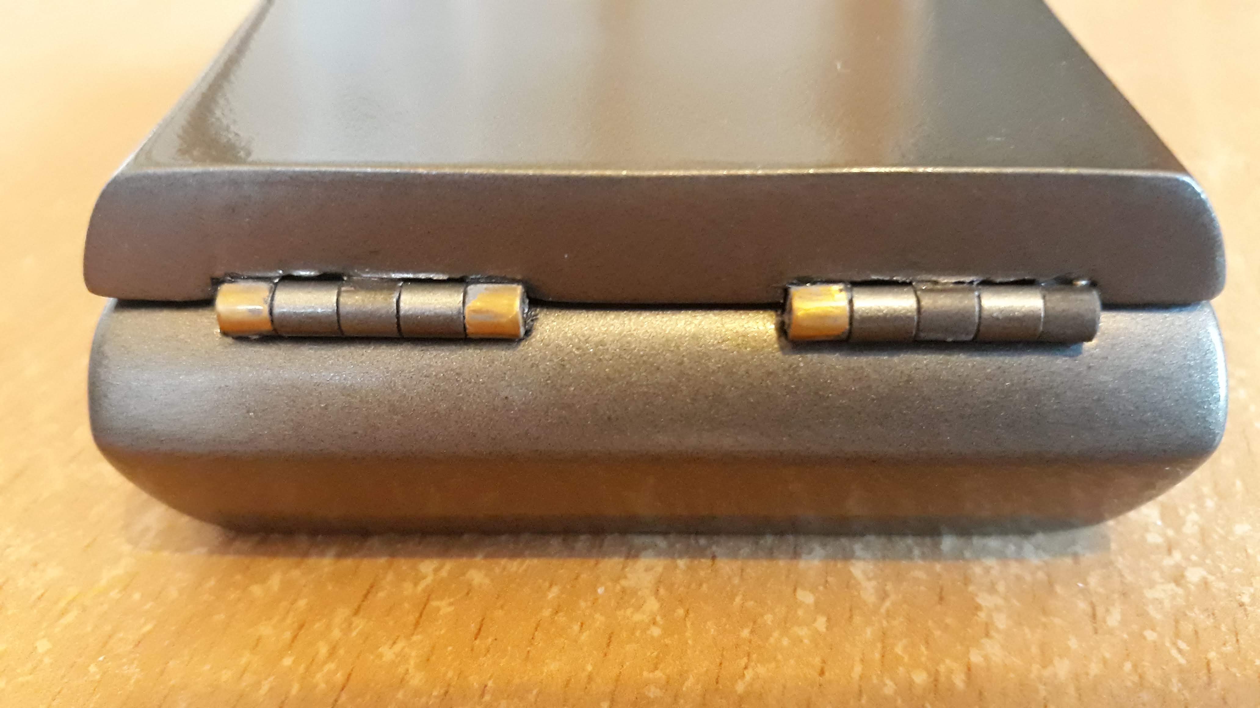

The bad news is that after a few open and closes, it started to wear the paint off certain bits of the hinge:
Obviously I've learnt from my mistakes and will know how to resolve this for the next kit (which is on it's way). But unsure how i fix this on this kit now it's all attached and lacquered.
Any ideas?
I managed to use a fine flat screwdriver to create a slightly larger gap between the hinge adjacent resin - which (for the most part) solved the problem after I resprayed the hinges external hinges. I just need to respray the internal ones that are visible as brass in these images.

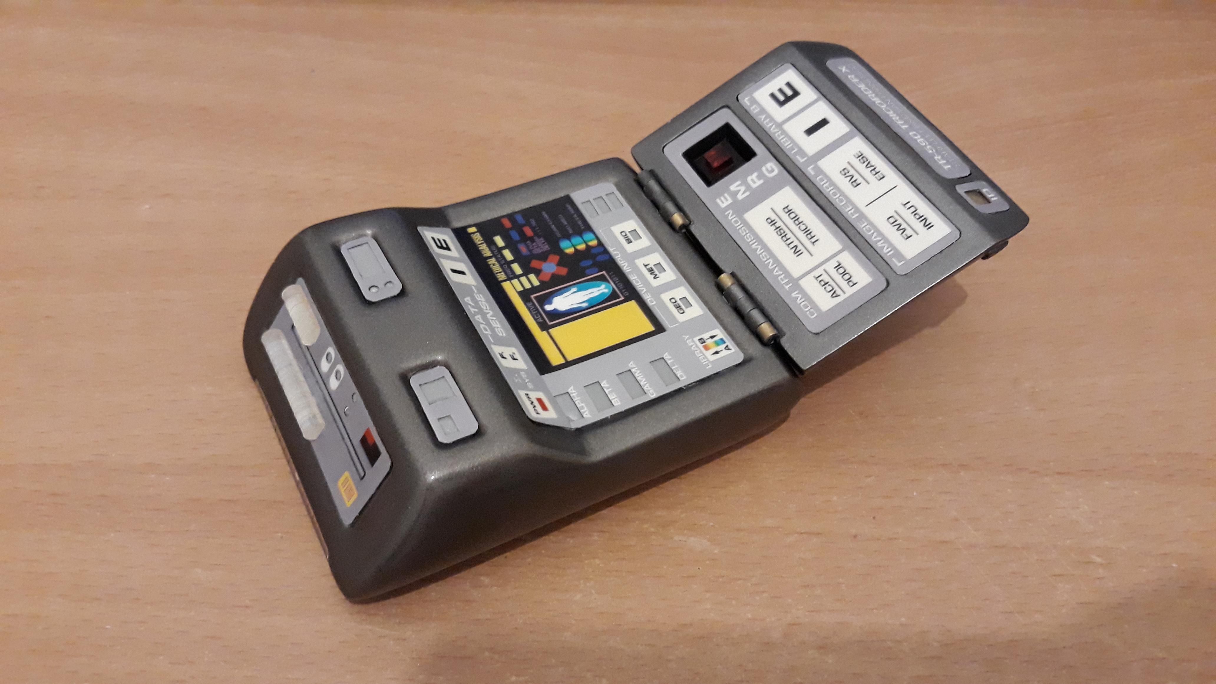

I forgot to take photos - but now that I've got another kit in the way I've moved forward quite fast as this is now a static Medical Tricorder prop.

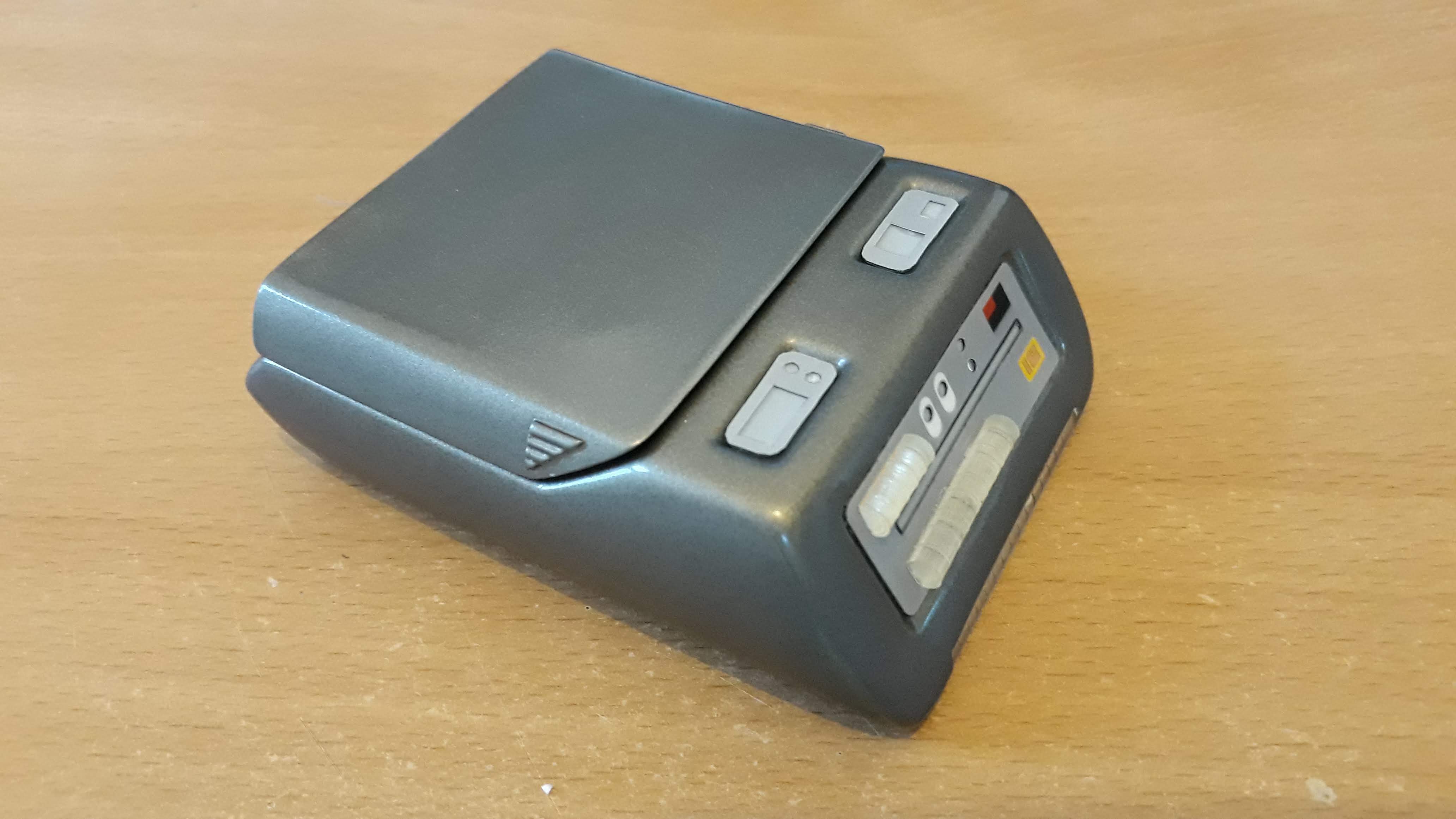

I had a couple of mistakes when gluing in the buttons, and got it on the paintwork. Another lesson to learn - don't use superglue that dries instantly when pressed! I'll definitely be moving to an epoxy glue next time, possibly a two-part with harder.
I've been able to sand the mistakes down, so will just need to re-lacquer. I'm going to wait until the whole thing is finished before doing that so I can give the buttons a protective coat. That said, I'm going to test it on one of the spare TR-590 labels to make sure the lacquer doesn't have an unexpected reaction before I do that.
I've noticed that the EMRG keypad is slightly lower than the others. But I've not fixed that one in, so I can raise it up a tad. I've also fixed foil behind the EMRG red button so that it reflects a bit of light.
The door looks more blue grey than the body in this image but I think it's just the completely flat vs slightly rounded surface.

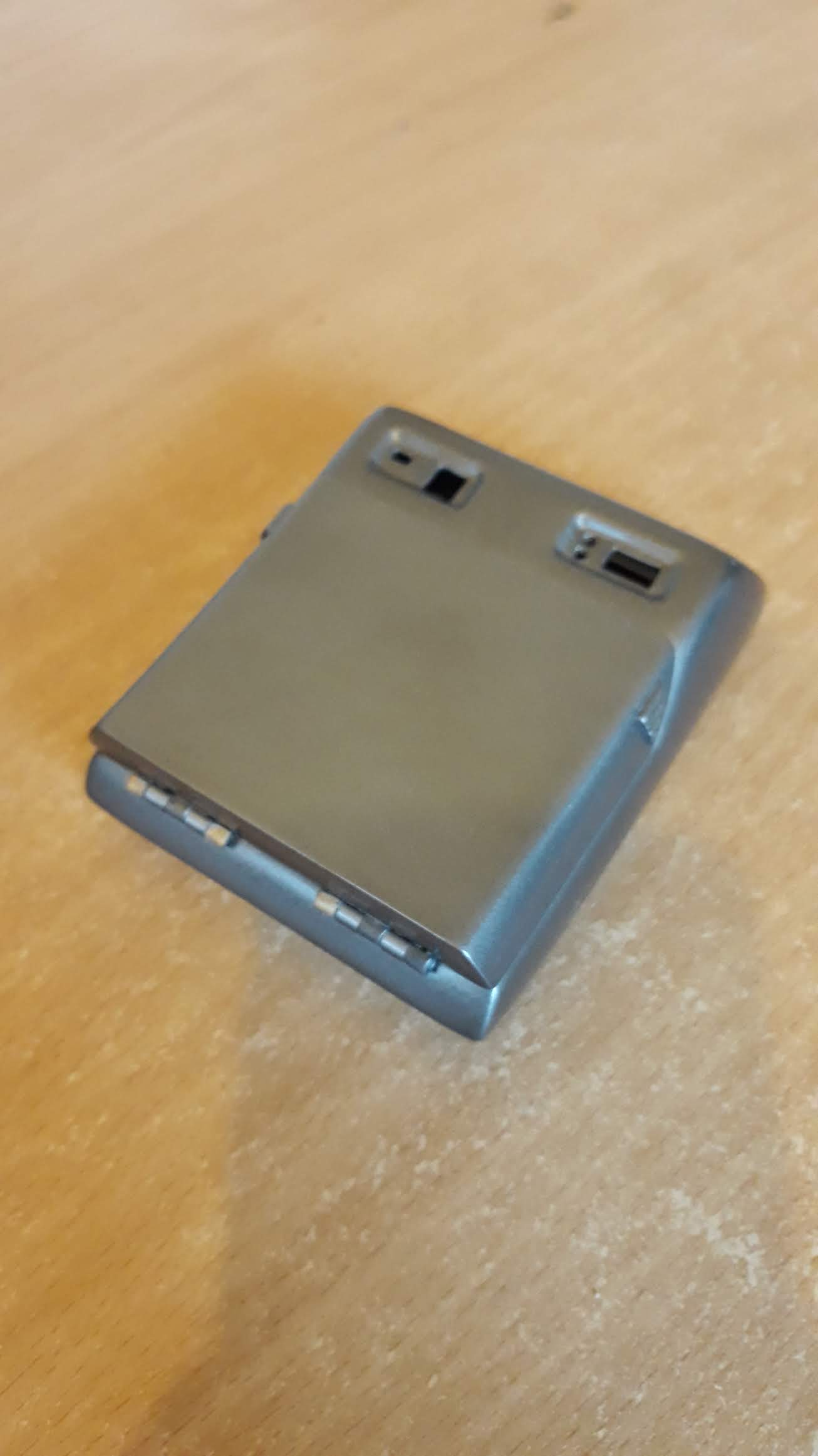

So I just got my medical tricorder kit and used it to finish off the main bits (with the exception of the hand scanner).
Now I'll turn to what will be my science tricorder which will include electronics. I plan to most of the work while installing the electrics so I'm very limited to what I can do right now. I'll start by attaching the back to the main body. Having learnt from my mistakes I'll be using a 2 part epoxy resin glue.

Also, you mentioned knowing how to fix the hinges being stripped of paint for your next build - what are you planning? I'm anticipating the same problem, so advice to prevent it would be great :D

For the hinges, its just a matter of sanding the resin around the bits where the hinge knuckles touch. I'd recommend having at least a 1mm gap between the hinge knuckle and the resin so the paint build up still doesn't touch it. I'd also suggest masking off and spraying the hinges separately. I ended up not having primer on them - just the paint. It seems to take well (as I gave the hinges a quick rub down with 800 grit).

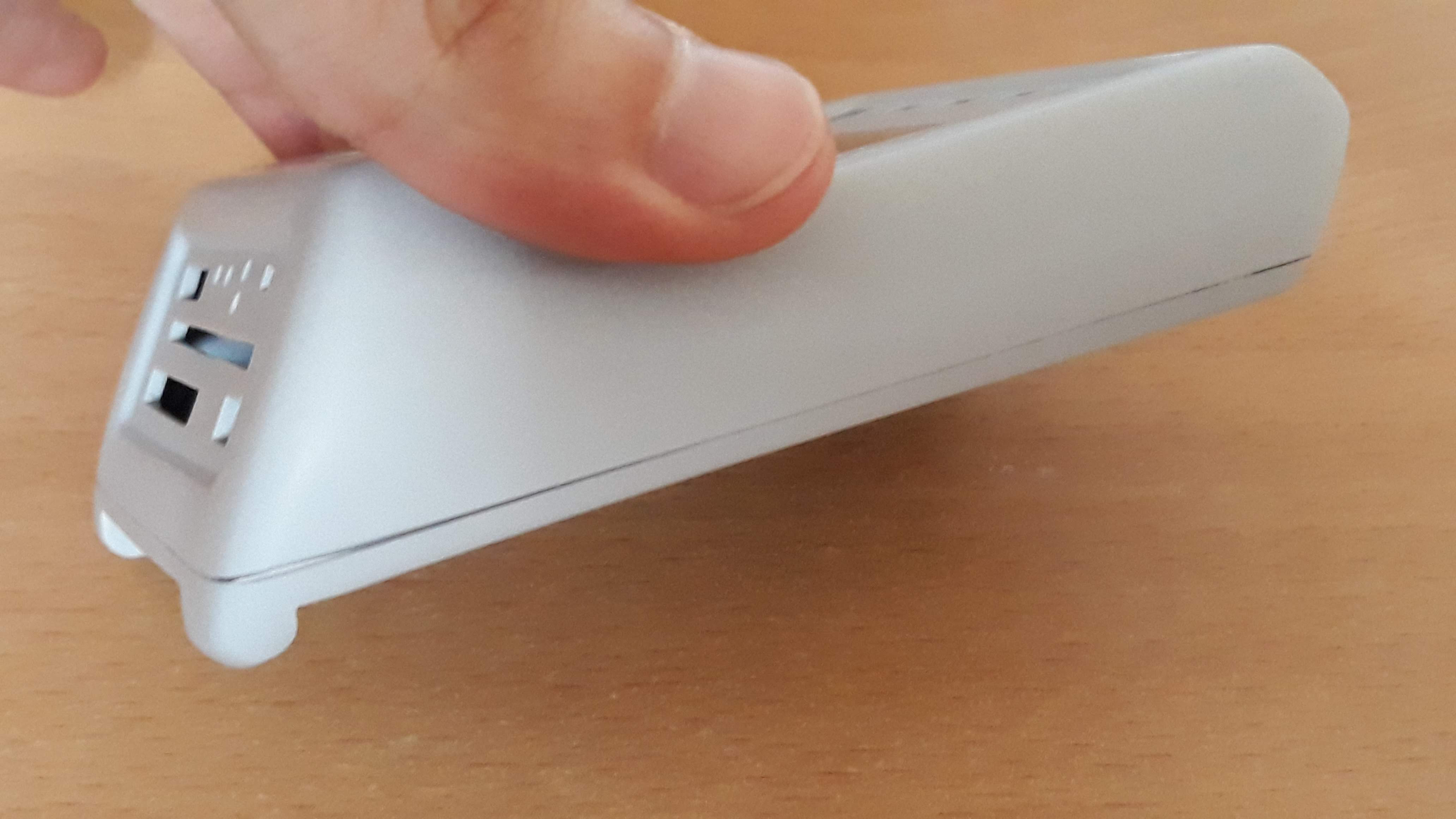

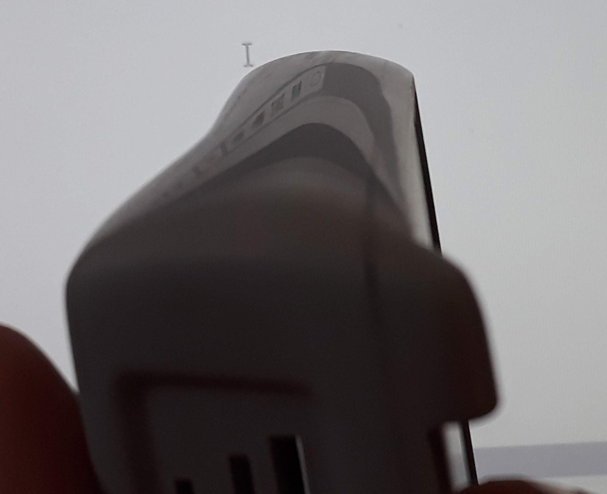

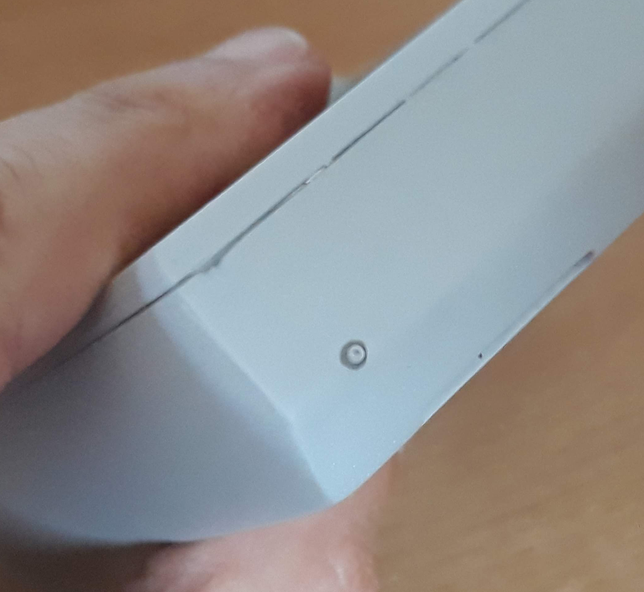

So I've started prepping the second tricorder which will be the TR-590 IX Science with electronics. I've started with epoxy resin glue to fix the front and back together.
There's a small bubble that I'm slowly filling in - but it's only 1 of 2 in the whole kit.
And while the seam may look rough and not well joined, a photo with some reflection shows how smooth the join really is:

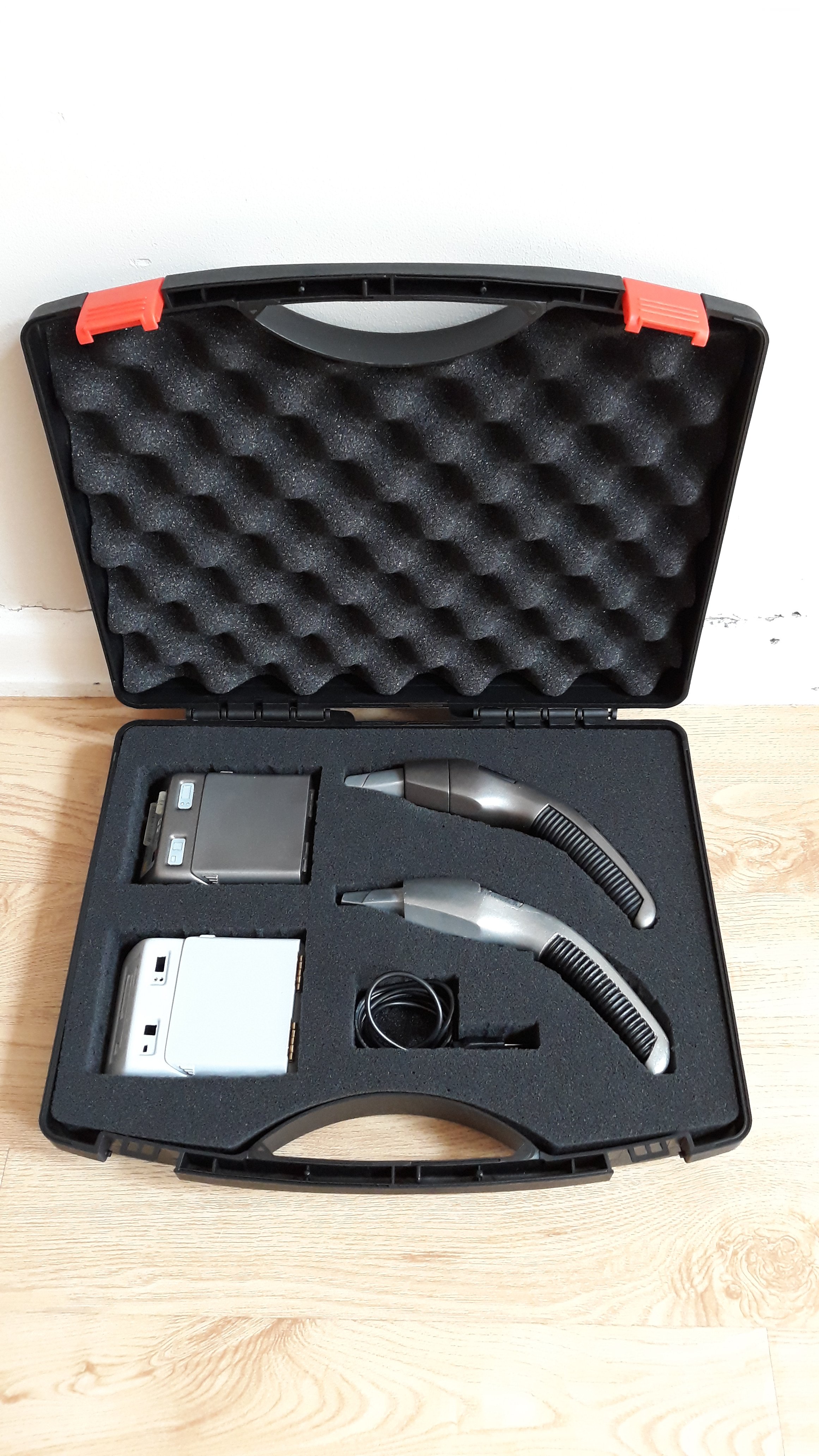

So I found a case that will house my static and hero props.
The lower phaser is a very old solid resin kit - which I think may be a recast (I wouldn't condone recasting - just never knew about what it was until I came to this forum) but once repainted it will make a nice filler with the other 3 "proper" kits.
Just need the electronics for the tricorder so I can get to work on it.
