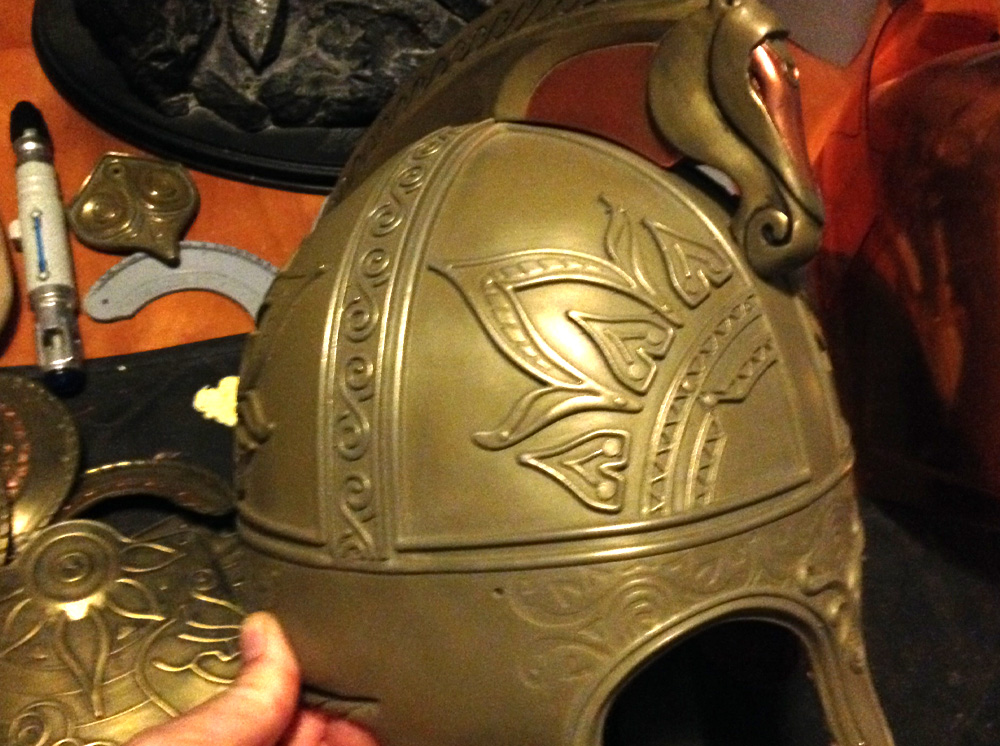

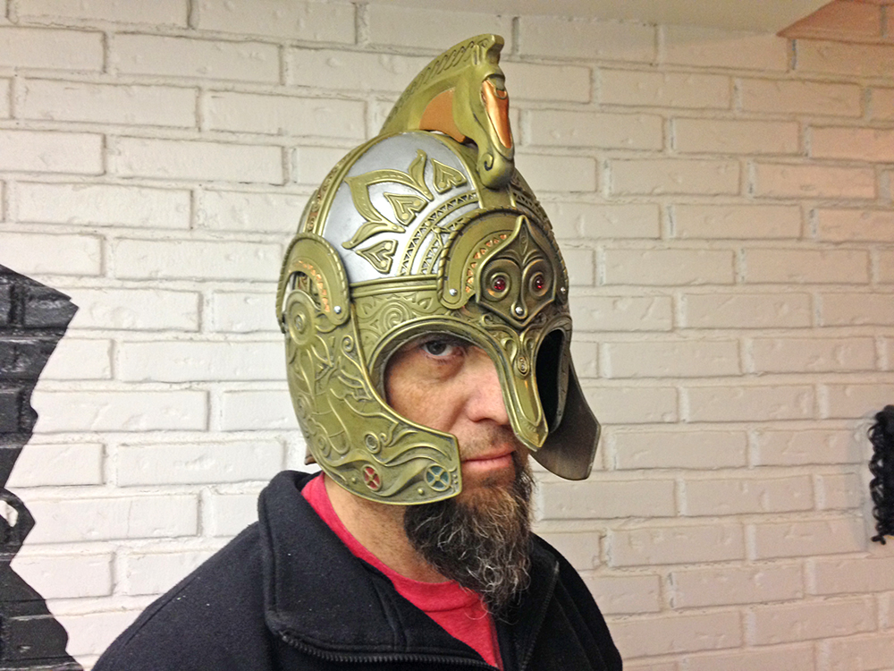

Last March I sat down and started my build of my favorite helmet from the trilogy. I knew it was going to be a long, complicated build so I used it as a background project that would be worked on when I was waiting for glue or paint to dry.
Here's the short story:

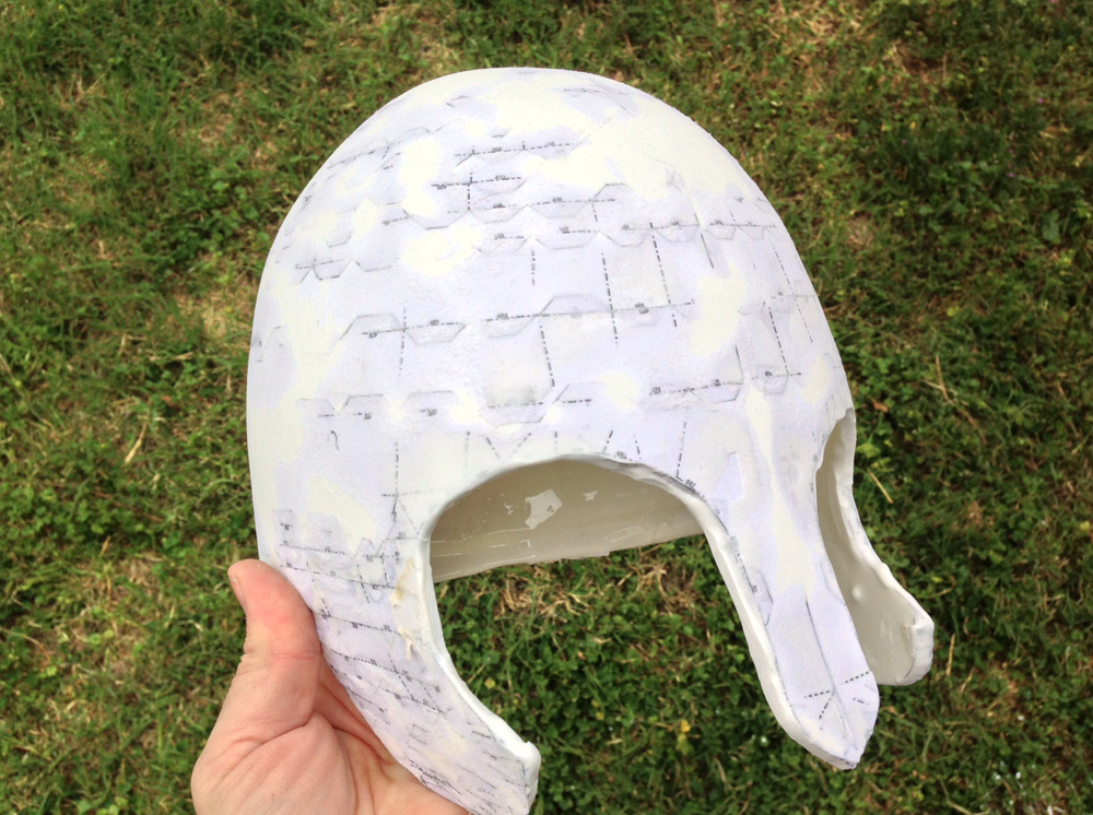

I started with a Pepakura base helmet, slushing the master with Smooth-Cast 300.

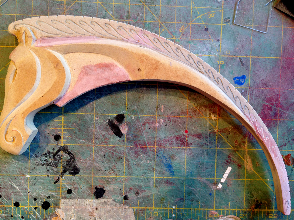

The crest was hand carved from a piece of 3/4" MDF.

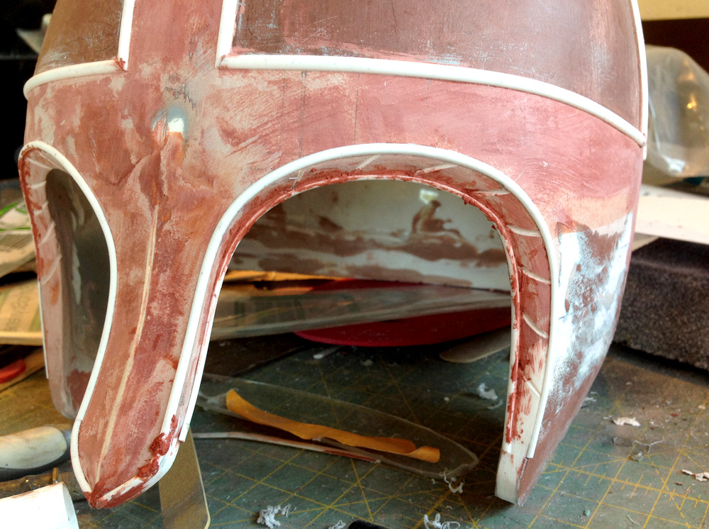

Raised bands where made with Bondo and the edging was styrene half-round.

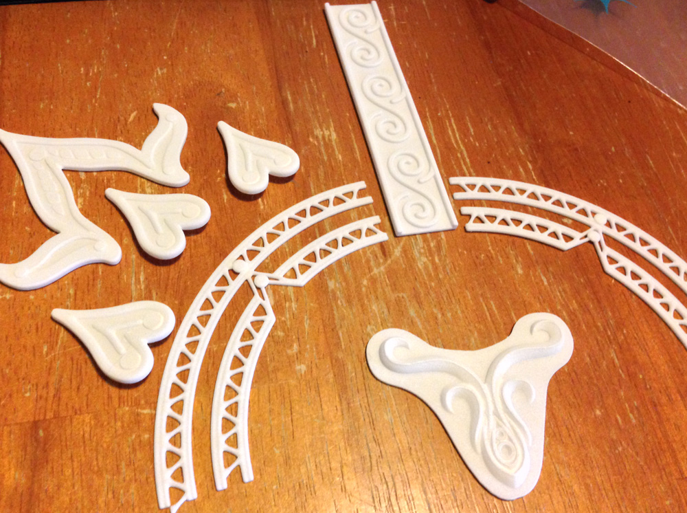

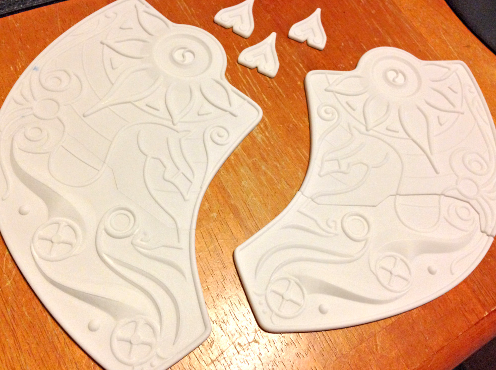

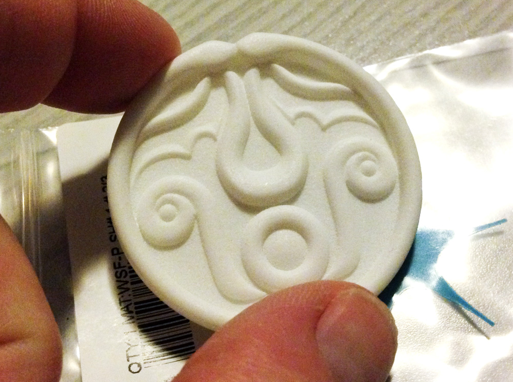

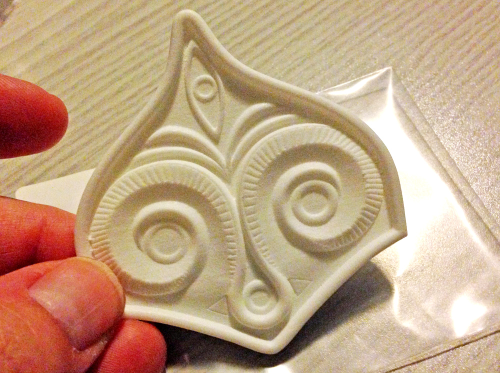

The cheek guards and all the plates attached to this thing were 3D printed via Shapeways.

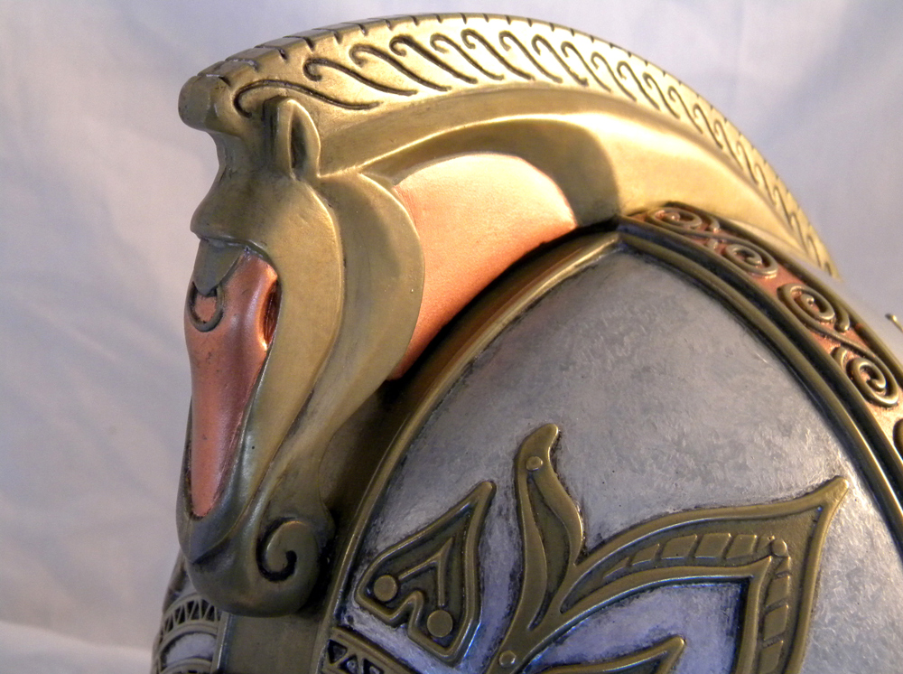

Theoden_Helmet_058.jpgTheoden_Helmet_068.jpgTheoden_Helmet_077.jpgTheoden_Helmet_057.jpg

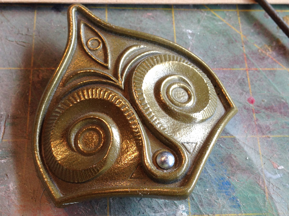

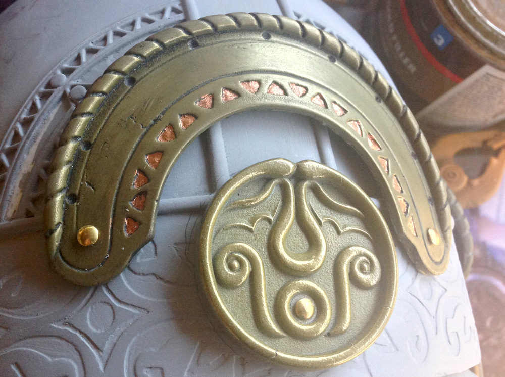

A bunch of molds later and everything was cold-cast in brass.
Theoden_Helmet_123.jpgTheoden_Helmet_090.jpgTheoden_Helmet_092.jpgTheoden_Helmet_096.jpg

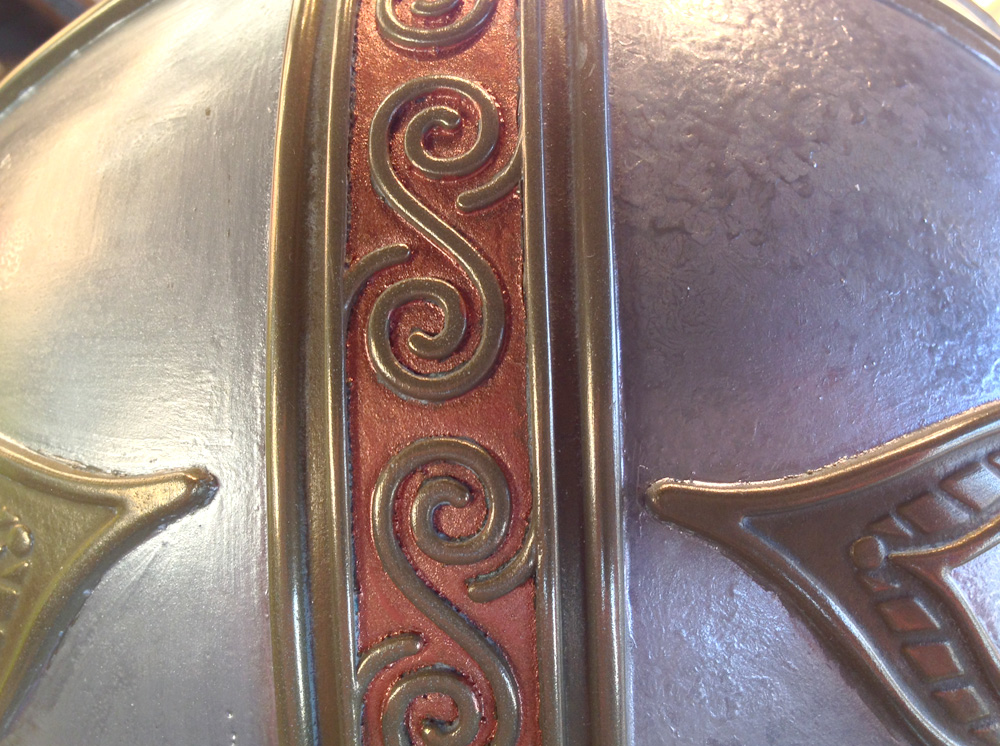

Inset areas were painted with plain ol' Testors model paint.

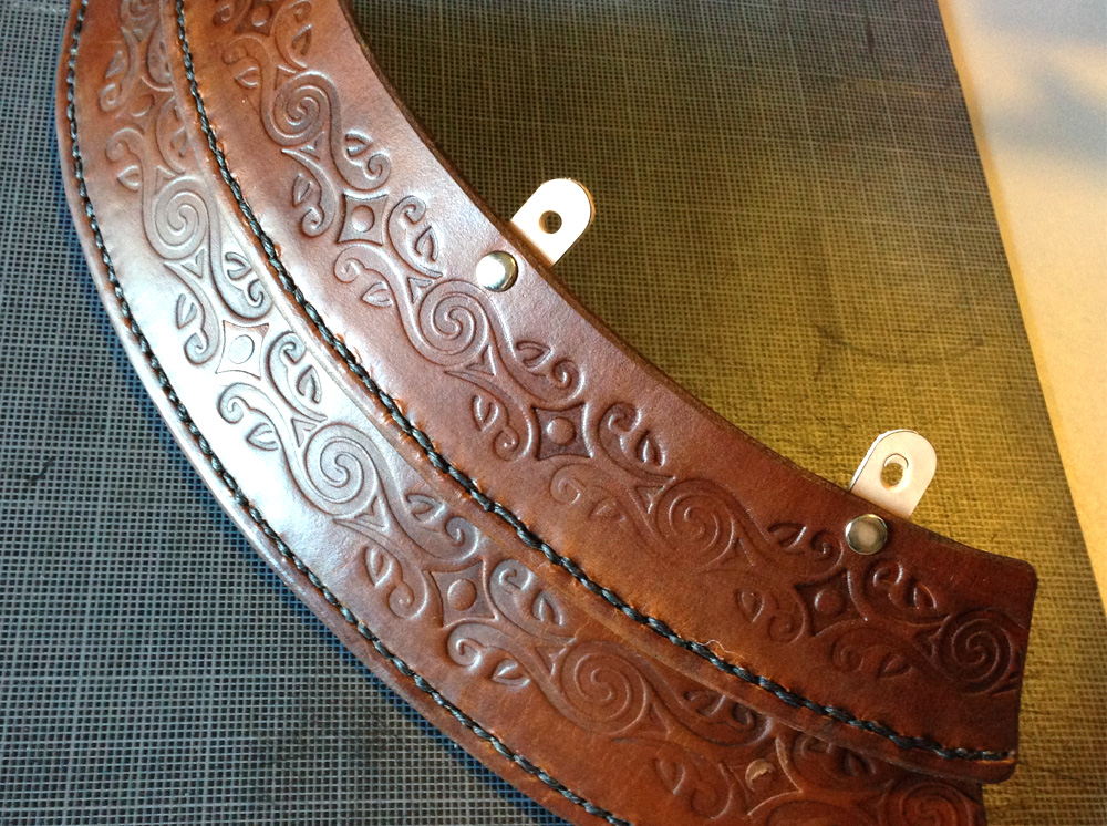

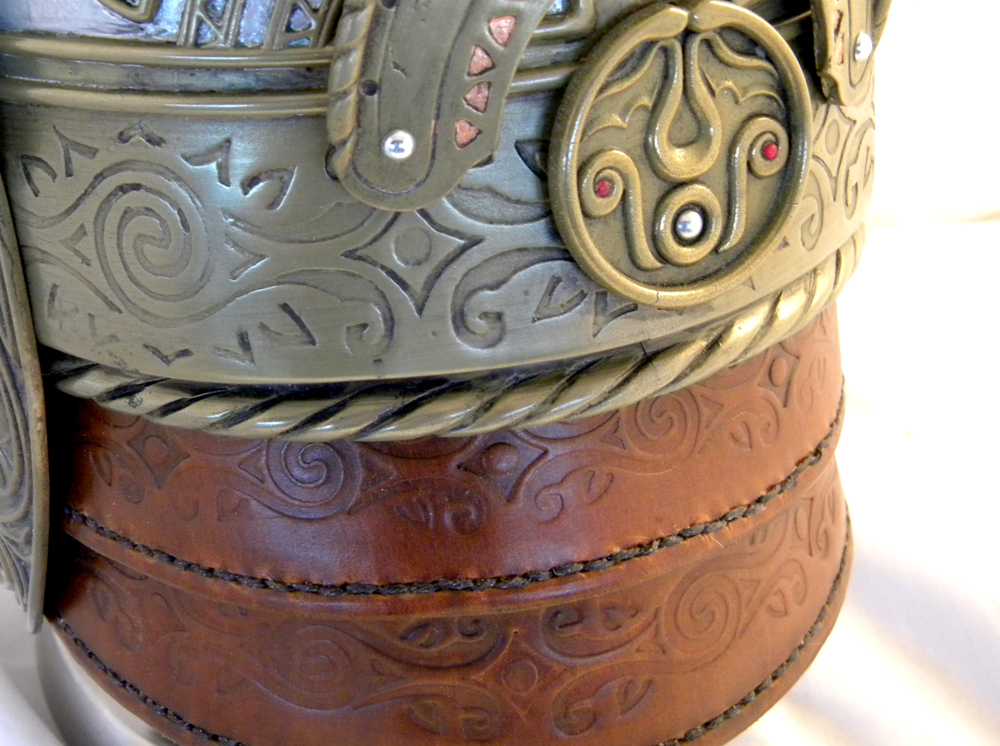

I got my friend Fevereon to produce the leather armor for the back.

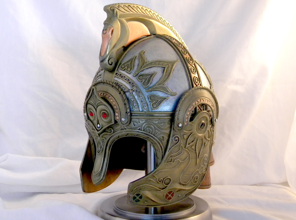

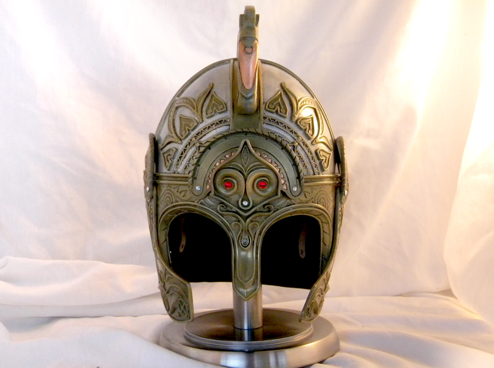

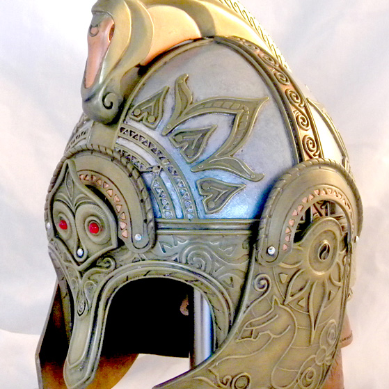

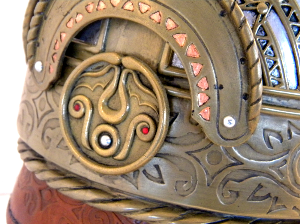

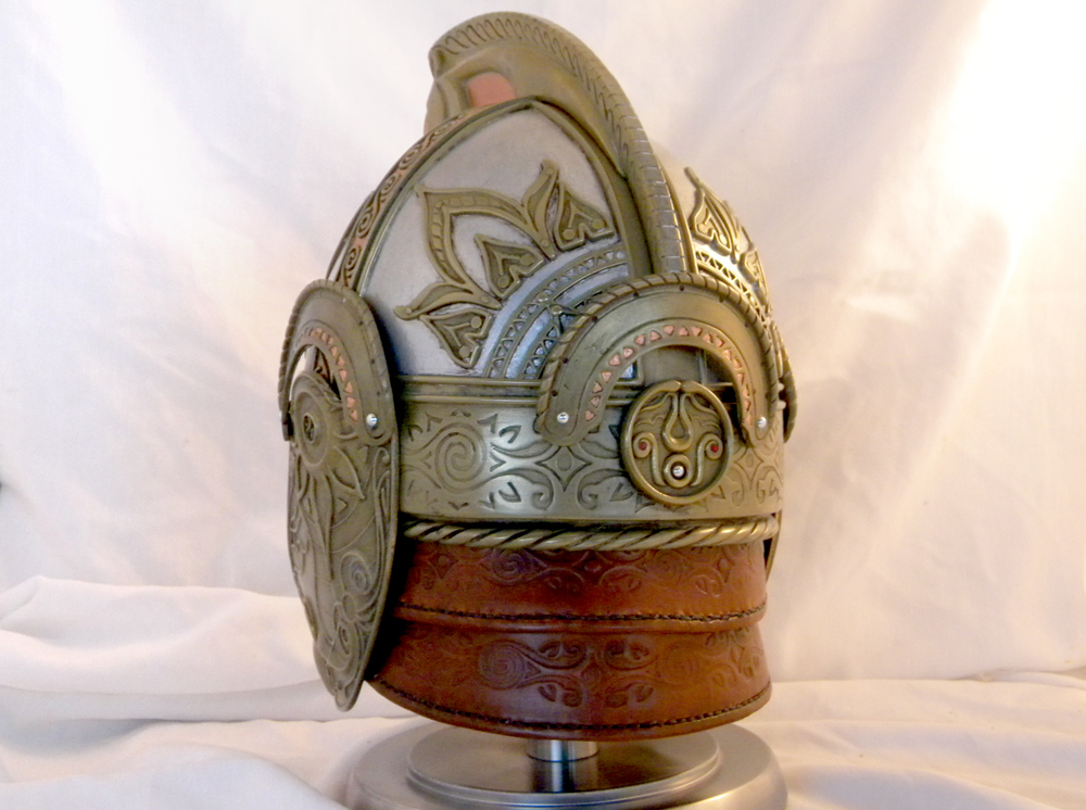

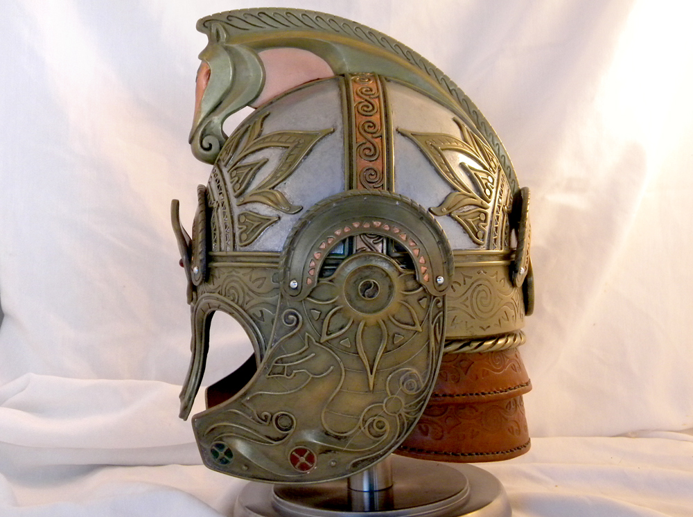

Finally finished!
Theoden_Helmet_130.jpgTheoden_Helmet_131.jpgTheoden_Helmet_132.jpgTheoden_Helmet_138.jpg

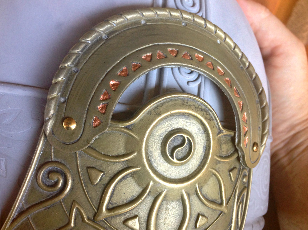

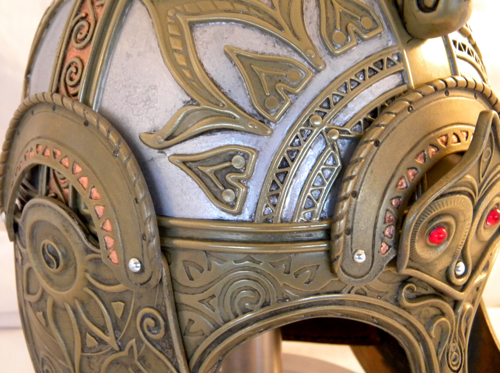

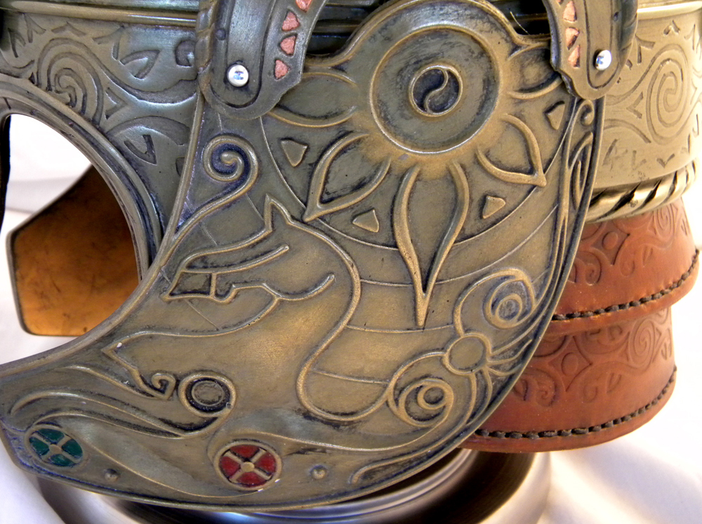

Some details
Theoden_Helmet_137.jpgTheoden_Helmet_136.jpgTheoden_Helmet_135.jpgTheoden_Helmet_134.jpgTheoden_Helmet_133.jpg
I cast my copy pretty thick so it BARELY fits on my head. Since it's going to be sitting on a helmet stand, I'm not going to worry about it.
